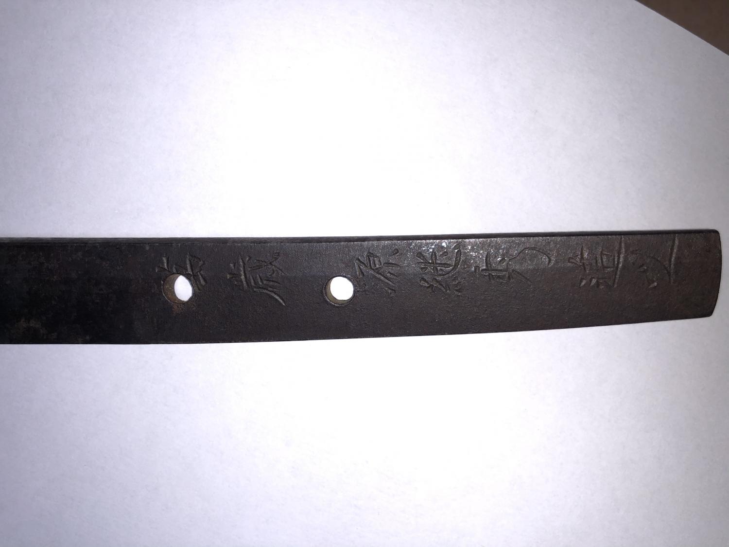

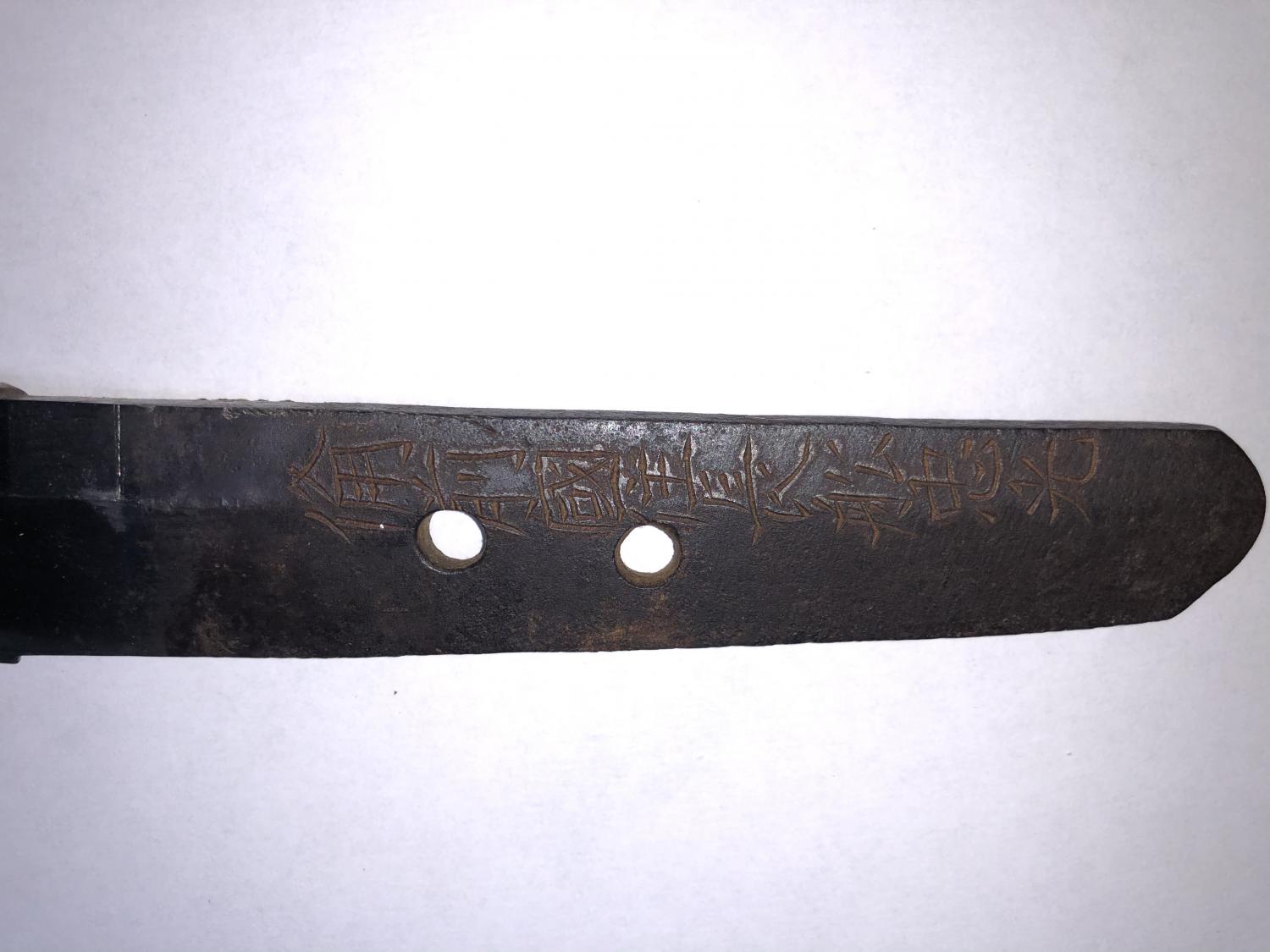

I need help to see which smiths made these wakizashis.

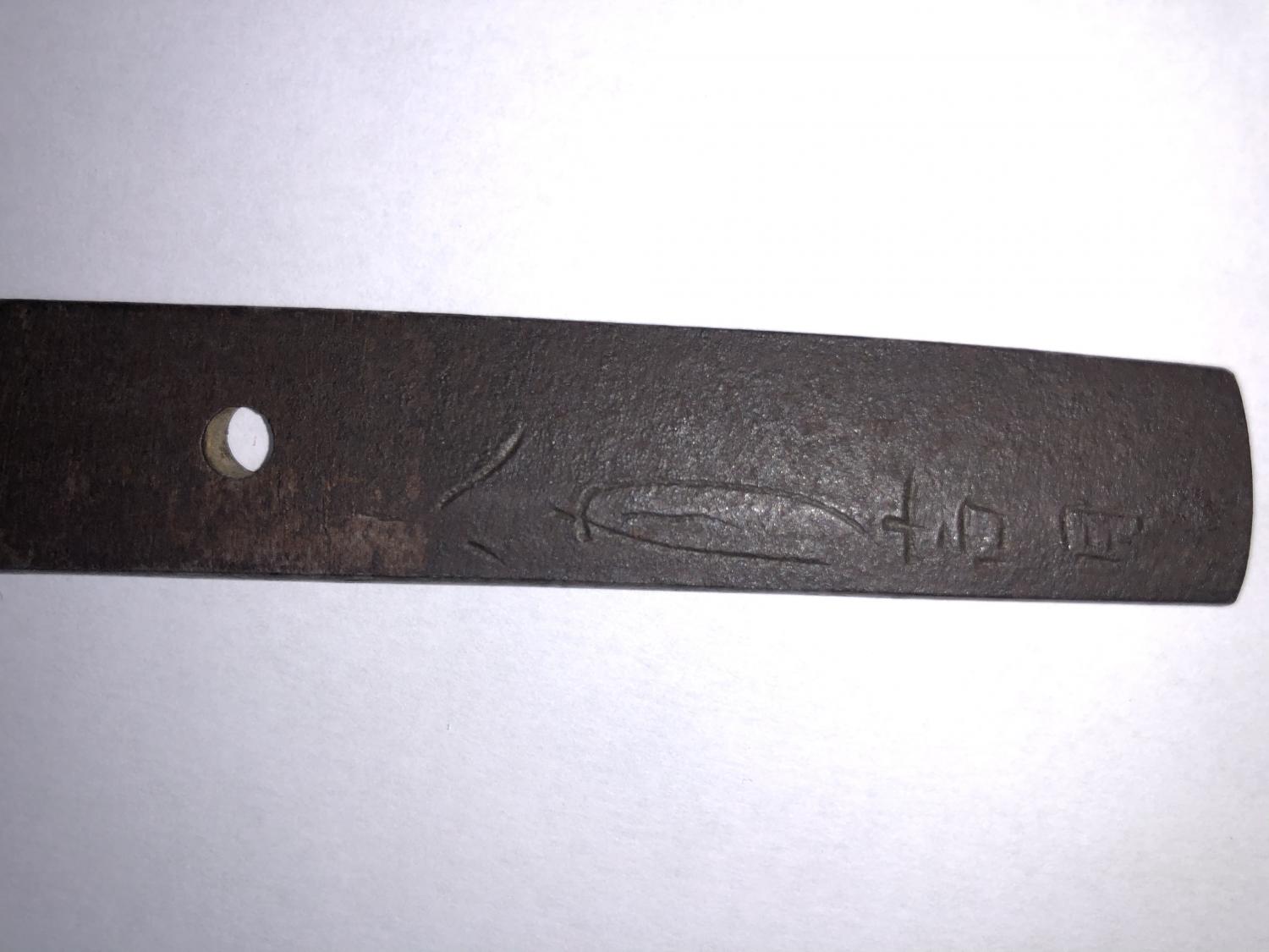

Wakizashi No. 1. This wakizashi is from the beginning of Muromachi jidai

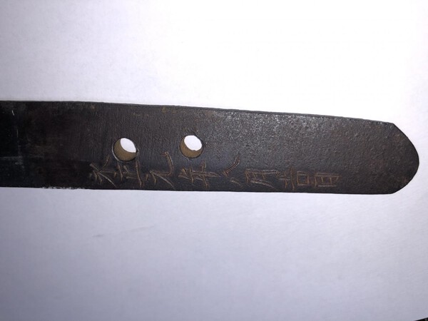

Wakizashi No. 2. I get no answer to this wakizashi when I look for smiths.

Like Bruce wrote above it is bit later than beginning for the first one.
I believe the mei on the second reads - 萬歳源継秀造之 so you would be looking for references for Tsuguhide.
Hi Jussi and Bruce
I can't find any smith with name Tsuguhide around year 1500. I have tried on different indexes but find none. Could it be some other signature to possibly get closer to who the smith is.
Do you have a translation of the second sword? It is probably a Shinto sword.

1st: Tadamitsu - 備前国住長船忠光 / 永正元年八月吉日
2nd: Tsuguhide - 萬歳源継秀造之 / 八月吉日
Tsuguhide worked in the late 1700's to early 1800's. Musashi province, lineage of Tsuguhira smiths.
