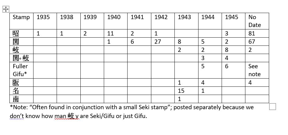

I've updated the charts with the Fuller Survey data.  Both the Cox and Fuller surveys used vast numbers of oshigata (Cox 426; Fuller 920).  Cox stated that half (213) of those observed had stamps.  Fuller didn't say, but assuming his was the same, then only 16% (77) of the Fuller blades, with stamps, were dated.  21% (44) of the Cox blades, with stamps, were dated.  Most stamped blades are without dates.
Small changes:
-- We see a 3 year overlap of the Showa and Seki stamps - 1940 through May 1942 (which refines the previously held "early 1942" end of the Showa stamp).
stamp survey (1).pdf

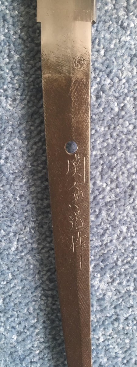

Nice collection Neil, first one that Saka stamp is close to the numbers, good looking koshirae. Second one is a three stroke  I believe.
Thomas, I am still unclear on what the katakana + the three numbers would add up too?

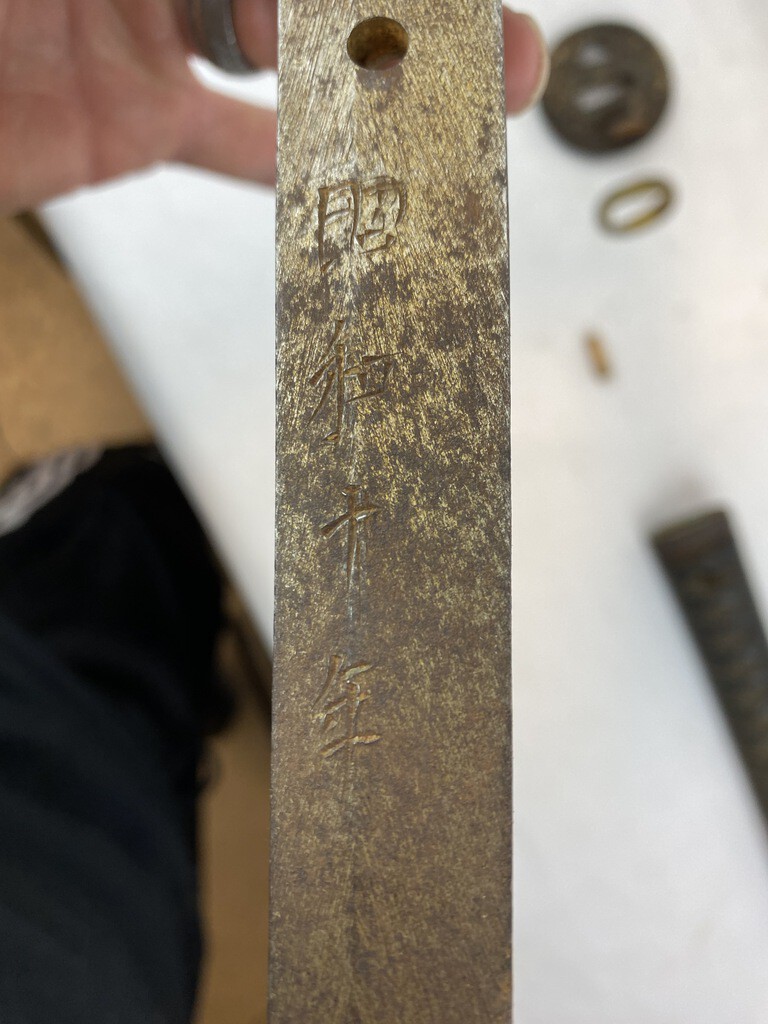

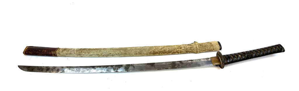

Found a 1935 Showa-stamped blade (still awaiting mei translation) fitted a canvas covered wooden saya, at a site, for sale.  Located HERE
Significant as it is the first 1935 I have seen.  Mal Cox sited one, Feb 1935, in his survey.  This one has no month, so it's a second verification of the earliest known Showa stamp.  It is before the oft-mentioned 1938 dated of the govt law requiring stamps.  As of yet, we have not seen documentation of the law, so we don't know for a fact that 1938 was the year it was instituted.  These 2 blades may indicate the real year was 1935 for the law.

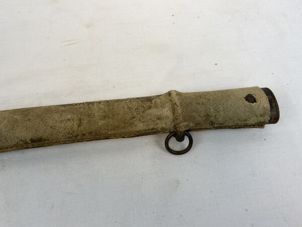

The other point of interest is the canvas cover.  This could mean the use of canvas began quite early.  Not prove, as the gunto's owner could have refitted the blade later in the war.

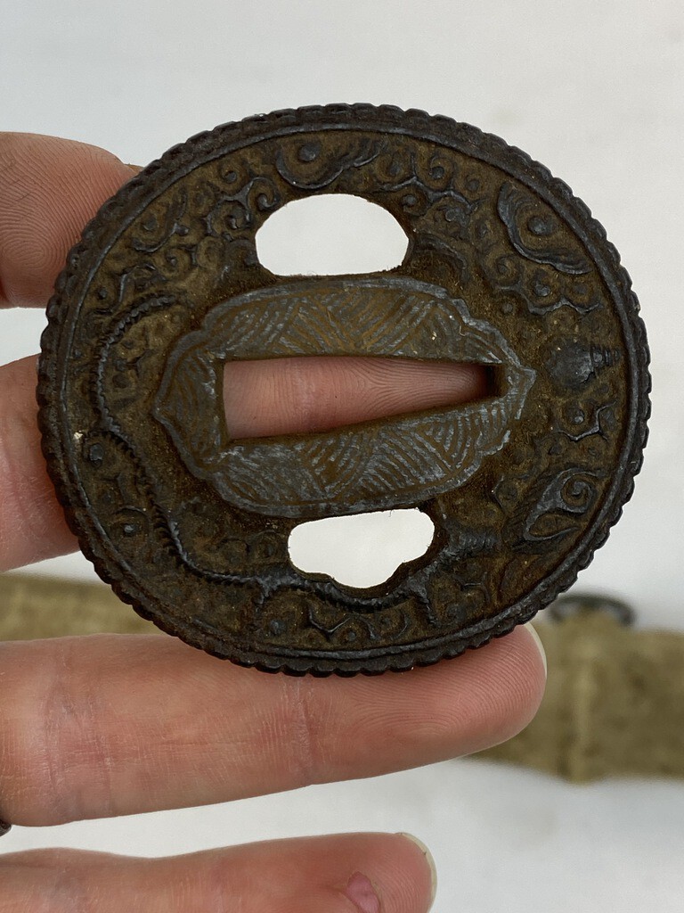

The whole thing is a little puzzling with the 2 mekugi ana and civil tsuba/tsuka.
Yes,   it is Matsuda Kanetaka  松田 兼高  and his real name was Matsuda Takaichi     松田   高市.
and yes Showa 10 1935.  Interesting early Sho stamp.
Also interesting to see the nambun tsuba and the old tsuka.  Is that leather binding?
He was registered as a toshi in Seki, Gifu 26 October, 1939 (S14.10.26) with 20 others.  Looks like a busy day.  It was a Thursday!

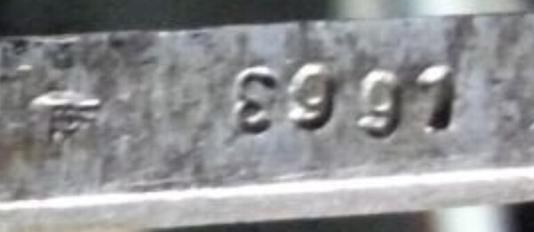

Number first.  On a Nagamitsu owned by Mauser99 (lost the thread, or I'd post a link) the number is a mystery.  It should be written with the Saka to the left like so:
post-3413-0-54817600-1454033047.thumb.jpg.29b4e1126074850b2ce7c5833ba9c2ae.jpg385036150_Screenshot2020-12-19084718.thumb.jpg.b32d563496465d54c58384c454eaf1cb.jpg
But as you can see, the "3" is backwards.  I can see human error doing this, but then the "1" isn't the normal type for a 1 either, and not a good fit for a "7".  If you flip it, the "1" is upside down, but the number would be 1663 and the 6s look right, whereas as "9s" the 9 looks wrong.
Here is two for comparison (it's blurry) and you can see the 1, and the 7 is curved.  You can also see how the 9 looks.
329415203_Screenshot2020-12-19085257.thumb.jpg.af1349b3a2bea6be08e5355503db453f.jpg1097991661_Screenshot2020-12-19085354.jpg.057bb1f5b83544c42c06316d77c1d9d8.jpg
Update: After calming down, I'm going for "saka" 3991, assuming the numbers guy simply had the 3 upside-down, and the 1 is just too heavily struck.

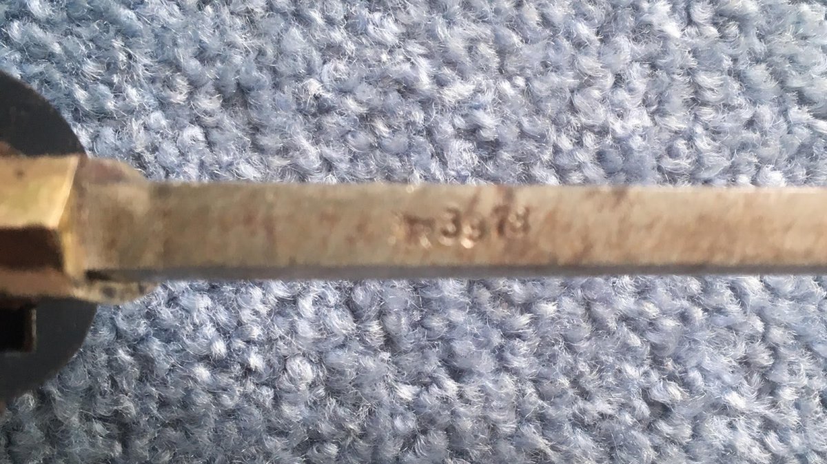

On 8/8/2020 at 5:16 PM, IJASWORDS said:
assembly number does not match the mune number 3978.
I just re-read the whole thread and noticed that I hadn't acknowledged your point Neil.  That's a very good example that points to the fact that these stamped numbers were not done by the fitter shops, at least on the RJT blades.

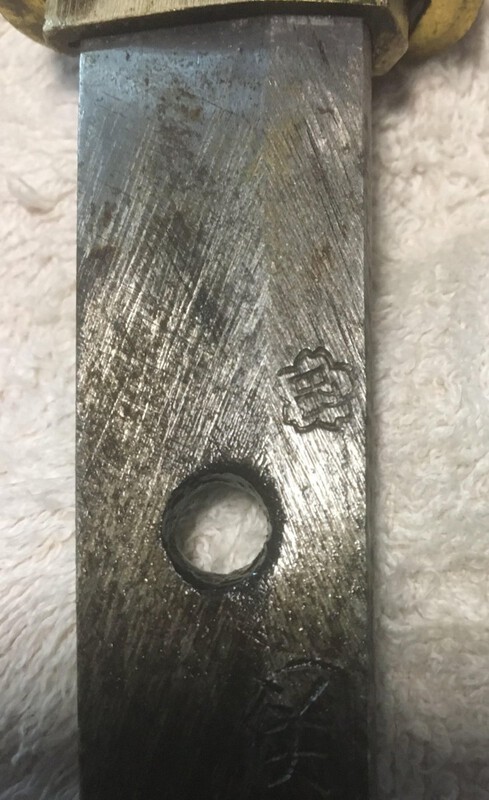

Nice one John.  I have only one other blade, a Kanemoto, star, no date, with the NA/HO mix.  The HO was the inspector mark of the 1st Factory of the Kokura Army Arsenal, so seemingly a mystery - why would a Nagoya Arsenal blade have a Kokura Arsenal stamp?  But we see the same thing on Type 95s.  Kokura was the oversight of both Tokyo 1st Arsenal and Nagoya Arsenal up until 1942ish.  I don't have definitive facts on exactly WHEN Kokura stopped oversight.  One source said 1940, another 1942.  But this dated blade pushes that date to 1942.  The RJT program began in 1942, which explains the lack of star on your Yukihiro.

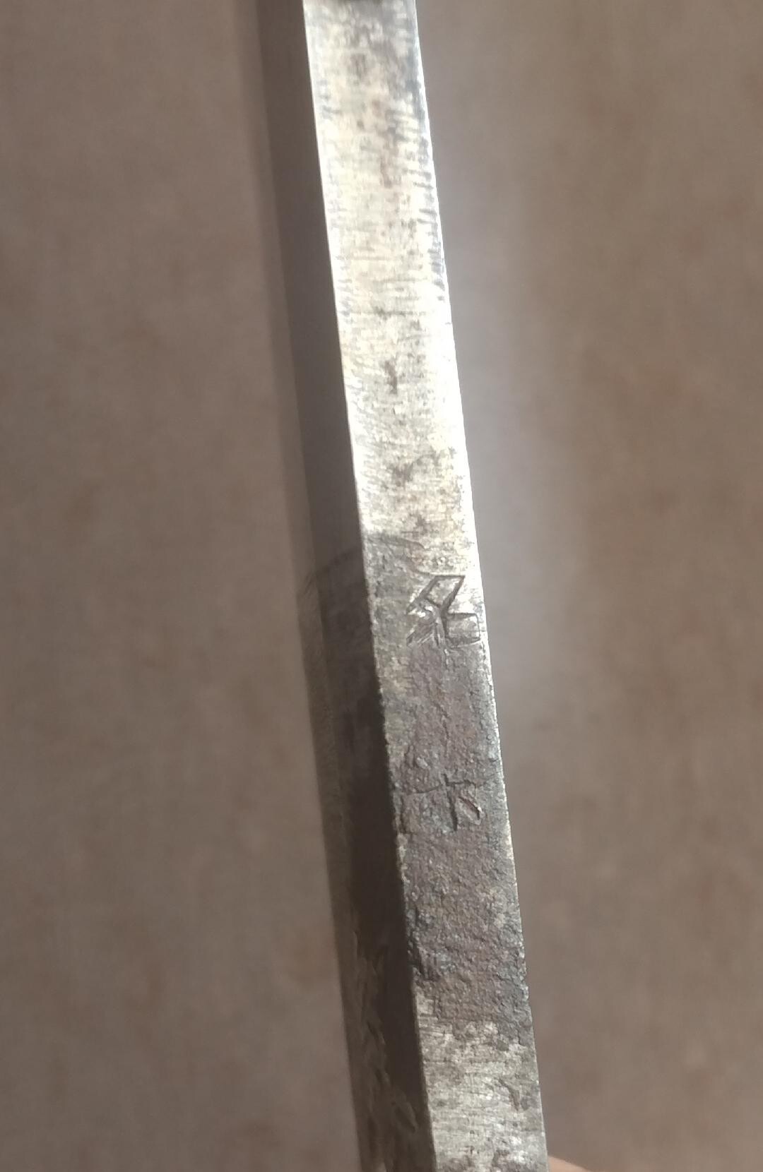

On 12/19/2020 at 9:37 PM, PNSSHOGUN said:
Gendaito by Muto Yukihiro, an RJT smith but this has no star stamp, so private order or made offsite. From memory date is November 1941.
Nakago Mune: 名 ホ.
Nakago Reverse: 紀元二千六百一年十一月 = November 1941.
Nakago Obverse: 筑後住武藤幸廣
