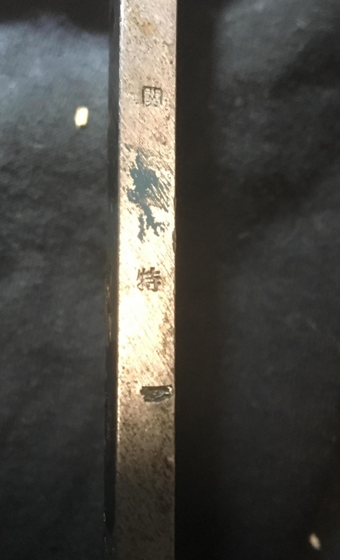

IJASWORDS Posted July 26, 2020 Report Posted July 26, 2020 Bruce, these 3 mune stamps are on a star stamped 1944 Kanetoshi in RS mounts. What are they? 1 Quote
Bruce Pennington Posted July 26, 2020 Author Report Posted July 26, 2020 Neil, From the top - Seki, 特 = TOKU, and Unknown. I haven't found anyone who recognized that bottom one, probably because there isn't enough detail to make out the strokes. Also, I don't know the meaning of the Toku, so if someone does, please let us know! If yours is a June 1944, I have it in my data already. If another month, please let me know! Quote
george trotter Posted July 26, 2020 Report Posted July 26, 2020 Toku means 'special' as in tokubetsu 'especially important'. 1 Quote
Bruce Pennington Posted July 26, 2020 Author Report Posted July 26, 2020 On 7/26/2020 at 2:05 PM, george trotter said: Toku means 'special' as in tokubetsu 'especially important'.Thanks George! Another mystery, because now we wonder "Especially important" order for important person, or especially important work because of the quality of the work? As these are inspector marks, I would guess the latter. You don't happen to recognize that last mark do you? 1 Quote

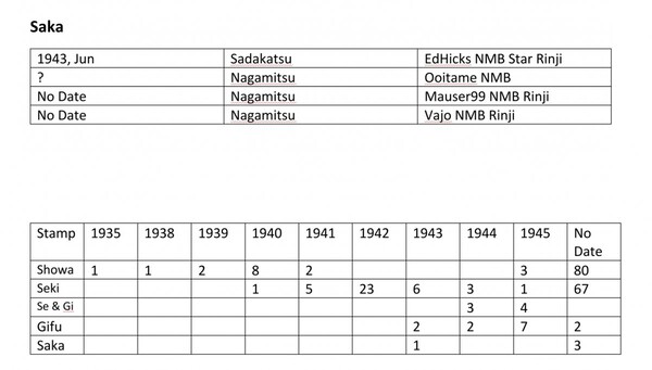

Bruce Pennington Posted August 2, 2020 Author Report Posted August 2, 2020 Thanks to Niel (IJASWORDS), we now have a stamp survey done by Malcolm E. Cox, published in a JSSUS newsletter. Master Cox was fortunate enough to survey 425 blades! Half, 213, had stamps. I've added his data to mine and made the following chart. The majority of blades in my survey are signed, but like the Cox survey, most are not dated. Cox didn't discuss smith mei in his report. You can see a small overlap in years 1940/1941 with the Showa and Seki stamps, but the real switch came in 1942 when the Army took centralized control of all sword production, ending the Showa stamp (except the rare 1945 blades!) and moving to the Seki stamp, followed by the Gifu stamp. I've just added the Saka stamp and only have 1 example. Since my interest began in blade stamps, I haven't seen many Saka stamps, but it surprises me as we have recently learned that the Osaka Arsenal was making more blades than Mantetsu as seen in this translated chart from 1944 blade production. 1 Quote

Bruce Pennington Posted August 5, 2020 Author Report Posted August 5, 2020 Posting the survey worksheet for those interested. Getting more Saka blades (4) and 3 of them are Nagamitsu. They are all in Rinji-seishiki fittings. Only the Sadakatsu is star-stamped. One Nagamitsu is in double-release button saya. I now have a kiagunto, mei: Goto Hiromasa, with a large Seki stamp. I know the large ones are out there, and I recall some other kaigunto with the stamp, but it will take some time to dig them out of the previous posts. stamp survey (1).pdfFetching info... Quote

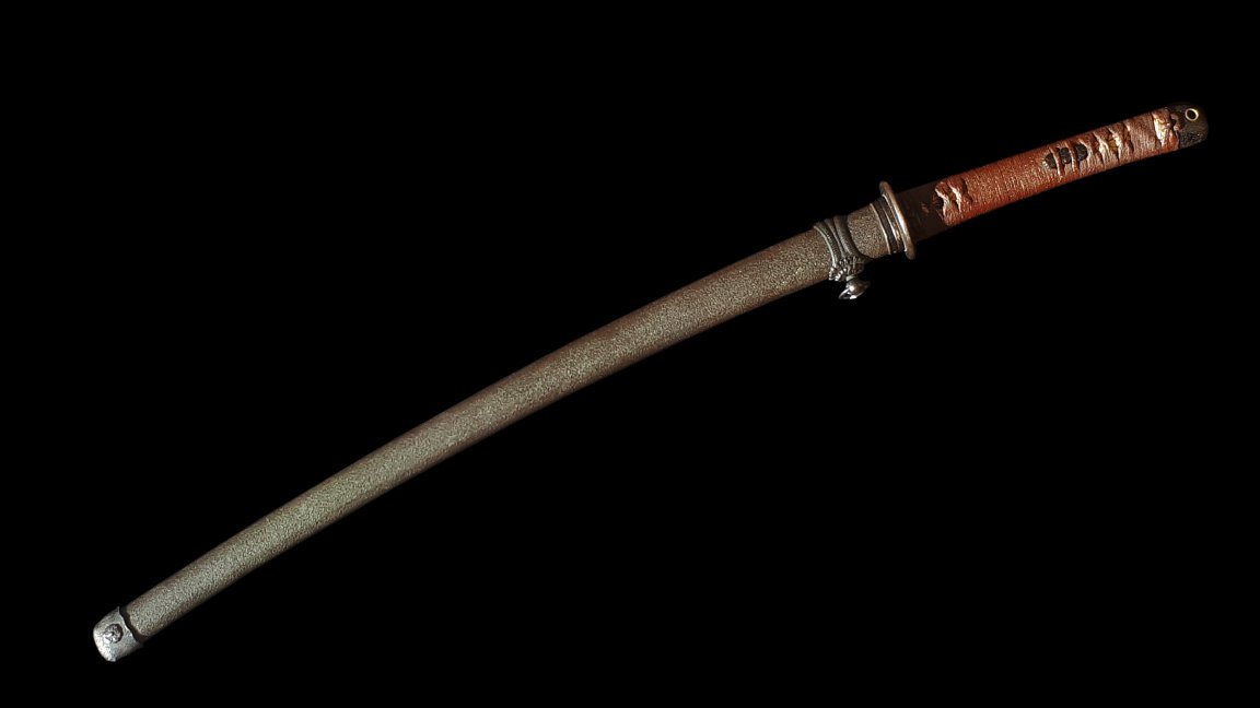

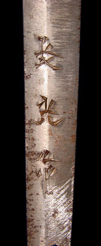

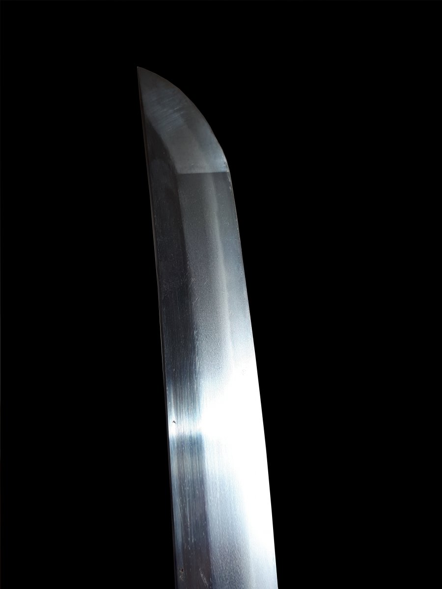

Bruce Pennington Posted August 8, 2020 Author Report Posted August 8, 2020 Thanks Thomas and Eric! Eric- Thanks, another Nagamitsu. I'm sensing a trend! 1 Quote

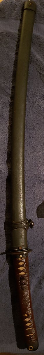

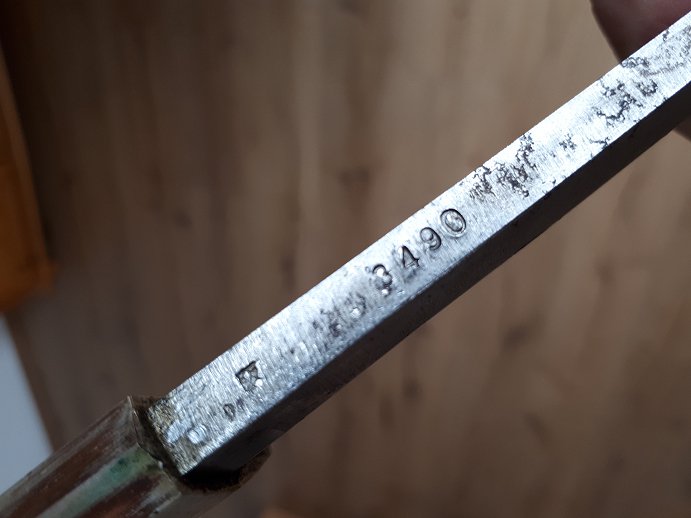

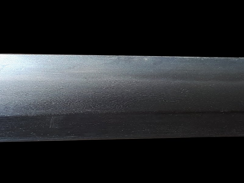

vajo Posted August 8, 2020 Report Posted August 8, 2020 Eric thats a nice nagamitsu. I have one in the same style but a higher no. Good piece. Has it suguha or choji hamon? 1 Quote
Ooitame Posted August 8, 2020 Report Posted August 8, 2020 No problem Bruce. Thanks Chris, it is ko gunome, but on both sides and the same spot it has about 2in. of sughua 3/4 up the sword and turns back to gunome. Not sure on the reason for this as it does look intentional. Yes this is the lowest numbered one I have seen yet. Would like to see and learn more on Nagamitsu and other Osaka RJT. Quote
Kiipu Posted August 8, 2020 Report Posted August 8, 2020 On 8/8/2020 at 6:26 AM, vajo said: Eric thats a nice nagamitsu. I have one in the same style but a higher no. Expand Actually, yours is lower. 阪 3490 vajo 阪 イ313 Ooitame 2 Quote
Ooitame Posted August 8, 2020 Report Posted August 8, 2020 Chris, nice one! Good shot on the hada! On 8/8/2020 at 7:06 PM, Kiipu said: Actually, yours is lower. 阪 3490 vajo 阪 イ313 Ooitame Expand Always willing to learn, Thomas, can you explain a bit further? 1 Quote
Kiipu Posted August 8, 2020 Report Posted August 8, 2020 If these are serial numbers, then they start at 1 and will go to three, four, or five digits. It looks like four digits in this case. After finishing the initial range of numbers starting with 1, they would start using a katakana prefix that follows the iroha poem order. In the West, we call these prefixes series marks. 1 to XXXX イ1 to イXXXX ロ1 to ロXXXX Something similar happened with Mantetsu swords except they did not use the no prefix series that started at 1. 1 2 Quote
