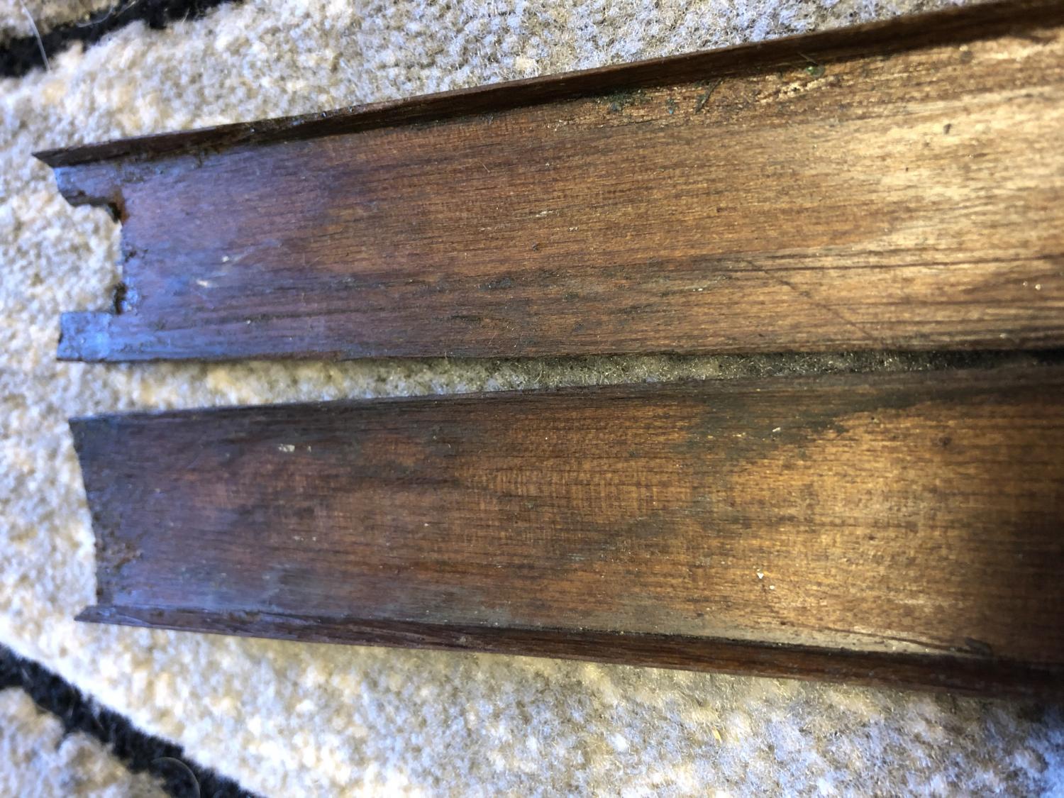

Bruce Pennington Posted July 23, 2020 Report Posted July 23, 2020 Someone on another thread wanted dimensions of the liner from a Type 95 saya, so I slid one out and posted the measurements. But afterward, I noticed how wet and saturated the ENTIRE liner was! I left it by the floor vent of a room that gets the most A/C air movement for a few days just to dry it out. After drying, I rubbed the inside with folded paper towels and was appalled at the grime that came out. Since then, I've checked 3 other 95 saya. One was ok, the other two had scattered black build-up that I think is the "tanins" (if that is the right word) that can permanently stain the blade! I used course copper-wool to sand that down, and then used folded paper towels to rub the surface down, removing grime and smoothing the surface. I have 4 more to check, but wanted to put this out there. If you are able to easily remove the liners of your gunto, it might be worth checking. I've tried this on my officer gunto, but have been unable to get most of them (only 1 came out) to come out. My dad's Mantetsu liner is locked in like it was glued or something. Dry, but heavy black build-up (before & after) Entire liner soaking wet 5 Quote

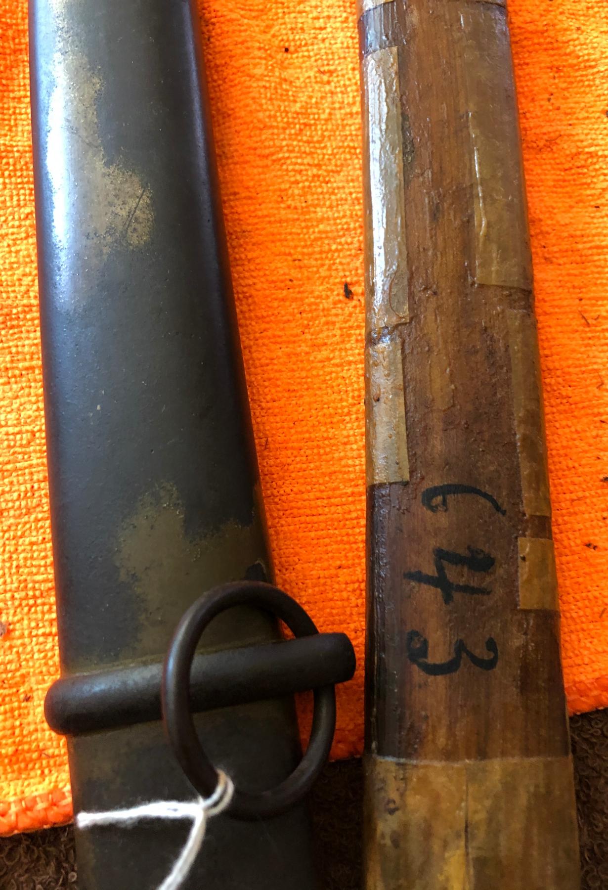

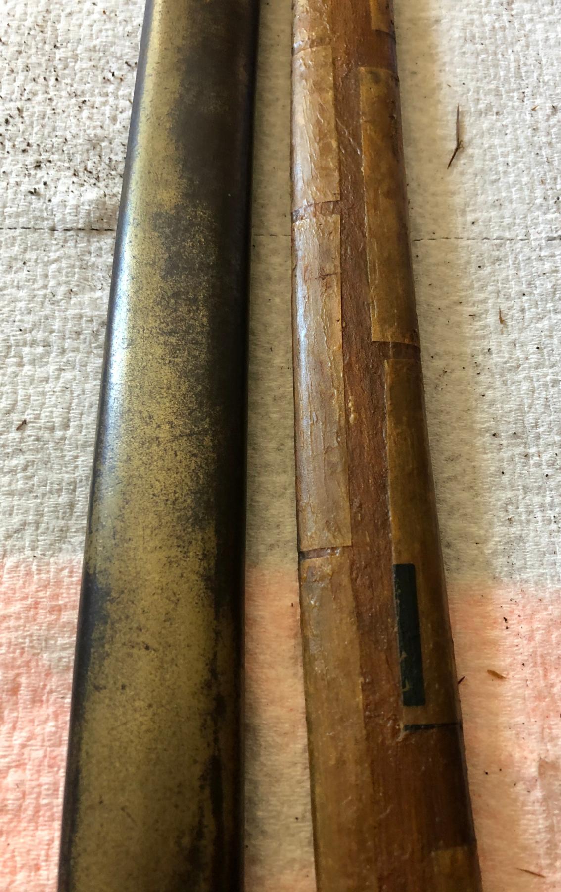

Bruce Pennington Posted July 24, 2020 Author Report Posted July 24, 2020 Got to check a few more today. One was dry and clean. Second one was still tightly glued together along the mune side! I could open it just enough to clean a spot or two, but mostly in good shape. Third had only 1 half of the liner!!! And it was on one of my near-mint 95s! You can see where the tannin put a permanent stain on the blade Checking my copper liner was a surprise! The halves were sealed tightly with glued strips of paper! The end was made differently than the liners of the aluminum models. 1 Quote

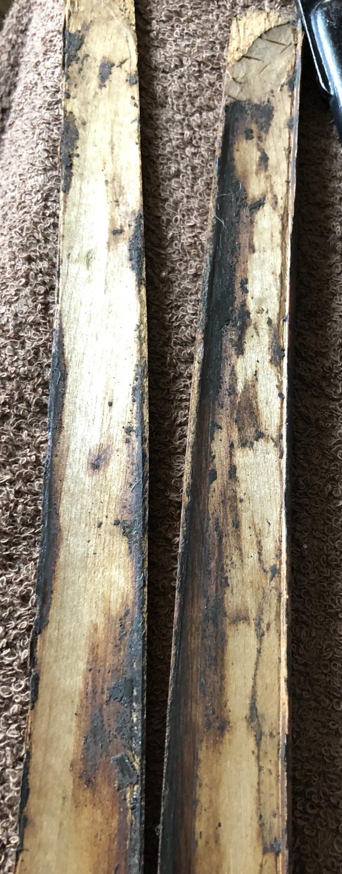

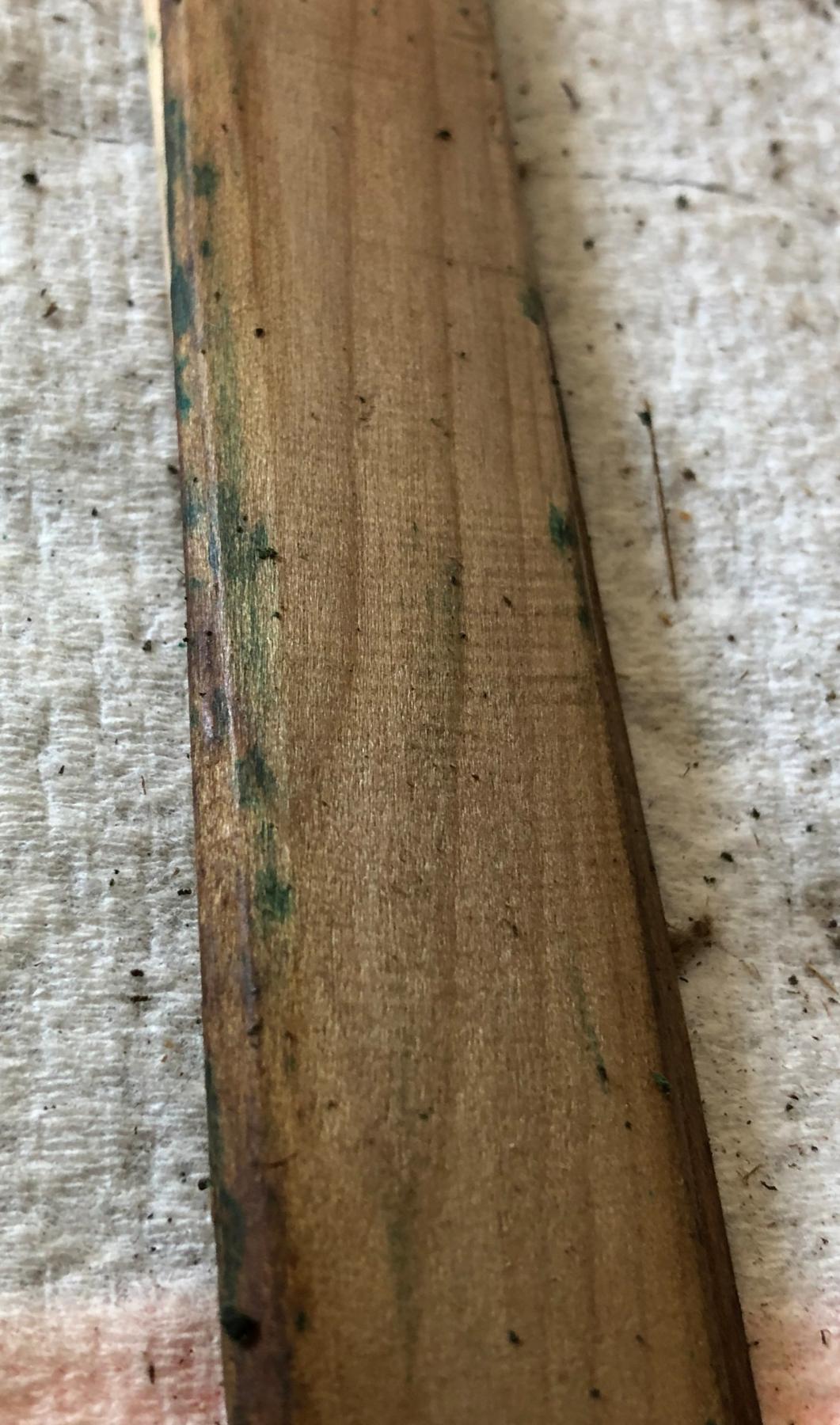

Bruce Pennington Posted July 24, 2020 Author Report Posted July 24, 2020 Found that even though a liner may have tannin stains, they don't always stain the blade. In fact, most of these stains are not found on the blades. this one has extensive stains, while the blade is unmarked Most if not all, had wet stains at the opening of the saya throat, which makes sense, as the first part of the liner absorbs the majority of the oils as the blades slides in. Goes as a reminder to not leave standing oil on the blade! My late-war liner was actively wet! The outside even had greenish moldy looking spots! I had already sanded this before the picture was taken. Quote

Ganko Posted July 24, 2020 Report Posted July 24, 2020 I suspect those stains are iron oxide transferred from the blade to the wood rather than the other way around. As Dave says Honoki can not do that. 1 Quote
Bruce Pennington Posted July 25, 2020 Author Report Posted July 25, 2020 On 7/24/2020 at 9:00 PM, Ganko said: I suspect those stains are iron oxide transferred from the blade to the wood rather than the other way around. As Dave says Honoki can not do that.Ok, could be! I have an example on the outside of the liner ends where rust from the inside of the steel saya was "growing" into the wooden tips. So, your idea may explain it. But now, I'm still at a loss in understanding the permanent black stains I find on blades. One of our guys had proposed the tannin idea, that it was leaching out of the wood and into the steel. If that's not the case, then what would be causing those spots? It's not rust. Quote
MarcoUdin Posted July 25, 2020 Report Posted July 25, 2020 I'm not an expert, but I believe those black spots are still rust. Usually when moisture gets trapped under the layer of choji oil. Usually becomes black if there is so little moisture that it does not form red rust. Other possibility is saya gets swollen, makes contact with blade causing moisture to transfer from saya to blade. Which then forms rust and stains saya. 1 Quote
MarcoUdin Posted July 25, 2020 Report Posted July 25, 2020 In general, low moisture + low oxygen = black rust. 2 Quote
