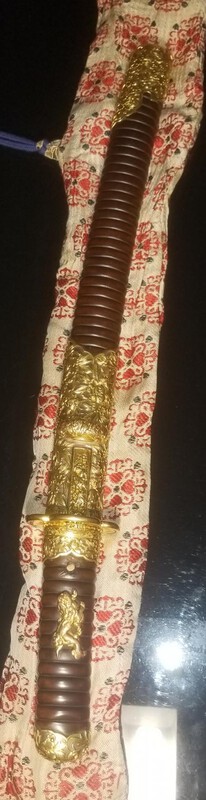

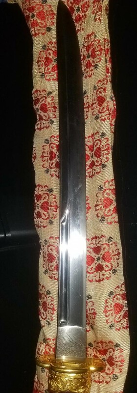

Yuradneprov Posted July 22, 2020 Report Posted July 22, 2020 I asked for translation help on a kogatana that came with this koshirae and still yet to be translated. Also quite interested on what type of koshirae this is because it is very unusual and seems well made. Feel free to weigh in. Quote
Ken-Hawaii Posted July 22, 2020 Report Posted July 22, 2020 Yura, I'm not sure of the hacho on your blade, but I can't recall seeing formal koshirae without a kurigata. Quote
Bugyotsuji Posted July 22, 2020 Report Posted July 22, 2020 It gives me flashes of Meiji or later. Quote
Ganko Posted July 22, 2020 Report Posted July 22, 2020 On 7/22/2020 at 3:18 AM, Ken-Hawaii said: Yura, I'm not sure of the hacho on your blade, but I can't recall seeing formal koshirae without a kurigata. Ken the kurikata is there, it just blends in with the other metal. 1 Quote
Yuradneprov Posted July 22, 2020 Author Report Posted July 22, 2020 Piers it's sure not meiji, my guess is 1780-1840 some time around there that this was made. It's a bit different wood and gold plated copper. Quote
Yuradneprov Posted July 22, 2020 Author Report Posted July 22, 2020 Ken zoom in on the first picture. The kurikata is camoflauged but it's there. Depicts 2 shishi dogs. Quote

Marius Posted July 22, 2020 Report Posted July 22, 2020 Judging by the workmanship (which is poor) it is Meiji at best. It could even be Chinese. The sword looks interesting, though. Yura, if you want to see a high quality koshirae (in fact, highest quality) have a look at this one: https://yuhindo.com/goto-mitsunobu-yokoya-nobusada-daisho/ 2 Quote
Yuradneprov Posted July 22, 2020 Author Report Posted July 22, 2020 Thank you for the feedback Marius, I'm very aware of what high quality koshirae looks like. One thing that 100% is that it's certainly not chinese. Quote

Dave R Posted July 22, 2020 Report Posted July 22, 2020 I would suggest Bakumatsu era, and a variant on Toppei Koshirae. You find some very non traditional pieces under that designation. 1 Quote
Babu Posted July 22, 2020 Report Posted July 22, 2020 I don't think anyone can be at all certain of what it is or isn't based on such low resolution images. It sounds like your keen to buy so perhaps a decision has been made and this discussion it better served after you have provided more detailed images and information, perhaps with it in hand. I think it's not that early but based on the images who knows.As for quality I don't think it's high, just flashy pretentious. It follows this is after 1830 IMHO and possibly 1930's Really not a lot to go on sorry. I'll politely bow out. Good luck Quote
Yuradneprov Posted July 22, 2020 Author Report Posted July 22, 2020 I totally agree with you Dave since bakafu prohibited use of pure gold around that time according to what another member mentioned would make perfect sense. Quote

Babu Posted July 22, 2020 Report Posted July 22, 2020 Can you please ensure your name is on every reply by embedding it in your signature. Lots of Newcomers are not adhering to this policy. Up to 1830 the quality of gold (pure gold content) was reduced to as little as 50% by order of the Bakafu. 1830 to end of the samurai class pure gold of any composition was prohibited other than foil and plate or gilt. What I cannot work out us why it's got a silver habaki.Thats not in the style of the piece. Quote
Yuradneprov Posted July 22, 2020 Author Report Posted July 22, 2020 Hey Adam my name is signed under everyone of my posts I thought. At least I see it when i write a message. Not sure as to why it's got a silver habaki either at 5pm I'll put up better picture This way everyone can see it everything better. Quote

Brian Posted July 22, 2020 Report Posted July 22, 2020 Much better pics.I am unsure what to make of this. I like the blade a lot. But as for some of the fittings, I suspect someone took a nice kozuka and menuki (and other parts) and heavily gold plated them. They messed up all the fine detail, nanako etc etc.Under that, I suspect we have decent shakudo and whatever else. 2 Quote
Yuradneprov Posted July 22, 2020 Author Report Posted July 22, 2020 Maybe possible brian, honestly I don't care about the fittings of course it sucks if someone really did do that. Im mostly interested and only want the sword either way just very very curious that's all. Quote
Yuradneprov Posted July 22, 2020 Author Report Posted July 22, 2020 Well since its not really a secret anymore nor was it really ever the signuture is "Oite Azuma Tamaki" and is dated August of 1835. Quote
Babu Posted July 22, 2020 Report Posted July 22, 2020 On 7/22/2020 at 12:04 PM, Brian said: Much better pics. I am unsure what to make of this. I like the blade a lot. But as for some of the fittings, I suspect someone took a nice kozuka and menuki (and other parts) and heavily gold plated them. They messed up all the fine detail, nanako etc etc. Under that, I suspect we have decent shakudo and whatever else. I think Brian is bang on the money.that would have been shibuichi over gilt or silver. I've a similar Fuchi kashira on a katana koshirae.that set if fittings have been really messed with and not in a good way IMHO sorry.the kozuka nanako has gone in places and it's lost any depth of field.That's a 20th Century ”restoration” I think. Was it done to improve saleability as I think it's a counterproductive measure for me. Regards Adam 1 Quote
Jussi Ekholm Posted July 22, 2020 Report Posted July 22, 2020 As it seems you have purchased it Yura, how confident you are with the signature? Quote
Yuradneprov Posted July 22, 2020 Author Report Posted July 22, 2020 Feel pretty confident about it Jussi. Quote
Yuradneprov Posted July 22, 2020 Author Report Posted July 22, 2020 So i have it in my posssesion now and seems that only the menuki have been dipped the rest seems all natural or at least the way it was made. Reason I'm saying menuki is because when you hold it in your hands for a bit the menuki lose the gold color and turn a copper tone. The rest looks good. Quote
