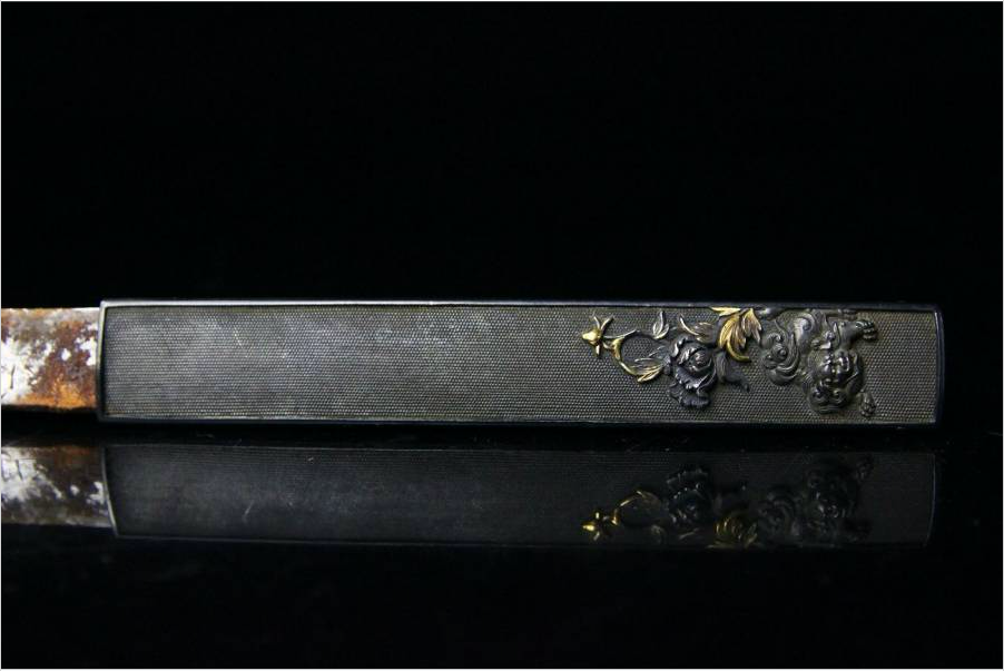

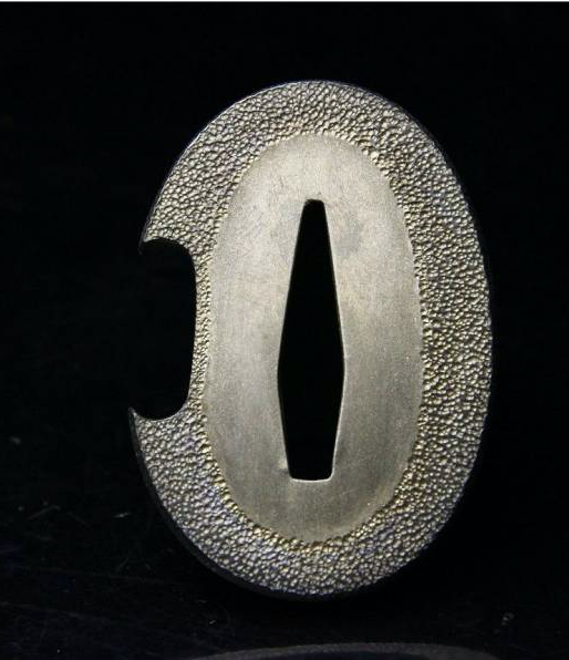

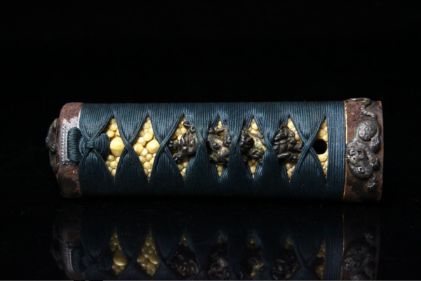

Surfson Posted July 14, 2020 Report Posted July 14, 2020 Hi All. Just requested some help with the signature on this piece and got a request to show photos, so I am doing so here, in case the tosogu section followers don't go to the translation page. This is an interesting wakizashi koshirae that I was moved to buy for several reasons. It has very nice mounts that appear to all be by the same hand. The fuchi and the kojiri are both signed Yasuhara Yoshinori and Yoshinori respectively (also Bijo - thanks to Steve for help with the translation), who is listed in Haynes as H12005.0. Haynes mentions his lineage, but I haven't had a chance to look into it more, so if any of you know about him or the line, please speak up. The fuchi-kashira are made in iron and some neglect has led to considerable surface rusting. I believe that this made it more affordable and gives me the chance to have some restoration done. I am open to suggestions as to who might be right for it. Since it is in Japan right now, somebody in Japan would be worth considering. I have the options to send it to Mishina San to use his collaborators or to Pablo Kunze, who I believe does this sort of thing. I have sent many items to Brian Tschernega, but he is very busy now. The seppa are also missing a few pieces of gold that I would like to have redone. The habaki appears likely to be solid gold to me, based on the depth of the carvings, though it may just have a very thick plate. The saya is quite interesting and I would love to hear what any of you may know about this style of work and how it is done. I assume that layering is involved and the layers are cut through, sort of like with guribori. The kozuka looks very good to my eye. I can't tell if it is likely to be Goto or not, but the nanako is perfectly geometrically placed, which is usually an indicator of top work in my experience. The kokatana is not shown, but has a very nice looking signature of Tamba no Kami Yoshimichi. It also has some surface rust. Any comments are appreciated. Cheers, Bob 6 Quote
Geraint Posted July 14, 2020 Report Posted July 14, 2020 Sweet! Thanks for sharing these, that's a lovely koshirae. Just look at the shittodome on the kashira. I think the first step is some careful work with a fragment of bone to clean off the worst of the fresh rust. All the best. Quote

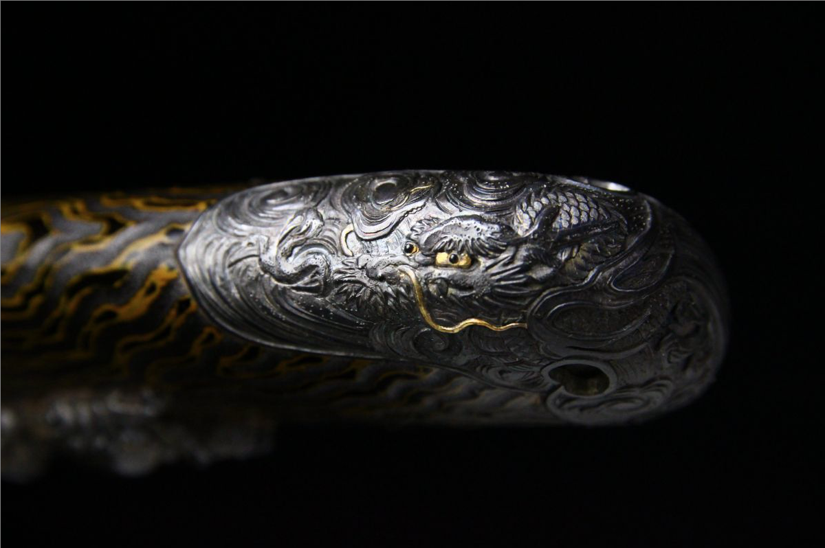

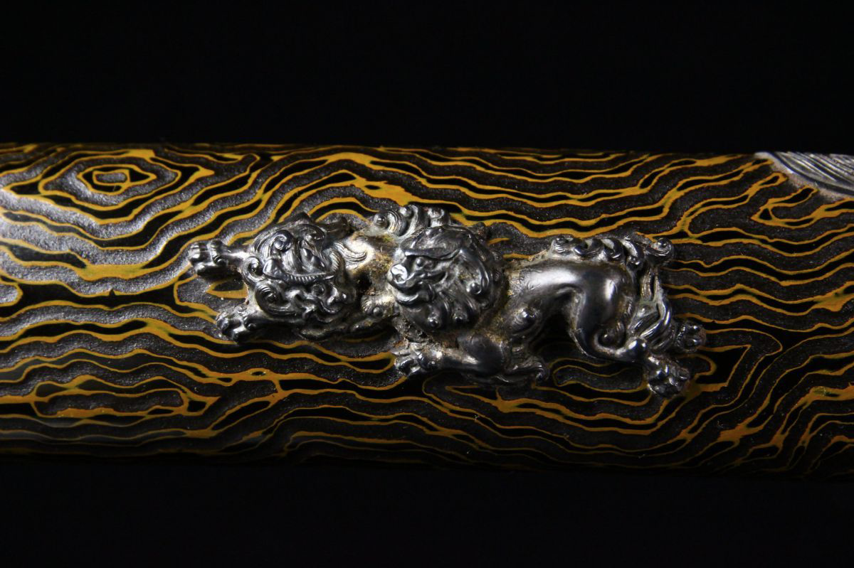

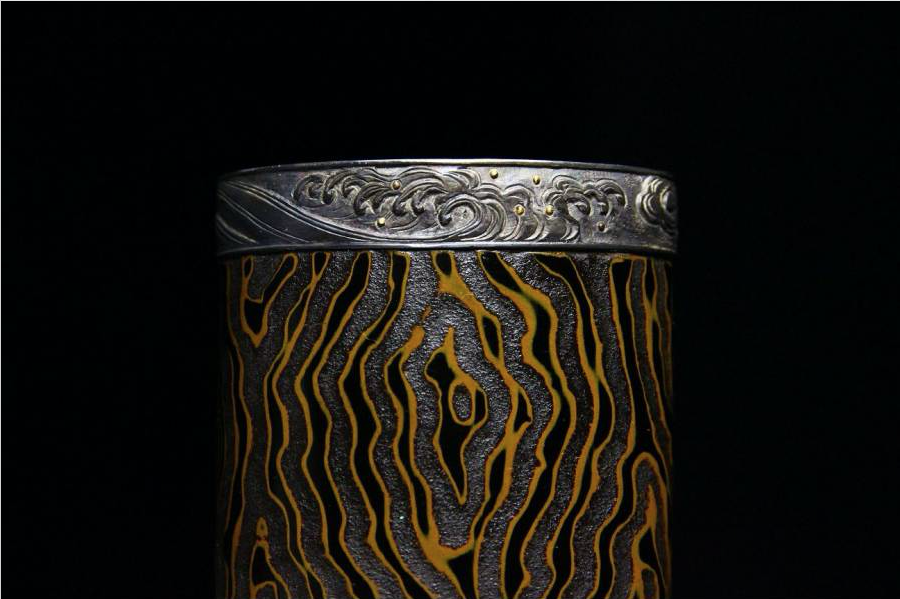

Fuuten Posted July 14, 2020 Report Posted July 14, 2020 Such a unique kind of lacquer ware finish too. I don't have anything in the 'oll digital archive like this (or at least not that i could find). Quote
Babu Posted July 14, 2020 Report Posted July 14, 2020 This technique appears to be to build up the profile of bark like ridges and in different colours of laquer then to shave back those ridges to achieve this effect. I wonder if it was first made to resemble bark of a tree then due to damages that were unavoidable this was not done as a sort of a saving grace repair. Quote
Ganko Posted July 14, 2020 Report Posted July 14, 2020 Very nice koshirae. I think the rust on the F/K will clean off fairly well, as Geraint says, a little work with sharp piece of bone will tell you more. The lacquer is a variant of Wakasa Nuri I believe, and very nicely done. Quote
thutson Posted July 14, 2020 Report Posted July 14, 2020 Beautiful koshirae, certainly worth restoring! That lacquer work is something else Quote

Surfson Posted July 14, 2020 Author Report Posted July 14, 2020 I like the Wakasa Nuri idea Tom. Here are some modern chopsticks using the technique. https://www.mrslinskitchen.com/11974.html Quote
Bazza Posted July 15, 2020 Report Posted July 15, 2020 Gents, lovely koshirae, very desirable IMHO. Now the rust. Long ago - decades in fact - the late lamented Alan Harvie while visiting Australia commented on an attempt of mine to remove rust from an iron tsuba. I had carefully picked away at the encrustation of rust with a de-tempered scalpel blade to remove as much as I could. This left pits where the rust had more severely bitten into the iron surface. Alan remonstrated with me saying that it would have been better to use the small flat of a bone (or ivory) with oil and gently abrade the surface until the rust was level with the original iron surface. This technique would therefore have left a smooth surface rather than a pitted one. Hopefully!! So, Robert, I would go with using an expert, of which there must be a few in Japan. And I would guess to do this restoration work at a professional level might cost as much as the koshirae??!! BaZZa. Quote

Ganko Posted July 15, 2020 Report Posted July 15, 2020 Robert, I recall reading some time ago that it is sometimes referred to as "idiots lacquer", since anyone would have to be crazy to spend the amount of time it takes to produce it. I like it. Great koshirae. On 7/14/2020 at 11:41 PM, Surfson said: I like the Wakasa Nuri idea Tom. Here are some modern chopsticks using the technique. https://www.mrslinskitchen.com/11974.html Quote
Surfson Posted July 15, 2020 Author Report Posted July 15, 2020 I will take some more shots of the habaki when it arrives Ken. I have another like it that is on a Yokoyama Bizen tanto - I think there is a thread with it somewhere. Also solid gold and deeply carved. Tom, that's an interesting name for it. Is that Japanese or a western name for a similarly complex western product? Bakana urushi? Quote
Ganko Posted July 15, 2020 Report Posted July 15, 2020 On 7/15/2020 at 3:27 AM, Surfson said: I will take some more shots of the habaki when it arrives Ken. I have another like it that is on a Yokoyama Bizen tanto - I think there is a thread with it somewhere. Also solid gold and deeply carved. Tom, that's an interesting name for it. Is that Japanese or a western name for a similarly complex western product? Bakana urushi? I believe it was from a Japanese site that was in English, it may have been "Kichigai nuri". I had a tachi kake that was done in that manner. 1 Quote
Yasaka Azuma Posted July 17, 2020 Report Posted July 17, 2020 I hate to say this, but I think that the sign of "義乗(yoshinori)" does not match the sign of "縁(fuchi)" and "鞘尻(sayajiri)". Yas.A 1 Quote
Surfson Posted July 17, 2020 Author Report Posted July 17, 2020 Yas, they both look like they were signed by the same hand. Are you saying that the translation is not Yasuhara Yoshinori (or Yasuhara Bijo)? http://www.militaria.co.za/nmb/topic/32632-mystery-name-on-nice-set-of-mounts/ If not, what is your translation? Quote
Yasaka Azuma Posted July 18, 2020 Report Posted July 18, 2020 Really? Maybe I've mistaken it for someone else. Both look great for me. Y.A Quote
Surfson Posted July 18, 2020 Author Report Posted July 18, 2020 Yas, I think that the character for Yoshi is this one: 美 Quote
