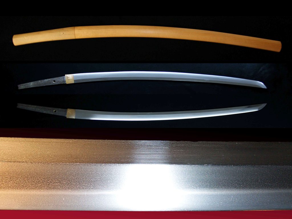

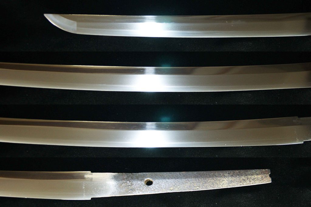

Marius Posted November 12, 2008 Author Report Posted November 12, 2008 Henry Wilson said: Are there any pictures? Hi Henry, here they are: http://cgi.ebay.com/ws/eBayISAPI.dll?Vi ... 0295904038 Quote
Marius Posted November 12, 2008 Author Report Posted November 12, 2008 mariuszk said: Henry Wilson said: Are there any pictures? Hi Henry, here they are: http://cgi.ebay.com/ws/eBayISAPI.dll?Vi ... 0295904038 Oh, just in case they disappear from eBay, attached they come... Quote

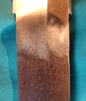

Stephen Posted November 12, 2008 Report Posted November 12, 2008 sorry for the late reply, here is a what a few sperts from Japan thought might be a koto nakago on a shinshinto or gendaito, ill try for a better pix but where it was joined is very hard to tell. Quote
Mark Green Posted November 12, 2008 Report Posted November 12, 2008 Mariuszk, I'm right there with you on the sword holdings. Allthough I have a few "gems", I have never paid more than 2000$ for a sword. I do know some polishers though, that helps. Now that I have blown up your pics, I still feel that your Nakago has been made to look older than the sword is. WHY???? Who knows, likely for money reasons. I have personaly seen more than a few 'newer' swords that have been cut down, then polished down thin, and the Nakago aged, so as to look Koto to those that don't know any better, and sometimes to those that should know better. A sensei told me it was called "suriaged", he had seen it a lot. I don't feel the hole in the back of your sword was fake. I think it may have been a 2nd hole, these are not uncommon in late period blades. It just made it easy for the fakers, or was simply cut off to put it in new mounts. I was told once that it became common practice with the 'gun slinger' Samurai of the Edo period. Just in case one of your Mekugi failed, your sword wouldn't come flying out of the handle. Made sense to me. Also common in ww2 era swords, for the same reason. I think for the price, you got a great sword. The boshi is good, and it has no flaws that I could see in the pics, and the polish is not that far off. Just enjoy it for what it is. That is what this obsession is all about. Mark G Quote

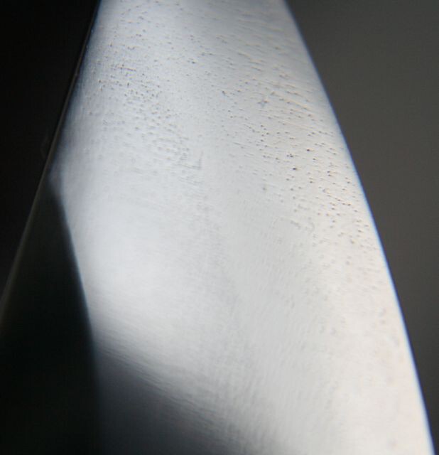

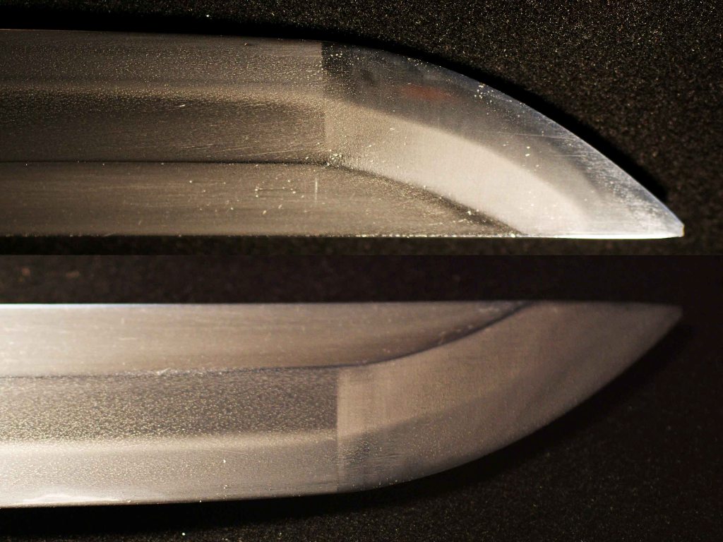

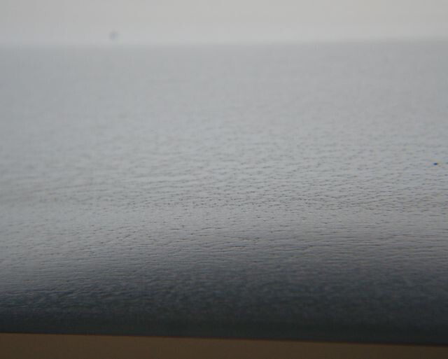

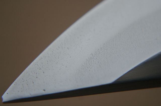

Marius Posted November 13, 2008 Author Report Posted November 13, 2008 Mark, Ed, many thanks for your comments. I shall read Kanzan Sato's information on welded nakago. I have taken some close ups of the boshi and the hada and hamon. It looks like the boshi is yakizume and the nioi deki hamon has a tight nioiguchi (at leat to me). Hada is nashiji-like. Might be a Hizen sword, were not for the yakizume. Still a puzzle, isn't it? thanks again :-) Quote
Grey Doffin Posted November 13, 2008 Report Posted November 13, 2008 To answer the original question: what does a welded on nakago look like? Sometimes it is tricky to spot the repair; you have to look close. With careful examination of the attached picture you should be able to see where the weld was done. Grey Quote
Brian Posted November 13, 2008 Report Posted November 13, 2008 Is that a little of Pete Klein's and Guido's sense of humour slipping in there Grey? :lol: Brian Quote
Ted Tenold Posted November 13, 2008 Report Posted November 13, 2008 I *think* I can juust make it out. As a guy that was trained and worked in welding/brazing for a few years I gotta say that whoever did that weld was absolutely attrocious. Jeez, I hope they're not putting ships or buildings together. Quote
dkirkpatrick Posted November 13, 2008 Report Posted November 13, 2008 Nice weld indeed! Something that makes me wonder if perhaps the point is moot with regard to the Yamashiro sword is that it would appear to me that the hamon rounds off the nakago past the hamachi making me wonder if the blade is perhaps saiba. That and the nioiguchi seems to be unusually thin and "lifeless". A fire might explain the some of the nakago distortion. I considered that maybe the blade wasn't o-suriage but only slightly suriage with multiple ana but at 66cm it would seem unlikely for the purported jidai. Perhaps a better pic of the hamachi might clarify this (not so close this time! :D )Just my musings! Doug Quote
