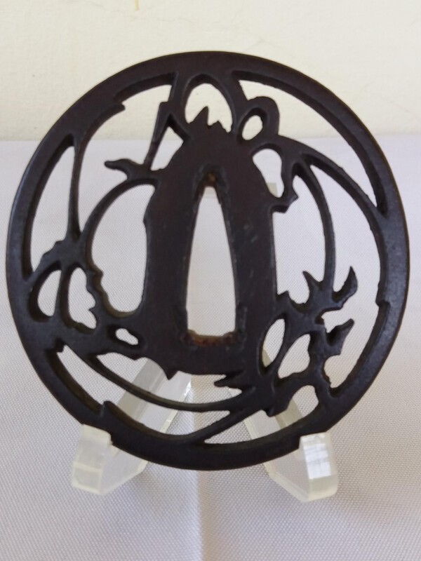

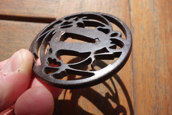

Yasaka Azuma Posted July 13, 2020 Report Posted July 13, 2020 I was watching Bruno's uploaded tsuba side by side. If I could buy an item like this for 90 euros, it would be fun. Both photos seem to be artificial light sources, but the rust color looks quite different even though they are the same tsuba. His images show the difficulty of identifying iron tsuba online. The importance of picking up the real thing cannot be overemphasized. Yas 2 Quote
Kurikata Posted July 13, 2020 Report Posted July 13, 2020 Yas, you are perfectly right. Depending the angle, the kind of light (natural, artificial) and I would say even my mood ... tsuba color might change. These one probably represent an approach to the real (natural light) color. 1 Quote
Yasaka Azuma Posted July 13, 2020 Report Posted July 13, 2020 On 7/13/2020 at 12:16 PM, Kurikata said: Yas, you are perfectly right. Depending the angle, the kind of light (natural, artificial) and I would say even my mood ... tsuba color might change. These one probably represent an approach to the real (natural light) color. Thank you for your reply,Bruno. The norm that many collectors already know is that iron tsuba must be confirmed in direct sunlight. The images I uploaded were sent by a friend. Both are popular edition, and were taken in direct sunlight. A friend tells me it is Akasaka Tsuba and Higo Tsuba, but anyway, I can see that the two have distinctly different rust colors. The tsuba on the right has a rust color like coal, which is known as "purple rust." These differences in rust color indicate different iron qualities or schools. For reference only. Yas Quote
Yasaka Azuma Posted July 13, 2020 Report Posted July 13, 2020 Do you own a standard work to compare with the new tsuba, in this case a certain Akasaka Tsuba? Nearest is your own eye. I'm just behind the monitor. Yas Quote
Japan2112 Posted July 13, 2020 Report Posted July 13, 2020 Those direct sun images are great. The tsuba looks entirely different Quote
