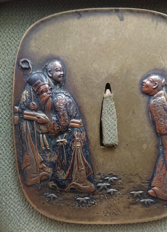

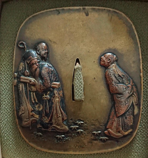

Babu Posted June 20, 2020 Report Posted June 20, 2020 Hi I'm trying to work out the theme as the title suggests. This is a copper tsuba 80x90x4mm Is it the tree poets? Seems to be designed for collecting rather than mounting but it could be I'm wrong. Is it perhaps the poet Sogi (1421-1502) and his major disciples Botanka Shohaku (1443-1527) and Saiokuken Socho (1448-1532) who composed one of the most famous of all renga to honor the memory of Emperor Go-toba (1180-1239), whose spring tanka written at Minase (the site of his detached palace) served as their initial inspiration. Any thoughts? Thank you Adam Quote

Furin Kazan Posted June 20, 2020 Report Posted June 20, 2020 There head wear, and clothes look very Song dynasty Chinese 1 Quote
Yasaka Azuma Posted June 21, 2020 Report Posted June 21, 2020 It may be "李白観瀑図" rihaku-kanbakuzu. http://blog.goo.ne.jp/tsuba_001/e/b9644a1a9f2a20dbc3a78a8704dd0d1f Yas 3 Quote

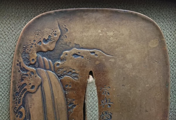

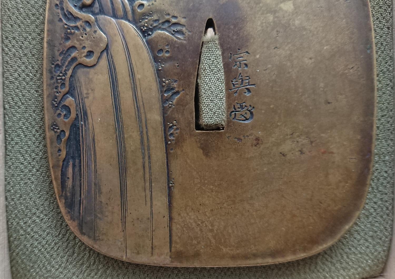

peterd Posted June 21, 2020 Report Posted June 21, 2020 Nice tsuba. Kao does not seem to match mei. Quote
Babu Posted June 22, 2020 Author Report Posted June 22, 2020 Thank you Yas I think that's exactly what the theme is.???? Peter I'm not sure that the mei is meant to emulate Yakoya Soyo. I've seen a few gimei and they do try to copy his style of signature. This seems to be a proud artisan with confident hand signing in his own name and Kao (A different Soyo perhaps ) . Or the Soyo may be an honorary attribute "nod in the direction of“and the Kao is the artists stamp. Even the style is not traditional yakoya Soyo. Can there be a way to identify the Kao? Any thoughts? I believe It's quite reasonable skill level. There's some detail in hand not visualised in the photos like the waterfall spray is tiny gold flecks .thank you Quote

MauroP Posted July 1, 2020 Report Posted July 1, 2020 I think the theme could be Kokei sanshō - 虎渓三笑 The three men in this case would be Huiyuan, Tao Yuanming and Lu Xiujing. Quote
Babu Posted July 1, 2020 Author Report Posted July 1, 2020 Yes I can see this also. I think its a Very good call as well. Thank you for finding this. Adam Quote
