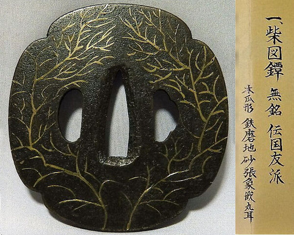

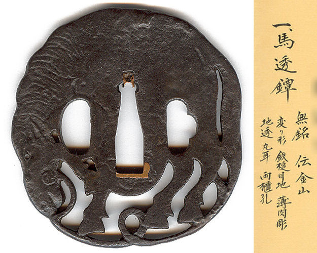

MauroP Posted June 20, 2020 Report Posted June 20, 2020 Just my perception, but I'm less positive about the "den" prefix. To me the true meaning is something like: "we do not really know, but the item has something resembling...". As far as I see it is a big manifestation of intellectual honesty (I do prefer an admission of uncertainty rather than a questionable affirmative attribution). Here below some examples: den tōshō: Amida-yasuri is not a feature typical for plain tōshō styleden Kanayama: here simply I can't understand why Kanayama school rather than whatever elseden Kanayama: nikubori carving surely not typical of Kanayama styleden Kunitomo-ha: just to remark the different meaning of "den" and "ha" (school) 1 Quote
