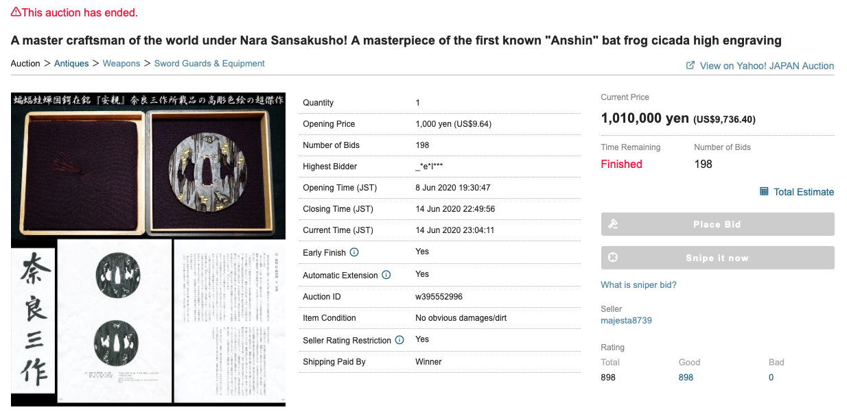

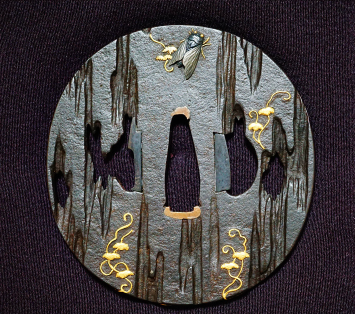

I was very interested in this tsuba, which was pictured prominently in the Nara Sansaku, a book featuring three great Nara artists including Yasuchika.  My feeble bid was overrun very quickly, even though the tsuba had no papers.  I would love to hear what the cognoscenti on the board think about this piece, which apparently is somewhat unusual in style for Yasuchika.
https://buyee.jp/item/yahoo/auction/w395552996
I am attaching some photos since these links have a very short shelf life.  They include the pages from the Nara Sansaku as well.

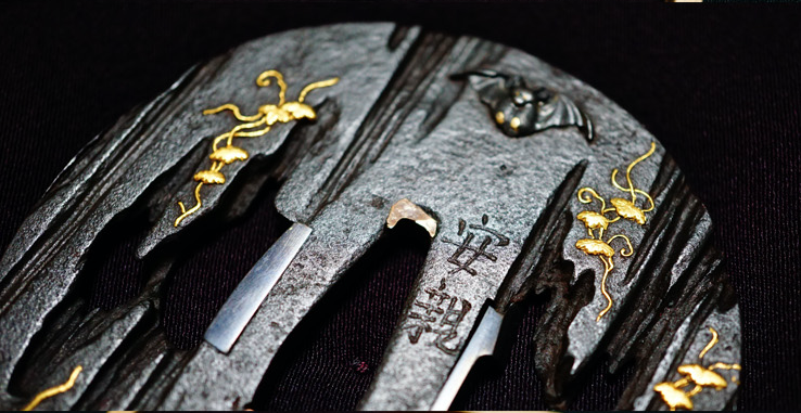

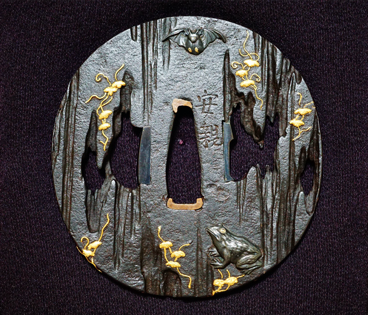

I love the work.
My interpretation is that the bat is eyeing the frog (maybe thinking about dinner) and I guess the frog is eyeing the cicada for the same reason.  The patina of the iron and the quality of the floral and animal inlays are first rate to my eye.
Obviously Yoneno, who wrote that book, thought enough of it to feature it prominently in his important book.
Frankly, Yoneno's views about it are likely to be more valid than those of a shinsa team that haven't spent their life studying this particular maker.  Had I gotten it, I wouldn't have bothered to submit it for this reason.
I'm not sure if Yoneno is still alive, but if so, perhaps you can debate it with him Brian!  Or as Mr. Klein says, "way bother"?

My friend also told me that the going rate for authentic shodai Yasuchika is $12,000-15,000, and some fine pieces have reached many fold that amount, so $10,000 seems to indicate that the market (in this case bidders on the tsuba) thinks that this piece is correct.  Of course the market can be wrong, sometimes dramatically so.

I'm sorry to hear that none of you like the design of this tsuba nearly as much as I do, but I guess because of that I'm glad that I don't own it and have to face the eventual prospect of selling it!  I think it really gives the impression of being in a cave and maybe that isn't very appealing.
