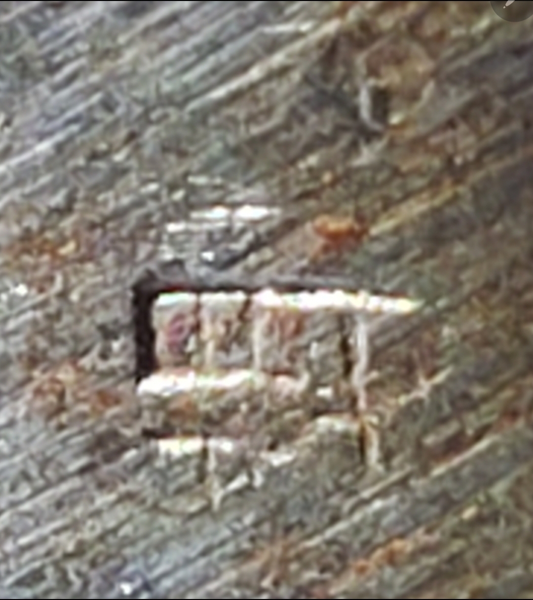

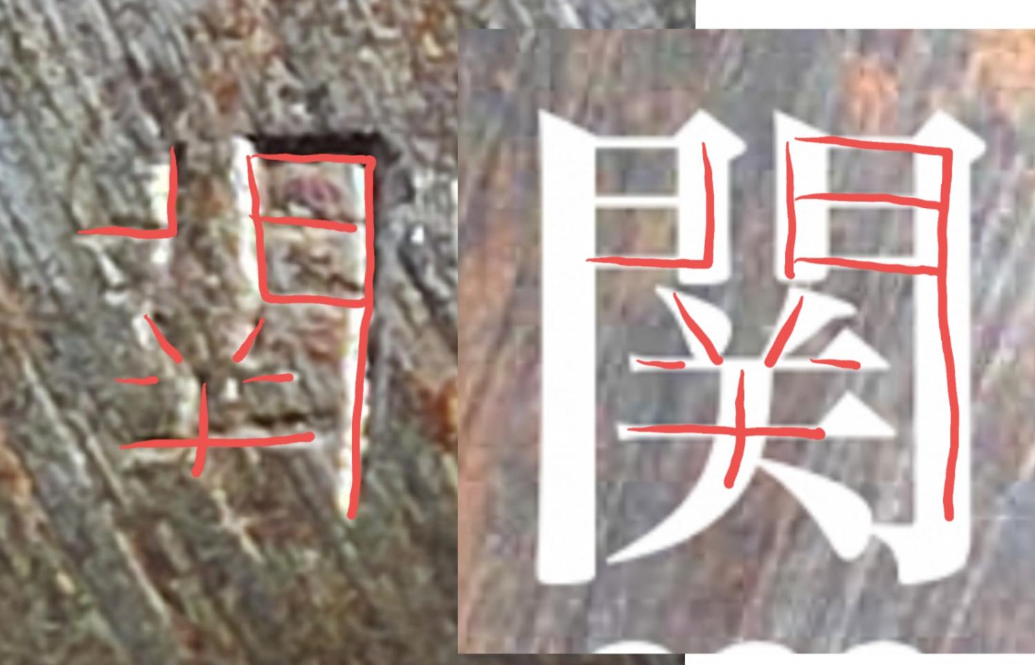

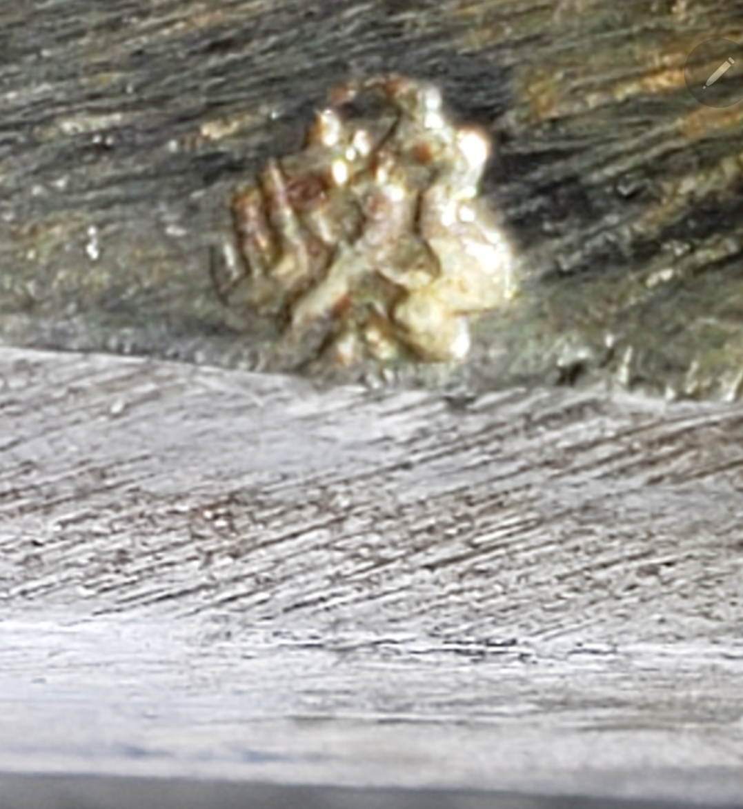

Is this a hiromitsu August 1945 gifu stamp, Ren Nanman Arsenal Dalian Factory stamp and maybe a 2nd gifu or cherrybloosm stamp?

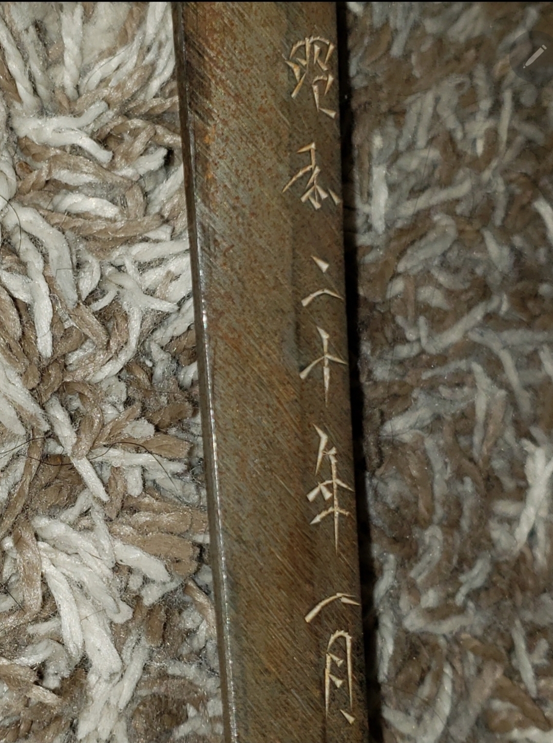

Hello every1. I'm new here, I've had 2 ww2 vintage swords that I have been trying to decifer. I have had some help but not a 100% assured hit. I have 1 that is unsigned and was told that it might be a koto or shinshinto. The 2nd sword is why I'm here. I have, from what I was told and doing my own research on the mitsu and stamps, a August 1945 hiromitsu, but I dont find the signature anywhere to match, the mitsu is a definite. The Hiro is the problem. It also has 3 stamps. One is definitely a gifu (gi) stamp the other 2 are what I think, and correct me if I'm wrong... one stamp is a Ren- Nanman Arsenal Dalion Factory, and 3red I think is another gift stamp or cherryblossom tree... I'm leaning more to figure. I would really appreciate if anyone's expertise, considering that I am only a novice. I will place pics on the next posting

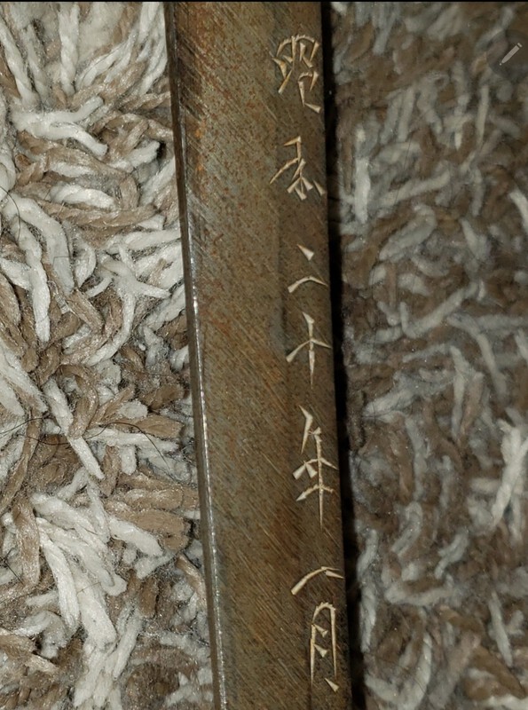

The sword is dated January 1945.  One of the inspection marks looks like a Seki stamp.  In the picture, it is rotated to the left.  A small Seki stamp is often found along with a 岐 Gi stamp.

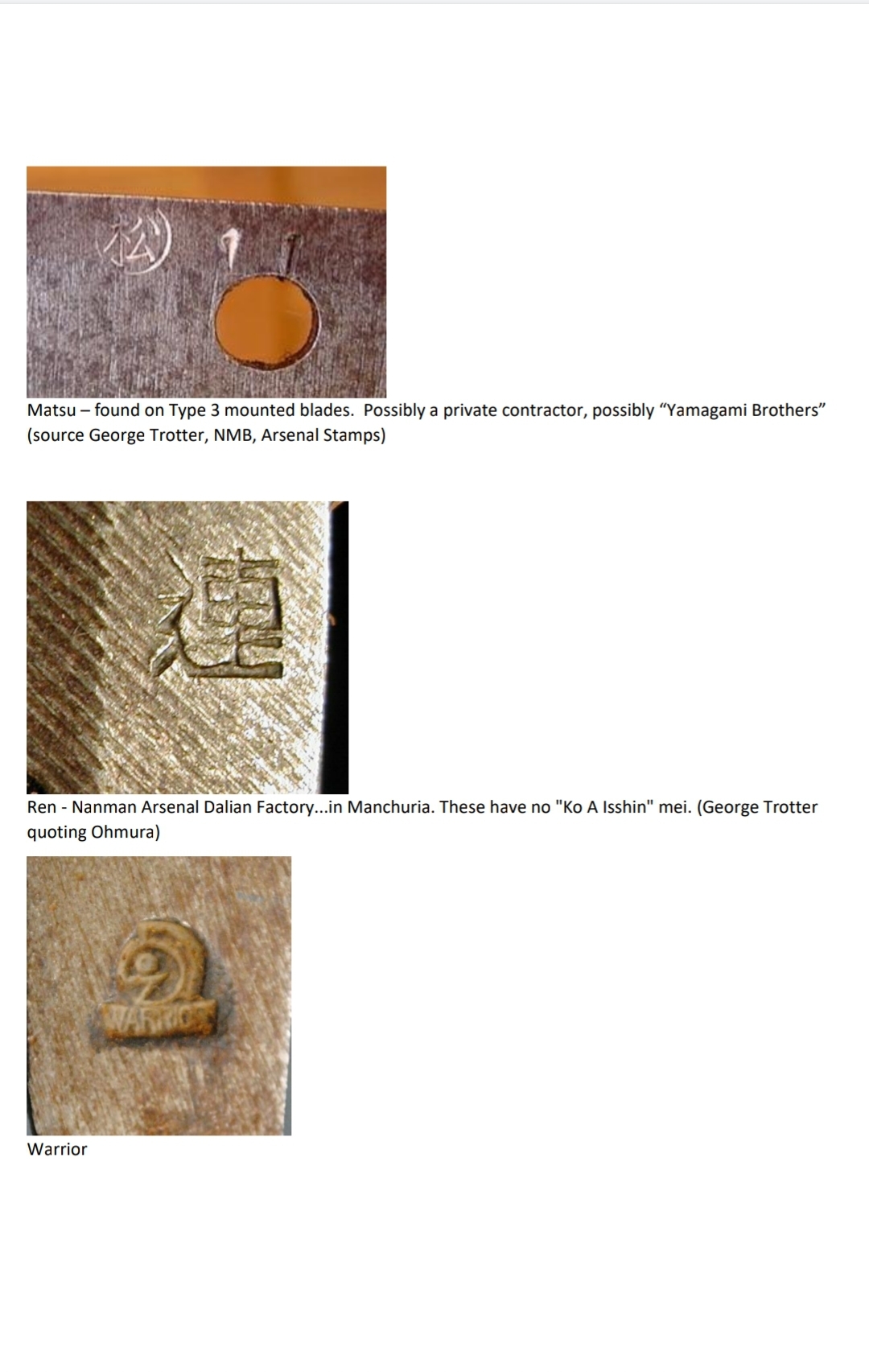

Thank you Ray and Kiipu. The January has a an extra mark to it, maybe a error when etched? The seki stamp I'm leaning to Ren - Nanman Arsenal Delian Factory. From what I read, it was made if Manchuria, if a sword has that stamp. If so, does this make it rare? Is it rare for a tang to have these 3 stamps?post-5362-0-45545000-1591912266_thumb.jpg
It is a SHO stamp + a SEKI stamp.

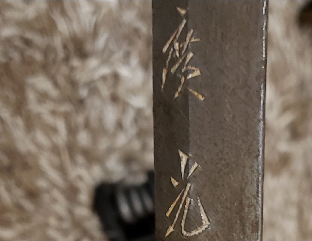

Hiromitsu with an almost identical MITSU and a variation on the execution of the HIRO kanji: http://www.japaneseswordindex.com/oshigata/hiromit2.jpg

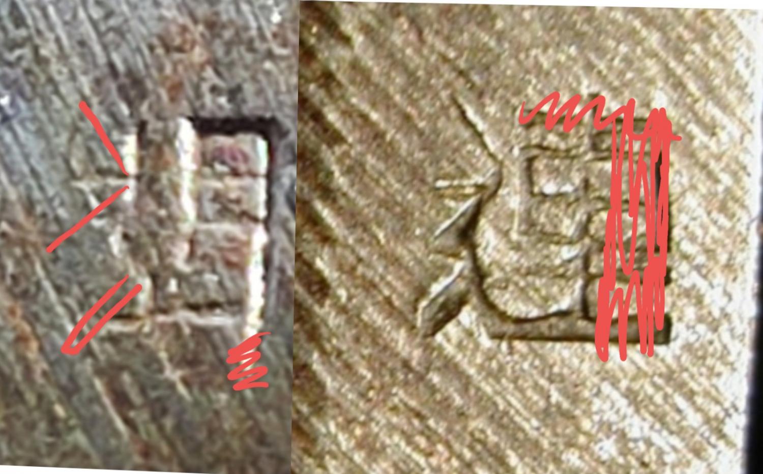

My stamp and sreenshot of what I found online from a bookpost-5362-0-22371700-1591912387_thumb.jpgpost-5362-0-11961000-1591912410_thumb.jpg
The stamp is a partially struck Seki. Here is what you are seeing:
For it to be a Ren, you'd have to be missing half of the right side (which, ok, poorly struck stamps are missing stuff), but you also have to have the indicated marks at the right diagonal angles.
PS: I'm the guy that compiled that "book" you referenced! Ha!
  • Like 4

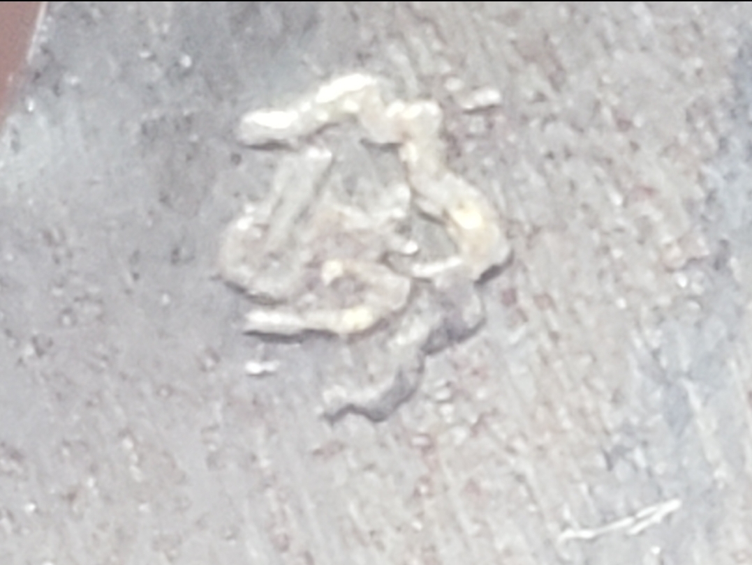

Hey Bruce... lol, yes I understand. I will post the pictures of the January 1945 Hiromitsu 1 seki stamp and 2 gifu stamps.

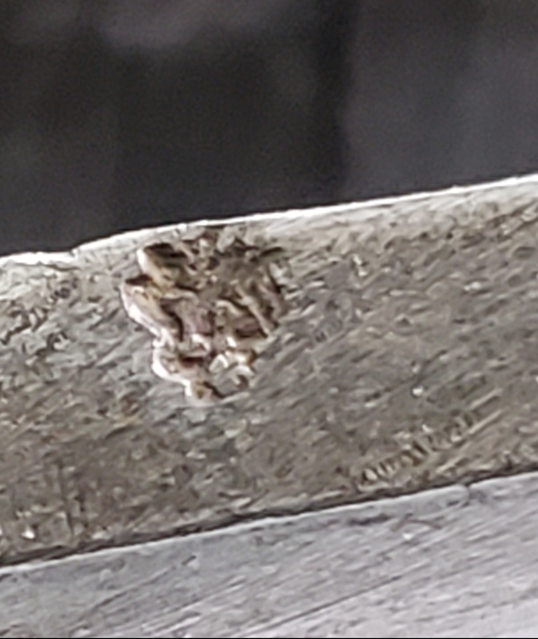

Thanks for the pics Robinson. The hamon is quite faint and hard to see. The Nihonto guys can correct me if wrong, but I believe this to be an oil-quenched, non-traditionally made blade (like the vast majority of WWII blades). The two holes in the nakago indicate this was made for the Rinji-seishiki (Type 3) fittings.
The multiple stamps are not unheard of on showato, though not the norm, but I agree yours having both the Seki and Gifu stamps put it in the "scarce" or "rare" category.
