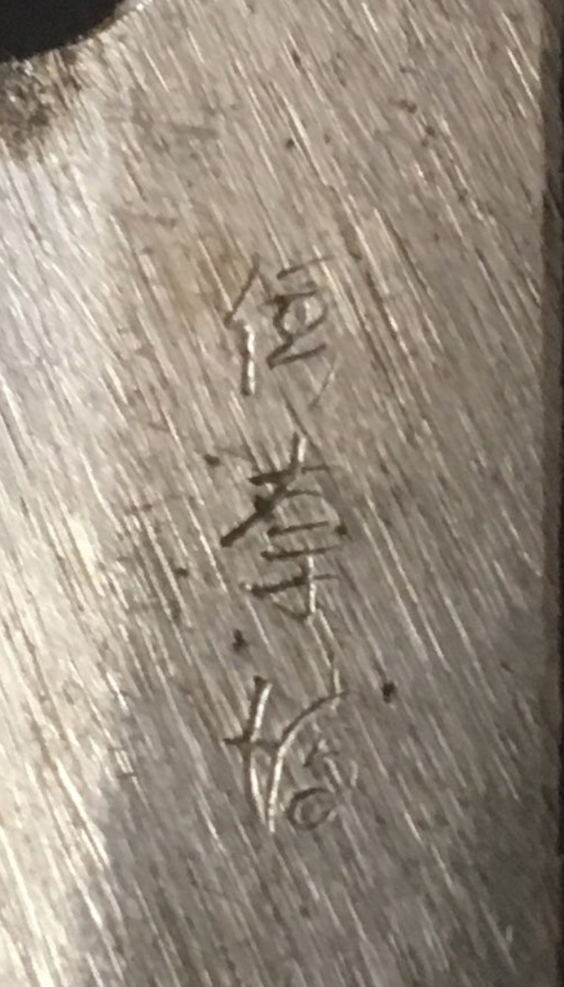

Jean,
Hate to say this as you might think I'm trying to teach you how to suck eggs, BUT, if one opens the photo and presses Ctrl  + it enlarges the given image.  I've done this quite successfully with this image and off-hand even so I can't read (i.e., translate) it...
BaZZa.
EDIT: Bruce, better, but it needs to be clearer as well!!!

Just a follow-up - after searching several of these, I'm quite comfortable that this is in fact Inaba. It's in the "cursive", and that's why it's harder to see.
Neil (IJASWORDS) sent me a clear picture.
Hi,
Maybe it says Inaba 伊奈波 .
But it's very unskillful characters.
Thank you Morita-san. Very small, and shallow too. I don't have enough examples of these blades, made as souvenirs after the war, to compare mei, but this isn't up to the normal appearance of Tenzoshan mei on the blades made during the war.
