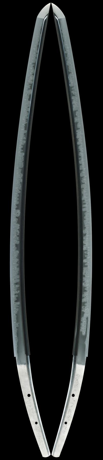

16k Posted June 4, 2020 Report Posted June 4, 2020 No words... just look and weep for not being able to afford it... https://www.touken-matsumoto.jp/eng/product_details_e.php?prod_no=KA-0278 7 Quote
Oshy Posted June 4, 2020 Report Posted June 4, 2020 Classic Ono, his Yamadorige utushi-mono stands by itself 1 Quote
Tom Darling Posted June 4, 2020 Report Posted June 4, 2020 Very nice, except, not a good sword for battle. Tom D. 2 Quote
Ken-Hawaii Posted June 5, 2020 Report Posted June 5, 2020 No, I draw a 30.5-inch blade in iaijutsu, so that extra 0.6" is manageable. It's the $60K that isn't! Beautiful blade, JP. 3 Quote

PNSSHOGUN Posted June 5, 2020 Report Posted June 5, 2020 I think Tom was referring to the large Hamon area creating a brittle sword. 3 Quote
16k Posted June 5, 2020 Author Report Posted June 5, 2020 Yes, I think he was. I think this type of Hamon was abandoned because the hardened area was so large it was more brittle than, say, hoso Suguha. Quote
