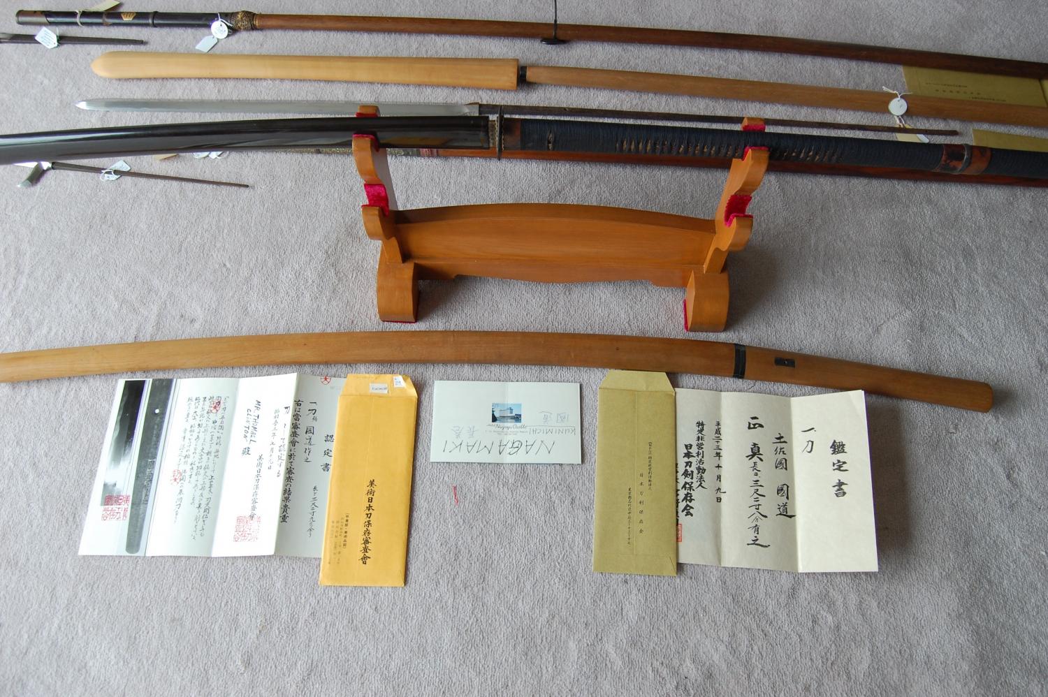

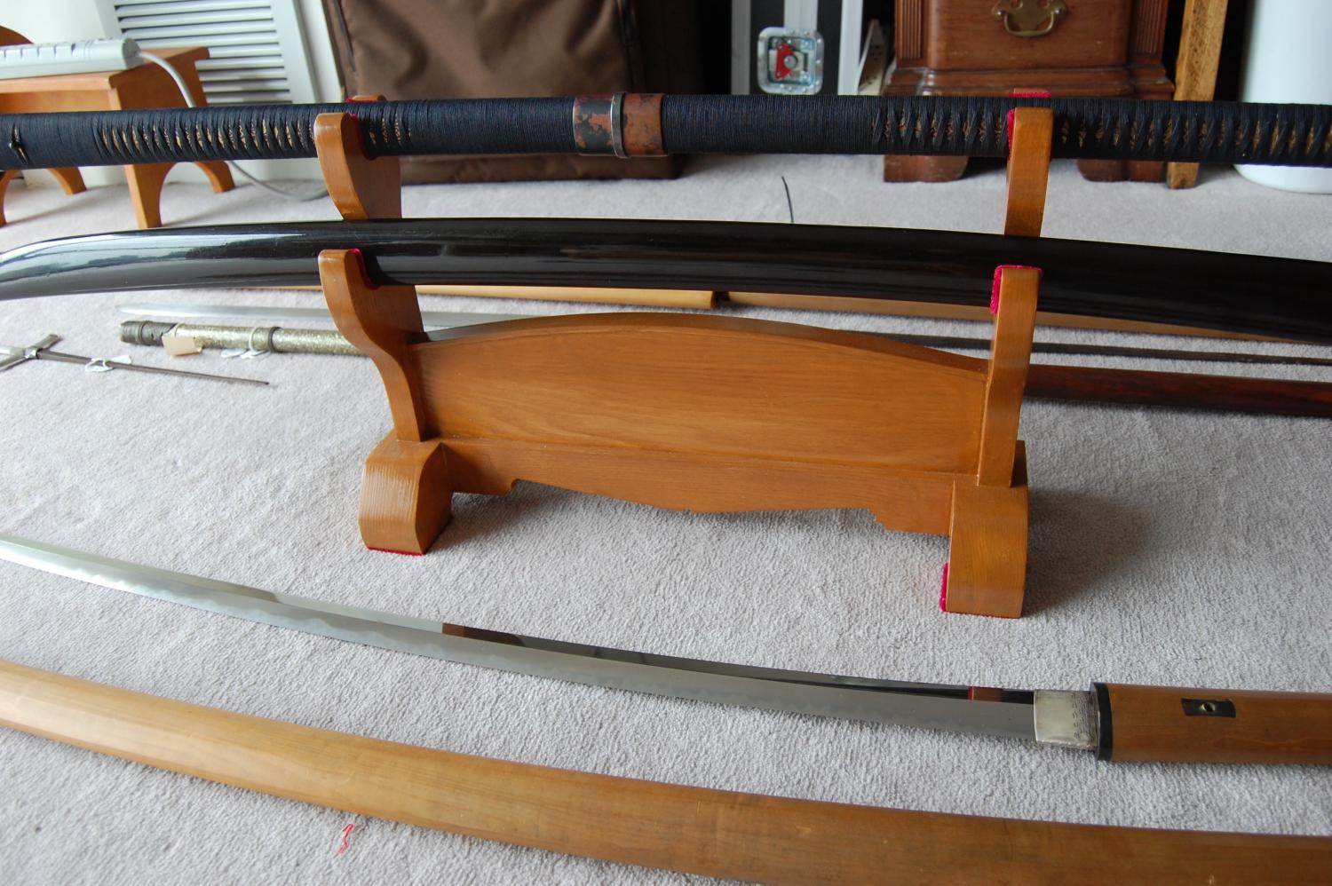

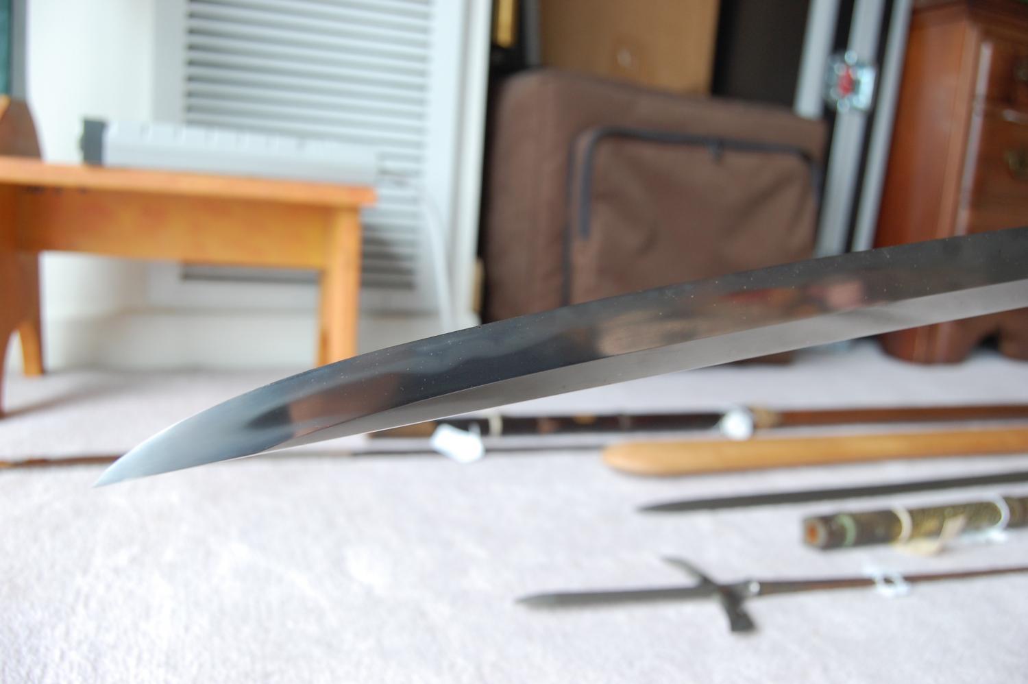

While we are on the subject, I once owned an O-Nagamaki (and several other pole arms) that I basically had to buy as part of a whole collection.  It was quite nice, very long, fully mounted and in full polish.  Unfortunately, it needed room to run and exercise, which it couldn't get in my small apartment.  Here are a few photos.

It was hard to draw it, though I have long arms and if I held it right near the tsuba and held the saya at the same spot, I could just do it.   Ignore the other pole arms in the background.
  That was must buy collection,  very nice!  Do you still own any of the collection Rob?
There's an art to drawing a sword, called sayabiki. In essence, you draw the blade as far as you can, without changing your balance, & then pull the saya off the kissaki, freeing the blade for nukitsuke, while keeping your left hand on your obi.
Sounds hard, but isn't.
The problem with this one Ken was that it was so long that my arm had to be completely outstretched to get the saya off the kissaki.  I have a 75" reach but could only barely make it.  I think that the blade is around 40" long on that one.
Hi Bob.  Yes, I kept a gorgeous shimada yari with Kanzan Sato sayagaki and a kikuchi yari that is still intact and was never made into a tanto, which is the fate that many or even most kikuchi yari befell.  Neither of them had koshirae other than shirasaya and both were fairly modest in length, so that they fit easily into my safe.  All the ones in the photos are gone.
