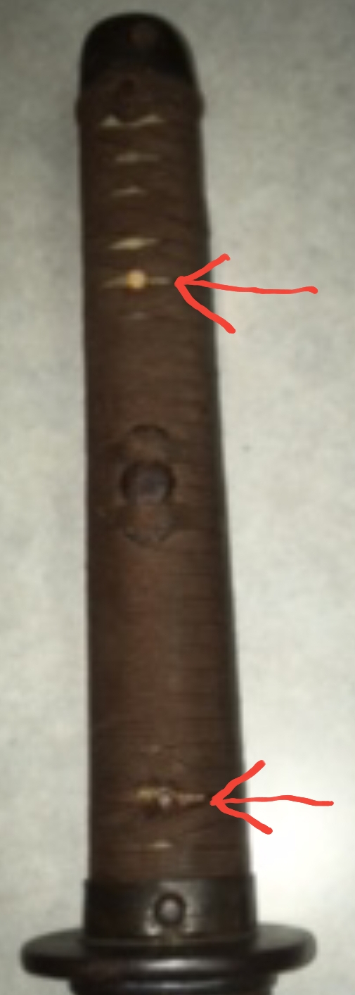

Bruce Pennington Posted May 31, 2020 Report Posted May 31, 2020 Hi Jeff, You've got a Contingency Model of the officer Type 98 gunto. Often refered to by collectors as the Type 3. You will lately see more and more calling it the Rinji-seishiki model (which is simply the Japanese words for contengency, or temporary, model). Long intro, but this wasn't an "official" model or Type. It was designed to test simpler fittings that could withstand the rigors of combat a bit better than the standard Type 98 fittings. It was also intended to be cheaper. Officers had to buy their own swords. Like Chris said, the ito (wrap) has shifted and covered the holes. I've attached a photo of one of mine so you can see where to look. It won't hurt anything to lightly move the wrap up and down, here and there, till you find them. Most Rinji models used a metal screw in the hole nearest the tsuba and a mekugi in the upper hole. I'm sure I speak for everyone here - PLEASE give us some full pics of the nakago (both sides) and blade! We have addictions that need their fix and the forum has been a bit slow lately. I've been starting to get the shakes! {Note to Brian - this could move to the Military forum} 7 Quote

Bruce Pennington Posted May 31, 2020 Report Posted May 31, 2020 Well now ....... after seeing the close-ups of the ito, it doesn't look like it was ever held/carried. I'm starting to think this tsuka was a Type 98, and someone has started to covert it to a Rinji tsuka, and they didn't finish the job. I'm thinking the wrap-job is just a Bubba-job. 1 Quote

Dave R Posted June 1, 2020 Report Posted June 1, 2020 On 5/31/2020 at 10:53 PM, Bruce Pennington said: Well now ....... after seeing the close-ups of the ito, it doesn't look like it was ever held/carried. I'm starting to think this tsuka was a Type 98, and someone has started to covert it to a Rinji tsuka, and they didn't finish the job. I'm thinking the wrap-job is just a Bubba-job. I think you may very well be right. The metal parts are OK, so I think we are looking at an abandoned repair using new wood and Same. There might be holes under the Same and given the state of the Ito it might as well be stripped off so we can get a better look at what is there. Quote
