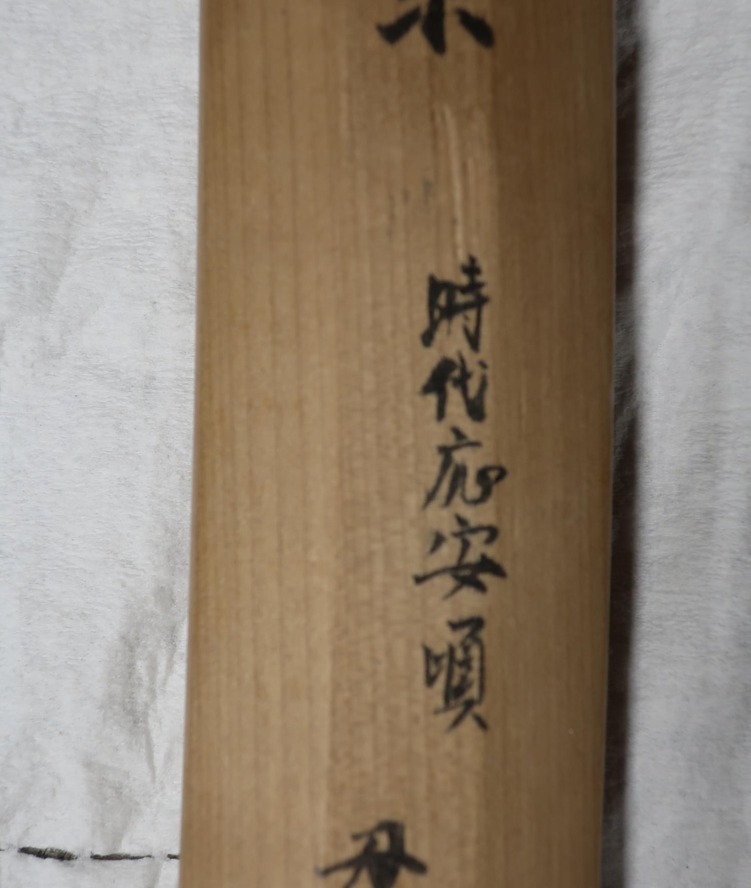

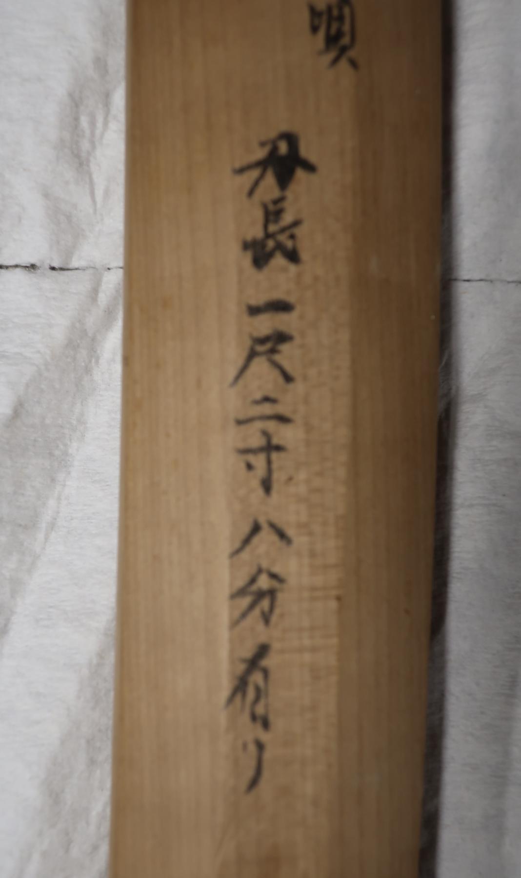

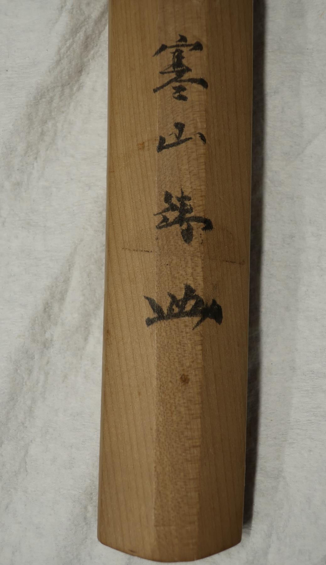

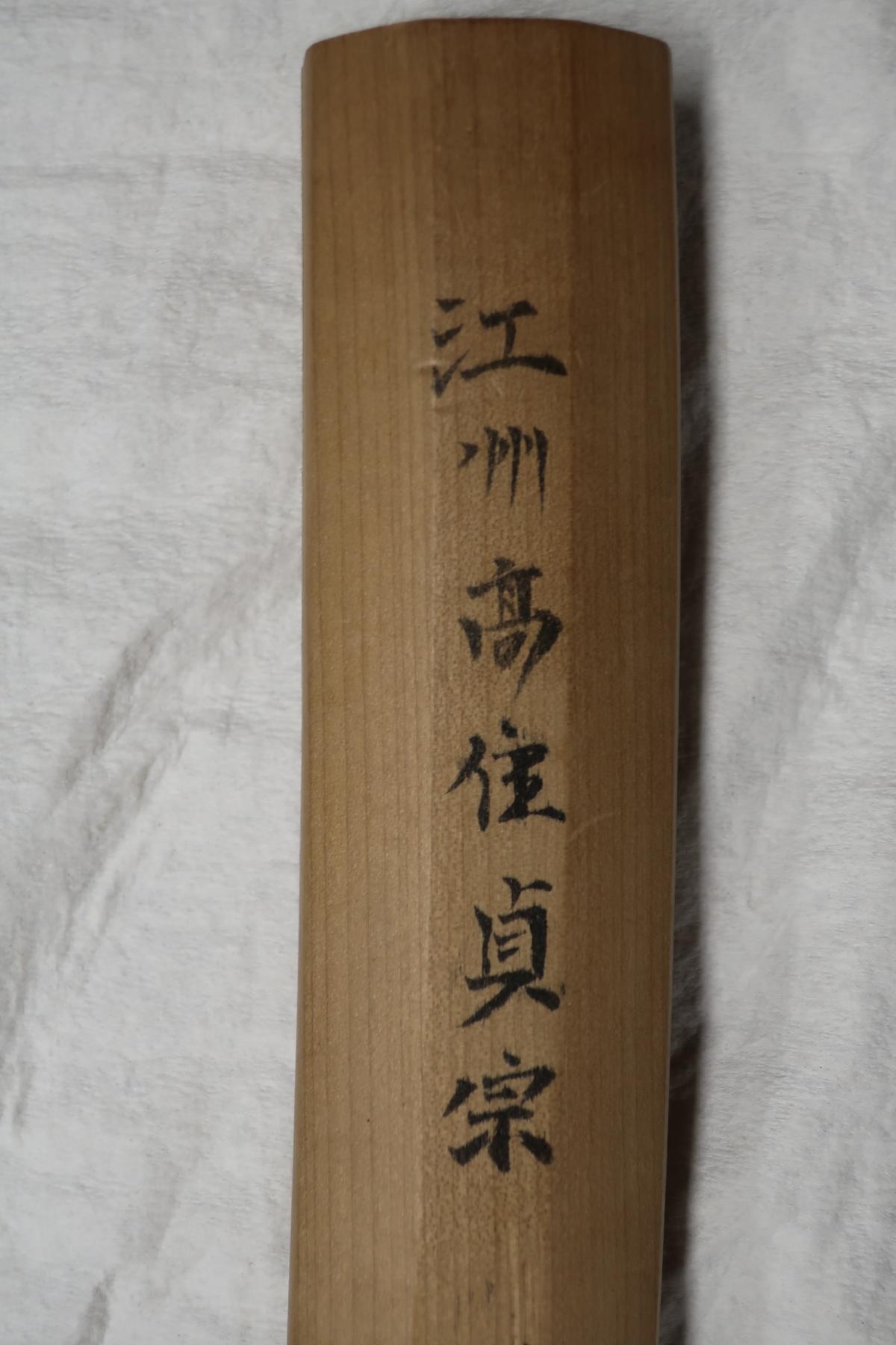

jt nesbitt Posted May 29, 2020 Report Posted May 29, 2020 Hey Fellas- Here's a quickie for you...I am having trouble with the calligraphy. I broke it down into 4 sections, What do you read in each of the sections- by individual kanji? Thanks --- JT Nesbitt Quote
Ray Singer Posted May 29, 2020 Report Posted May 29, 2020 Attribution is to 江州高[木]住貞宗 - Gōshū Takagi Sadamune. Time period is 応安 - Ōan (1368) Length (nagasa) is 1 shaku 2 sun 8 bu. The individual's name is Kanzan + KAO (ie. signed with the name used by Sato Kanzan) 3 Quote
jt nesbitt Posted May 29, 2020 Author Report Posted May 29, 2020 Ray- You are consistently on it here! Thank you for your reply -Sorry for the double post, I can't figure out how I double clicked the "post" button or how to take it down! OK - so back to the sayagaki- what if I told you that I had a suspicion of "enhancement" to the calligraphy? Take a close look at the last three characters of the first photo. What do you think? How difficult would it be to sand off the ink from the saya and replace? Does the ink that Sato Kanzan used penetrate and deeply stain the wood of a shirasaya? -- JT 1 Quote
Ray Singer Posted May 29, 2020 Report Posted May 29, 2020 It is certainly possible for sayagaki to be manipulated and I have seen examples where some part of the attribution was changed. This usually leaves a color difference to the appearance of the wood which I am not seeing in your photos. There are also many sayagaki which are not authentic examples from Kanzan, his is a frequent target for fake sayagaki. 1 Quote
jt nesbitt Posted May 29, 2020 Author Report Posted May 29, 2020 Ray - I am 100% sure that the shirasaya was made for the blade that it is housed in. I am pretty sure that the Kanzan signature is legit. A little "iffy" on the Sadamune. If the ink used stains the wood to a depth that would take real sanding and removal of lots of wood, then I think I have a legit signature that somebody went over and "highlighted". Your thoughts? -- JT Quote
Ray Singer Posted May 29, 2020 Report Posted May 29, 2020 JT, from what I can see in the photo I believe that every part of the sayagaki is contemporary with itself (ie. no parts enhanced or changed later). With that I am not saying that it is an authentic Kanzan sayagaki, but I don't believe that it has been modified. I'd also like to add that the attribution, the jidai (time period) and the length all align. Ie. the length is what you might expect from a Takagi Sadamune ko-wakizashi and this is a smith who worked in the Nanbokucho period. Quote

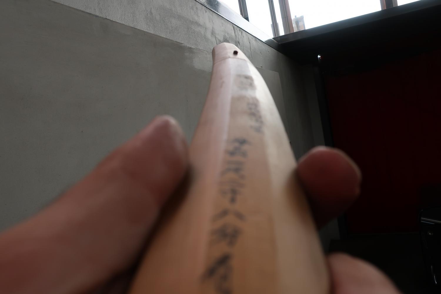

jt nesbitt Posted May 30, 2020 Author Report Posted May 30, 2020 Mystery solved (i think)- If the saya is held to the light just so, a different texture emerges around the suspect Kanji. The Maker and the date have been VERY cleverly modified. I am impressed with the quality of the forgery. What an interesting thing to have in my collection! A real teaching moment don't you think? --- JT 1 Quote
jt nesbitt Posted May 30, 2020 Author Report Posted May 30, 2020 PS- The camera is out of focus on purpose. The altered texture almost doesn't register when focused on it, becoming more apparent when it is out of focus and become more of a "zone" of different texture. --- JT Quote
