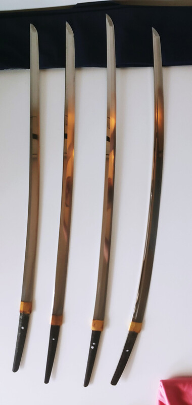

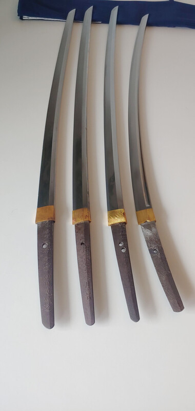

Bryce Posted January 2, 2023 Report Posted January 2, 2023 G'day Guys, Gassan Sadakatsu was very consistent in the blades he produced, but his style did change over time. Below is a photo showing three blades dated from top to bottom - 1921, 1940 and 1943. (Thank you to AOIJapan for the images.) His earlier blades produced in the Taisho period tend to be slimmer, shorter and straighter than his Showa period examples. Tsurata san has the theory this was because many were used as parade sabres. They usually have a nagasa in the range of 64-68cm, with a sori of 1.4 - 1.7cm and a kissaki around 2.5cm. Many are done in Bizen den. In contrast his Showa period examples usually have a nagasa of 67 - 70cm, sori of 1.8 - 2.2cm and a 3.0cm kissaki. The majority are done in ayasugi and masame. All of the 1943 dated examples I have seen are similar, but have a slightly longer kissaki around 3.5cm. Cheers, Bryce Quote
John C Posted January 2, 2023 Report Posted January 2, 2023 Could this be due to military standards? I'm sure you have considered that. What is your theory as to why he changed? John C. Quote

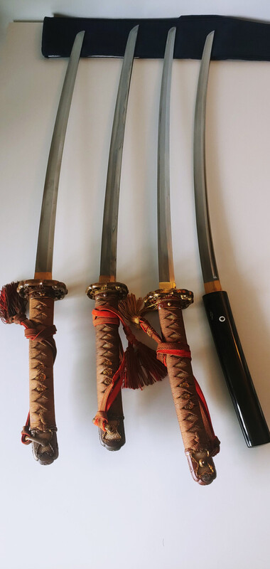

PNSSHOGUN Posted January 2, 2023 Report Posted January 2, 2023 From my observations Meiji & Taisho era blades certainly tend to have a particularly slender and delicate Sugata. Below are blades from this period: Left to right: Meiji - 1896, 1904 Taisho - 1915 Showa - 1926 (this was made specifically as a Kamakura era style court Tachi) 3 Quote
Bryce Posted January 2, 2023 Report Posted January 2, 2023 G'day Guys, I don't think it can be anything to do with military regulations. You find a very wide range of blades in military mounts. I guess it probably just comes down to the fashion of the day, but Sadakatsu was certainly welded on to his Showa period sugata. Cheers, Bryce Quote
