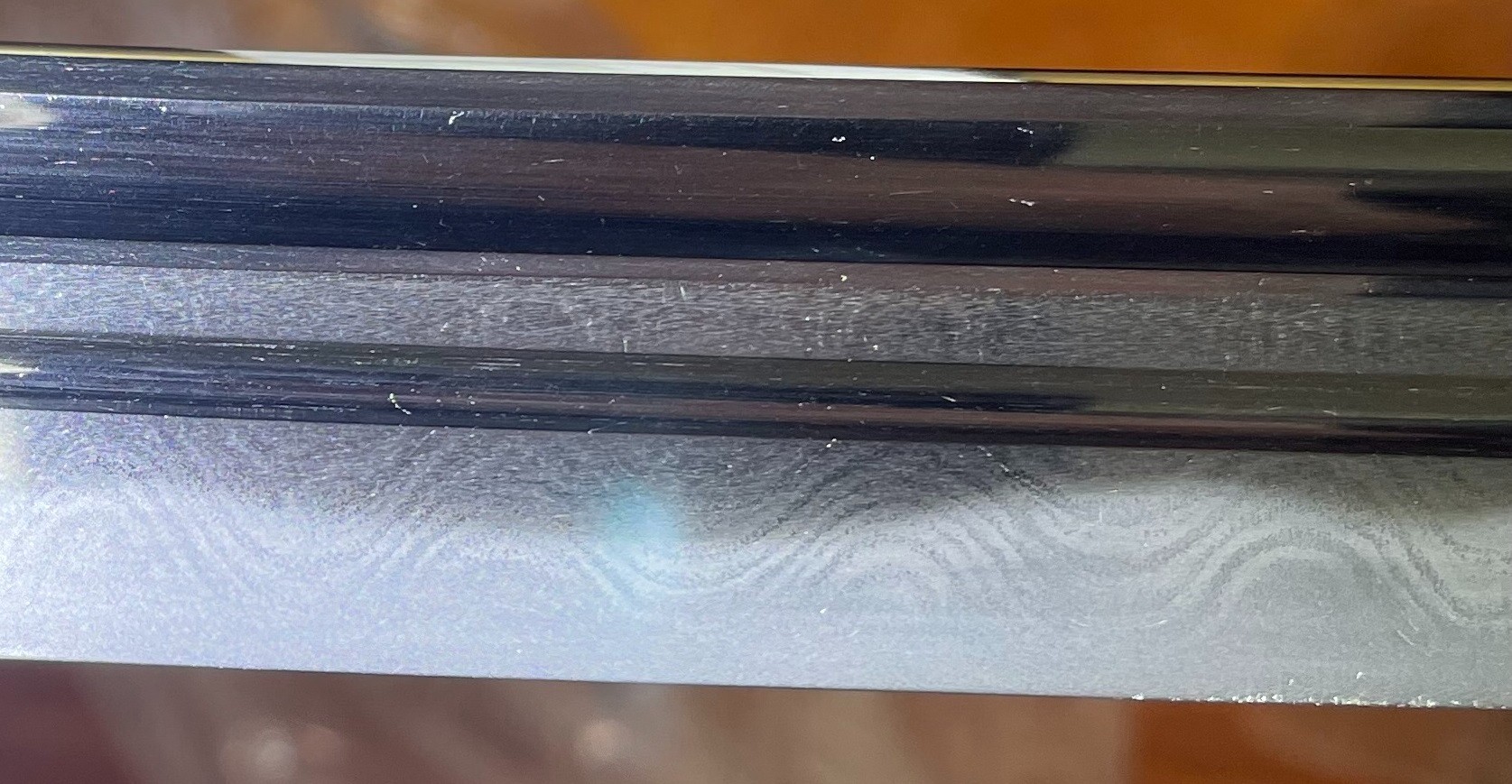

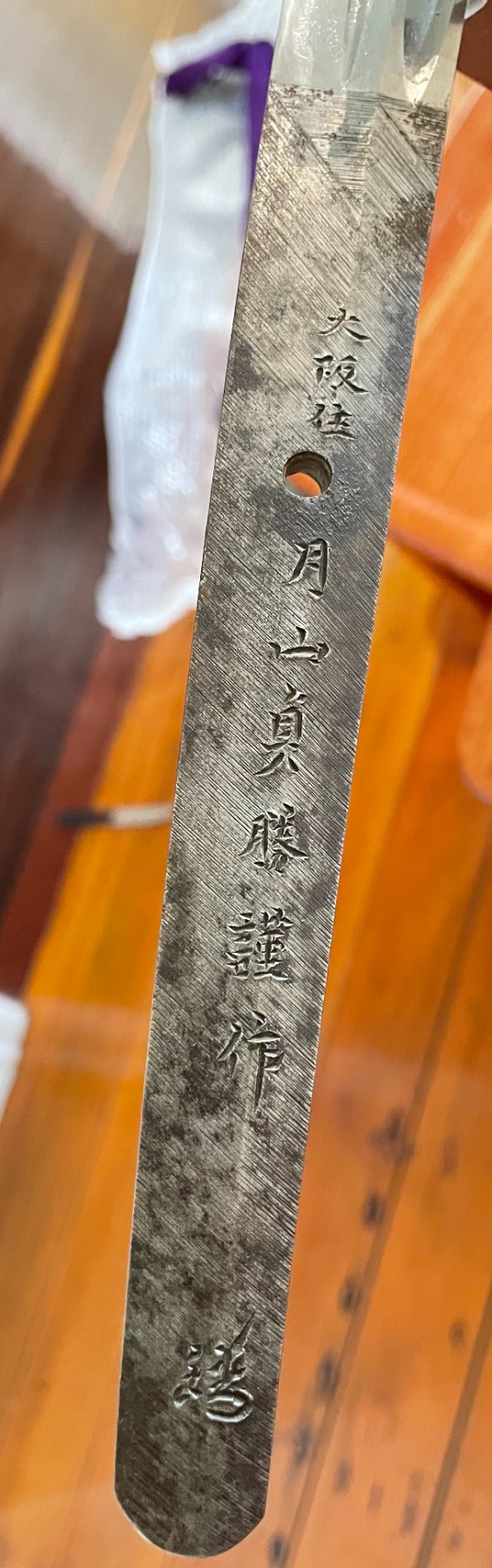

Ankh Posted September 30, 2020 Report Posted September 30, 2020 Can someone help me understand why this nakago is written like that? for I see mostly Ōsaka-jū Gassan Sadakatsu kinsaku + kaō Quote

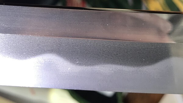

Bryce Posted July 12, 2021 Report Posted July 12, 2021 G'day Guys, Here is a 1940 Gassan Sadakatsu made from steel smelted by the Japan Iron Sand Steel Industry Company. On the katana-mei/tachi-mei subject, the split seems to be about 60/40 and does seem to be almost random. Cheers, Bryce 7 Quote

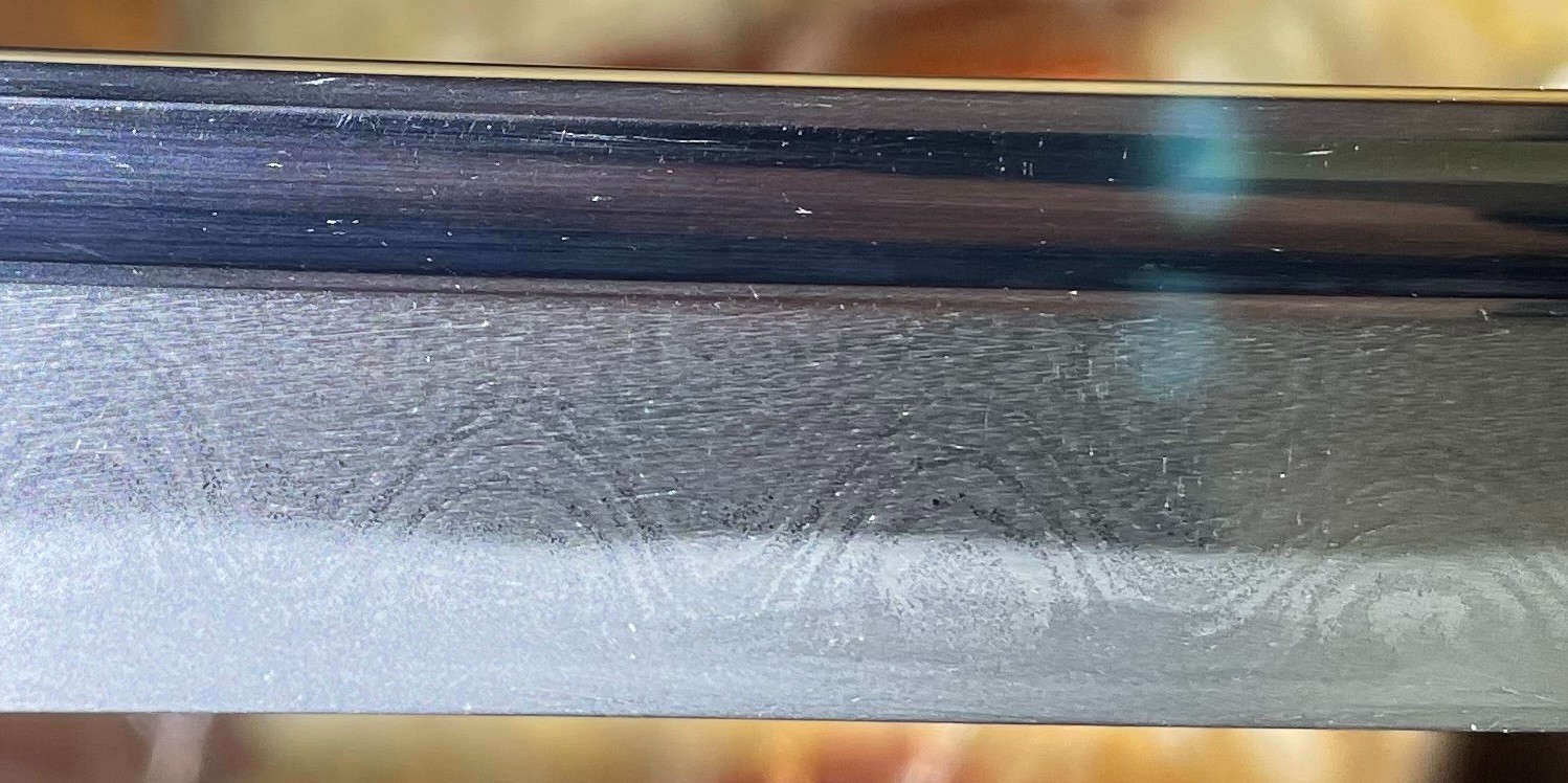

Bryce Posted September 4, 2022 Report Posted September 4, 2022 G'day Guys This is a 1943, custom ordered, Gassan Sadakatsu done in ayasugi hada. Cheers, Bryce 4 2 3 Quote

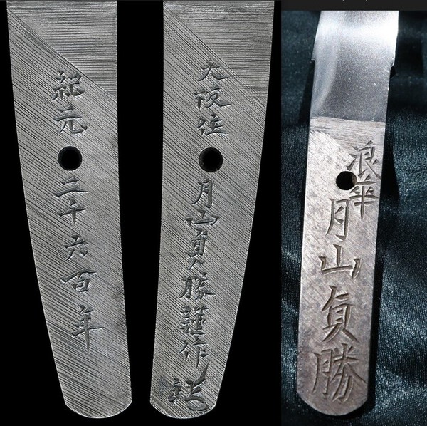

Bryce Posted September 6, 2022 Report Posted September 6, 2022 G'day Guys, I saw a "Gassan Sadakatsu" tanto for sale on ebay recently. On the left is the nakago from a typical, papered Gassan Sadakatsu and on the right is the ebay example. I know which one I like. Cheers, Bryce 1 1 Quote
Surfson Posted September 6, 2022 Report Posted September 6, 2022 That ayasugi is beautiful Bryce. I have found that it is a polarizing feature - people tend to love it or be put off by it. I am in the love it camp. As to the tanto - very few modern smiths' work has been copied with gimei. You know a maker had a good career when his work was faked by others. Enough said about that particular tanto. I just hope that it wasn't bought by a NMB member. 1 Quote
David Flynn Posted September 6, 2022 Author Report Posted September 6, 2022 I like Ayasugi, however, I find that the swords with this Jihada , have rather weak Hamon. Again, this is personal. Quote
Bryce Posted September 7, 2022 Report Posted September 7, 2022 G'day David, I get what you are saying about the weak hamon, because it is broken up by the alternating layers of steel thru it, but it does have a certain "wow" factor. Cheers, Bryce 1 Quote
