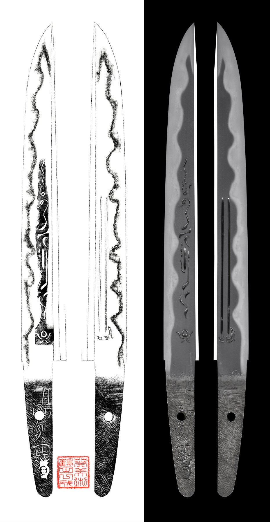

Bryce Posted September 28, 2022 Report Posted September 28, 2022 I know there is at least one Sadakazu that has gone Juyo. Does anyone have a photo or oshigata of it? Cheers, Bryce Quote
David Flynn Posted September 28, 2022 Report Posted September 28, 2022 I don't have a photo or oshigata, but I have seen this sword first hand. The sword in question is a Utushi of a Sadamune. It was on exhibition at the NBTHK a few years ago. Quote
PNSSHOGUN Posted September 28, 2022 Report Posted September 28, 2022 From memory there have been other Sadakazu that have passed Juyo, perhaps @Jussi Ekholm can get the numbers? Quote
Jussi Ekholm Posted September 28, 2022 Report Posted September 28, 2022 I believe there are 3 Sadakazu works that have passed Jūyō so far. Unfortunately I only have book entry for 20 as I am still missing session 60 & 61 books. Wakizashi in session 20. (1908) 奉久邇宮殿下命月山貞一謹作 / 明治四十一年三月日 Katana in session 60. (the one talked above) (1906) 大阪住人月山貞一彫同作 (花押) / 以相州鎌倉住人貞宗伝作之 / 明治三十九年十一月吉日 Wakizashi in session 61 (very similar mei to the katana above, possibly a pair?) (1906) 大阪住人月山貞一彫同作 (花押) / 明治三十九年十一月吉日 / 以相州鎌倉住人貞宗伝作之 2 Quote
Bryce Posted September 28, 2022 Report Posted September 28, 2022 Thanks very much Jussi. I would love to see the oshigata of these juyo blades if anyone can help? Bit of an update on what I found to date: So far the earliest daimei by Sadakatsu I have found is dated Meiji 30. The latest blade I have come across, that I believe was actually signed by Sadakazu was dated Meiji 41, but the search continues. Cheers, Bryce Quote
Bryce Posted September 30, 2022 Report Posted September 30, 2022 This is an interesting sword I have come across on the net. Made in 1906 like the juyo example mentioned above and signed Gassan Sadakazu made this at the age of 71. I believe this is a daimei by Sadakatsu. Sadakatsu is also named in the mei. Can someone please tell me what the context of this is? Cheers, Bryce Quote
Bryce Posted October 1, 2022 Report Posted October 1, 2022 G'day Guys, I think I found a picture of the Juyo katana. I believe this is also a daimei by Sadakatsu. Cheers, Bryce 1 1 Quote
