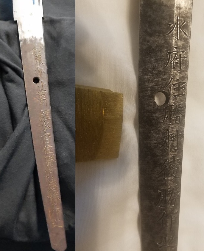

Z8mtj Posted May 19, 2020 Report Posted May 19, 2020 Hello, I am a new member to this board and am trying to learn as much as I can on this topic. My grandfather left me this Shin Gunto when he passed. I believe it was a bit neglected before, and I made efforts to care for it when I would visit. Would anyone be able to tell me if this Shin Gunto is an authentic Norikatsu Katsumura blade? http://imgur.com/gallery/h5xIa1a Thank you in advance, and please pardon my inexperience. Terran W. 3 Quote

DKR Posted May 19, 2020 Report Posted May 19, 2020 Norikatsu was one of the better smith........ A close-up picture of the blade would be very helpful to see the Hada / Hamon. Only a signature does not make it easy to form an opinion whether a blade could be real or not. 1 Quote

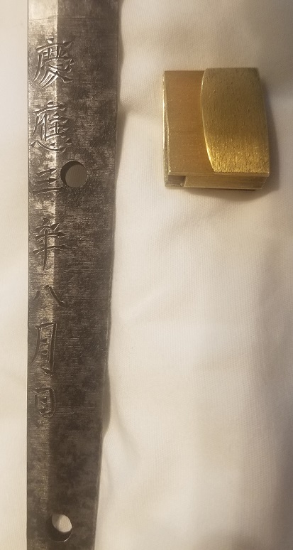

Vermithrax16 Posted May 19, 2020 Report Posted May 19, 2020 Hello Terran, Nice looking sword! Norikatsu is my favorite smith. His signatures varied between standard block style and grass script ones. Like another poster wrote, a good hada picture is the best way to tell, his nie laden masame hada is quite distinct. Your mei seems just a touch thick for his works that I have seen, but he is a somewhat rare smith to see examples of. I have put your mei side by side with one I have that is verified: Quote
Ken-Hawaii Posted May 19, 2020 Report Posted May 19, 2020 Terran, we can estimate, but only shinsa can authenticate. Welcome to NMB. Quote

Gabriel L Posted May 20, 2020 Report Posted May 20, 2020 @Mark and others – I helped Terran translate this on Reddit. The full signature is: Oite Tōto Koishikawa kan Suifu jū Katsumura Norikatsu saku kore 於東都小石川舘水府住勝村徳勝作之 (Made by Katsumura Norikatsu, resident of Suifu, at Koishikawa manor in Tokyo) Keiō gannen hachigatsubi · gō Shōri [no] Ken 慶應元年八月日 • 号勝利釼 (A day in the eighth month of the first year of Keiō (= 1865) · named Sword [of] Victory) Terran,Capturing the hada can be difficult, especially when the polish isn't pristine, but I believe I can indeed see nie-laden masame hada in your recent photos which is a very good sign. Masame in general is not the most common style of hada and is a trademark for this smith.Although I do find this signature thicker and clumsier than most I have seen for him, as I said before I still do not want to rule this one out as genuine, and these hada photos are a big step towards making me think that might be the case.As Ken states, the final word will have to come from Shinsa. 3 Quote
Vermithrax16 Posted May 20, 2020 Report Posted May 20, 2020 On 5/20/2020 at 12:50 AM, Z8mtj said: Vermithrax16, I added a picture with a bit more detail for a side to side. Thank you very much for providing the picture. Would you happen to have any more? http://imgur.com/gallery/dEvfxwO I have a lot but what would help us more is if you can get a good picture of your swords hada and style. Take a glancing photo in a dark room, flash enabled. Here is the dated side picture of my Norikatsu. Like member Ken said, only a shinsa team can say for sure, but I don't think they are a match: Full reading of signature and date: Suifu-jū Katsumura Norikatsu kore o saku (⽔府住勝村徳勝作之) ‒ “Made by Katsumura Norikatsu, resident of Suifu (the government seat of Mito)” Keiō sannen hachigatsu hi (慶応三年⼋⽉⽇) ‒ “On a day of the eighth month, Keiō three (1867) Norikatsu masame hada: 2 Quote

Tom Darling Posted May 21, 2020 Report Posted May 21, 2020 Looks like a nice gimei to me. I compared the mei with mine Suifu ju nin minamoto Tokukatsu saku kore dated 3rd yr. of bunkyu 1864. cutting edge 80cm. Same kaji. Besides, the kiri is haphazardly cut, not precise. Please do, send it to NBTHK when you get a chance. If I am wrong, I'll take you out to Starbucks. But, it is still is a very nice sword. Thank you for showing it. Peace. Tom D. 2 Quote

Jacques Posted May 25, 2020 Report Posted May 25, 2020 Here an oshigata from the same year and i've some doubt this mei is genuine 1 Quote

Jacques Posted May 25, 2020 Report Posted May 25, 2020 On 5/25/2020 at 7:51 PM, Z8mtj said: Jacques D, Can you please send me the link to the website that has that picture? Thank you, Terran It doesn't come from a website but from the Shinshinto Taikan : A Japanese book which is in my library. 1 Quote
