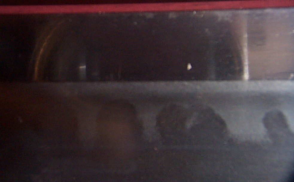

kusunokimasahige Posted October 23, 2008 Report Posted October 23, 2008 Hiya all, Mike has a blade for sale, well a few for absolutely ridicoulous prices, so i am resisting the urge to bid.... not too much to spend these days... DAMMIT! but what could these round things be on this blade? http://cgi.ebay.com/ws/eBayISAPI.dll?Vi ... otohosting very interested if it is inside the metalwork... an air bubble during forging? does it have a Japanese name? KM
Bungo Posted October 23, 2008 Report Posted October 23, 2008 " what could these round things be on this blade? " instead of the long rectangular ones we see, this look like round repair. milt
Brian Posted October 24, 2008 Report Posted October 24, 2008 Umegane? Brian Edit: Pfft! Beaten by Jean :lol:
Jean Posted October 24, 2008 Report Posted October 24, 2008 Edit: Pfft! Beaten by Jean Because of my hind legs
Henry Wilson Posted October 24, 2008 Report Posted October 24, 2008 Could it not be an itame blurl? (as a long shot)
Jean Posted October 24, 2008 Report Posted October 24, 2008 Could it not be an itame blurl? (as a long shot) Henry, it does not seem to fit the environing hada - seems embedded
Jacques Posted October 24, 2008 Report Posted October 24, 2008 Hi, IMHO its looks like more spot of shingane than umegane. This blade seems have been often polished.
kusunokimasahige Posted October 24, 2008 Author Report Posted October 24, 2008 great info all!! Wouldnt a repair like that seriousely downgrade the outcome at shinsa? even though it might have been a contemporary repair? KM
Brian Posted October 24, 2008 Report Posted October 24, 2008 It's a flaw. Not fatal, but a visible flaw, and will affect the value and/or outcome the same as any visible flaw. This goes for it whether it is shingane or umegane. Let's just say it isn't a good thing. Brian
Ted Tenold Posted October 24, 2008 Report Posted October 24, 2008 I have yet to see any umegane done in round shape, and certainly nothing that large. The structure and color are clearly different. This points to shingane imho. If the blade could be examined in hand, one would look for similar structure and color in the shinogiji and also the mune to confirm the construction method and if those areas are exhibiting kawagane loss as well. Even this can be difficult to see though if the burnishing was done to push down signs of that too. Not accusing the seller of any malice. It's clearly odd and he describes it apparently with the same question.
kusunokimasahige Posted October 24, 2008 Author Report Posted October 24, 2008 Oh nothing bad about this seller, he is one of the best out there, especially with his prices and project blades which sometimes are jewels in disguise! merely learning about the technical side of things here... KM
shan Posted October 27, 2008 Report Posted October 27, 2008 Hi All. I recently had a poor polish Yari that i wanted to see the hamon on. I was told by many that a shortcut "window" to the hamon was through Lemon juice. I brushed some lemeon juice onto the blade and waited for a while. The hamon did come up a little better but when i turned the blade over the underside (which is V shaped) had some lemon droplets on it that formed those round Marks.They are quite hard to remove as well. I think it is either lemon,Vinegar or an Acid or alkaline of some sort. Probably rubbish, but just sharing anyway. P.s the lemon trick was not that effective so don`t bother with it. regards shan
