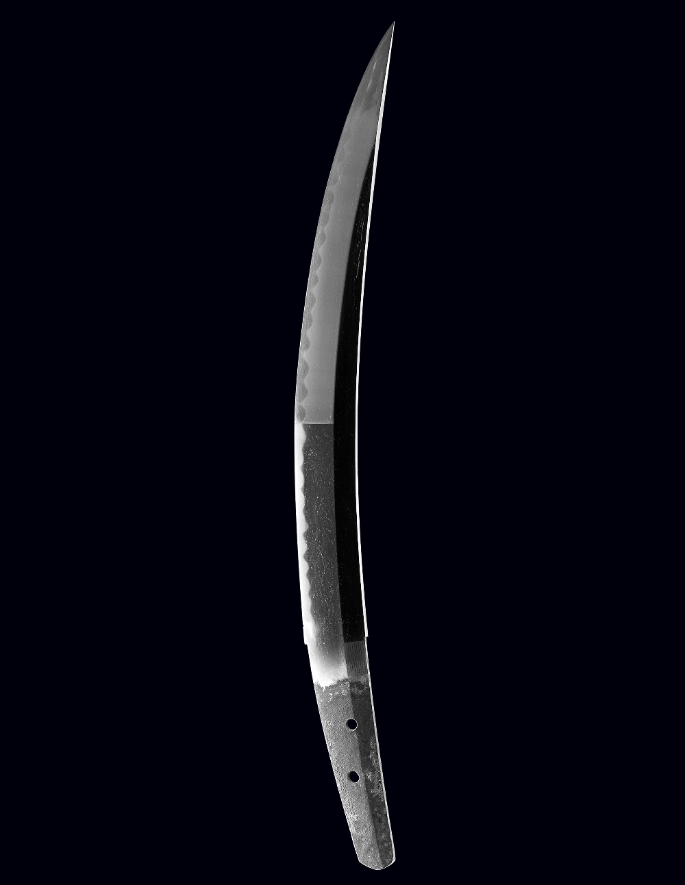

warrantsto Posted May 14, 2020 Report Posted May 14, 2020 Good afternoon! Please bear with me with my first post and request for information ( newly signed member). The following information are the ones I have measured myself in regards to the Tanto: Nagasa - 22 cm Nagako - Mumei Blade - Osoraku Moto-haha - 4 mm Base witdh - 23 mm Kurigata - looks like black horn Saya - Not sure if it’s lacquered but it has embossed butterfly. Koshirae - Aikuchi style I could not find during my research an example of this simple koshirae and the embossed design intrigues me. I am also not sure if the Kogai is original to the koshirae. I’ve had this Tanto but did not pay attention to the details. Now that my interest in learning about Nihonto as an art form, maybe I could learn more about this tanto. I am really not sure if it qualifies in that category. Any comments or recommendation will be greatly appreciated. Quote

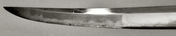

vajo Posted May 14, 2020 Report Posted May 14, 2020 Welcome Arnel. First congratulation for your good photos! The koshirae is topei as Tom said. A nice piece. The Blade is interesting in my eyes - would go for a kaiken. I would say a shinto piece. Nice bizen styled hamon. The yokote is set on the middle of the blade. Not as much sori as this But this in the picture is a late edo piece 3 Quote

Shugyosha Posted May 15, 2020 Report Posted May 15, 2020 Apologies to the OP and I'm happy to be shouted down here, but am I the only one thinking that there is something off about the sugata? It gives me the impression of someone having added the yokote to a shobu zukuri blade. There's something not quite right for me about the way that the blade tapers significantly immediately after the yokote. Also the nakago shinogi looks like it has been tampered with and I'm wondering whether the blade has been pimped to make it a more attractive sell. Perhaps some photographs from the mune side would confirm whether the kissaki is genuine or just cosmetic? I'll retreat to my bunker... 2 Quote
Grey Doffin Posted May 15, 2020 Report Posted May 15, 2020 For what it's worth (not much) my 1st impression also was that something isn't right. The placement of the yokote seemed artificial and the fact that the yasurime have been messed with is a red flag. I'm not sure by a long shot of this and will be happy to be proven wrong; I wait to hear from those with more experience than I have. Grey 1 Quote

warrantsto Posted May 15, 2020 Author Report Posted May 15, 2020 Thanks to everyone! It’s been very interesting reading all the commentary. This is a good learning process for novices like me, understanding the complexity of different blades. For a quick background about the tanto, I found it the flea market for $75 dollars just to keep as a conversation piece. Not until I signed up in this forum where my curiosity gets tickled by the wealth of information available. Whether this blade is somewhat genuine or not, I treasure more the information you all provided. There’s an interesting mune shape above the yokote/kissaki. 3 Quote
Brian Posted May 16, 2020 Report Posted May 16, 2020 Arnel,I don't think there is any doubt that this is a genuine Japanese sword, with a few hundred years on it. The question I think is regarding the shape. Was it altered to have a more unusual shape, or is the shape original. But for the price, you have got a real bargain anyways, and it is a real sword. 4 Quote
Ken-Hawaii Posted May 17, 2020 Report Posted May 17, 2020 That may turn out to be the most-expensive $75 you ever spent, Arnel! Welcome to NMB, & an expensive hobby. Please don't try to clean the nakago! I hope it wasn't you, but the dark "crust" provies a lot of information on jidai (age), & should never be messed with. I have a Gendaito with almost exactly the same sugata & yokote placement, so I don't see anything unusual about this blade. Shinshinto Mino. 2 Quote

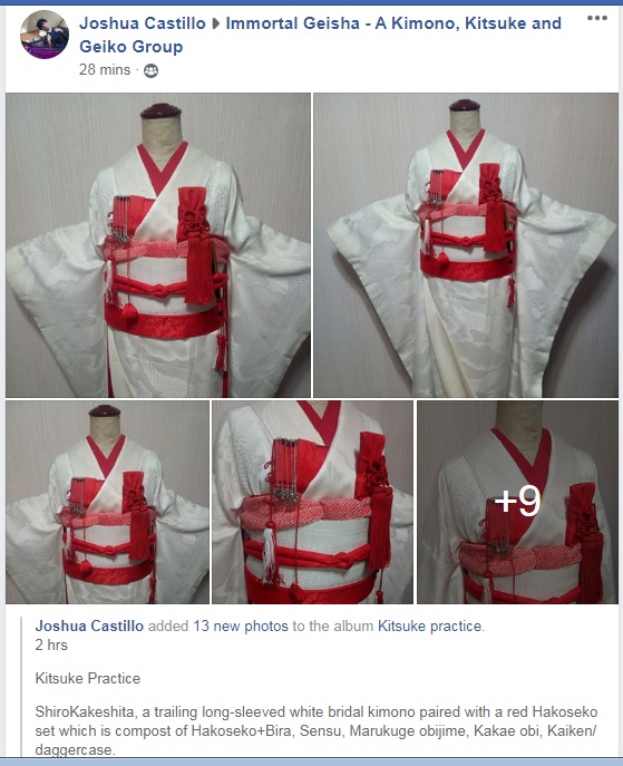

Dave R Posted May 18, 2020 Report Posted May 18, 2020 You might find this interesting, these blades could be won as part of a women's bridal outfit! In this case neatly tucked away in a special bag. 1 Quote
warrantsto Posted May 19, 2020 Author Report Posted May 19, 2020 Dave, That is really interesting. Started me to read more about the traditional way the tanto could have been carried, especially by women and it’s purpose. Quote
