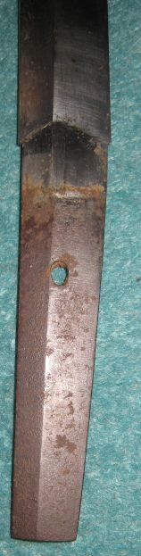

I've have an o-suriage wakizashi and I wondered if it may have started out life as a nagamaki or naginata.
It has the faint remains of the top of a hi in the nakago on one side. The hamon is a Bizen like choji midare with wide nioiguchi, it has long wide finger like streaks of choji that come out of the main hamon reaching the shinogi. The ji is full of small tobiyaki. The mune is quite narrow but on reaching the monouchi flares out to become wide. Sorry for the poor images but I think it gives a general idea.

Pete,
From what I understand, the difference between Nagamaki and Naginata, actually lies in the mountings and not the blade shape. Nagamaki meaning "long wrap" elludes to the ebu (shaft/haft/pole) being wrapped much like the tsuka of a sword, while the Naginata is mounted unwrapped. I think Guido found some article about this a long time ago as I remember some discussion of it on another forum. I see them documented or referred to by both terms somewhat interchangably, unless they are obviously of later period Naginata style with the beveled shinogi and naginata style hi.
:shock: :o
Yeah, might wanna get that one checked out. It sounds very Ichimonji-esque! Hope it's a winner!! :D
Thanks Ted! What period does this shape of naginata generally originate from?
Also the hamon has areas with crab claws would this be more indicative of a muromachi period Sukesada or the like?
The long extended shapes with long reaching kissaki emerge in the Kamakura period.
I'd agree that the crab claws and any really togari based hamon point to later work. Lots of odd and naoshi *looking* shapes were done in late Muromachi and Momoyama, so it's easy to suspect later period on some of these, but still worth checking out.
