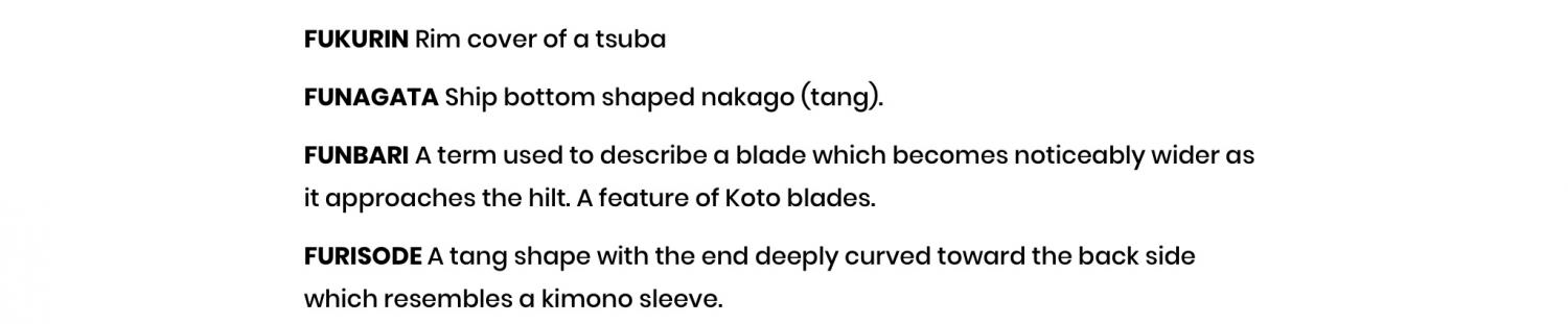

Funbari IS the tapering from yokote to machi, Scott.
Funbari see,s to be a very complex and difficult to use word. It would seem that "real" funbari applies to older blades, pre Muromachi, where near the Habaki, the is a sudden enlargement of the blade. However, some people, and among them supposed scholars of nihontō, also use it even in books to speak of the general tapering of the blade from machi to kissaki. so maybe it is used because of a lack of specific word? A rare instance in Japanese nihontō study where an excess of Precise vocabulary seems to be the norm.
Whatever, I personally use "funbari" in the first instance and just "tapering" in the second one to avoid confusion. But Ken, I understand your use of it.
EDIT: for example, even in this book by an authority like Yoshindo Yoshihara, it is used in the machi/kissaki meaning. Then an excerpt from Nihontō.com where it refers to the first meaning. So a confusing term that can, I guess, be understood in both ways.
Here is also a translation from a French source:
Except in truly exceptional cases, all sword blades have a saki haba  narrower than the moto haba. This difference can sometimes be quite significant and some authors call it funbari. In fact, the funbari 踏ん張り - which could be translated as "resistance" - is a marked increase in blade width a few centimeters from the machi. The ashi wofunbaru (bow on his legs) is a good illustration of the feeling of a man camped on his wide legs that the funbari gives. This is a feature on the end of Heian to early Kamakura  blades which, of course, have not been shortened.
I think this excerpt shows the confusion quite well.
