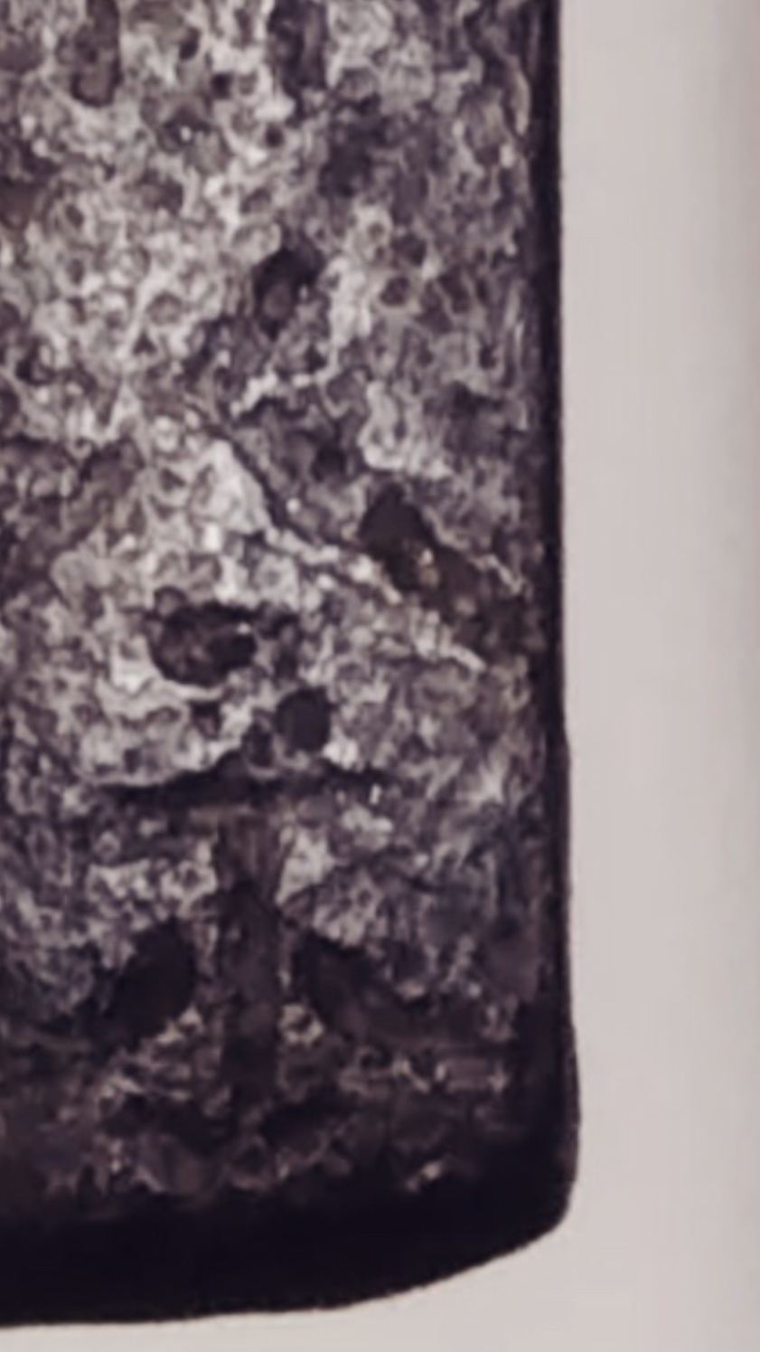

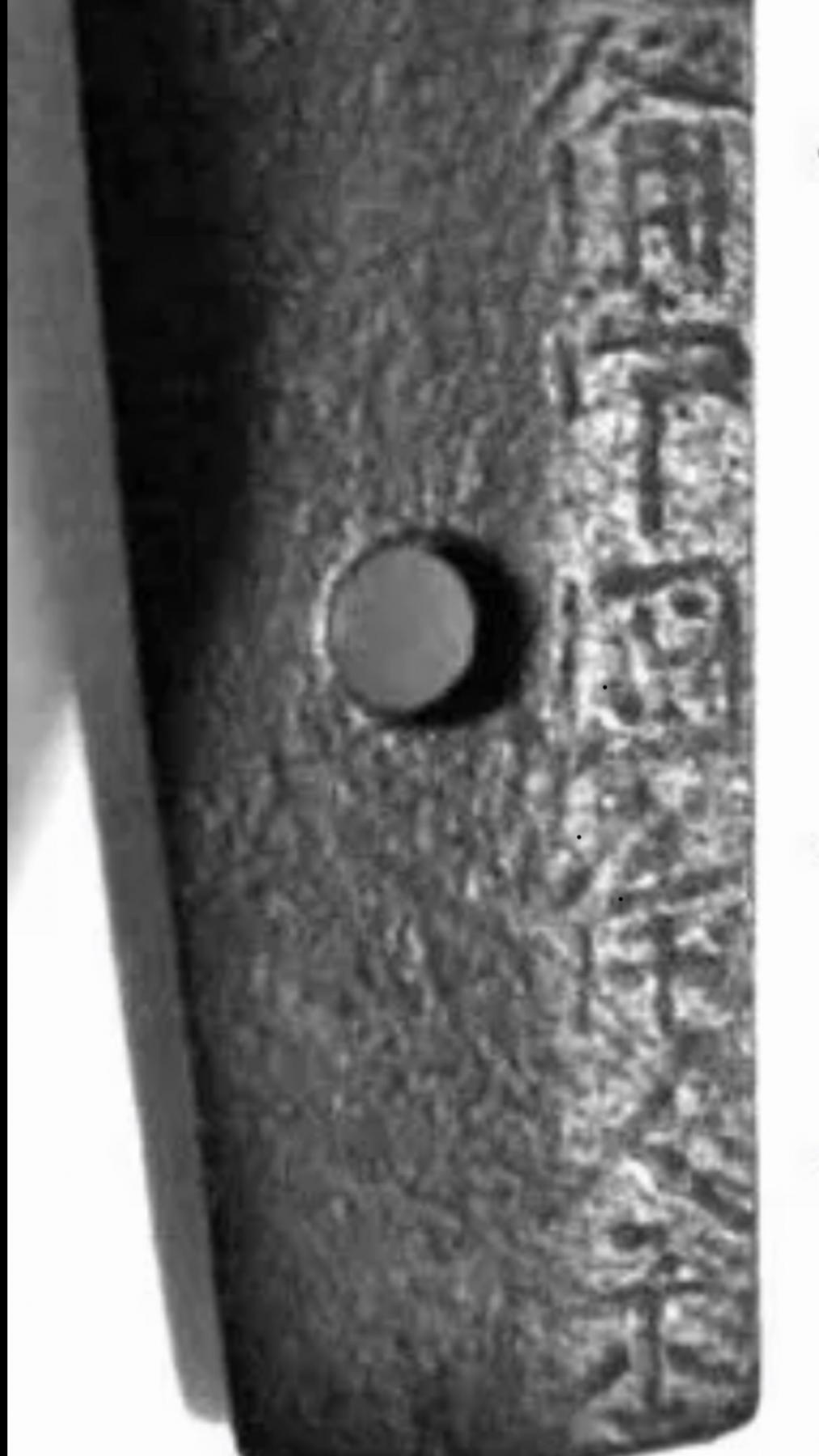

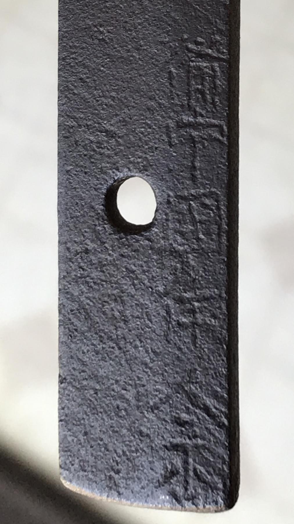

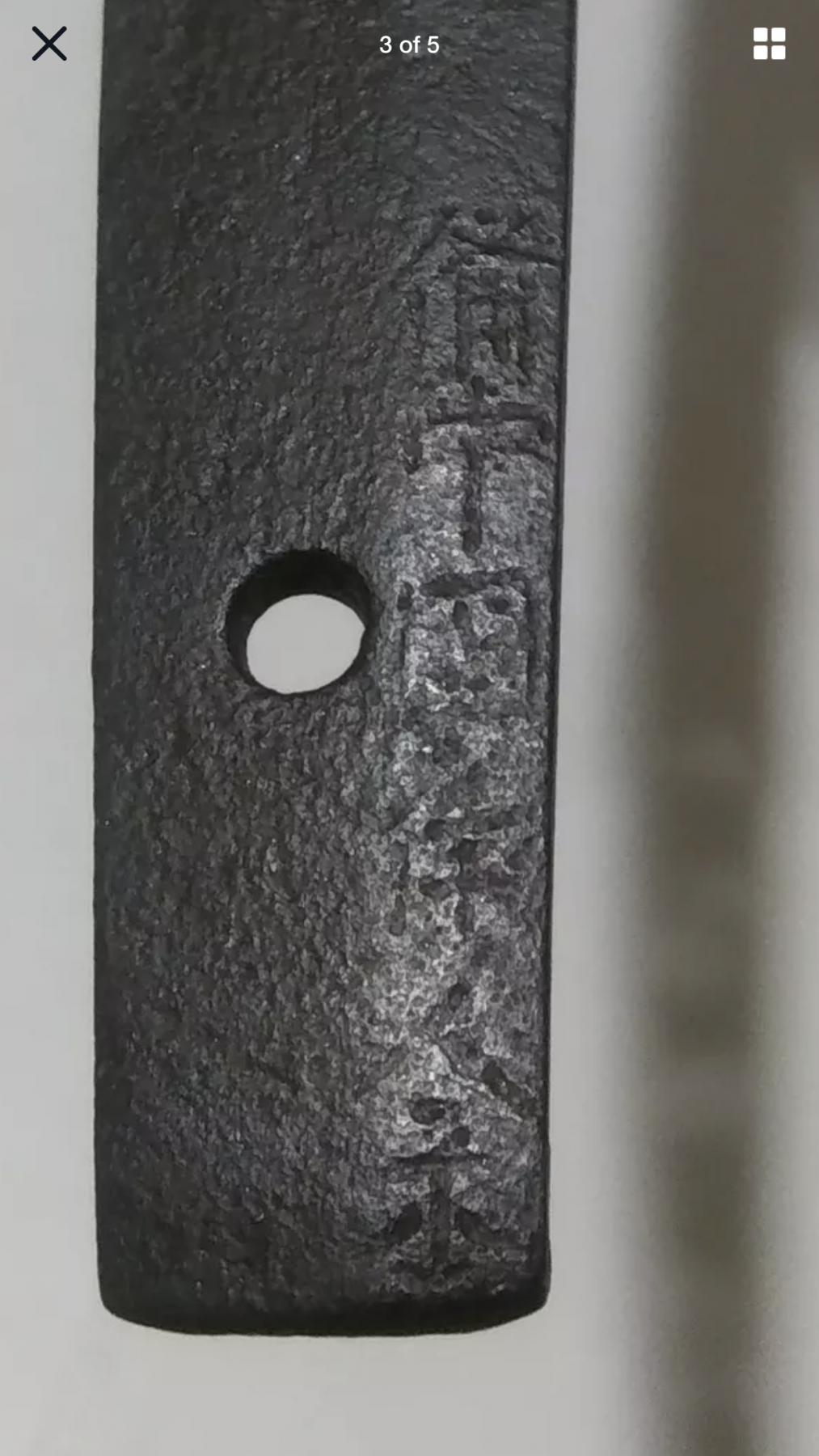

Utopianarian Posted April 19, 2020 Report Posted April 19, 2020 I know part of the mei says Bitchu kuni ju nin. I can’t make out the last character Quote
ROKUJURO Posted April 19, 2020 Report Posted April 19, 2020 George,please try again with better photos! The NIN might prove to be a HISA. Quote
Ray Singer Posted April 20, 2020 Report Posted April 20, 2020 Agreed that the first few kanji do look like: 備中國住人There would be at least one kanji missing past the kanji below junin. SUE (for example, part of Suetsugu) looks close but there is an extra stroke that would seem to eliminate that option. 備中國住人末次 1 Quote

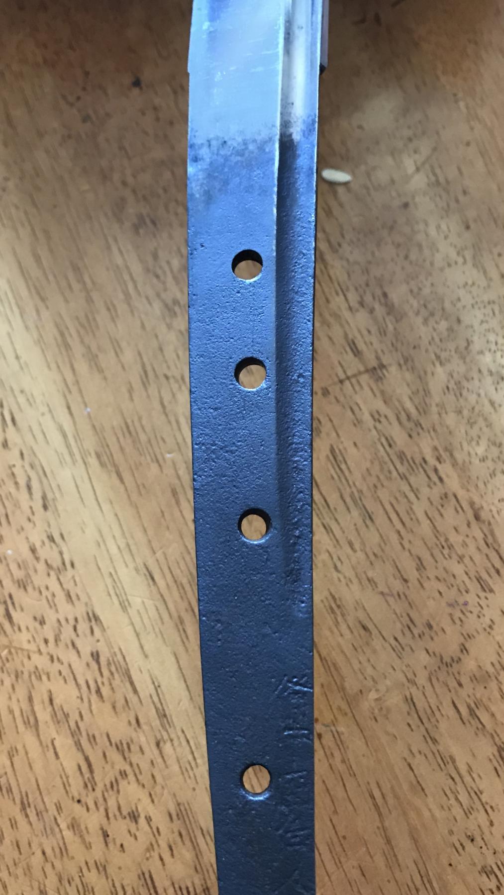

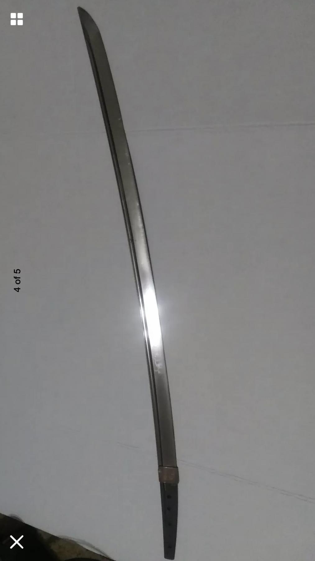

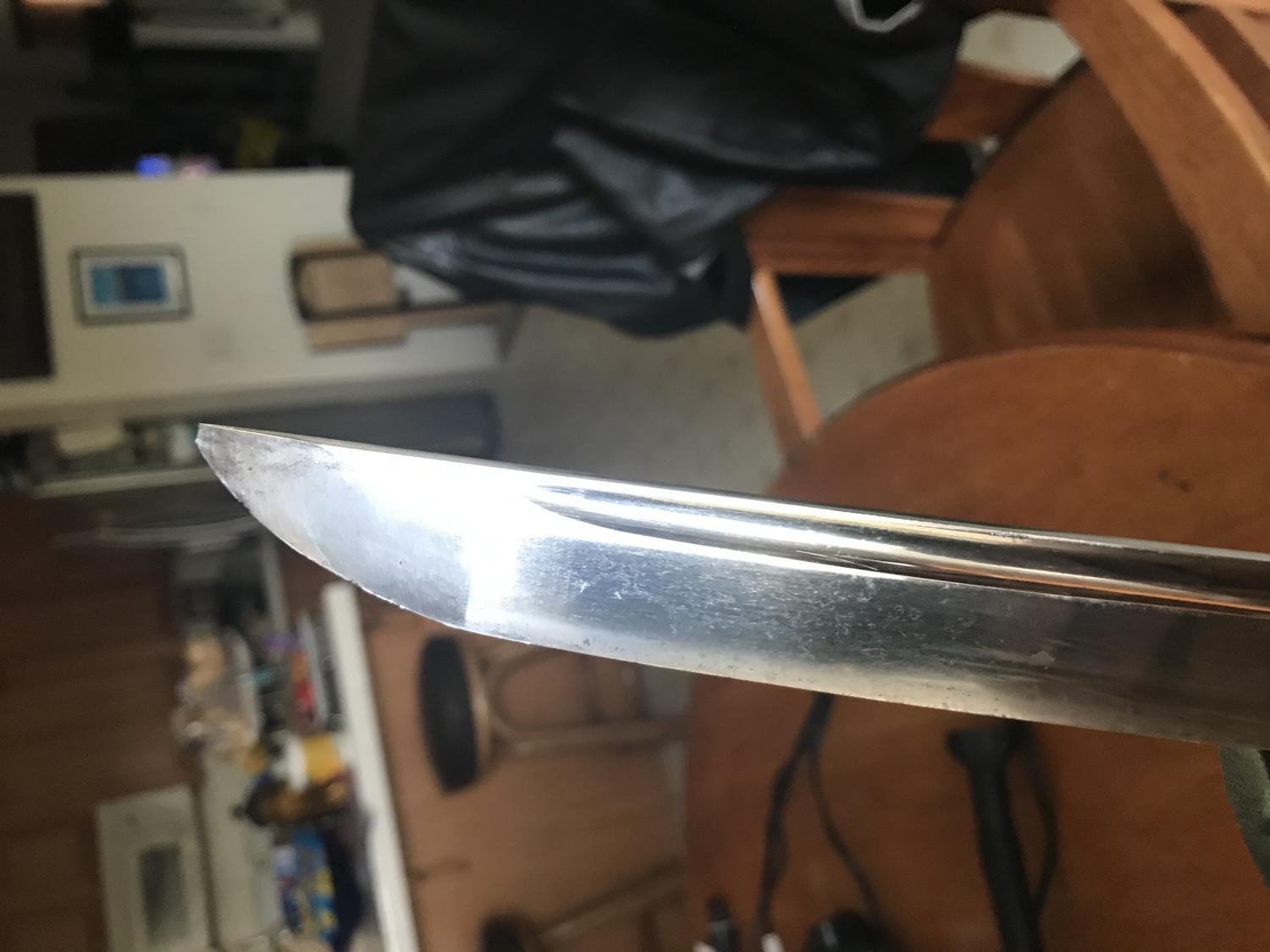

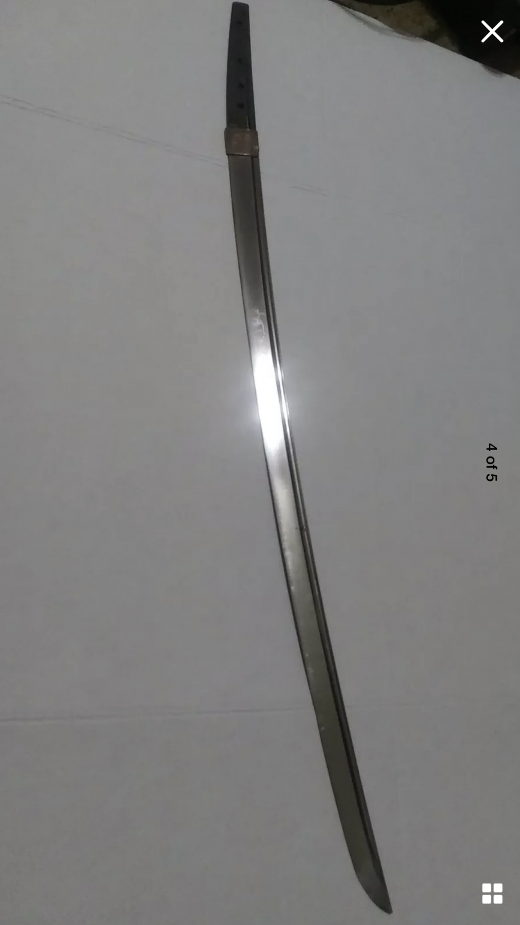

Utopianarian Posted April 20, 2020 Author Report Posted April 20, 2020 Thank you all for your input. Here is a little clearer pic of the mei and a pic of the overall shape of the sword which might help to place maybe the era of the blade Quote
Utopianarian Posted April 20, 2020 Author Report Posted April 20, 2020 Sorry here is blade upright Quote
Ganko Posted April 20, 2020 Report Posted April 20, 2020 Appears to have a Nambokucho shape, quite desirable if it is. Quote
Bugyotsuji Posted April 20, 2020 Report Posted April 20, 2020 There was a Kamakura Aoe Nagatsugu smith who signed 備中国永次 for example, and at least two 永久 Nagahisa from the same area, one Ko-Aoe and the other Eisho. (Assuming of course that the character we see is 人 and not 久) 2 Quote
Utopianarian Posted April 20, 2020 Author Report Posted April 20, 2020 HisaMune might fit too idk or munetsugu Quote
ROKUJURO Posted April 20, 2020 Report Posted April 20, 2020 With the new photo I agree with Ray. It does look more like NIN, not HISA, and one name KANJI seems to be missing. When making photos of a blade, try to show it with the tip upwards. Quote
Nobody Posted April 21, 2020 Report Posted April 21, 2020 I guess the last kanji may be 秀 (hide). So, the mei may be 備中國住人秀・・・ BTW, the ebay seller says the last kanji may be 宗 (mune) or 末 (sue). Ref. https://www.ebay.com/itm/Antique-Signed-Japanese-Katana-Sword-Pre-1600s-Koto-Period-WW2/283619426397 3 Quote

Utopianarian Posted April 21, 2020 Author Report Posted April 21, 2020 It caught my attention and wanted to learn more about it. I had the seller send me a few extra pics including the overall pic of sword I posted of bare blade. This seller doesn’t seem like the typical eBay monkey that pumps out junk buffed blades. The location shows Jacksonville Alabama. I live in a Southern California. Like many here on the board like to see what’s out there. As you all know 99% of eBay is junk sifting thru for something. Most know what they have if it’s significant and that reflects in the inflated prices you usually see. The occasional blade that’s interesting worth looking at which is rare does on occasion happen. We all know which ones to stay away from Quote
Utopianarian Posted April 21, 2020 Author Report Posted April 21, 2020 Would you define this as Genroku-shintō-sugata or something more reminiscent of Nanbokucho or Muromachi Quote
Utopianarian Posted April 30, 2020 Author Report Posted April 30, 2020 I think the last character is 利 Toshi. Part of it looks shaved off on the end of the nakago mune side where it tapers thinner. So I am guessing Toshitsugu 利次. I actually purchased the blade off eBay. I will get a better idea when I can evaluate it in hand. I think it was worth the gamble for a possible Nanbokucho Aoe school blade. Quote

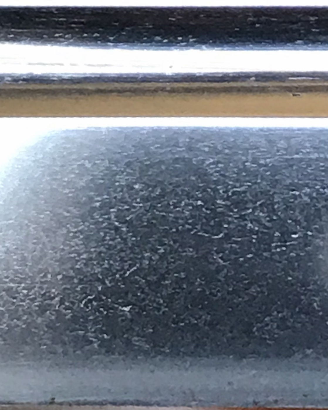

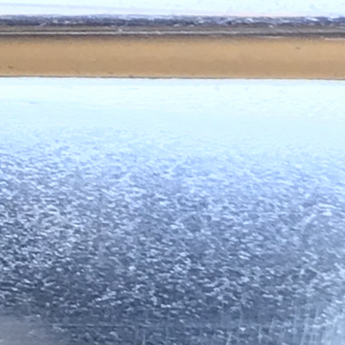

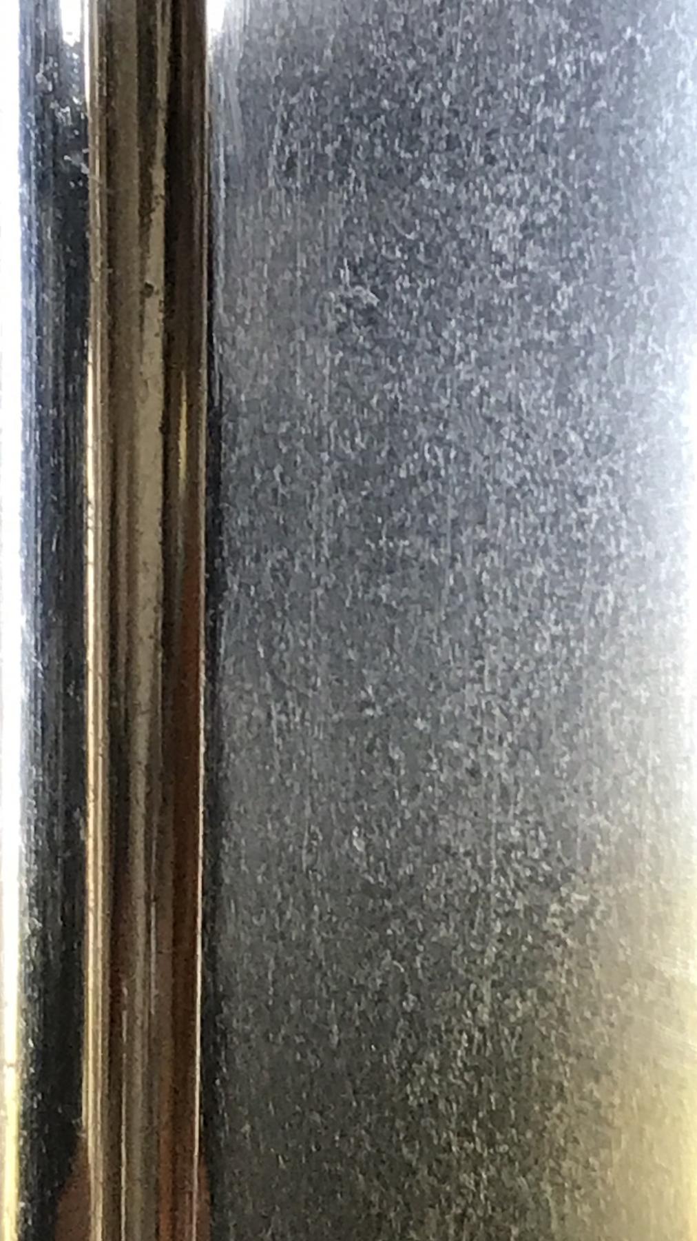

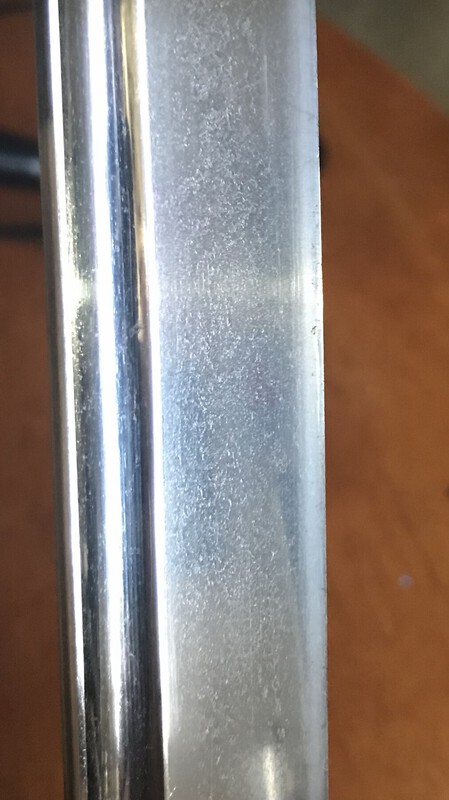

Utopianarian Posted April 30, 2020 Author Report Posted April 30, 2020 Not too good a pic but has that nie look on hada like the top of a lake that just froze over. Also the ha hada line. The seller sent me these pics so I’ll have to see when I receive it Quote

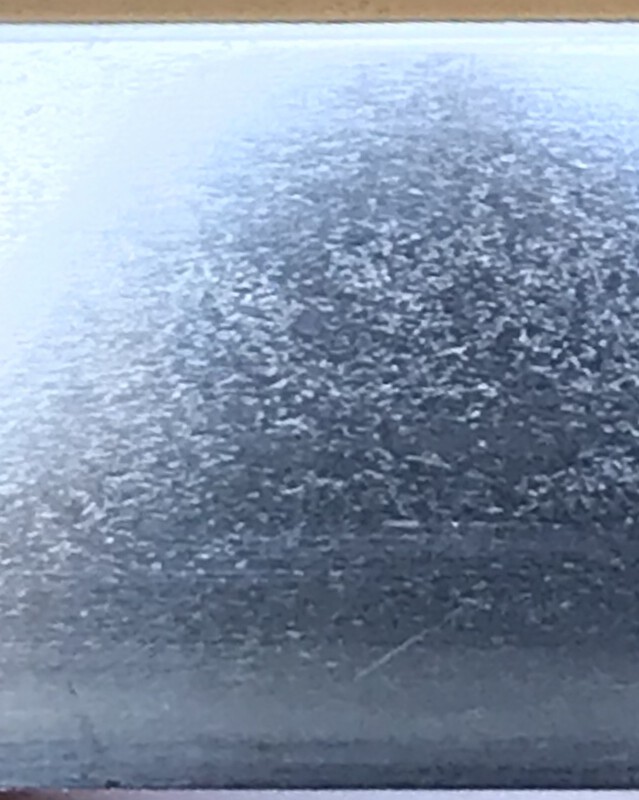

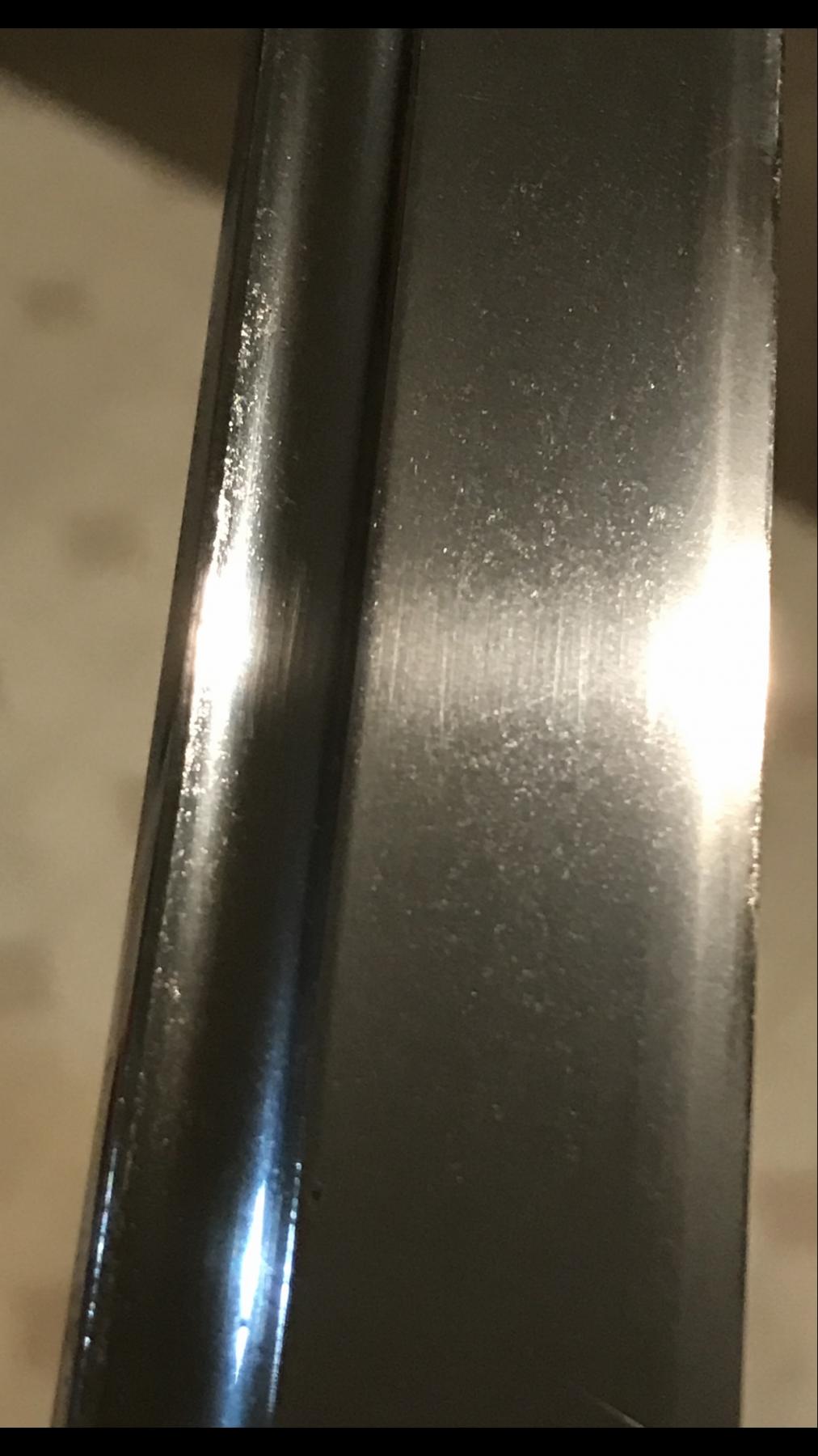

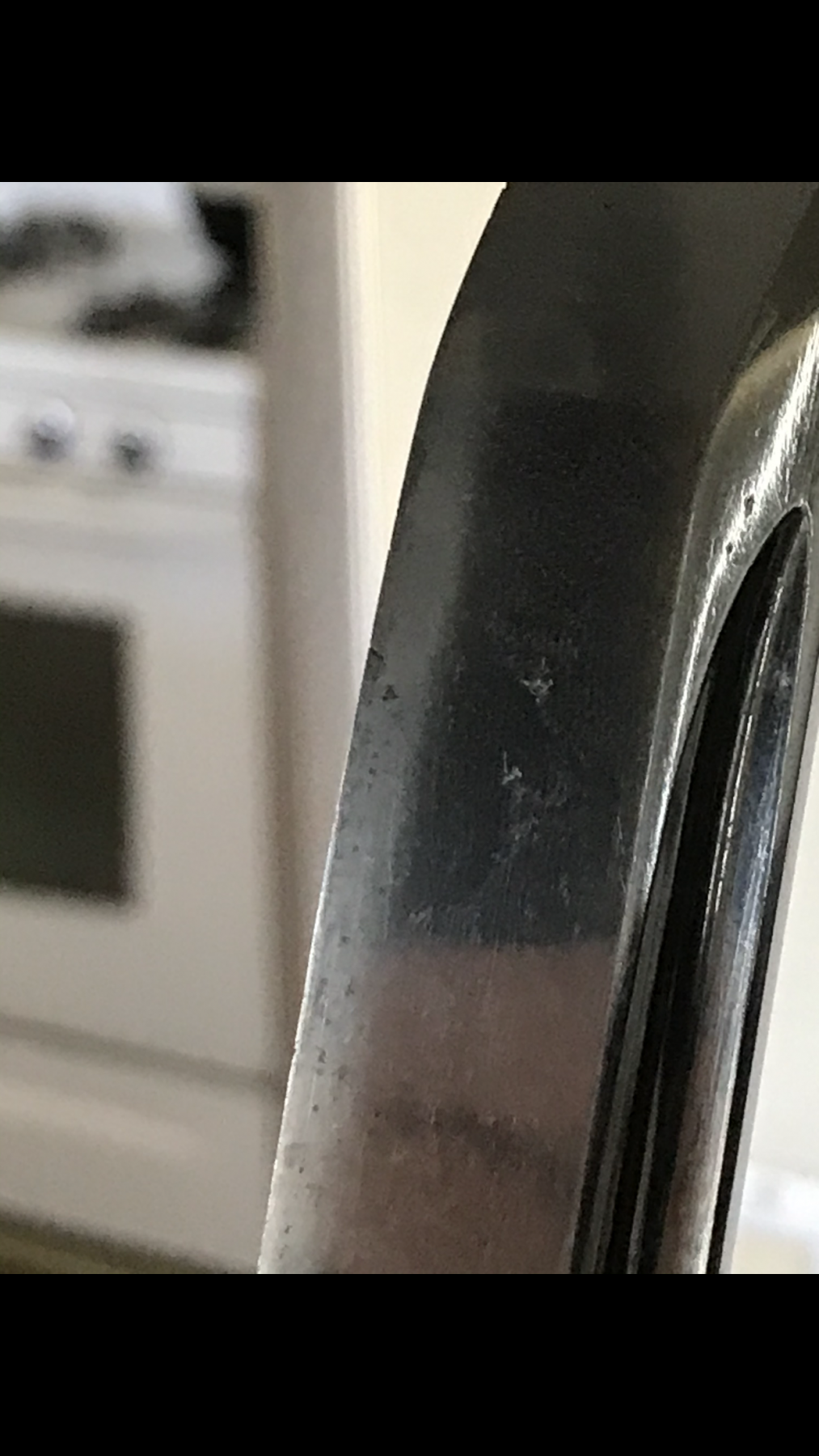

Utopianarian Posted May 6, 2020 Author Report Posted May 6, 2020 Sword just arrived in mail. The end of the mail tube the sword was in was destroyed. The only thing holding the sword from falling out was a piece of tape. Anyways I just snapped a quick picture before I left for work of the hada and grain of the sword. I think it does sort of have an Aoe school look to it. I will post more pics when I am off work and have more time. BTW we are being inundated with Covid pts here at the hospital (West Coast). Seems like cases are increasing on the West coast now. Quote
Utopianarian Posted May 9, 2020 Author Report Posted May 9, 2020 Measurements: Nagasa 69.3cm sori 1.6 cm moto-haba 3.17 cm saki-haba 2.22cm Kissaki width 2.22cm Kissaki length 4.13cm nakago nagasa 17.46cm moto-Kasane 0.67cm Saki-Kasane 0.47cm. Sugata koshi zori leaning toward tori zori. Hada tight forged crinkled texture with tightly forged mokume hada with some areas of sumi-hada, tight noi-guchi,nie-deki, ji-nie, utsuri, hoso saguha. Iori mune. Small area broken off tip. Hard to get visual of boshi and type of file marks on nakago. kaki-nagashi on both sides that run into the tang and runs up the blade and stops just before the yokote.The nakago is cut off missing some of mei. Signed katana mei side. It does appear to say Bitchu kuni junin mune probably missing tsugu. There was a Bitchu smith in the late 1500s that signed Bitchu kuni junin munetsugu but the sword seems to appear Aoe by the characteristics. They say first judge the sword before the signature. There was an Aoe smith in the Nanbokucho period named munetsugu but signed without junin on one of his signatures. Do you think it’s possible that smith’s sometimes signed differently with sometimes adding junin or slightly altering how they signed. Quote
SteveM Posted May 9, 2020 Report Posted May 9, 2020 It doesn't look like Mune to me. Moriyama-san above mentioned it looks like Hide 秀, so I wouldn't ignore that suggestion. Piers suggested 永, and that was my first impression also. Hide and Naga seem more plausible than Mune 宗. I would chase down those two avenues first. A cursory search on the internet didn't turn up too much for me, though. I think if you want a definitive answer you'll have to get it to shinsa somewhere. Quote
Utopianarian Posted May 9, 2020 Author Report Posted May 9, 2020 Thank you Steve!! I will look into those options as well. Quote

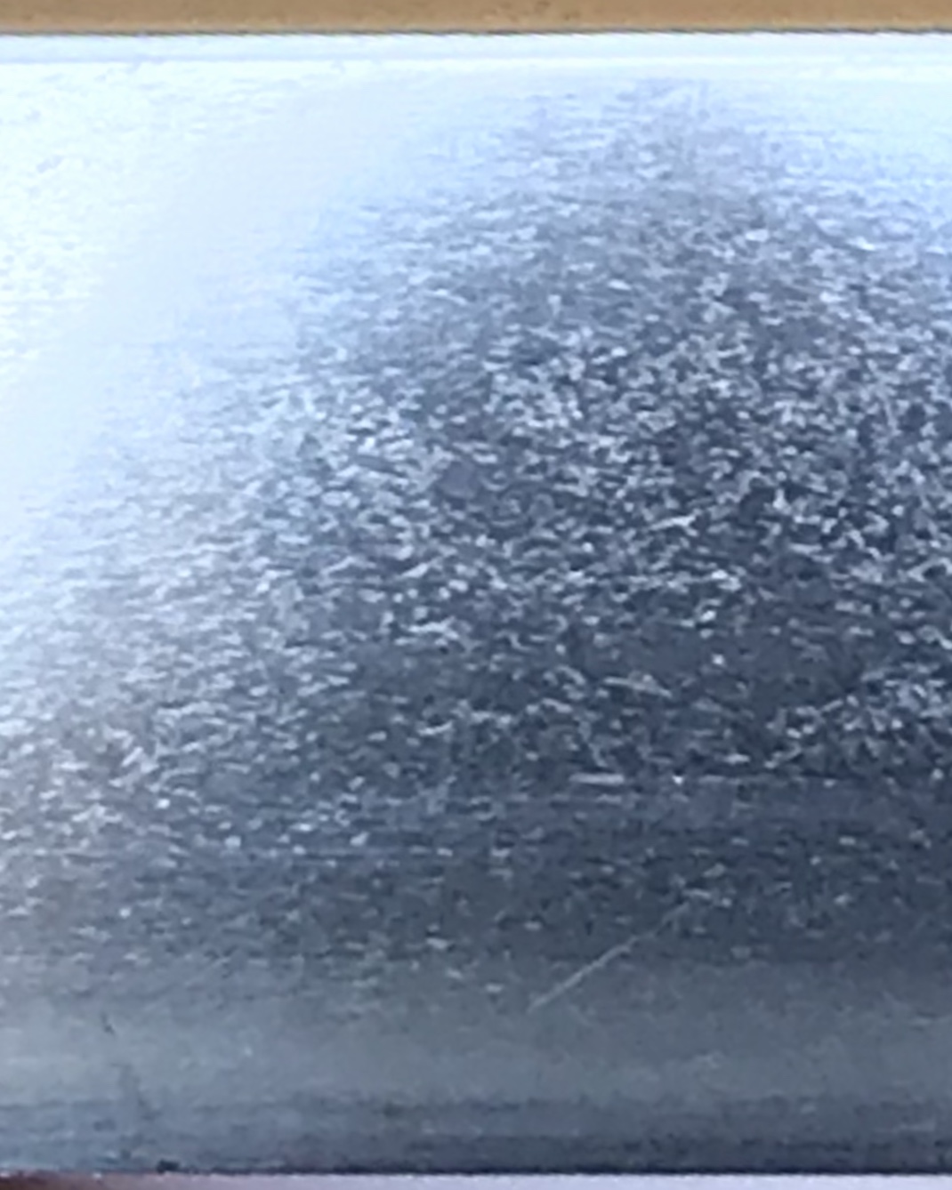

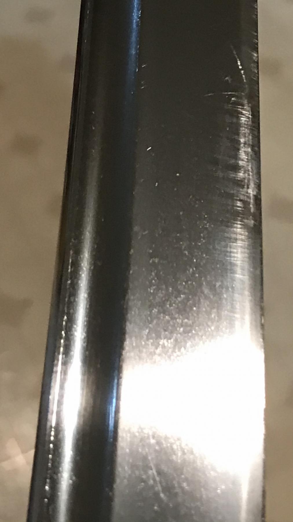

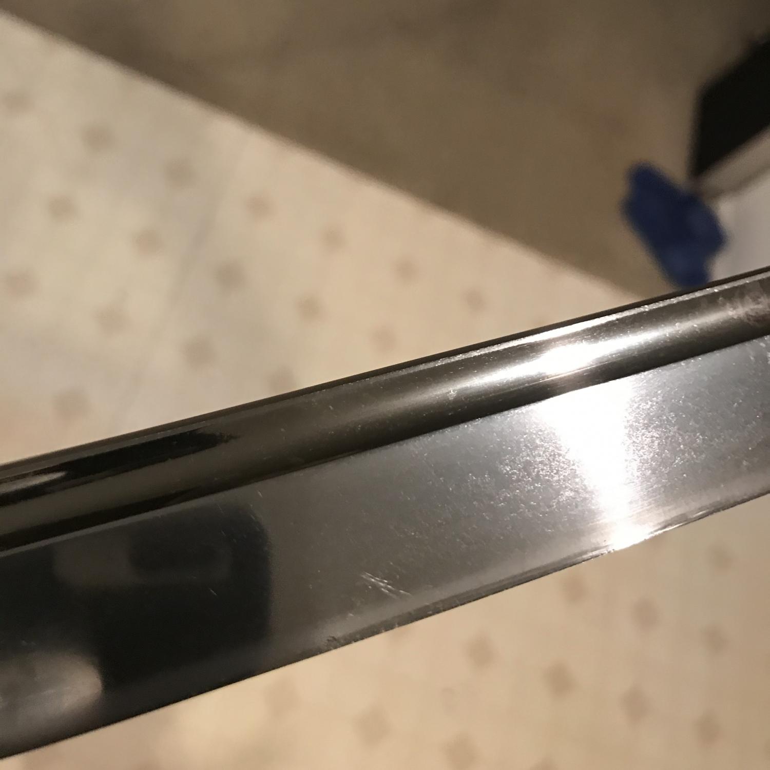

Utopianarian Posted May 24, 2020 Author Report Posted May 24, 2020 Last night finally got the chance to spend more time taking a closer look at blade. I turned the lights off and used a small penlight and saw a neat hologram like or 3D type of utsuri above Hamon. One type of utsuri appears and when I would move the angle of light source another would appear and the original one I was looking at would disappear depending on the angle I was moving. I looked it up and believe it’s called Dan utsuri. One utsuri layer looks darker and wavy or midare and the other is lighter misty white that looks more straight in appearance. It’s almost impossible to capture it in a picture. This is the only blade I’ve ever handled and owned that has this feature and very excited. I think I will use Jimmy Hayashi from SanFran for the full polish on this one. This blade does have all the features of an Aoe school blade. 1 Quote

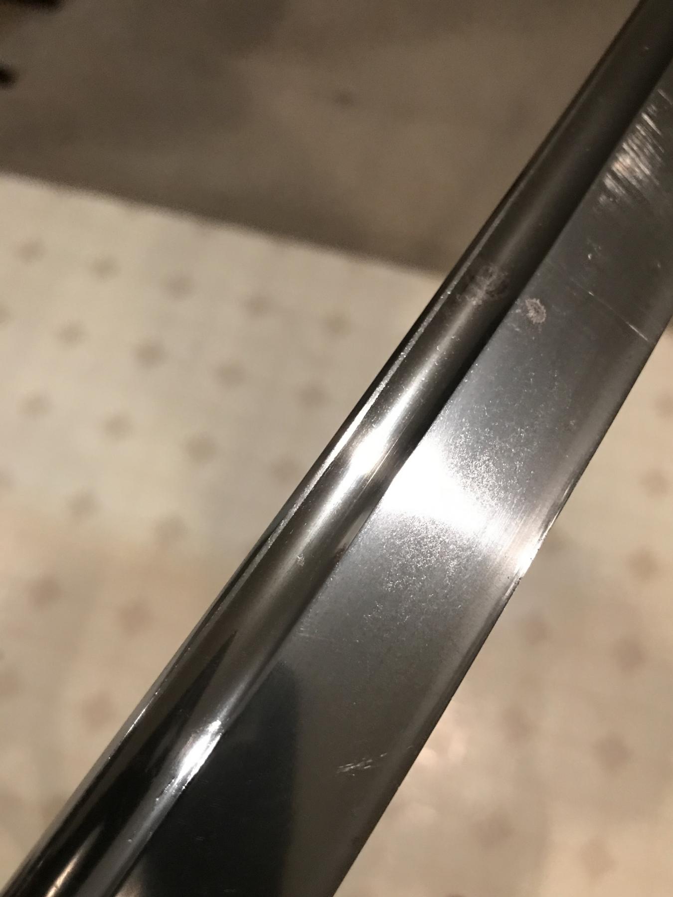

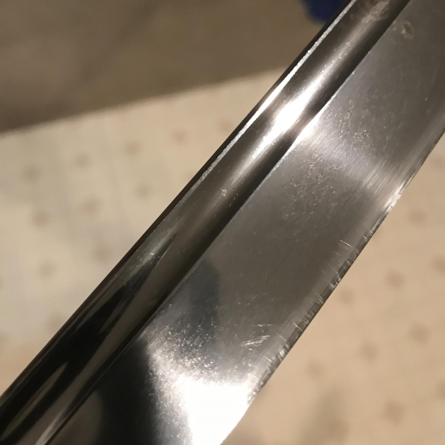

Jussi Ekholm Posted May 30, 2020 Report Posted May 30, 2020 It is very interesting sword George. Unfortunately I think your pictures are too close up and bit blurry as I cannot see details well, can also be my eyesight and current condition of the sword. Will be nice to see the sword if you will have it polished in the future. Quote

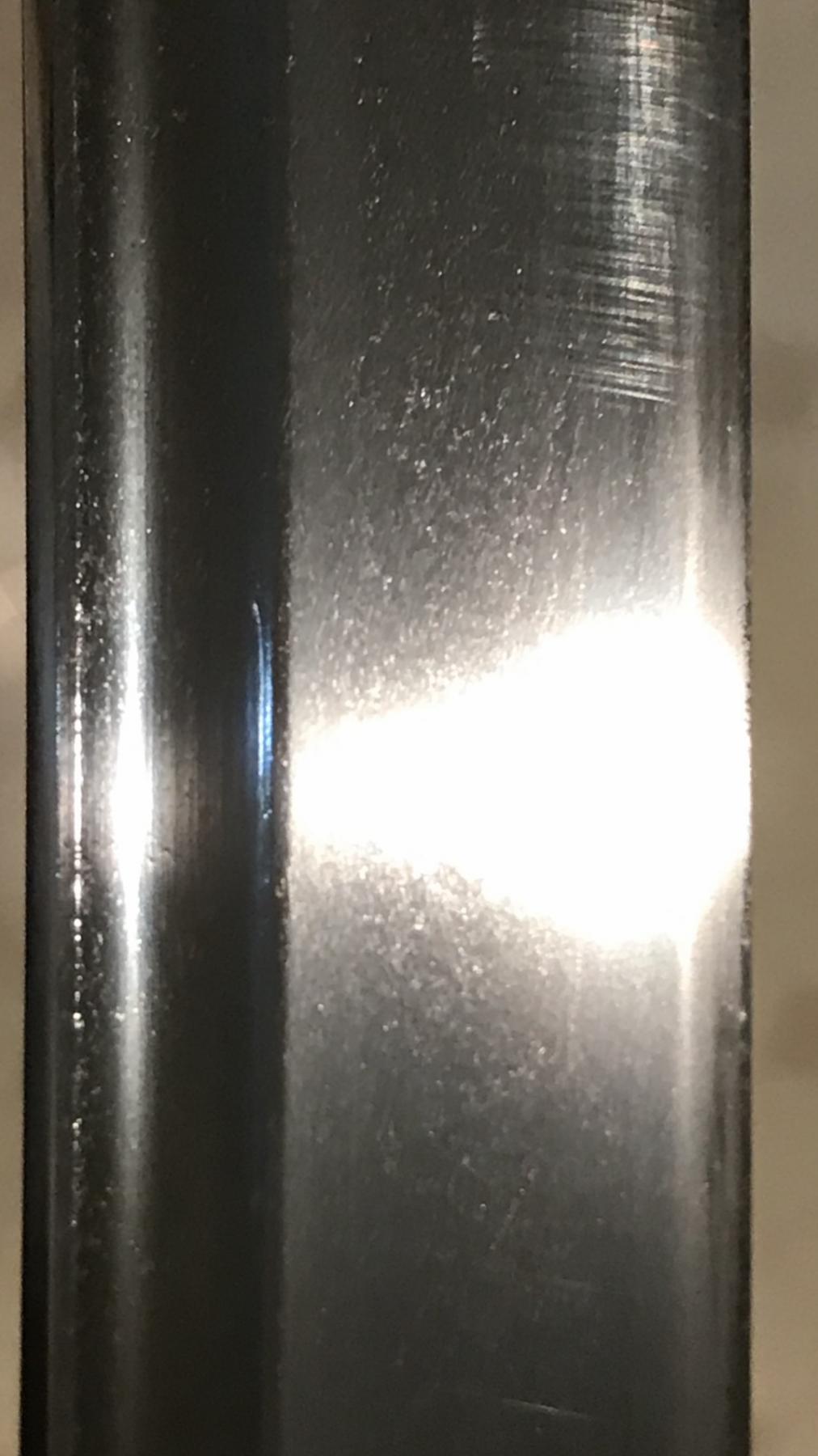

Utopianarian Posted May 31, 2020 Author Report Posted May 31, 2020 Here is about the best pics I can get at this present time Quote

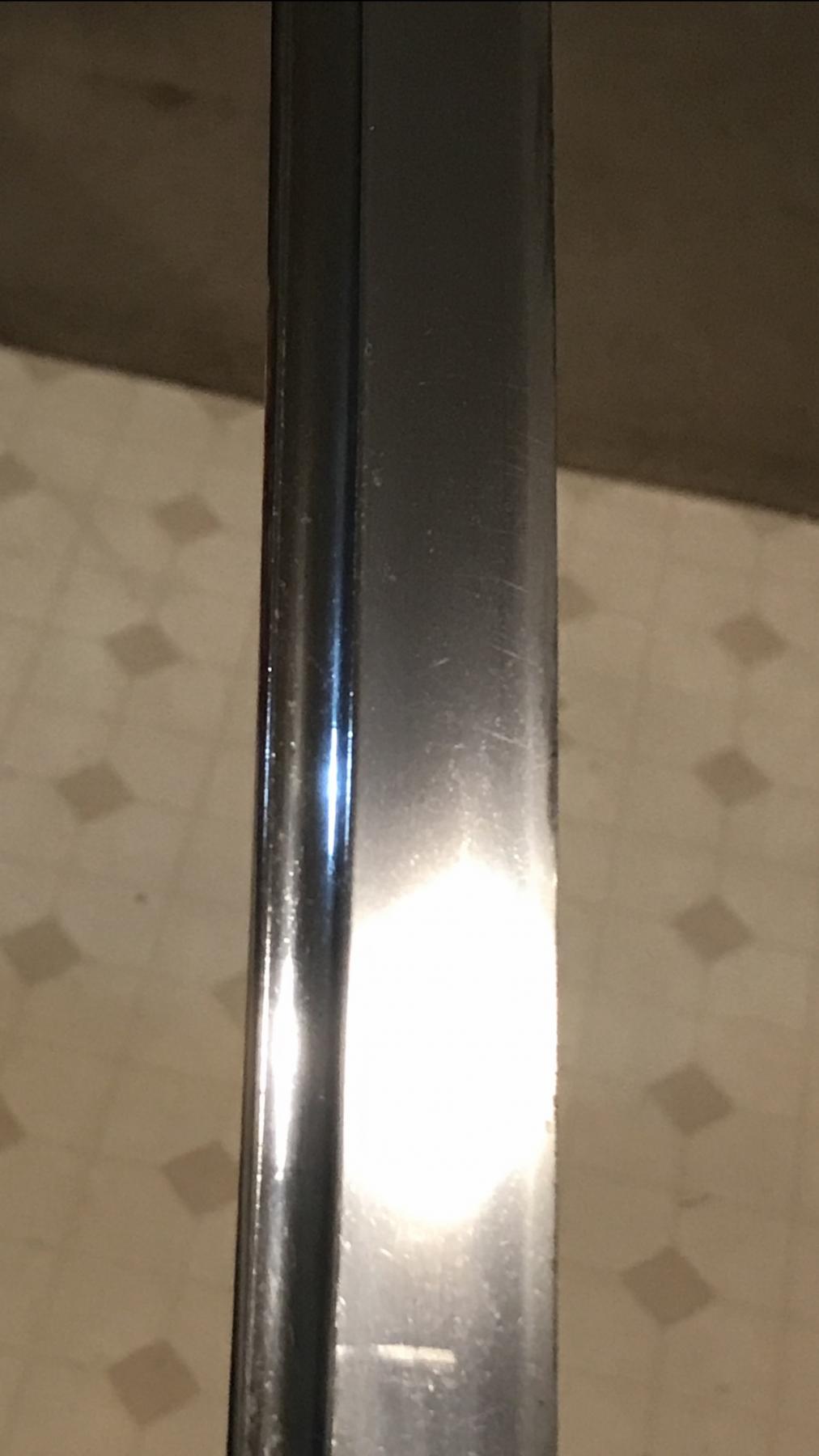

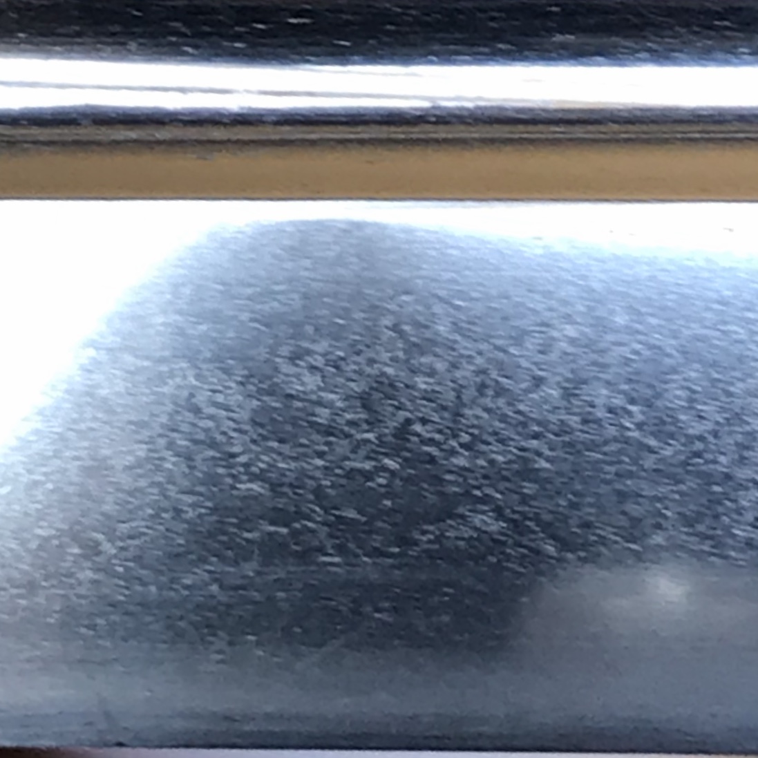

Utopianarian Posted June 1, 2020 Author Report Posted June 1, 2020 Sumigane is hard to get in pic. The blade is healthy with lots of meat (niku) no core steel showing. Here is the best I can get to show example of what I think may be sumigane 1 Quote
