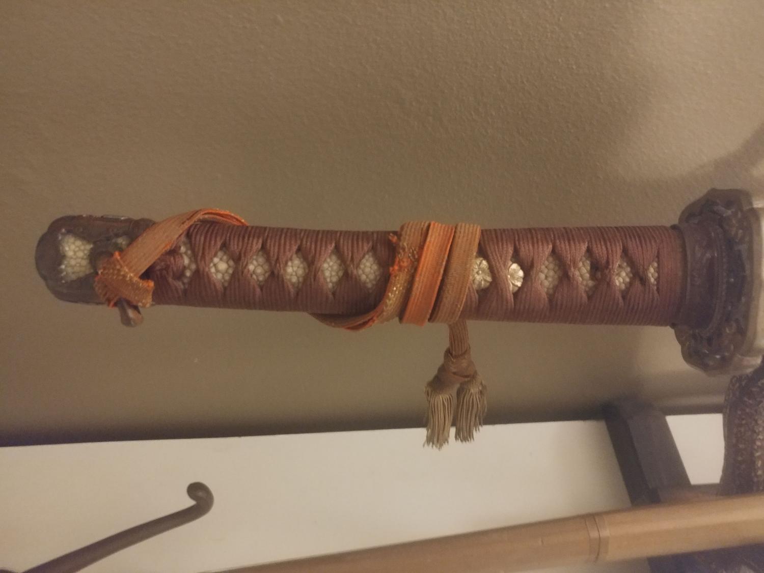

PNSSHOGUN Posted April 13, 2020 Report Posted April 13, 2020 From my experience Emperor nodes were fairly normal on the early, higher grade Type 94/98 swords. This is the only Shin Gunto I have with an obvious full Samegawa wrap, funnily enough the large Emperor node is nearly covered by the Ito knot: 1 Quote

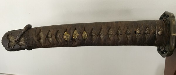

Bryce Posted April 14, 2020 Report Posted April 14, 2020 I also have one gunto with a full same wrap with emperor node. Cheers, Bryce 3 Quote
PNSSHOGUN Posted April 16, 2020 Report Posted April 16, 2020 Great example Bryce, the full premium wraps seem to be more extant on these early swords. Quote
