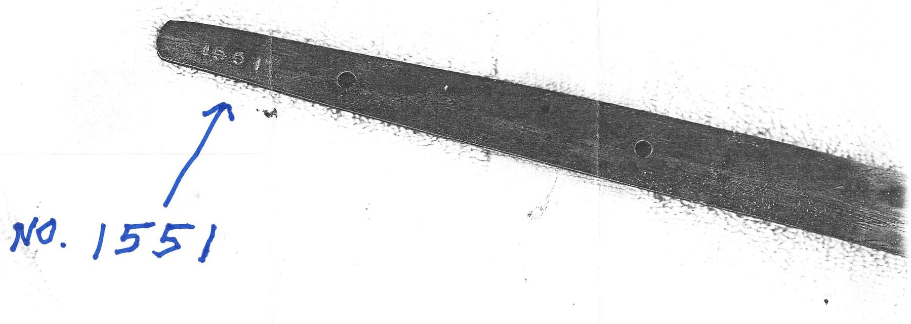

Kiipu Posted November 29, 2020 Report Posted November 29, 2020 I ran across some pictures of a Jinsen Pattern 7 sword, which is the same type of sword pictured above, while going through my files. What was different about these pictures is that the owner removed the wooden grips and took some pictures of the nakago. Unfortunately, the pictures were printed on copy machine paper and thus the quality is somewhat lower than to be expected. Below are the details of the nakago markings. The reverse of the nakago is stamped with the number 1551. The obverse of the nakago is stamped twice with the inspection mark ヘ. In addition, the obverse side of the scabbard below the hanger is hand carved with the following inscription. WW2 N. Korea '45 I know of one other Jinsen made sword, a Pattern 8, which has a nakago serial number and it can be seen at the link below. Questions about "late war", NCO swords 1 1 Quote
Bruce Pennington Posted November 30, 2020 Report Posted November 30, 2020 On 11/29/2020 at 9:05 PM, Kiipu said: number 1551. Expand Thanks for bringing these to our attention, Thomas. Now we have stamped numbers on Type 95 nakago too. Quote
