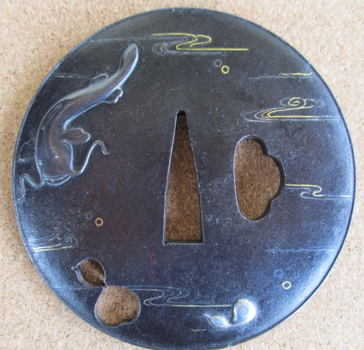

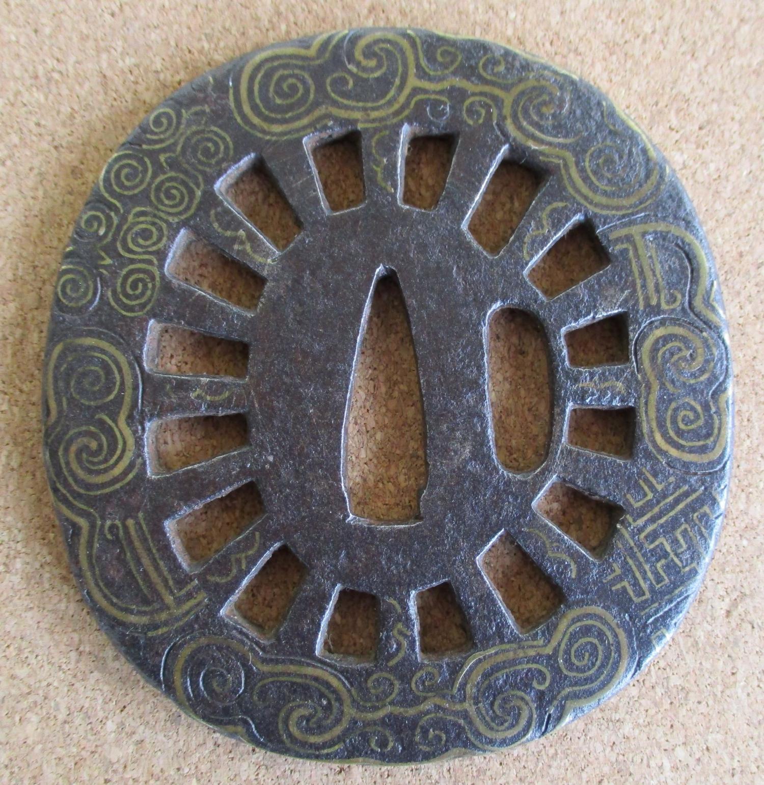

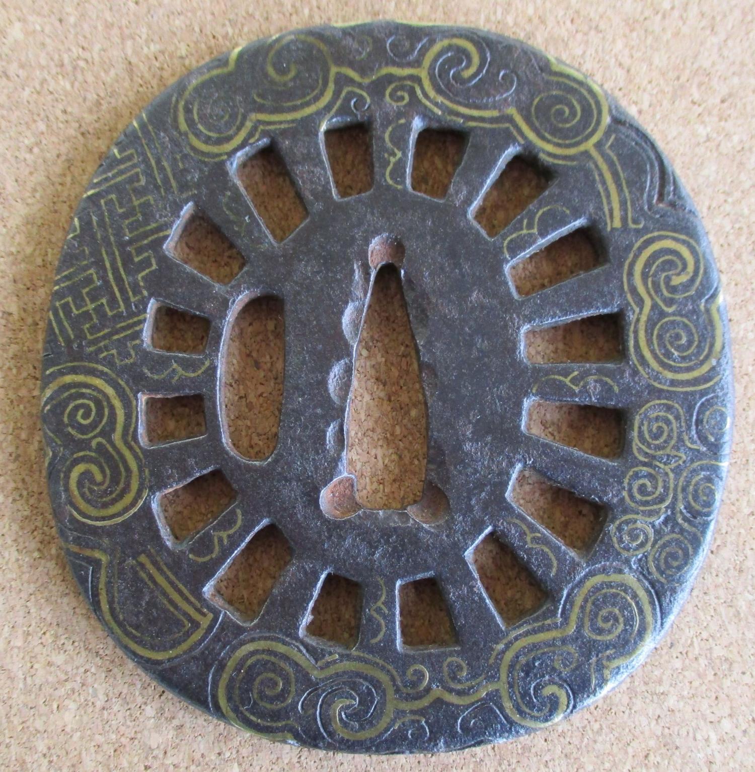

roger dundas Posted April 10, 2020 Report Posted April 10, 2020 As per usual I would appreciate any and all comments members might like to offer . The first tsuba was the first I purchased but in fact is it a tsuba or just something that looks like a tsuba ? It measures 73 x 73 and very thin at the edge, 5mm at the centre area. Iron I presume, shakudo catfish and one gourd, silver the other. It appears competently made to my eyes but I just don't know what to make of it. The second tsuba is the last tsuba I purchased and I think it speaks for itself- I really like it.Am I correct : Saotome plate, later Kaga inlay. Azuchi- Momoyama era. 8.8 x 7.76 x .38 in measurement. If someone wants to be harsh in their comments, I can wear it . Roger d. Quote
Stephen Posted April 10, 2020 Report Posted April 10, 2020 Posted in wrong section. Better help in Tosogu Quote
Ken-Hawaii Posted April 10, 2020 Report Posted April 10, 2020 Agree with Stephen that Mods should move. What makes you think the first tsuba isn't real? Not high-quality, but looks okay to me. Second tsuba is Heianjo. Quote
Tanto54 Posted April 10, 2020 Report Posted April 10, 2020 Hi Roger, The first tsuba has an interesting motif - Catfish (Namazu) and Gourd. It comes from a Zen riddle of trying to catch a slippery catfish with a smooth gourd. The image conjures up the idea of being slippery, elusive or overcoming an impossible task. Here's a National Treasure Painting of the Subject: Here's a Tsuba by Miyamoto Musashi of the Subject: 2 Quote
roger dundas Posted April 10, 2020 Author Report Posted April 10, 2020 Thank you Stephen and Ken. When my internet helper returns we will try to rectify the posting to Tosogu. Ken, you asked why I wondered if the first tsuba was 'for real' was because I have not seen another similar or with such a finely finished edge to the mimi. It doesn't appear to have been mounted so wondered if it wasn't quite modern and meant to be anything but a personal test piece. Glad to see you think it is legitimate. I had wondered if the plate had been turned up on a lathe ? Roger d Quote

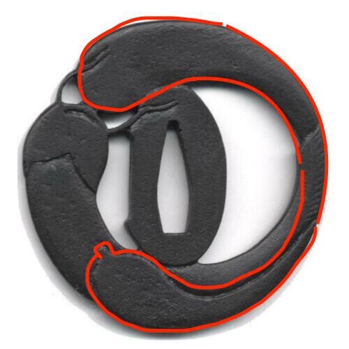

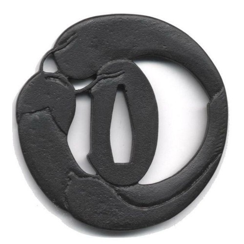

Spartancrest Posted April 10, 2020 Report Posted April 10, 2020 Here is a modern copy of the two catfish - it loses something in translation don't you think? That nakago-ana just isn't right! Quote
Tanto54 Posted April 10, 2020 Report Posted April 10, 2020 Hi Dale, Actually that's one catfish and one gourd instead of two fish. Outlined (poorly...) the gourd in red: 1 Quote
Tanto54 Posted April 10, 2020 Report Posted April 10, 2020 Hi Roger, In addition to the connection that Dale noted above (great story Dale!), the Japanese also believe that the Namazu can predict earthquakes. I remember seeing one in a tank at the top of the Tokyo Tower (years ago), and its purpose was to warn visitors giving them time to get out of the tower before an earthquake hit. In the case of your tsuba, because the Namazu is coupled with a gourd (or two), the meaning is the Zen Riddle that I mentioned instead of having to do with an earthquake. Quote
roger dundas Posted April 10, 2020 Author Report Posted April 10, 2020 I love the way these discussions develop with the cross fertilization that goes on and how memories get prodded and new information emerges. Your Catfish and Gourd certainly fits the theme of all three tsuba George so once again thank you. And we know a lot more about Catfish and earthquakes thanks to you Dale and George. Roger d Quote
Spartancrest Posted April 11, 2020 Report Posted April 11, 2020 George M. 'Post in haste repent at leisure' I spotted that guard on fleabay - catfish - yes that fits the thread - post. Funny I took in the fake nakago-ana and missed the gourd, well it was way past my bed time when I posted it and that's my excuse. You would pass out if you saw the list price on it & its many companions! 1 Quote

ROKUJURO Posted April 11, 2020 Report Posted April 11, 2020 Roger,your entries cause a lot of interest and discussion, so why should you stop that? I have the feeling that "the wisdom of crowds" works well in our little community, and everybody can profit from that. At least it works for me!Concerning your second TSUBA (HEIANJO), I want to add that it may be an early one. Reasoning for my impression is the very level HIRA-ZOGAN and the generally good condition of the inlays. The plate seems to have some age to it as well. Probably Ken Goldstein could give you more info as he is an expert with HEIANJO TSUBA. Valuable general info also on: http://www.militaria.co.za/nmb/topic/18119-heianjo-zogan-tsuba-serial-productioninfo/ Quote
roger dundas Posted April 12, 2020 Author Report Posted April 12, 2020 Good day Jean and once again I am reassured by your input which seems to me to be always on the mark and well considered. As for the Heianjo tsuba I haven't had it long but hoped it was an earlier piece so am pleased to read your assessment - thanks for that. When I took the opportunity of joining the NMB and mentioned an interest in heianjo tsuba , Ken mentioned then that this was an area of collecting interest for him and I imagine he has many fine examples plus a deep knowledge also. I have been trying to dig another word out of my brain to describe your NMB; it came and it is ...the" scholarship " that you members have and generously share ! Thanks again, Roger d Quote
Bazza Posted April 12, 2020 Report Posted April 12, 2020 On 4/11/2020 at 8:55 AM, ROKUJURO said: Roger, your entries cause a lot of interest and discussion, so why should you stop that? I have the feeling that "the wisdom of crowds" works well in our little community, and everybody can profit from that. At least it works for me! Concerning your second TSUBA (HEIANJO), I want to add that it may be an early one. Reasoning for my impression is the very level HIRA-ZOGAN and the generally good condition of the inlays. The plate seems to have some age to it as well. Probably Ken Goldstein could give you more info as he is an expert with HEIANJO TSUBA. Valuable general info also on: http://www.militaria.co.za/nmb/topic/18119-heianjo-zogan-tsuba-serial-productioninfo/ Gee Jean C, if I ever knew of Ken's HEIANJO TSUBA link I had forgotten all about it. I enjoyed the read/re-read and I think I can truly say that NMB is the place where there is more "forgotten knowledge" than many of us know about... Sadly, I can't spend all of my waking hours here, though I think my Better Half wishes I would surface for a breath of "outside" life more often... BaZZa. Quote

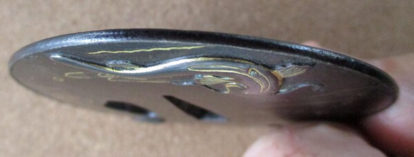

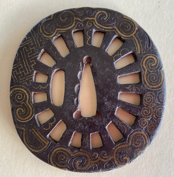

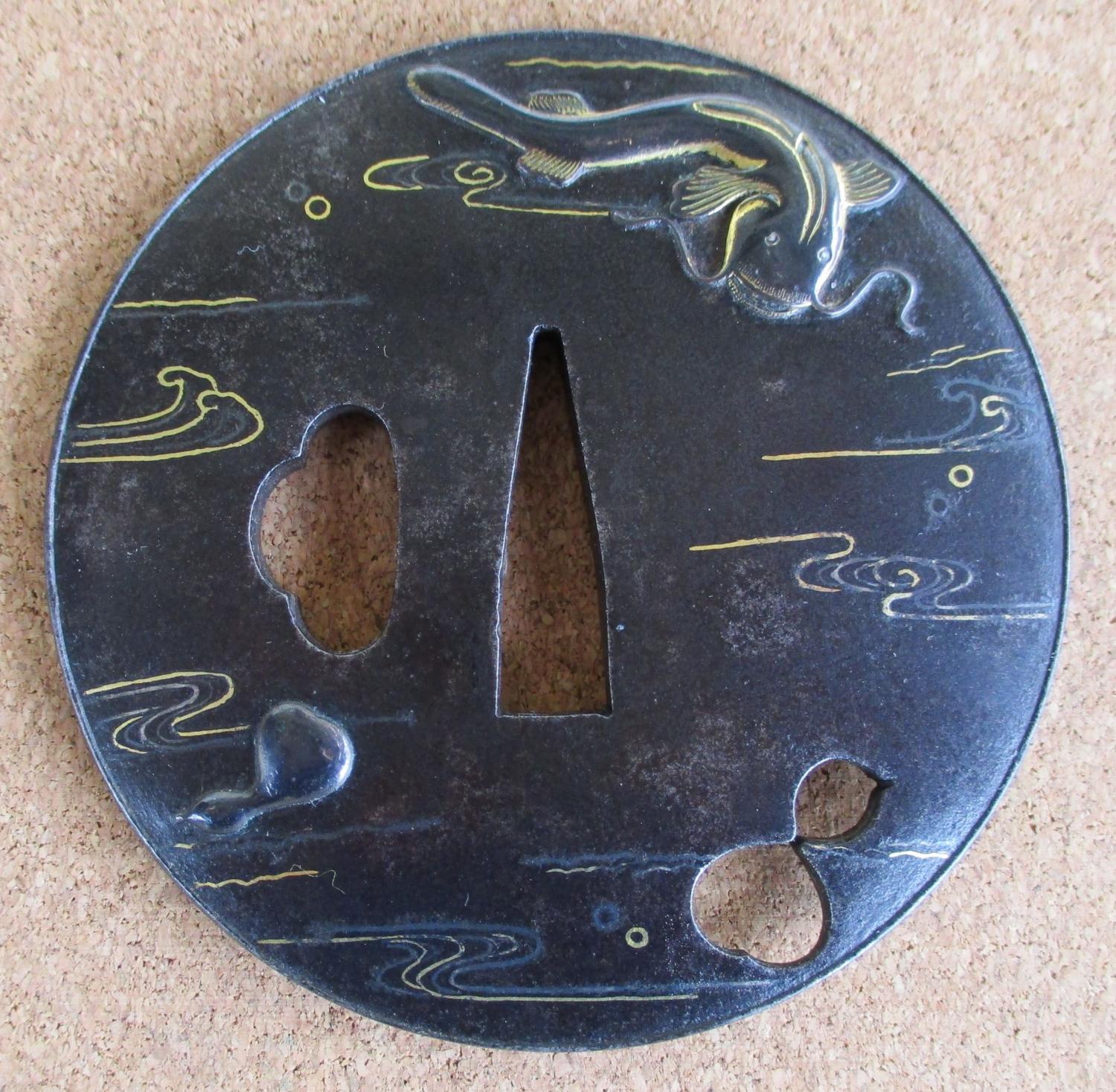

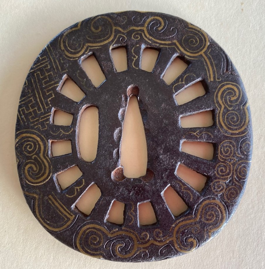

roger dundas Posted May 10, 2020 Author Report Posted May 10, 2020 My photographer wife wasn't happy with the original pics with this post and thought they didn't do justice to the tsuba. She has taken some others hoping to improve on the originals. Let's see. Roger D 1 Quote
Bugyotsuji Posted May 10, 2020 Report Posted May 10, 2020 Both good tsuba, and good shots of them! Quote
roger dundas Posted May 10, 2020 Author Report Posted May 10, 2020 Just checked again to see the improvements to the pics and we found your response Piers. Thanks for your comment and it added to the pleasure of her mother's day. Well done. Roger d Quote
