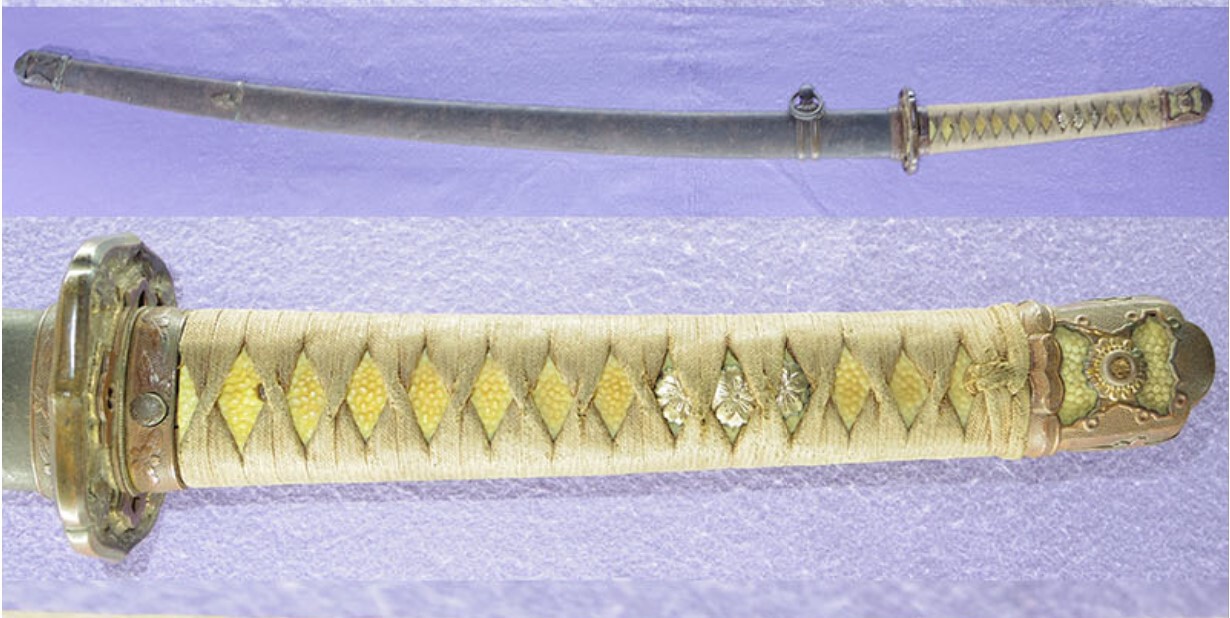

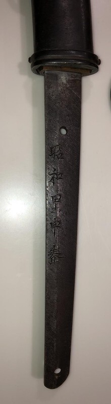

This sword, the MRS model, has been discussed on other threads, so I thought I would pull it together on one topic. This can be a focal point for other contributions from interested collectors in this model.

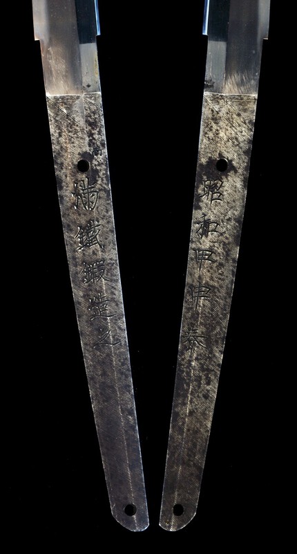

It appears that all examples examined have Mantetsu blades, some without a mei.
It's basic design reflects the limited capability of equipment at the Nan-Man factory.
The same on all known examples, is a heavy duty cotton fire hose material.
Production looks like late 1944 through 1945.
No paint is evident on the saya, but looks like a gun bluing or browning.
Ito handle wrap colour, varies from brown to black .
Small variations exist across the examples known to exist.
I reach out to others to add more information, and photos of other examples .

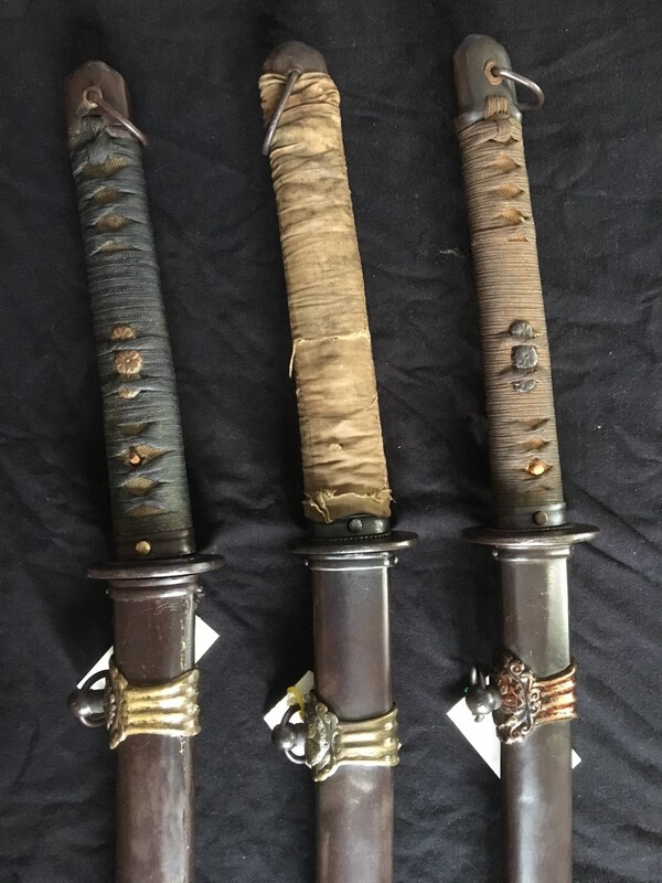

Trystan, when you see WW2 photos of troops with swords, many have a canvas or cotton cover for protection. Very few of these covers remain. I am leaving this on. But when I lifted it the handle looks perfect.
I saw most of them have white cotton on ,not many canvas though.
 It's a tradition that goes back to Edo and probably earlier still, which makes sense when you have a silk wrap on the hilt. Very nice indeed to see an actual WW2 example. Thank you for the photo.

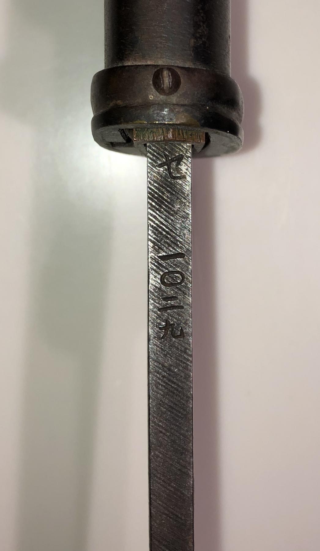

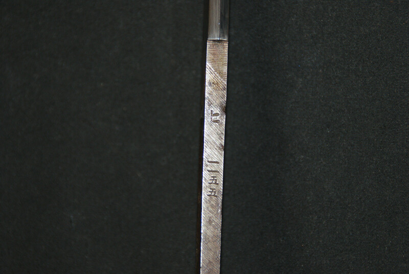

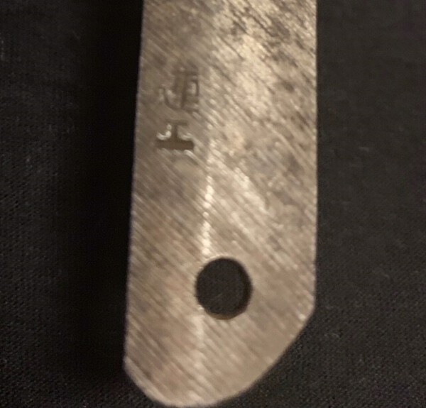

Forgot this thread was started.  I'm copying my post from the other thread:
Couple of updates on this:

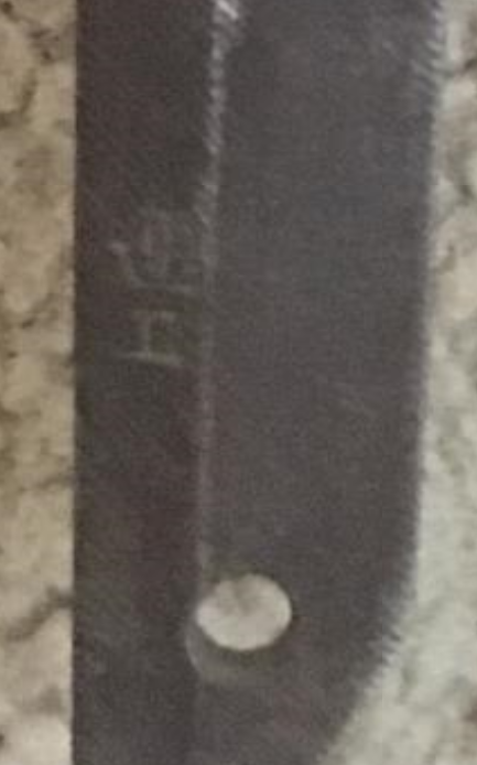

1.  Trying to find anyone, either here or on Warrelics, that has documentation or insight to the 連工, or Renkoh stamp (got the English pronunciation from Nick).  I'm starting to agree with Thomas (Kiipu) on the idea this was a contraction, like Mantetsu is for SMR, for the 大鉄道場 Dairen Tetsudō Kōjō Dairen Railway Workshop, who was the SMR shop making Mantetsu swords.  My reasoning is the location of the stamp on the end of the nakago.  It is not a normal location for an inspector stamp on Japanese blades.  Inspector stamps are found near the tsuba/seppa and on the mune.  The only inspector stamp found at the jiri of any blade is the M or W.  What we DO see is personal Kao and Hotstamps of  smiths, and we see stamped numbers which are either put there by smiths or by the fittings shops.  Either case COULD mean this Renkoh is the name of the shop, not an inspection stamp.
2.  I also think it's significant that the stamp is only found on the MRS fitted blades.  I wish it were true of ALL MRS blades, but it's not.  After perusing my files, I've found 6 1944 Mantetsu  and 2 1945 mumei Mantetsu in the MRS fittings:
1944
セ 1099
セ 1143

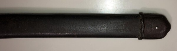

セ 1310 (with leather saya cover!)
セ 2430
セ 2575
?  199
1945
い 1170
Richard Fuller's mumei Mantetsu (unstated serial number)
Only 3 of those - 2430, 2575, and 199 - have the Renkoh stamp, although I don't have a full-length nakago pic of the 199 or 1066 blades (so they COULD be Renkoh stamped).
That canvas protection is seen often on old ww2 soldier photos when the tsuka is shining white. Its very rare to have it. Neil has an outstanding collection.

Bruce, if you go to my last post in Mantetsu owners, a survey, you will see the 1938 MRS outfit with the cloth wrapped handle, and the blade stamped with the Railway stamp, and dated 1938.
This reinforces my hypothesis that the MRS (blade and koshirae) sword was a unique and individual model in its own right.
I suspect they were made for the Japanese troops stationed in Manchuria, and probably designed there. As PNSSHOGUN (John) suggested somewhere, the fittings have an almost Chinese design look about them. Remember in the Ohmura study, it is mentioned how Japanese blades would break in the cold Manchurian environment. And this was one of the drivers for a steel to be developed to withstand the cold. "Mantetsu".
I have examples spanning 1938 to 1945, all with Mantetsu blades.
So again, theories like, late war home defense swords, Rinji prototypes, etc, I think can be ignored.
Another reason why these swords are so rare, and never show up in photos of swords surrendered in the Pacific.

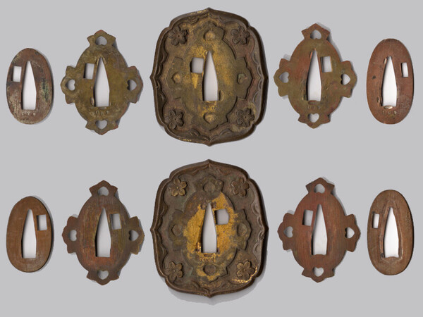

I assume you mean the ones in Type 98 fittings.  Here they are:
Spring '44 HI 1155 (only have pics of the tsuba/seppa)
IMG_1960.thumb.JPG.1419394296d81e8e5564f509b7ce852e.JPG20200120_125414.thumb.jpg.80bf6e26a02addf8f9d49da6b3914389.jpgIMG_1962.thumb.JPG.c791a5c86fb7cfbc34793104580c57c9.JPG
Spring 1944 MO 228
893406261_Screenshot2021-02-03135851.thumb.jpg.26bb40210bca4cdd917ff733690d9bf3.jpg1124627097_Screenshot2021-02-22075336.thumb.jpg.bf4882475ca78c89cfab42f69efb0c07.jpg
Spring 1944 (no serial available):
post-855-14196801217482_thumb.jpg.5a312503750abf0ac034004ab8eabc9b.jpgpost-855-14196801220926_thumb.jpg.858ca554d4948e3c70a593a80b859d23.jpg

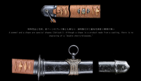

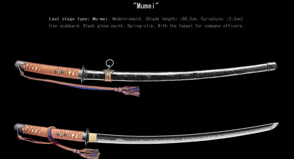

Just discovered this on Ohmura's site HERE.  It seems to be the MRS fittings with a mumei blade.  The problem is that the blade has quite a non-suguha hamon.  So, either this is a 1945 Mantetsu blade with a very non-standard, maybe custom, blade; or it's a blade by someone else than SMR, and they buyer purchased an SMR rinji set of fittings; OR the style is not exclusive to SMR.
In WWII, we can never say never, never say always!
2 hours ago, Kiipu said:
Beat you to it.
Dang!  But my pictures are better than yours! Ha!
To horribly abuse a famous quote: "I've forgotten more, than (I) will ever know!"
Worked out, though, as this is the thread it needed to wind up on.
