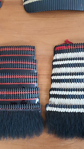

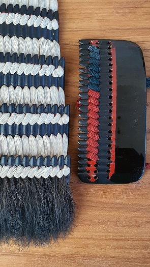

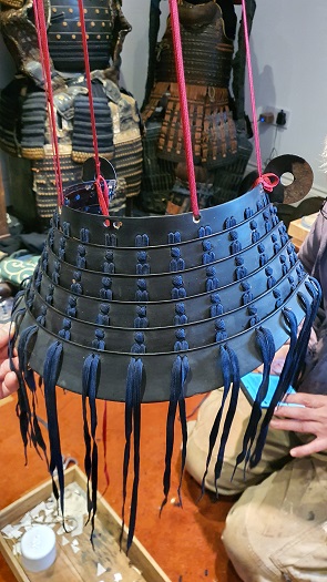

I carefully removed the shikoro from the hachi making sure the shanks of the byo remained intact as
well as the ukebari liner. Before proceeding to remove the disentregrating odoshi I made plenty of
photo's of all angles for references. Stripping the odoshi ever so gently away from the lames so
not to damage the urushi. Some holes were the rust particles merged with the odoshi became
as hard as concrete and had to be drilled out. After this was done I treated the lames with kikko mol polishing paste and consolidated the hairline cracks.
