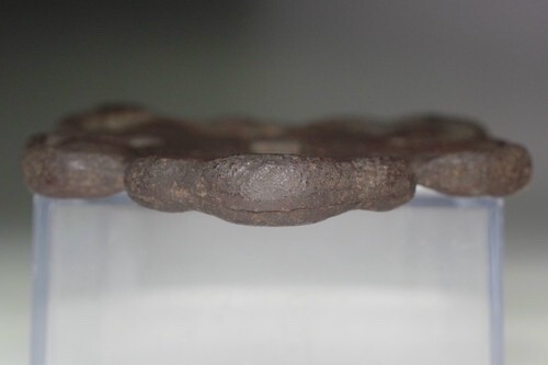

These are very well made and the iroe is often very well done but there is no inlay and the colour is only applied as a surface coating, The sekigane and ategane are simulated. Other versions have no iroe, the tegane-ato marks around the nakago-ana are always identical [though some are more 'crisp' than others]

It's an old but interesting topic. In Moscow, this quality of tsuba is being sold only now by 3 sellers. More than $1,000 for each one. I believe that they were produced at the end of the 20th century - the beginning of the 21st. I compared them thoroughly, the differences in relief are minimal. Obviously, they were manually modified after casting to make them different from each other. The sellers claim that these are copies of the 19th century. Who is closer to the truth?

In my opinion not made for real use. The decoration is partly on the SEPPA-DAI. Recently made with modern technology, avoiding some mistakes of the past, but still fakes.

So I can't find at least one reason why it was done in the 19th century) The quality of fakes is only increasing over time. In this case, all the same cast copies, and then they were given to a person for manual revision. However, this remains just a "coloring book".
