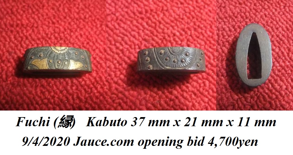

Spartancrest Posted April 9, 2020 Author Report Posted April 9, 2020 George M. Menuki are not my thing - but have certainly seen many that look alike to me, there are also a lot of fuchi that turn up, not the obvious Chinese fakes and modern sword shop manufacturers but once again looking ubu but there are just too many of the same design and not utsushi because they are too much alike. Namban: don't get me started. I have a page layout from my book here, its a bit blurry because of the way I copied it, I have retyped my comments in the lower right corner, it should be noted that a lot of copies have also included tagane-ato imprints in the casting and not added by a chisel so dont try to adjust in this way you will only get a broken replica! Also I have some examples of one of the most common namban dragon cast copies.[The pages have the alternative spelling of nanban.] As well you may not like the other composite picture that shows a range of copies that are very common - and some adorn the collections in the worlds best Museums. There are also copies done in soft metals that are also common. 4 Quote

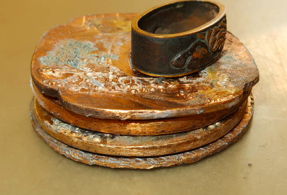

Tanto54 Posted April 9, 2020 Report Posted April 9, 2020 Outstanding Dale! Thank you again. Can you offer more about how you believe the molding and casting were/are done? The many fake gold menuki that I referred to appear to be made using wax-injected, vulcanized rubber molding combined with the lost wax method of casting (and that combo has only been available for about the last 40 years or so). I believe that some of the newer fake tsuba are being made that way too. I'm guessing that the older fakes are probably sand casting and the better, "middle period" and newer ones are "green sand casting". I personally think that the Kinko copies with all the added "iroe" are from the last 40 years and are not Meji, Taisho or early 1900's (don't remember ever seeing them in the US or Japan before the last few decades). Quote
Spartancrest Posted April 9, 2020 Author Report Posted April 9, 2020 I am unsure of the production methods, some of the castings are very detailed and I would think lost wax method unlikely. When did injection molding of iron start? There are some copies that look stamped out like coins, this is not some backyard operation it is high tech factory production. I know a lot of Kinai school pieces were production line produced copies of famous designs. I think that the majority of iron copies are older than 40 years - examples in 19th century collections are evident. I did just purchase some obvious repro menuki (Gold as it happens). That I intended to use as decoration on my tsuba display boards, they are still on their way. Paid 1,000 yen about $12, the seller must have heaps he sells them in batch lots! Quote

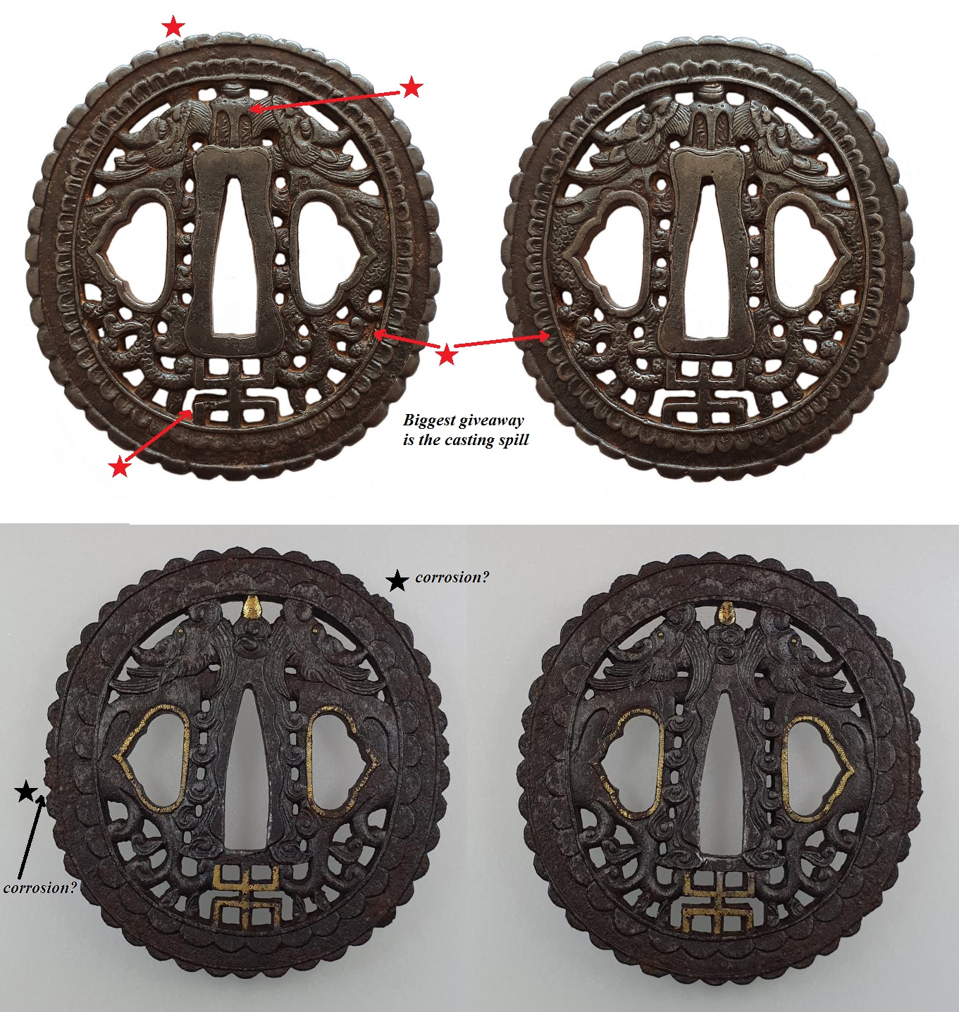

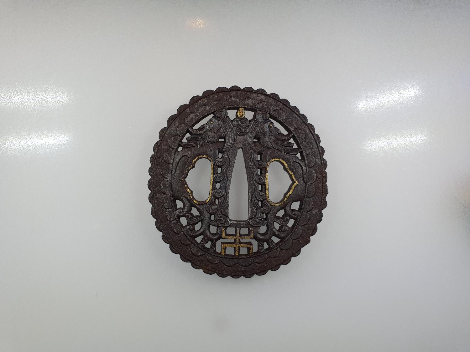

Steves87 Posted April 9, 2020 Report Posted April 9, 2020 Hi Dale, Regarding your commonly cast Nanban pages, I have this example which I'm fond of (even though the patina is a little hit and miss) as it appears to be chiseled and has actual button inlay (eyes). Ive looked for a few years and I have not been able to find another similar. I suspect this is a relatively new Tsuba example. would love to know what you think, apologies if this is not the time or place for this, I can pm if better edit: Chris, your post wasnt there when I was typing, that is amazing! 1 Quote

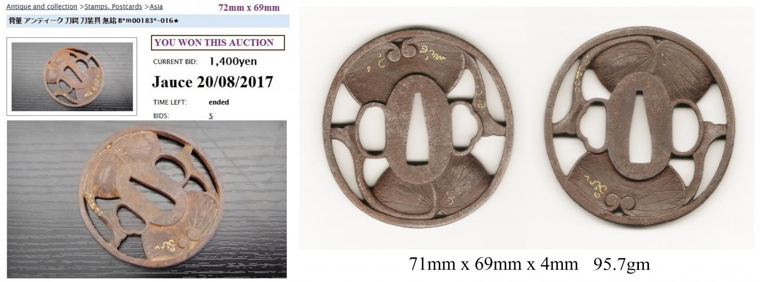

Spartancrest Posted April 9, 2020 Author Report Posted April 9, 2020 Chris S. & Stephen K. Well they look like a much better guard in this design than average, obvious fine carving but what worries me Chris is the chip on the top, a casting spill bottom right and the fact it has no evidence of being mounted. Comparing yours and Stephen's you can see they have differences in the inner ring of 'petals' or ornament. Stephen's likewise shows no evidence of having been mounted, it too has fine carving and the eyes as he says look like inlay,also the 'seppa-dai' is finer. What I can't decide is if the beading is faulty or has suffered bad corrosion. From the pictures I can't tell if the beading on Stephen's is hemispherical or just curved in one direction. Don't shoot the messenger, but that cast over-run at the bottom does not bode well, as I think I may have said before a lot of cast guards were reworked (Izarae) to bring out the finer detail. If indeed Chris's guard is Hizen then the Hizen school must have done some casting. I can only go on what I see, to prove my observations check the comparative pics of both guards and the highlighted areas. Sorry but you did ask. 1 Quote
Spartancrest Posted April 9, 2020 Author Report Posted April 9, 2020 George M. Just getting back to you, I have found a picture of a rather too common fuchi with kabuto decoration, I know its common because I had one just the same (for the life of me can't find it though) So there was/is a huge industry pushing out copies of all sorts of fittings and no doubt the sword collectors will include swords as well - just who when and where I don't know - the why is always money! 2 Quote

Steves87 Posted April 9, 2020 Report Posted April 9, 2020 I can confirm bad corrosion and if I understand correctly, I think the beading is just curved and not hemispherical. Dale, I really enjoy your books and comparison pictures, thank you very much for your work Quote
Spartancrest Posted April 9, 2020 Author Report Posted April 9, 2020 Chris S. The patina is good and even, I like it for what it is. Have you any idea how the tiny punch dots got there around the seppa-dai and the bottom cross shapes? They are something different, can't work out what that means. Was the finisher doodling with his tools or did it happen much later? Quote

Spartancrest Posted April 9, 2020 Author Report Posted April 9, 2020 Chris. S. I don't think it was machined - it is a complex construction and really we don't have all the answers as to how they were made. Can you imagine the results Europeans would have come up with, molding iron in such fine detail, it isn't easy [just check out cast iron furniture, its not art work!]. Quote

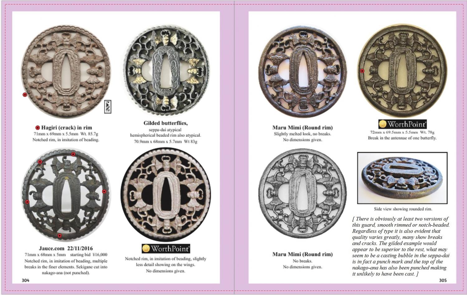

Tanto54 Posted April 10, 2020 Report Posted April 10, 2020 Dear Chris, I have to agree with Dale that it looks like your tsuba was cast or "drop forged" (not hand forged and the sukashi were cast in or made by a mold). I think the "dots" are porosity/casting bubbles, and I think Dale is correct about the other details that he points out indicating casting. 1 Quote

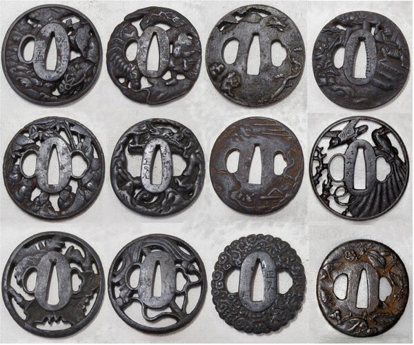

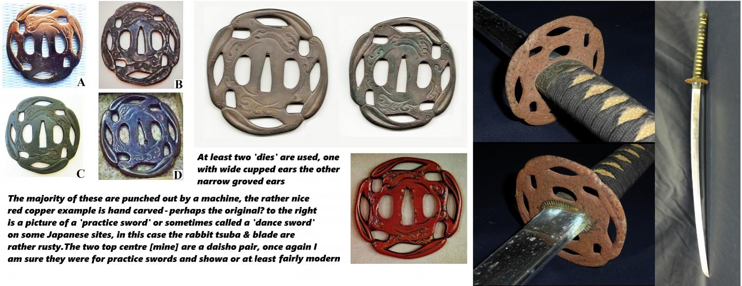

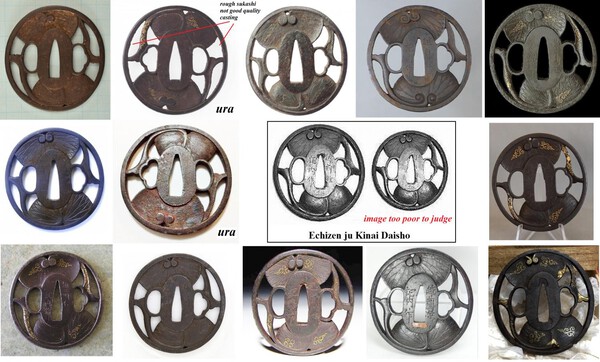

Spartancrest Posted April 10, 2020 Author Report Posted April 10, 2020 Well back to the thread, Now these examples below are a slightly different problem. The Kinai school seems to have ended its days by students churning out copies of that schools classic designs and we are left to determine if the resultant horde of guards were originals, copies or castings. Many of the Aoi leaf designs were embelished with gold scrolls or tendrils and signed by various masters. However even some cast examples were reworked and many of the signatures were faked. By the way there are copies of this design being factory produced as we speak. I do not contend that all these images are of fakes or copies but it is very difficult to judge just from an image on an auction site, so particular attention to detail is necessary to avoid buying a dud. I just checked a Japanese auction site that I look at regularly and noticed that three guards of this design were listed just today. The image below is only about a quarter of the examples I have on record - so many in fact I have given up collecting anymore images of these. I bought one myself rather cheap and rusty likely a copy never mounted but don't believe it is cast. - My house has tiled floors so if I drop it maybe it will survive, not sure I want to find out though! 3 Quote

Spartancrest Posted April 12, 2020 Author Report Posted April 12, 2020 Posted 09 April 2020 - 08:53 PM George M. [Just getting back to you, I have found a picture of a rather too common fuchi with kabuto decoration, I know its common because I had one just the same (for the life of me can't find it though) So there was/is a huge industry pushing out copies of all sorts of fittings and no doubt the sword collectors will include swords as well - just who when and where I don't know - the why is always money!] ----------------------------------------------------------------------------------------------------------------------------------------------------------------------------------- Just come across another example of the common fuchi pattern on Feabay- I do hope it doesn't belong to a NMB member. https://www.ebay.com.au/itm/Antique-Japanese-Fuchi-Kabuto-Kuwagata-Sword-Fitting-Tsuka-Handle-Koshirae-Old/254566280821?hash=item3b45552e75:g:-E4AAOSwfaZZuK2S it is not identical but there is a definite trend here. Quote
Brian Posted April 12, 2020 Report Posted April 12, 2020 Just beware not to start giving the impression that any of the same designs must be repro or cast or copies. The schools had pattern books, and mass production of fittings was a valid and known thing.So you really have to examine each item for signs of casting or identical flaws. Same designs can still be perfectly valid. 3 Quote

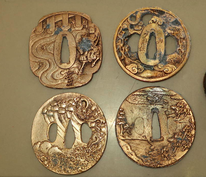

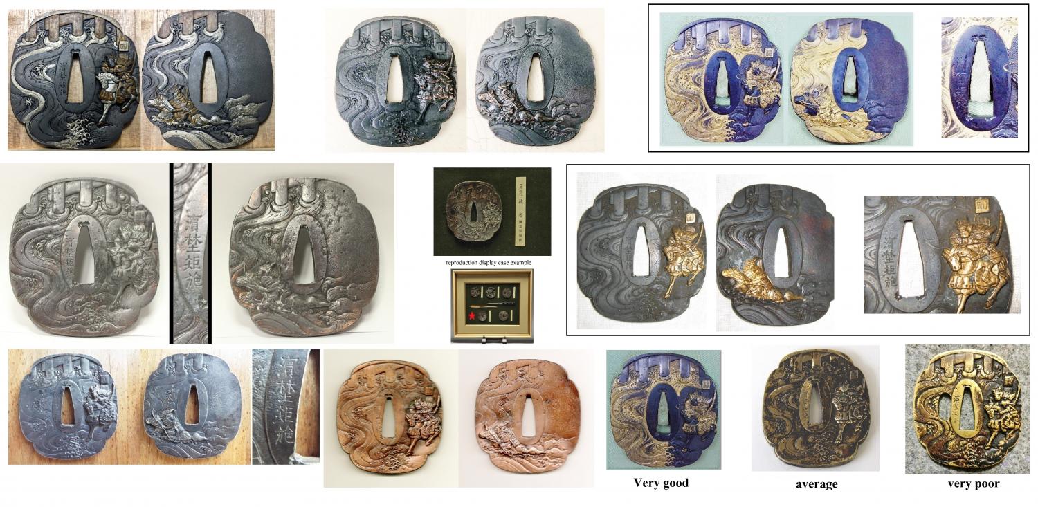

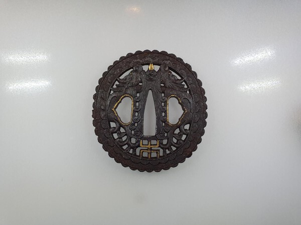

Tanto54 Posted May 5, 2020 Report Posted May 5, 2020 Here are some leftovers/rejects/partially finished fake tsuba that are being sold on Yahoo Japan right now. One of them is the same model that Dale has been following and he posted an excellent photo comparison page above (and reproduced below). These are clearly modern fakes/reproductions and are not antique or vintage school copies or utsushi. You can see the flash from the molding process. As Dale points out, these could be from a reproduction display and are now being sold as "tosogu" on Yahoo Japan. Dale's Page: From Yahoo Japan: 1 Quote

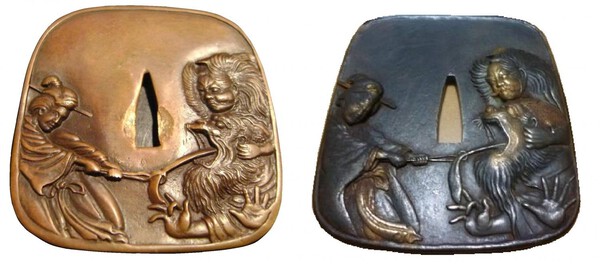

Spartancrest Posted May 5, 2020 Author Report Posted May 5, 2020 George M What fascinates me is the range in quality of these fakes, they range from beautifully detailed with great iroe (though no inlay) to others so coarse that the features are almost totally lost. The same applies with the 'geisha pulling the tongue of the monster' examples, as well as the 'Oni and Futen'. Both appear in large numbers and no doubt other examples apply. I am aware that many fakes/ copies were made for glass cased sale items but I don't know if they were intended as domestic decoration in Japan or purely for export. It is an interesting side to serious collecting - I fear for novice collectors. 2 Quote
