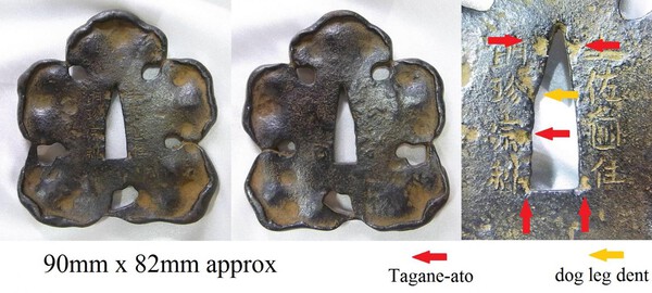

Spartancrest Posted April 5, 2020 Report Posted April 5, 2020 This subject has been discussed previously as far back as 2011, but just a short update on the growing number of these "tsuba" to use a word very loosely. I have added an often neglected view showing the bottom edge where the giveaway casting marks are often found. Collectors should be made aware of these often high priced 'Paper weights'. I continue to collect images of these things as they continue to pop up, there are a few right now on auction sites so have a real close look when you buy. 6 Quote

Brian Posted April 5, 2020 Report Posted April 5, 2020 Very interesting info Dale. The pics show a number of identical examples that could only have been duplicated by moulding.I'm assuming not all of these are cast? Quote
Spartancrest Posted April 5, 2020 Author Report Posted April 5, 2020 Brian I have seen some examples that are close to this design that were hand cut [ the one pictured is clearly in a league of it's own ], but I am just giving a caution on the large numbers that are copies. I have also seen a large number of what purport to be Hamano guards that are also copies - the difference with those being they are sometimes in different metals and some have iroe (colouring) but every one has the same simulated tagane-ato marks done with a Chysanthemum punch - the detailing is mainly good though some are very worn because of the soft nature of what-ever alloy was used. I watch with some alarm at some of the set prices on a few of these that reach into the thousands of dollars - especially since I purchased one for less than ten dollars [knowing full well it was a copy] I also know that there is one original or at least utsushi that is on the market now with N.B.T.H.K Hozon papers selling for ¥530,000 - which puts it out of my league! Some people may not like to know, that what they have are only copies - especially if they have paid big dollars, but equally others may be relieved they didn't 'invest' in a fake. I have plenty of other 'mass-copy' files on record. 2 Quote

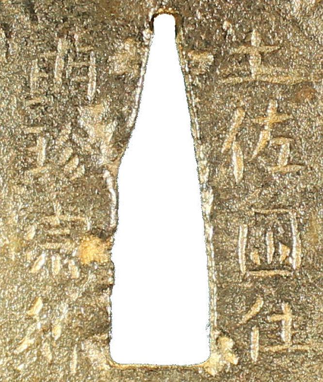

Spartancrest Posted April 6, 2020 Author Report Posted April 6, 2020 Grev So sorry to be the bearer of bad news, yes your guard is a typical copy. Almost all have an identical nakago-ana - though a few have casting spills at the top of the hole making it even narrower. I don't know how they were made so well so often! I assume the maker didn't have injection molding! The mei is sometimes blurry, worn or non existent - so possible multiple 'die' were used. I have mine before me as I write, they are certainly big bold and heavy! Just checked my records and found it cost me all of 23 yen [approx 25c] - postage and fees were most of the bill! Thats a bargain even for a paper weight. For others out there I have posted an image showing the main points to check out - I love this forensic stuff! Ps. Can I add the image of your guard to my ever increasing data base? 4 Quote

kissakai Posted April 6, 2020 Report Posted April 6, 2020 Hi Dale Thanks for the bad news! Live and learn I should have a least spotted the misshapened nakago ana Of course you can keep a copy Grev 3 Quote

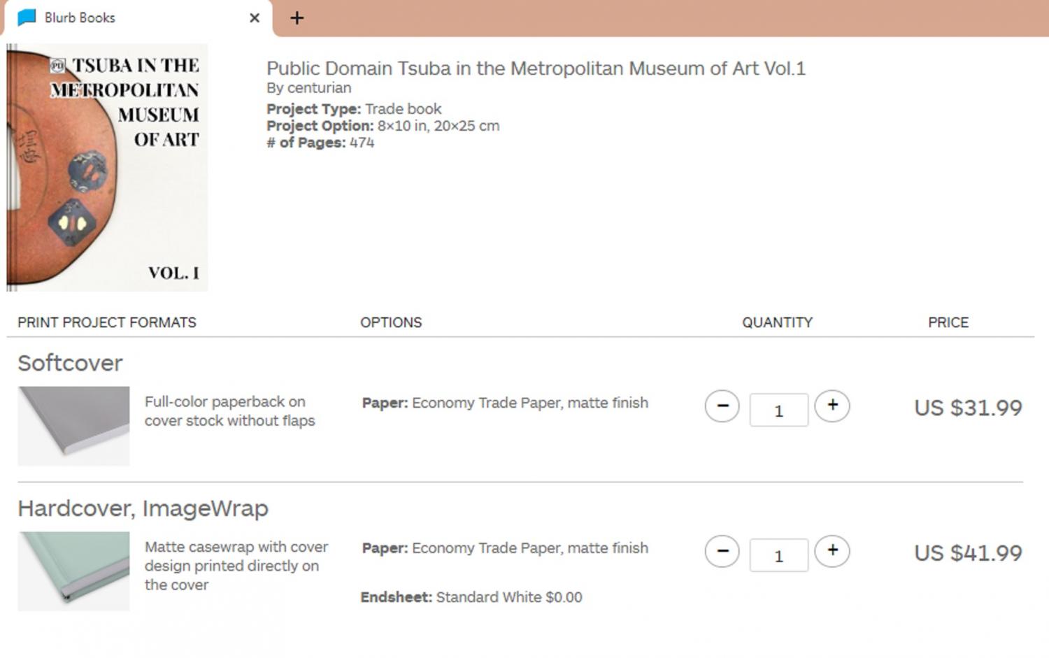

Spartancrest Posted April 7, 2020 Author Report Posted April 7, 2020 Grev Boston V1? Metropolitan Museum you mean? Amazon is very confusing price wise they offer second hand editions of books that are not even printed yet!, Vol 2 should be cheaper than volume 1 it has slightly less pages, I bought my copies direct from Blurb.com who do my printing - found they have a better range of paper options and four or five print qualities - To keep price down on the theory that cheaper would make them more available to the many - went for economy printing. Would recomend looking at more book sale sites than Amazon they are not always the cheapest. I couldn't even afford my own books in hard cover, just as well, I had to fix a few spots before I listed them! Proof reading on a screen is hard work! Did not consider doing an electronic rendering of the Met book, why bother if you are on the computer just go to the Met on-line. I like reading in bed with the real thing in hand and its quicker to turn the page! 1 Quote

Spartancrest Posted April 7, 2020 Author Report Posted April 7, 2020 Grev When you get the book let me know any mistakes you can find, I am no expert but have opinions gained over a long time. If I know a mistake I can get the book fixed for the benefit of others. My biggest regret is that approx one third of the Met collection are under copyright so we all miss out on whats there [ and that is most of the really good stuff ] The book prices I get from Blurb are cheaper but postage is still a killer. Quote
