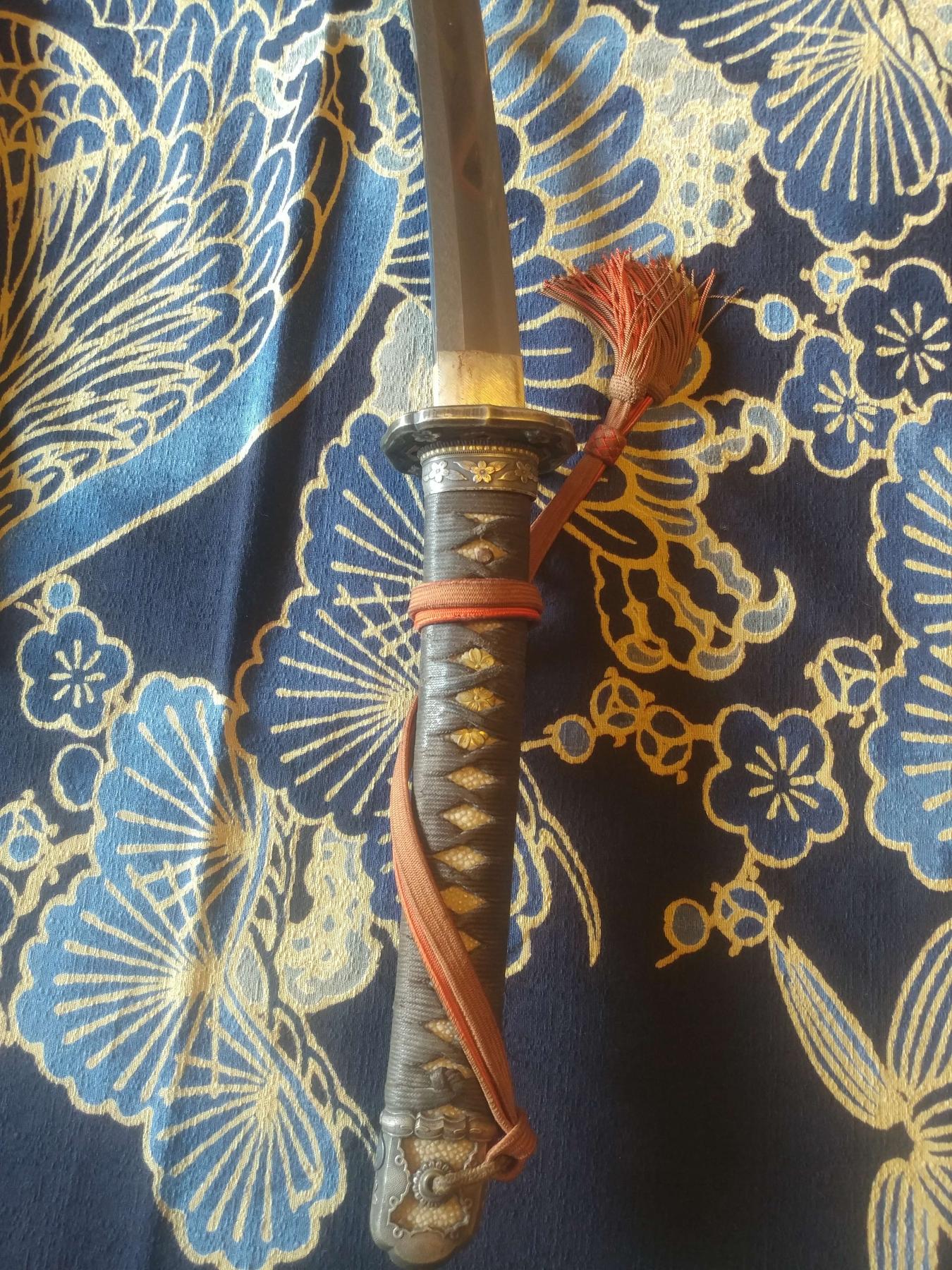

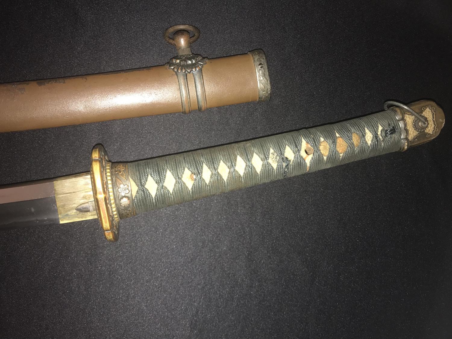

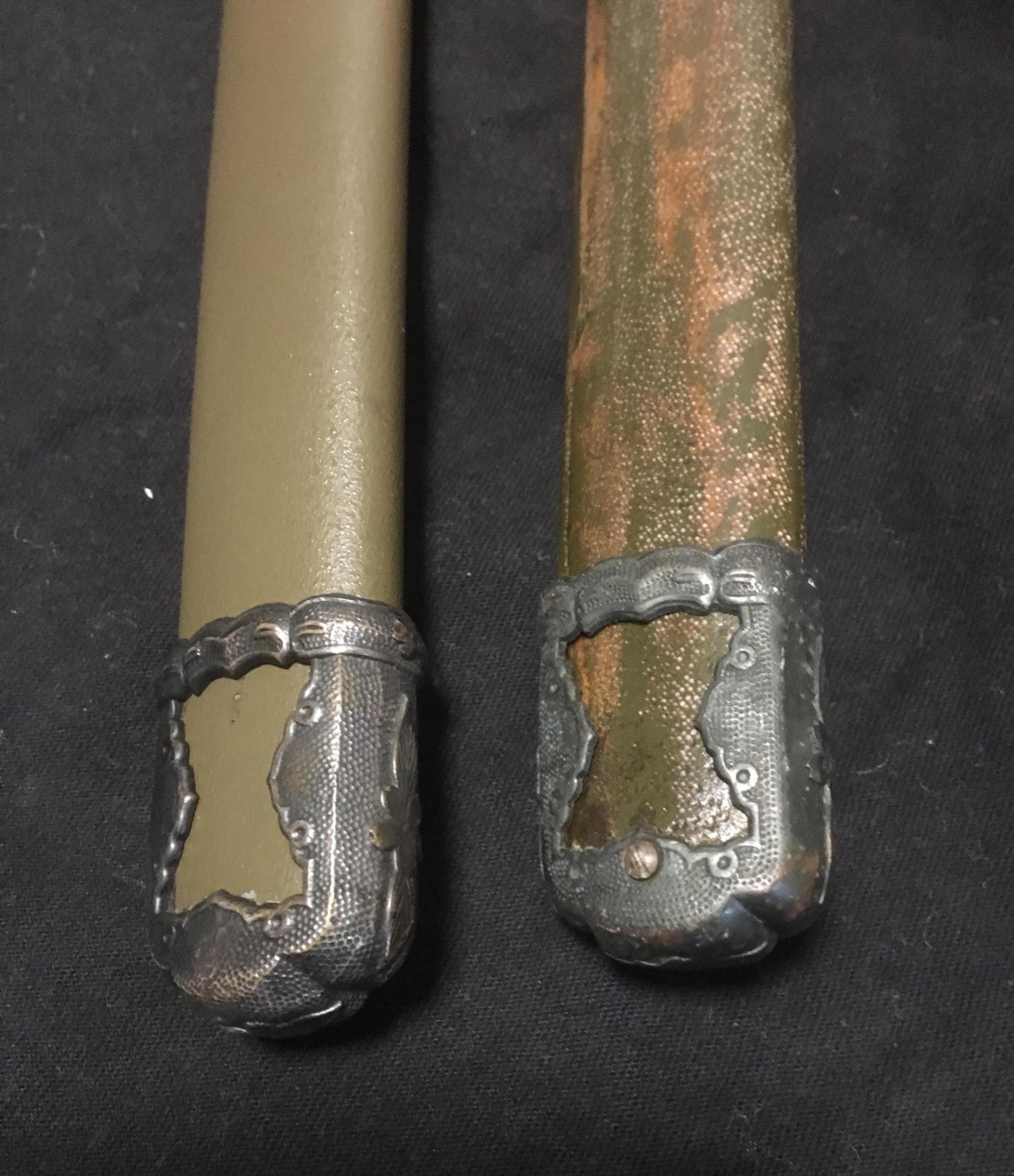

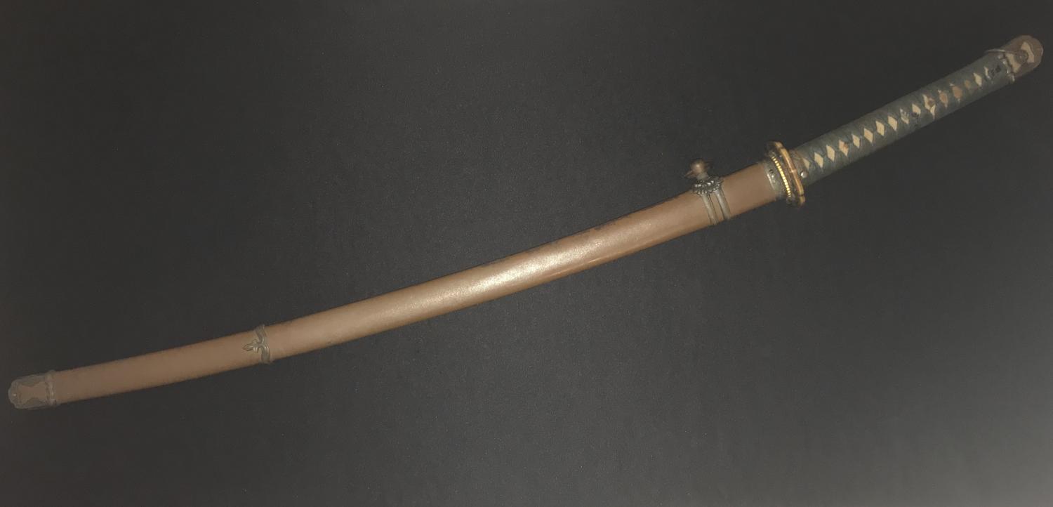

As the happy new owner of one of these I'm curious to know if there is a certain reason for these splendid Type 98's? From what I have gathered so far we can determine these few points:
1: They chiefly contain good quality Gendaito blades
2: There are two known examples that were Royal Gifts (one published in Swords Of Imperial Japan, p.165, another in a museum in Europe)
3: They appear to mostly be in Type 98 regulation mounts of superior quality and finish
Were these specifically a certain kind of special gift or presentation sword? Obviously they are special order but the fact that there are two known gift swords is highly intriguing, or perhaps just a coincidence and they were just a flashy upgrade for officers desiring that extra touch of flair. If anyone has any further information or documentation about these interesting swords please share so we can solve the mystery! Naturally feel free to share any examples you have in your collection or have encountered over the years.

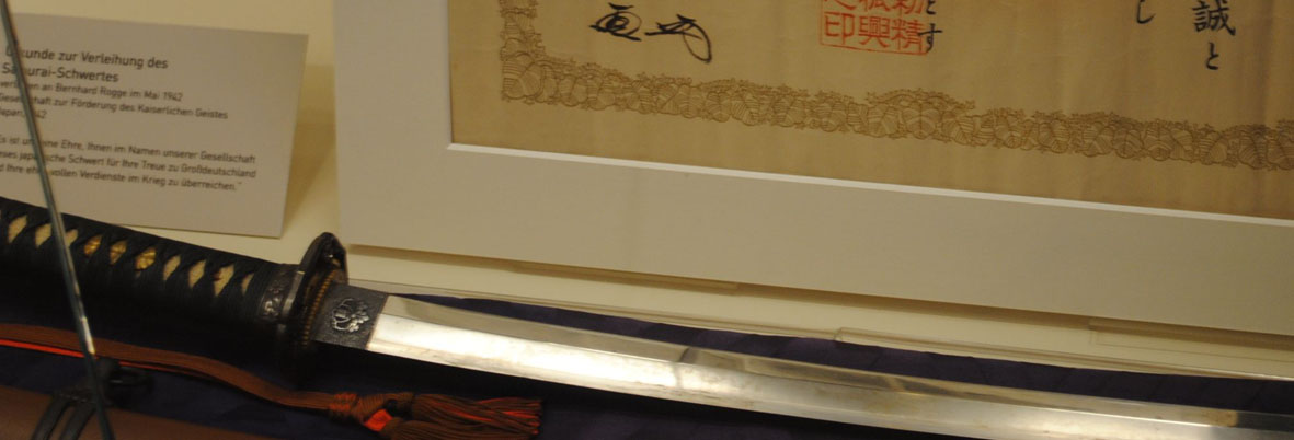

Example from Ohmura:
Imperial Gift from Swords Of Imperial Japan:

John, good questions. One thing I have noticed is that the type you have is normally in pristine condition. Like they never saw battle. So a presentation sword, that was kept in a safe place is not out of the question.

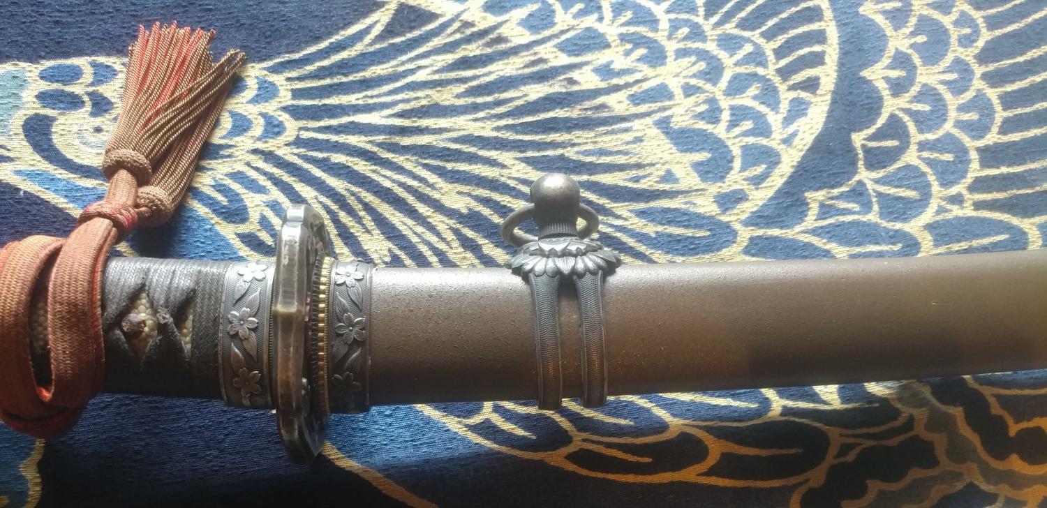

For comparison I posed one of mine to look like your third photo.
This blade is Ichimonji Minamoto Amahide, and is pristine like the koshirae.
  • Like 6
You're right, virtually all examples have very little wear or signs of being carried in the field. It goes without saying that an officer would already have a sword, if he was the recipient of a fine gift sword like this it would be sent home for safe keeping.
Here is another, with blade by Amahide: http://www.militaria.co.za/nmb/topic/14389-special-order-shingunto-koshirae/?hl=%2Bblackened+%2Bgunto&do=findComment&comment=151276
post-3926-0-58880400-1586066624_thumb.jpgpost-3926-0-06004400-1586066626_thumb.jpgpost-3926-0-03412100-1586066627_thumb.jpg
  • Like 6

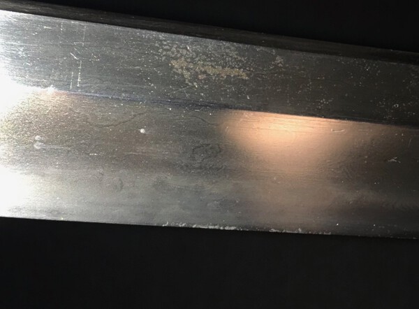

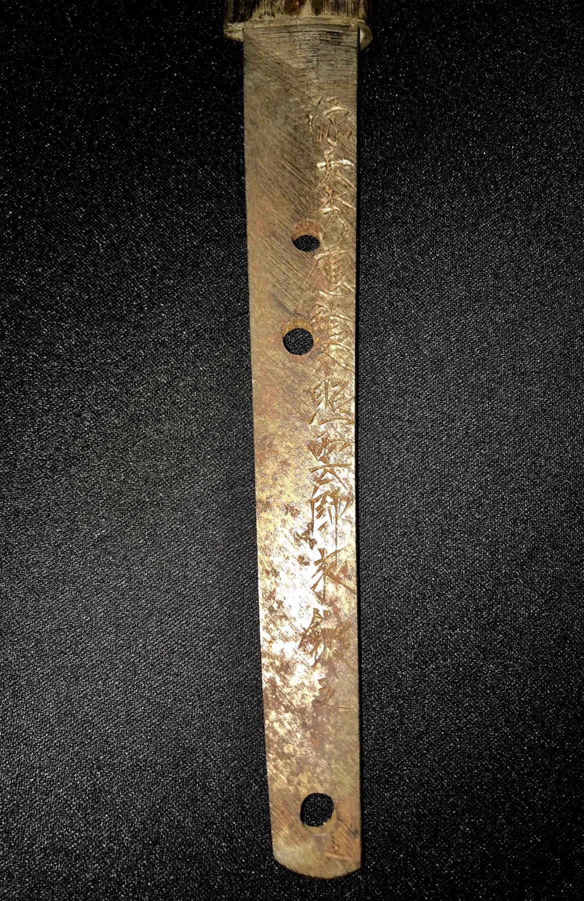

Reading Dave's extracts, Ray Singer kindly translated this Amahide. No date no stamps. Ichimonji Minamoto Amahide Kore O Kitaeru. Or, Amahide forged this. It is similar to but not the same as the 10 inscriptions' in Dave's article.
 What I took away from Mr Bowen' article was that "Amahide" is as much a trademark as a Mei, and that the variations probably had some meaning within the shop, that we are unlikely to ever understand.
