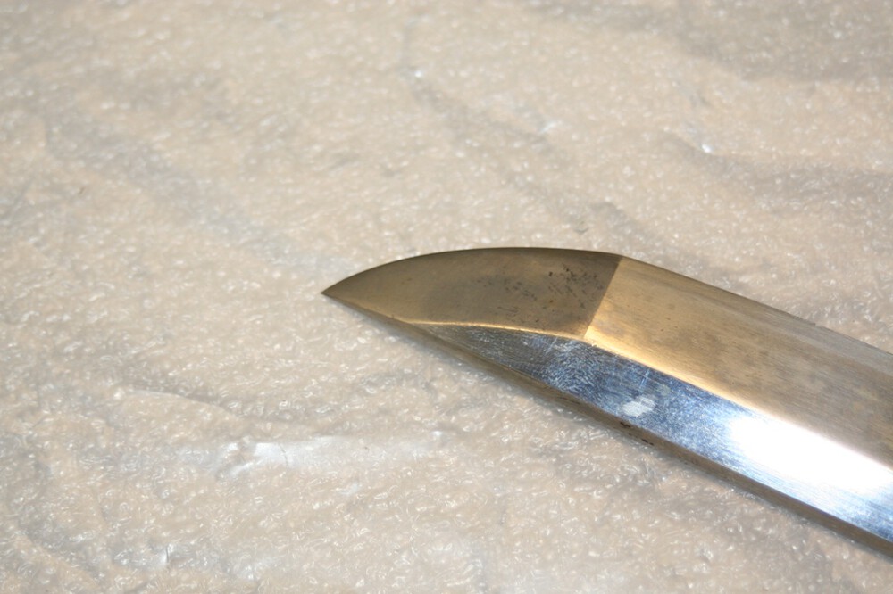

I have seen at least 3 different mei from Yoshimitsu (Eikkyo) implying there were several smiths having the same mei, so don't focus on the mei but on the kantei process to ascertain the school. It seems the hamon is suguha. Is it usual at this period for these smiths? Is it nioi deki. Waki at this period were not as stout as in sure Muromachi, suguta was slender ...
Anyway, shinsa is the best to have an idea
Hi,
According my books there were 3 generations of Yoshimitsu (father son and grandson) both worked in nioi deki. The shodai and the sandai made mainly gunome hamon, the nidai made mainly suguha hamon.

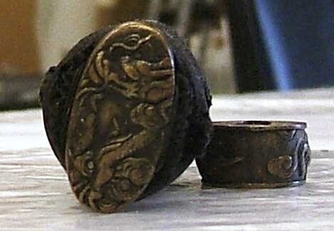

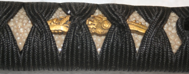

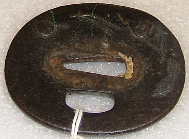

Eating the elephant one bite at a time, I have a question. If the Tsuba has a pear on it, Fuchi and Kashira and Menuki all have dragons, wouldn't the Saya have a dragon on it, instead of an odd looking bird? See photo attached.
Seems like there would be some effort put into cohesion right?
Is there a book for Tsuba like Yumoto's book is to swords?
Lot to digest, one step at a time :-)
Thanks again.
Regards
Doug
Doug,
It is unlikely that all the fittings stayed together through the years. They were so commonly swapped and changed that by the time they get to us, most have been altered. Themes often did match, but we do see papers going to koshirae without a solid theme. However in this case, the parts are probably from different time periods and themes, and are later additions to the set. I think the f/k, menuki and kozuka do look like they go together. Maybe the saya was made later as it is more fragile than the other parts, and the tsuba looks like it was added later.
