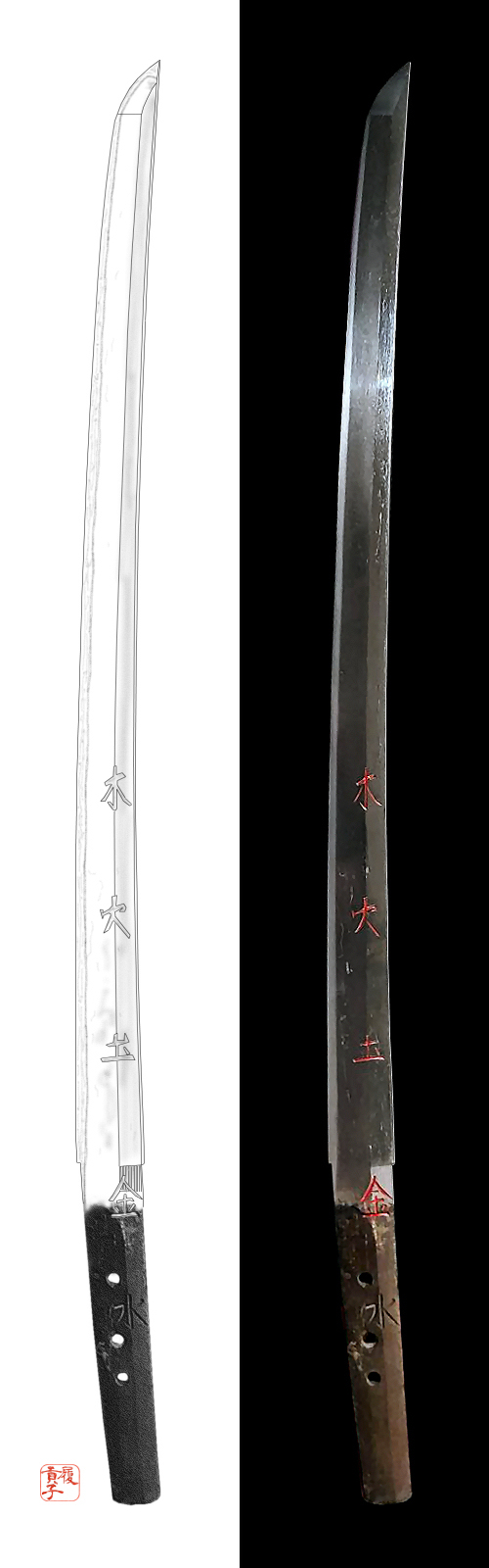

vajo Posted March 26, 2020 Report Posted March 26, 2020 ⽊ wood ⼤ fire ⼠ earth ⾦ metal ⽔ water Wǔxíng, the five elements Latest opinion (from Darcy) is Yamato Senj’uin, maybe Uda. Yamato Senjuin Koto period Kamakura ca. 1300-1326 Quote
Steffieeee Posted March 26, 2020 Author Report Posted March 26, 2020 thats a very cool sword, I've never seen that before, what date is that? Is that red lacquered script? Quote
vajo Posted March 26, 2020 Report Posted March 26, 2020 No, its a Horimono (carving) and red urushi lacquered. Quote

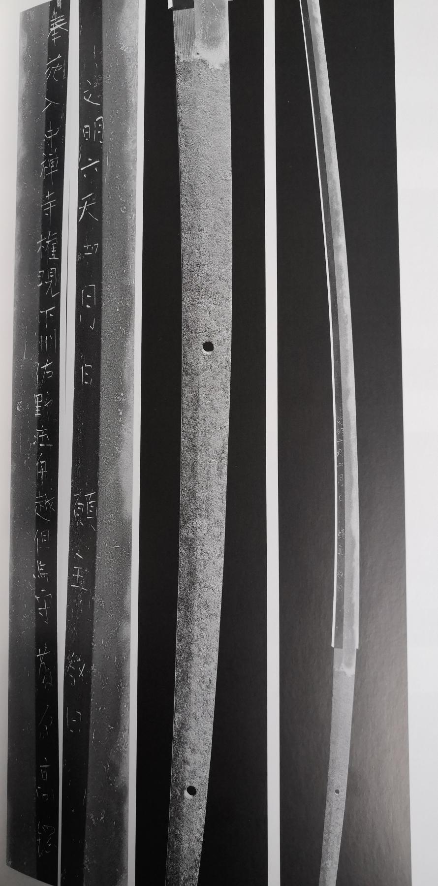

Jussi Ekholm Posted March 27, 2020 Report Posted March 27, 2020 Here is an example of very rare thing, that is an added on writing on the blade itself. I believe it is usually called tōshin-kiritsukemei or at least that is what I personally call it now. I haven't found it listed in any of my glossaries but Japanese descriptions of specific swords usually state it as such as far as I can translate the text by myself. This was a mystery for me for a long while and it might be for some others too so I thought I'd share it. 3 Quote

Steffieeee Posted March 27, 2020 Author Report Posted March 27, 2020 That appears to be an incredibly long nagako what on earth is that sword? On 3/27/2020 at 3:35 PM, Jussi Ekholm said: Here is an example of very rare thing, that is an added on writing on the blade itself. I believe it is usually called tōshin-kiritsukemei or at least that is what I personally call it now. I haven't found it listed in any of my glossaries but Japanese descriptions of specific swords usually state it as such as far as I can translate the text by myself. This was a mystery for me for a long while and it might be for some others too so I thought I'd share it. IMG_20200327_171455 (2).jpg Quote
Blazeaglory Posted March 27, 2020 Report Posted March 27, 2020 On 3/27/2020 at 3:35 PM, Jussi Ekholm said: Here is an example of very rare thing, that is an added on writing on the blade itself. I believe it is usually called tōshin-kiritsukemei or at least that is what I personally call it now. I haven't found it listed in any of my glossaries but Japanese descriptions of specific swords usually state it as such as far as I can translate the text by myself. This was a mystery for me for a long while and it might be for some others too so I thought I'd share it. IMG_20200327_171455 (2).jpg Wow! That has to be an Ubu nakago right? That sword is amazing But to the OPs question... There were many reasons to get horimono but I think as time went on it became more of an "art" or a way to show off your sword. In earlier times horimono represented certain beliefs in the symbols being carved into the blade adding power specific to each character or image. Kinda like Viking runes maybe? And yes some horimono are meant to cover up flaws but most of the time you can still see what flaws were being covered. Quote
Jussi Ekholm Posted March 28, 2020 Report Posted March 28, 2020 I posted that example above as it has writing (instead of horimono characters) on the blade which is very rare. The sword is an ōdachi in the collection of Futarasan-jinja. It is mumei attributed to Sōshū Masahiro and Nanbokuchō period. The blade length is 117,8 cm and nakago is 53,1 cm. Here is the writing on the blade. I do believe the main point of it is it was dedicated to the shrine 1474. Someone more proficient in Japanese language would be able to translate it. 奉施入中禅寺権現下州佐野庄舟越但馬守藤原高綱 / 文明六天四月日願主敬白 I believe pretty much all of the examples of tōshin-kiritsukemei I have seen have been on swords that are in the various shrines. In the masterpieces from Futarasan-jinja book 15 out of 34 swords featured have this type of writing on the blade. 2 Quote
