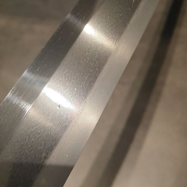

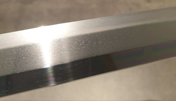

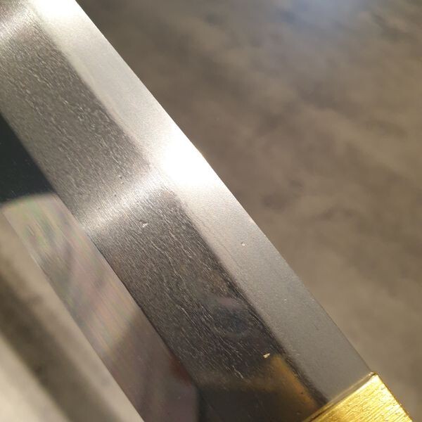

Yasutsugu (肥前国住保次) from Saga prefecture made some yamato style blades (at least masame hada, not sure about high shinogi but will know more when I get it in hand). According to Mr. Tsuruta from AoiArt, he was born in 1910 so might have been active during the war but from what I have found, he got his license in Showa 44 (~1970) and all the swords I have seen with that signature are signed early to mid 1970's. Picture from AoiArt of a sword I bought is below.
Would love to add a Hokke Saburo Nobufusa to my collection. I have been bitten but the masame hada bug....

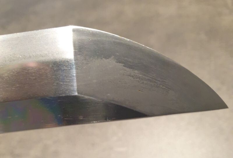

I once had a Nagamitsu that was done in Yamato-den with running masame hada and hataraki like uchinoke, nijuba, etc. I'll see if I can find pictures.
Below are pics of a sword by Masauji that I had that featured a prominent type of masame hada that blended with itame hada, though the workmanship threaded the needle between Yamato-den and Soshu-den.
Most of the time I have observed masame hada in a gendaito, the workmanship was an attempt at Soshu-den.

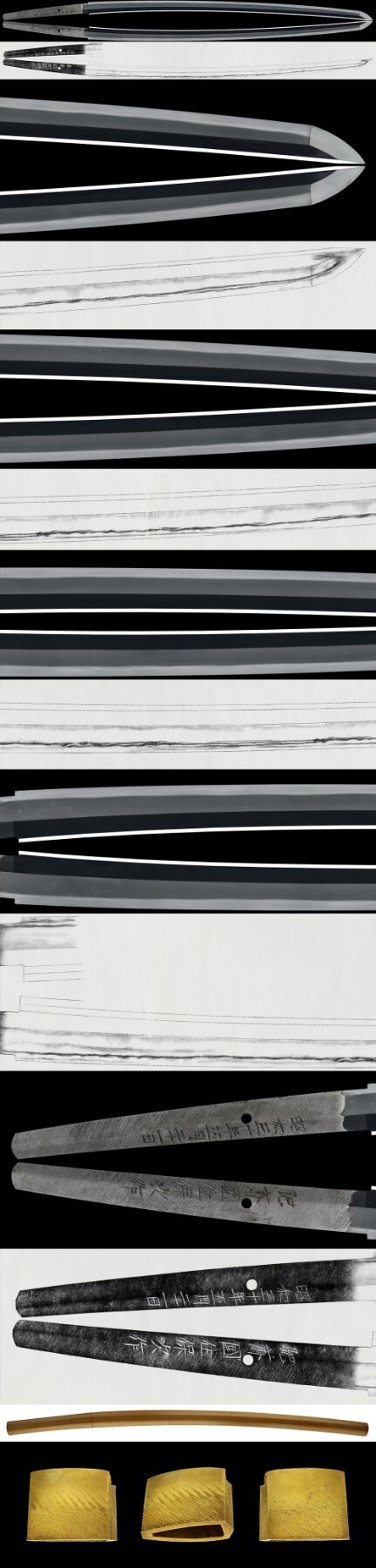

This order made Hokke Saburo Nobufusa 8.Generation
is made as a Tegai Kanenaga utsushi.
polished and judged by Kenji Mishina
papered by the NBTHK

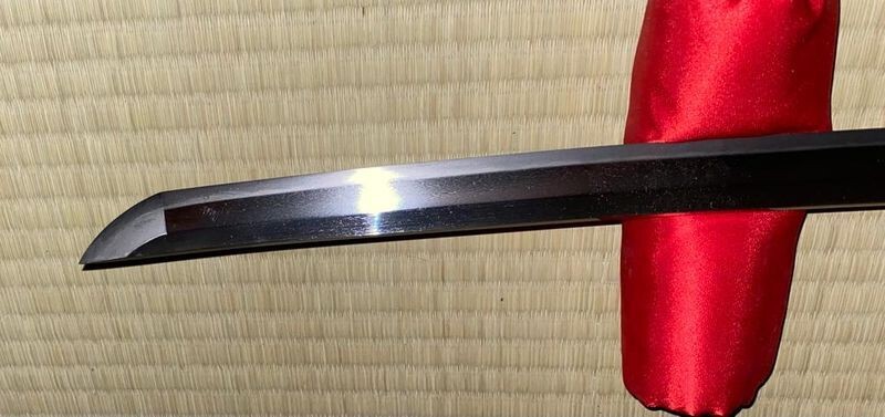

Gassan Sadakatsu is also famous for his take on Yamato Hosho. Here is an example made in 1940.
