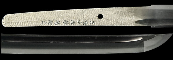

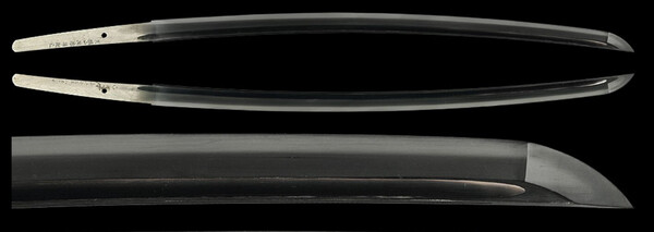

Bruno Posted March 21, 2020 Report Posted March 21, 2020 Hi guys, Trying to gather some reliable infos about hamon and forging method of Navy showa-to made with anti-rust steel at the Tenshozan Tarenjo. From what I have read and saw, the swords made at the Tenshozan Tarenjo seems of better quality than those made at he Toyokama arsenal. Early ones are of course usually better. Most I have seen online (never handle any of them) look to have no hamon anymore once "cleaned", and etched/stoned on hamon when in their original polish. It is written that smith and metalurgist Fujiwara Kanenaga was able to obtain a real hamon. Is it confirmed or more a rumor? If true, are we talking about oil quenched or water quenched hamon in his case? Was he the only smith able to do that? I read also that words made at the Tenshozan tarenjo were made by several Seki showa-to smiths, then shipped to the Tenshozan tarenjo to have the final polish and inscriptions/stamp. Is it correct? Finally, are they sunobe-to or do they have a core steel like Mantetsu-to? Thanks for the help Quote

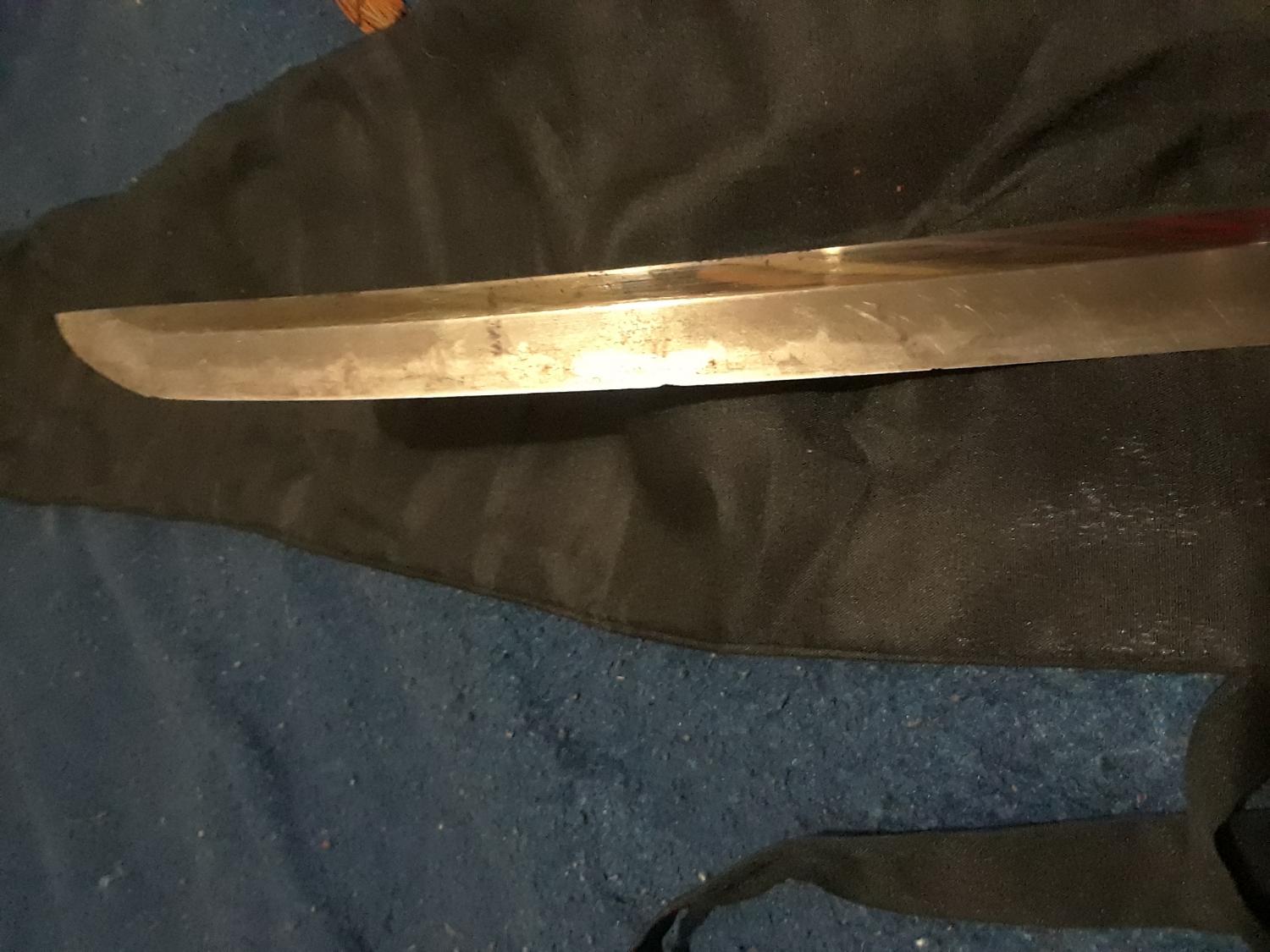

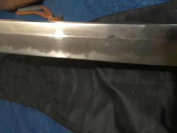

ChrisW Posted March 24, 2020 Report Posted March 24, 2020 I have one by Kanenaga that might fit your above description. I am no expert though, but I believe it might have what one would consider a hamon. Quote
ROKUJURO Posted March 24, 2020 Report Posted March 24, 2020 Chris,that looks definitely like a nice HAMON! But as you can see on the NAKAGO, there are traces of corrosion, so I would really like to know what steel alloy they used. There must be a certain amount of carbon in the steel. Quote
ChrisW Posted March 24, 2020 Report Posted March 24, 2020 Chris, that looks definitely like a nice HAMON! But as you can see on the NAKAGO, there are traces of corrosion, so I would really like to know what steel alloy they used. There must be a certain amount of carbon in the steel. That's the thing, I don't know if this is technically anti-rust steel or just a really nice wartime gendaito. The patina is not really indicative of either. I'd have to get it in the hands of someone more knowledgeable. Quote

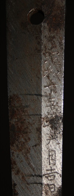

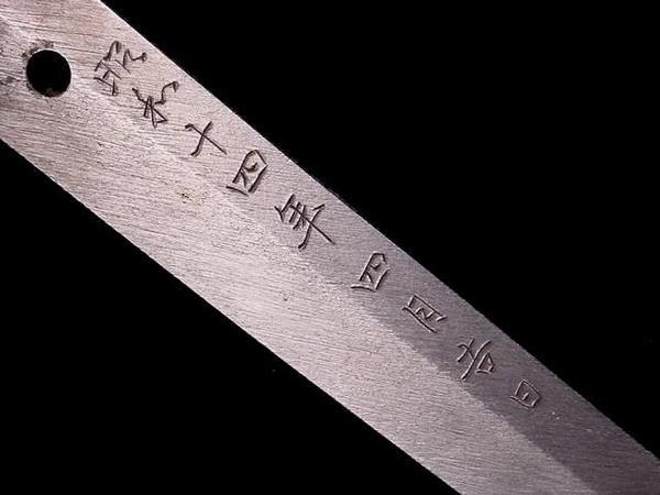

Bruce Pennington Posted January 19, 2022 Report Posted January 19, 2022 Barry's post seems to be the best one for a continuing line on the Tenshozan Tanrenjo mei blades. I've gotten 16 Tenshozan blades on file now, 13 with the forge mei. The latest comes from a friend with what may be the first one sighted of it's kind - one with a bohi. I've seen navy blades with bohi, on rare occasion, but I've searched and cannot see that I've ever come across a Tenshozan Tanrenjo mei blade with one. Dated March 1942, so the third earliest on file with the anchor stamp and second earliest with the mei. Quote

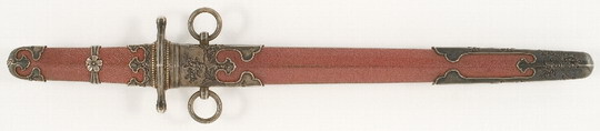

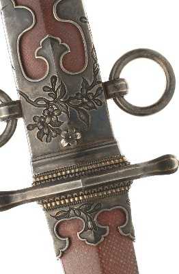

Kiipu Posted November 19, 2022 Report Posted November 19, 2022 On 1/19/2022 at 5:36 AM, Bruce Pennington said: Dated March 1942 昭和十七年五月吉日 A lucky day in May 1942. On 1/19/2022 at 5:36 AM, Bruce Pennington said: one with a bohi. I know of another one that was sold in Japan that had a fullered blade. It is anchor stamped and dated 昭和十七年八月日 [a day in August 1942]. http://kako.nipponto.co.jp/swords/KT124416.htm 1 1 Quote
Bruce Pennington Posted November 20, 2022 Report Posted November 20, 2022 7 hours ago, Kiipu said: I know of another one that was sold in Japan that had a fullered blade. It was anchored marked and dated 昭和十七年八月日. Wow! Nice find, and great custom fittings: 1 Quote
mecox Posted November 20, 2022 Report Posted November 20, 2022 That is a very interesting blade/sword and a quality item all up. The level of workmanship indicated on the blade suggests it could well be Kawamura Eijiro Kanenaga. He was a brilliant metalwork artist and an innovative metallurgist, doing leading work with stainless steel, referred to as "taisabiko". He also successfully produced real hamon in stainless steel...which looks like it in the pic? He typically inscribed blades with mei of this smaller, precise form, and also at times used a criss-cross (higaki) yasurime. Although from Seki he did spend extended periods at Tenshozan Tanrenjo....working and experimenting. He died in Aug 1943, but only age 57. This blade is August, 1942. Its OK to be critical of stainless steel swords as not true nihonto, but in my view Kanenaga was highly skilled and well ahead of his time. He also early on (1920's-30's) produced unique stainless pocket knives plus exotic articulated insects from iron and other metals. 4 2 1 Quote

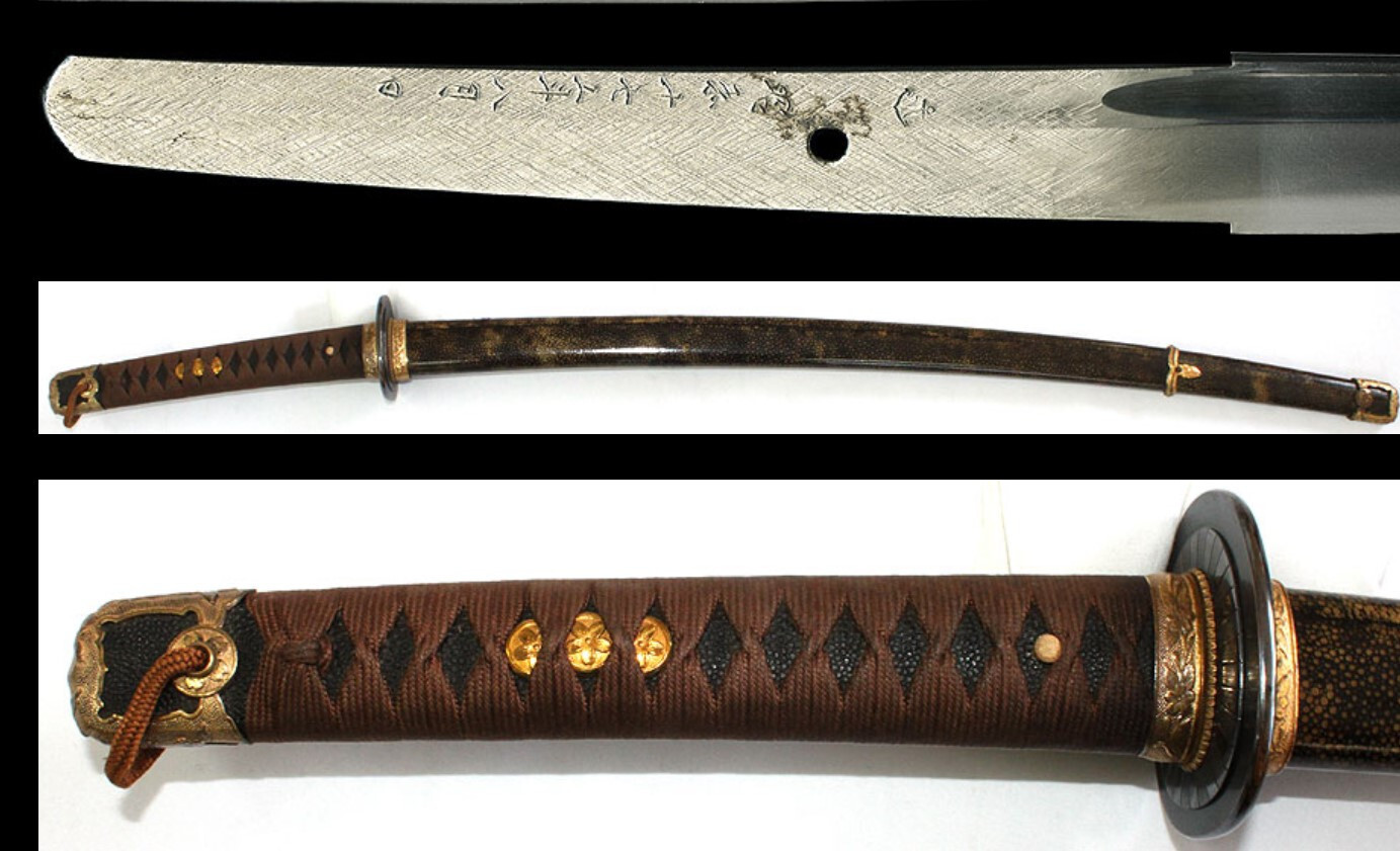

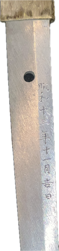

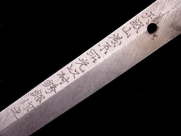

Conway S Posted May 3, 2024 Report Posted May 3, 2024 @PNSSHOGUN Here are some pictures of the kai gunto I posted in the translation section. As you can see it's signed: Tenshozan Fujiwara Akimitsu made this from stainless steel and it's dated a lucky day in November 1938. Minus some patination on the fittings, everything on the sword is in great condition. Conway 1 Quote
