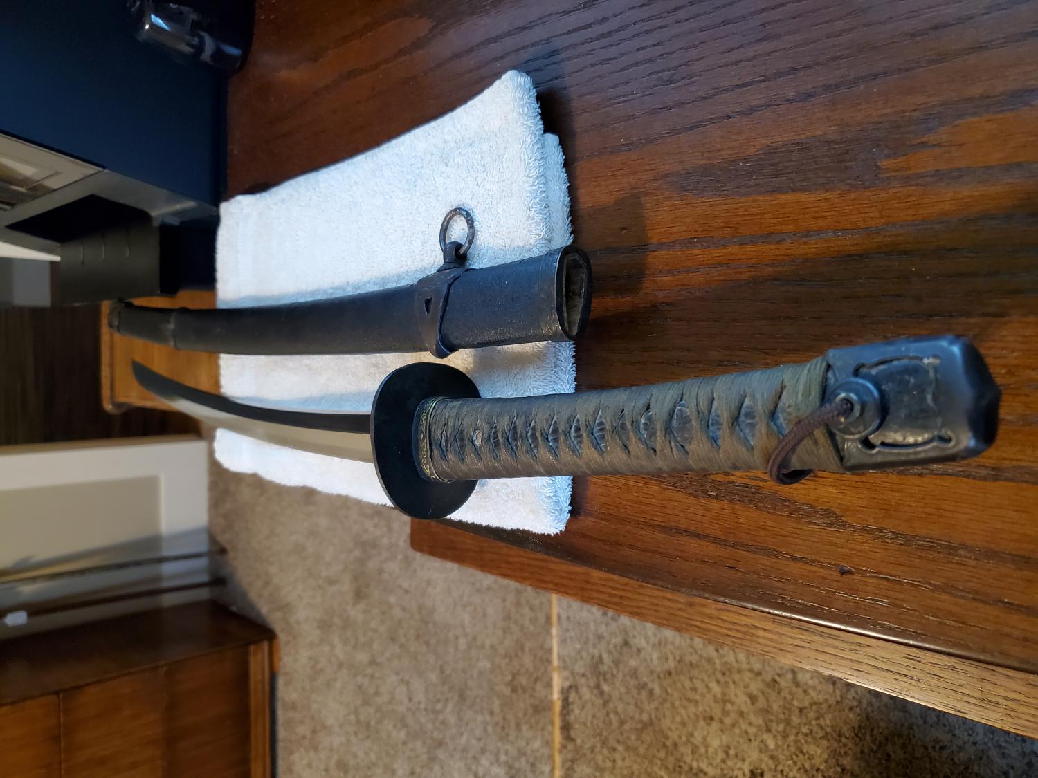

This is what appears to be a very late war (short) Kai Gunto. It was displayed on an antique store wall for many years until I was able to purchase it recently as the store decided to close shop.
The sword is very light weight with a nagasa of 22". One hanger, and without the rising sun o-seppa.
I believe the Mei is possibly "Kiyonobu", but by no means am I certain. Please let me know if this translation is correct.
Thanks Much,
Dave M.
I think its Kiyomichi (清道). I think the sword on the site that Jussi pointed to is misidentified, and that one is also Kiyomichi.
Check out a similar signature here.
https://japanesesword.com/archived-pages/2017/8/1/stainless-toyokawa-arsenal-kai-gunto-by-kiyomichi
I'm looking for more examples because I'd like one or two more before I close the door on this. There is an auction site that lists a Kiyomichi with the same signature
https://aucfree.com/items/q246066058
but I'd like to find a site other than an auction site.
Thank you Steve,
This was what I was having a problem with initially. The characters were a bit confusing to me, and the black paint didn't help matters.
I think you're correct though, "Kiyomichi".
Again, Thank you and Jussi also,
Dave M.
