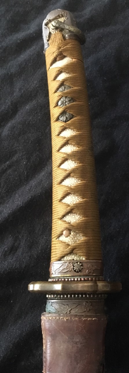

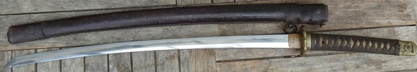

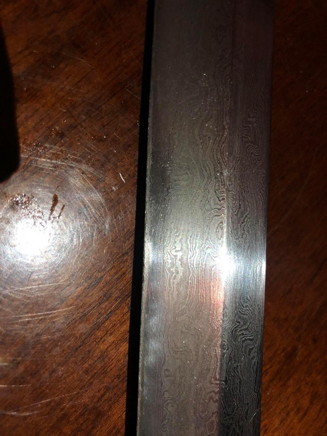

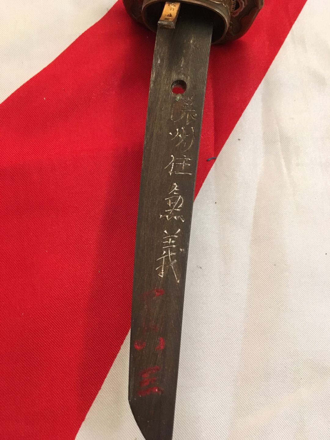

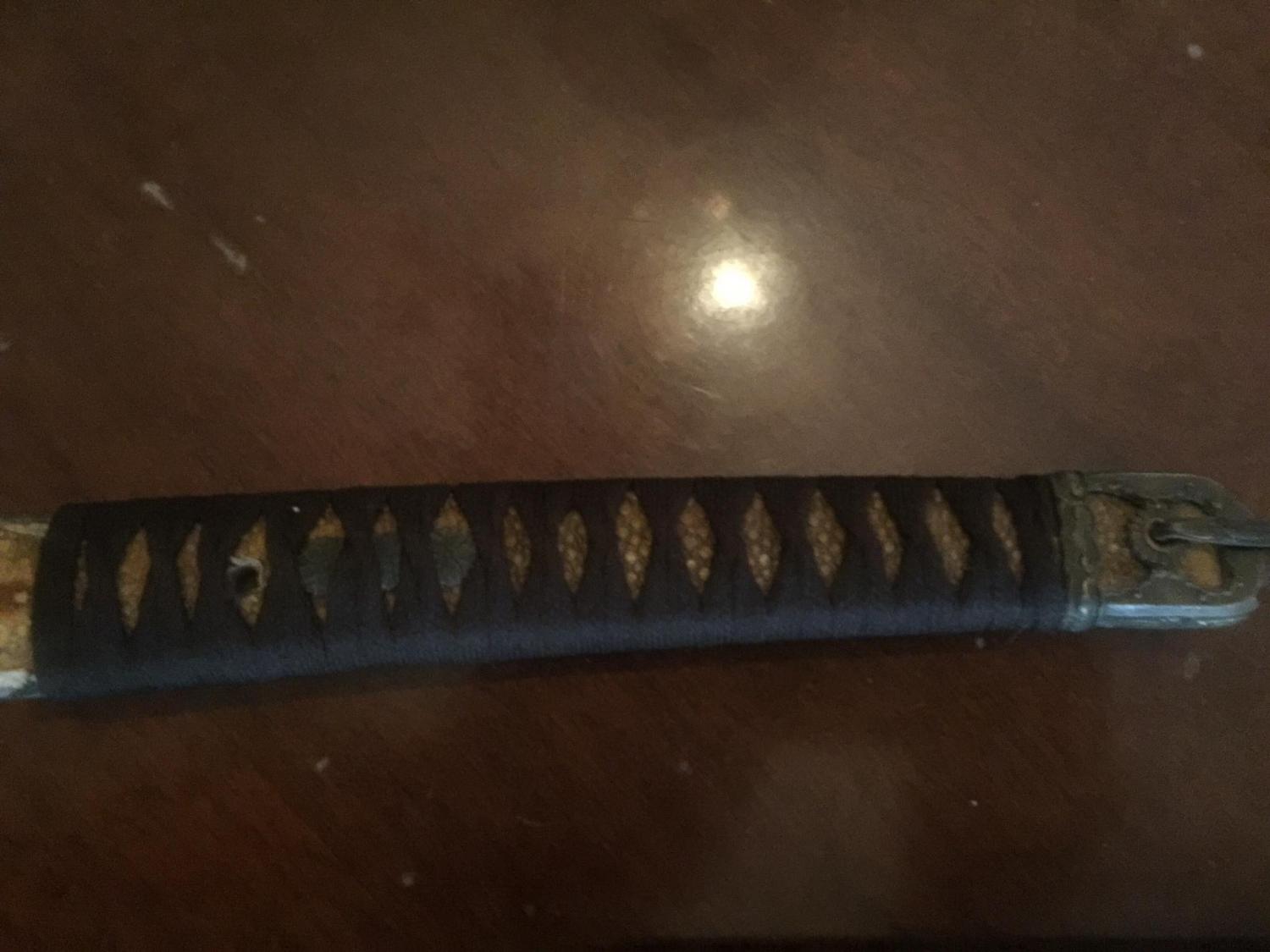

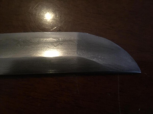

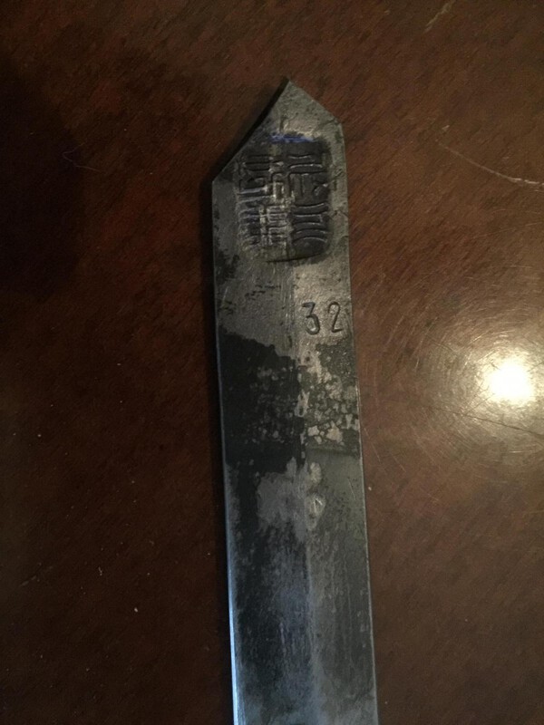

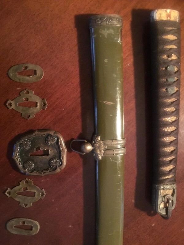

Jason_D Posted March 10, 2020 Report Posted March 10, 2020 Hello everybody , i would like (again ) your help to identify if this sword is authentic. The blade is weird looking like a damascus steel. What kind of hamon is this? (by hamon i mean the wavy line on the edge some other swords i have seen , i hope hamon is the right word)This sword doesnt have a wavy line. What do the Japanese stamp mean? Whatever info you can give is welcome. Below are some pictures... if you need better pictures of some part just ask me. Thank you! Quote

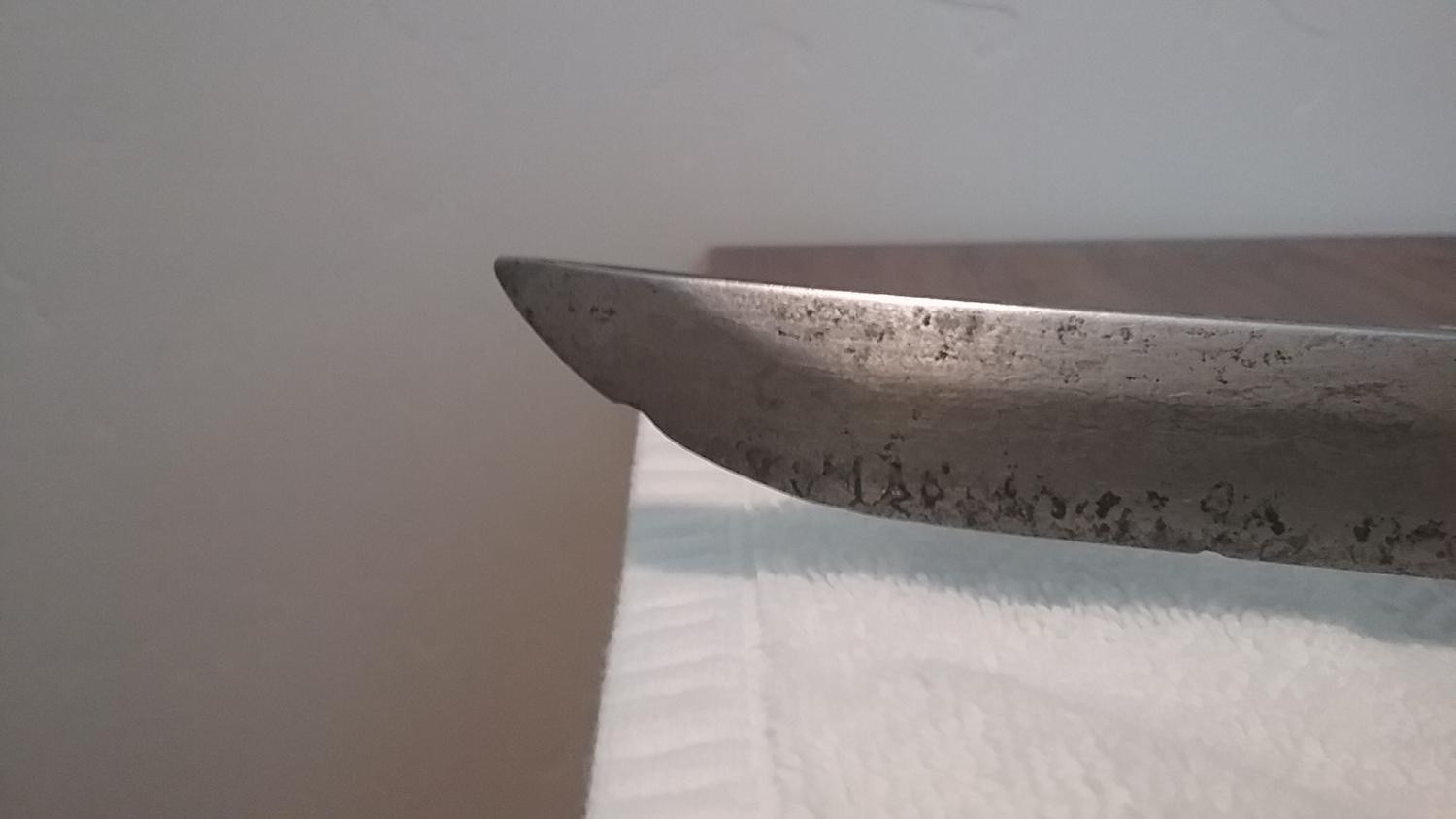

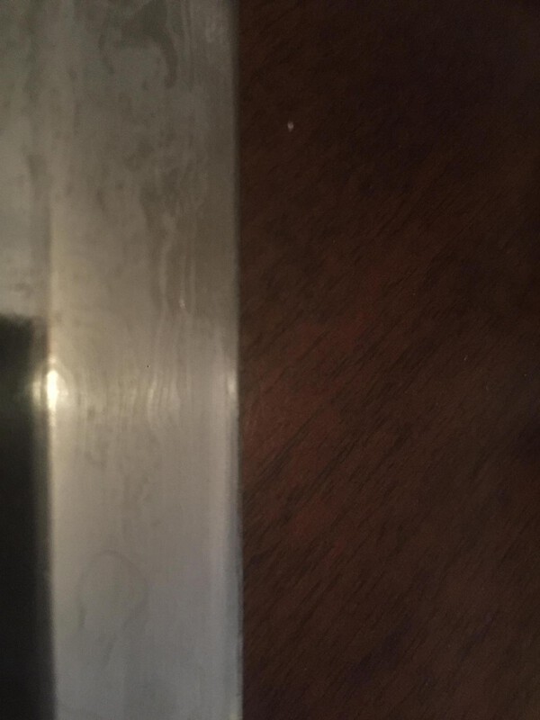

Oshy Posted March 10, 2020 Report Posted March 10, 2020 Looks like the hada was enhanced using acid etching of some sort? The hamon appears most visible in the kissaki(tip) picture. Are there any other serial codes not shown here, perhaps on the back of the blade or mouth of the saya? 1 Quote
Dave R Posted March 10, 2020 Report Posted March 10, 2020 Every so often blades like this turn up, and create havoc! They are a known type, Amahide is known to have made them, and I have seen one of them in hand, with a good provenance. As far as I can make out, they are a flashy blade option, possibly influenced by 19th century blades from Western manufacturers, Solingen sold Damascus blades as an option for private purchase. http://www.antiques.com/classified/1134564/Antique-Imperial-German-Naval-Officer-Sword--Damascus-Blade 2 Quote
Jason_D Posted March 10, 2020 Author Report Posted March 10, 2020 On 3/10/2020 at 4:38 PM, Dave R said: Every so often blades like this turn up, and create havoc! They are a known type, Amahide is known to have made them, and I have seen one of them in hand, with a good provenance. As far as I can make out, they are a flashy blade option, possibly influenced by 19th century blades from Western manufacturers, Solingen sold Damascus blades as an option for private purchase. http://www.antiques.com/classified/1134564/Antique-Imperial-German-Naval-Officer-Sword--Damascus-Blade On 3/10/2020 at 4:37 PM, vajo said: Its a fake/ repro sword. I am confused... its not an authentic shin gunto ? Is it after ww2 make? If amahide made it , doesnt that make it authentic? Thank you. Quote

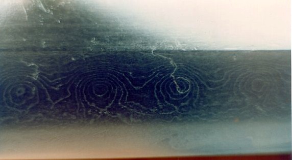

Dave R Posted March 10, 2020 Report Posted March 10, 2020 This is one of Amamahide' mixed metal specials.... 2 Quote
vajo Posted March 10, 2020 Report Posted March 10, 2020 The blade above is fake. The blade, the tsuka, the habaki, the saya. All is from somewhere made in Asia, but not in Japan. 2 Quote
Grey Doffin Posted March 10, 2020 Report Posted March 10, 2020 As far as I know, no real Japanese sword ever had a serial number on its habaki. That and the phony Damascus steel (and other clues) leave little doubt; this is a post war fake. Grey 3 Quote
Dave R Posted March 10, 2020 Report Posted March 10, 2020 Like I say, they do turn up, and when they do they cause furious arguments because most collectors are not familiar with them... and if they don'r recognise them they cry fake. Of course there are fakes about, and they often have an in your face pattern welded blade. But I think yours is a genuine Shin Gunto. This one below was posted on this message board by lindus. 1 Quote
Dave R Posted March 10, 2020 Report Posted March 10, 2020 On 3/10/2020 at 4:56 PM, Grey Doffin said: As far as I know, no real Japanese sword ever had a serial number on its habaki. That and the phony Damascus steel (and other clues) leave little doubt; this is a post war fake. Grey I missed that, so there we go, sadly it is a fake and I was caught out by my hope to find another Amahide. 3 Quote

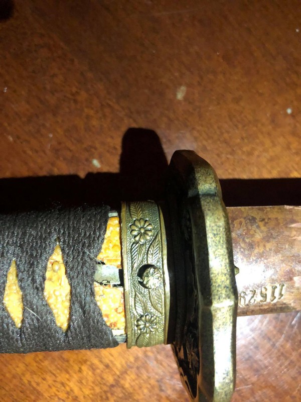

Jason_D Posted March 10, 2020 Author Report Posted March 10, 2020 On 3/10/2020 at 4:20 PM, Oshy said: Looks like the hada was enhanced using acid etching of some sort? The hamon appears most visible in the kissaki(tip) picture. Are there any other serial codes not shown here, perhaps on the back of the blade or mouth of the saya? Some more photos... Thank you for the help. Quote
vajo Posted March 10, 2020 Report Posted March 10, 2020 Jason, it is 200% fake. All is wrong. 3 Quote
Jason_D Posted March 10, 2020 Author Report Posted March 10, 2020 Thank you all for the help , i guess its a fake one ... Quote
Jason_D Posted March 10, 2020 Author Report Posted March 10, 2020 On 3/10/2020 at 5:04 PM, vajo said: Jason, it is 200% fake. All is wrong. Thank you very much! (again) Quote

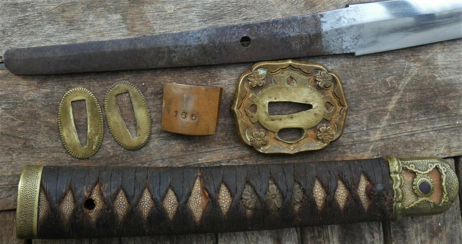

BANGBANGSAN Posted March 10, 2020 Report Posted March 10, 2020 Grey You're right, this sword Jason post is a fake. But, never say never about WW2 Gunto, in fact,I have an NCR Gunto made by 兼義 Kaneyoshi with numbered Habaki. On 3/10/2020 at 4:56 PM, Grey Doffin said: As far as I know, no real Japanese sword ever had a serial number on its habaki. That and the phony Damascus steel (and other clues) leave little doubt; this is a post war fake. Grey 5 Quote

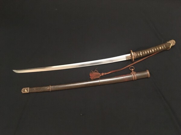

Bruce Pennington Posted March 10, 2020 Report Posted March 10, 2020 You can see the clear difference in quality and accuracy between the two: 4 Quote

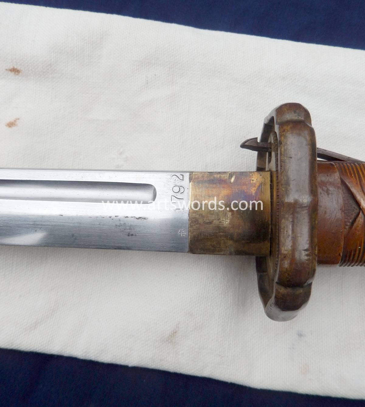

Shamsy Posted March 10, 2020 Report Posted March 10, 2020 I have two very late war swords, one with serial numbers on the habaki and one with serial numbers on the blade. It's not unheard of with the mess of swords, especially late war. 3 Quote

David Flynn Posted March 11, 2020 Report Posted March 11, 2020 The actual Japanese swords that one thinks maybe mixed metal or Damascus, are actually swords that have been acid treated, this brings up the hada and because it's acid, it affects the lines of the hada and hamon. As far as I'm aware, Amahide didn't uses "Mixed Metals" but are true Nihonto (ones without stamps). Amahide, also had O hada, which when acid cleaned, tends to make them look like Chinese copies. However, the OP is chinese. I believe Niels sword is acid treated. 4 Quote

lonely panet Posted March 11, 2020 Report Posted March 11, 2020 Just have a look at the original post fitting, its obviously a fake. Suddenly the py have figgured out how to fake a obscure hotstamp and your all tricked 1 Quote
Denis V Posted March 12, 2020 Report Posted March 12, 2020 I’ve always wondered if there are sarute who can go all the way round the kabuto gane? All mine are stuck on one side and can’t be flipped to the other side. Here the sarute looks very big. The tsuba and koshirae in general on this sword are not even well copied. As far as the habaki is concerned, i also always believed they never came with a number on it. But this is the beauty of the board, you learn every day :-) 1 Quote
BANGBANGSAN Posted March 26, 2020 Report Posted March 26, 2020 Here is another Type 98 with numbered Habaki 5 Quote
ROKUJURO Posted March 27, 2020 Report Posted March 27, 2020 On 3/11/2020 at 5:17 AM, David Flynn said: The actual Japanese swords that one thinks maybe mixed metal or Damascus, are actually swords that have been acid treated, this brings up the hada and because it's acid, it affects the lines of the hada and hamon. As far as I'm aware, Amahide didn't use "Mixed Metals" but are true Nihonto (ones without stamps). Amahide, also had O hada, which when acid cleaned, tends to make them look like Chinese copies. However, the OP is chinese. I believe Niels sword is acid treated. David, this is simply wrong. You cannot enhance a traditional HADA with acid as there are usually no different alloys found in one place. Acid treatment works where two different steel alloys occur that have different 'sensibilities' with acid attack. As an example, this is the case with high carbon and low carbon content as is found on the YAKIBA and the JIGANE of a traditionally made blade. A coarse Damascus pattern can be made visible with acid as different alloys - not necessarily high and low carbon content, but Nickel and Manganese will work even better - are differently attacked and will reveal the pattern. When we see cheap blades with an obvious Damascus pattern instead of a traditional JIGANE, we can be sure that they were acid treated, but then it is not a HADA but simply fire-welded Damascus of (mostly) questionable quality. We have discussed this subject before. Quote
