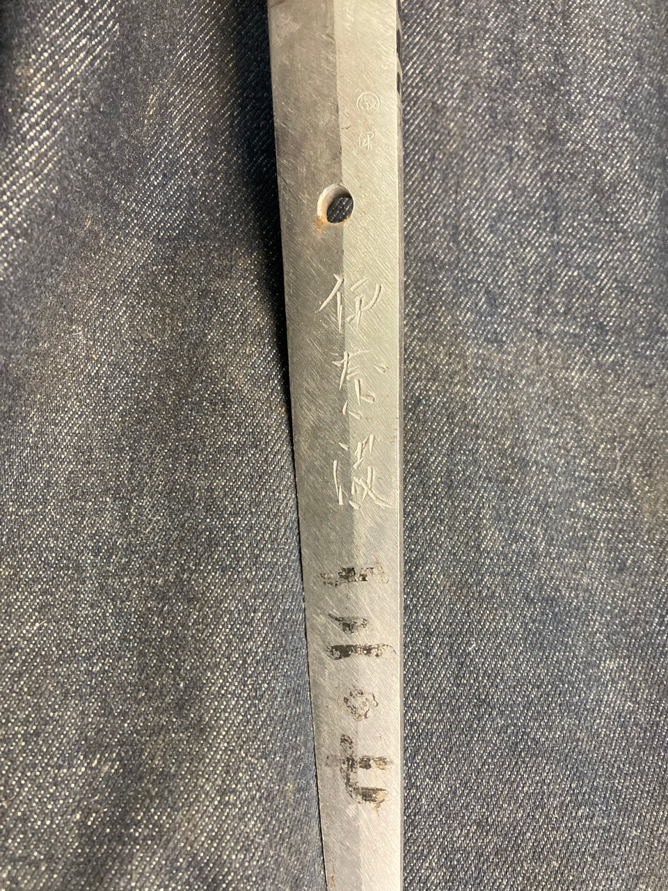

tbonesullivan Posted May 10, 2021 Report Posted May 10, 2021 On 3/10/2020 at 1:24 PM, Bruce Pennington said: Thanks for the better pics Jason! I wish I had kept a picture of the serial number on the previous Inaba Kaneyoshi. This seems to be his way of marking his blades. I see the saya is black after all. The first pics gave it a brown look. The material under the wrap seems to be a textured lacquer. Haven't seen that before! Type 97 Kaigunto tend to run more than army Type 98s as they are no as plentiful. There is one posted on fleabay now for $2,700, and a couple of aucitons starting at $900 (they won't end that low). I'd say $1,800-2,400 depending upon condition and smith. Just got in a Kai-gunto by Inaba. Didn't recognize it right away because the signature is really kinda messy compared to the last one we had, posted here: This one has the 伊 stamp under the anchor. I do not see any serial number on the blade. It's painted with 1 2 0 7, which matches all the fittings. 1 Quote
Bruce Pennington Posted May 10, 2021 Report Posted May 10, 2021 Thanks! This confirms the kanji/symbol is tied to Inaba Kaneyoshi. Now I will have to go back and look at the other ones I have to see who the Smith was that they came from! Quote
tbonesullivan Posted May 10, 2021 Report Posted May 10, 2021 10 minutes ago, Bruce Pennington said: Thanks! This confirms the kanji/symbol is tied to Inaba Kaneyoshi. Now I will have to go back and look at the other ones I have to see who the Smith was that they came from! The previous one we had just had the "Anchor" without the other marking, which looks like a "grass writing" 伊. I don't think that had a serial number either. Quote
