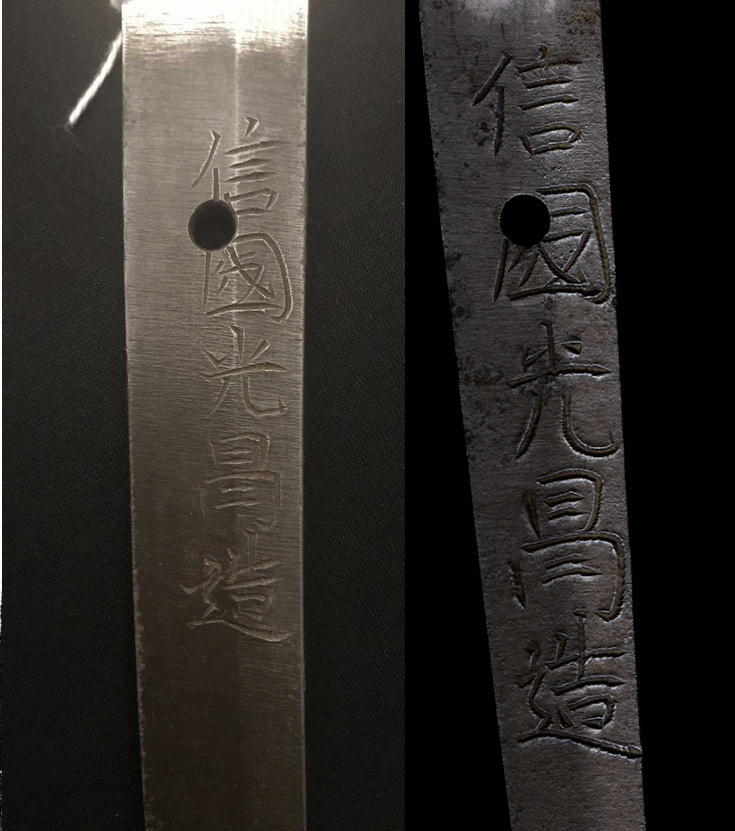

I have got some pictures of the nakago. Does all seem good where that is concerned? Also if anyone can read the kanji I would much appreciate it.
Mike
A good effort Francois, well done, very close.
So you have Nobu...next one, anytime you see that "box" kanji, think Kuni.
So Nobukuni Mitsu...you got the masa correct.
And then having another part of a name at the end would be odd, so look at typical mei endings and you will come up with saku or kitau or tsukuru. In this case...made (tsukuru)
So it is Nobukuni Mitsumasa tsukuru.
Compare with http://www.nipponto.co.jp/swords5/KT331359.htm
I would give a hard "no"
But just my opinion. Stroke strength and styles are way off. Look at the mitsu. But buy the blade, forget the mei unless it has papers.
I agree with Brian that a different hand did those mei; i don't know if there was more than one generation that signed that way, worth researching if you are looking to acquire the sword.
