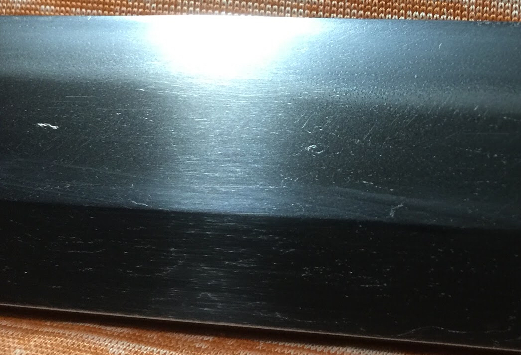

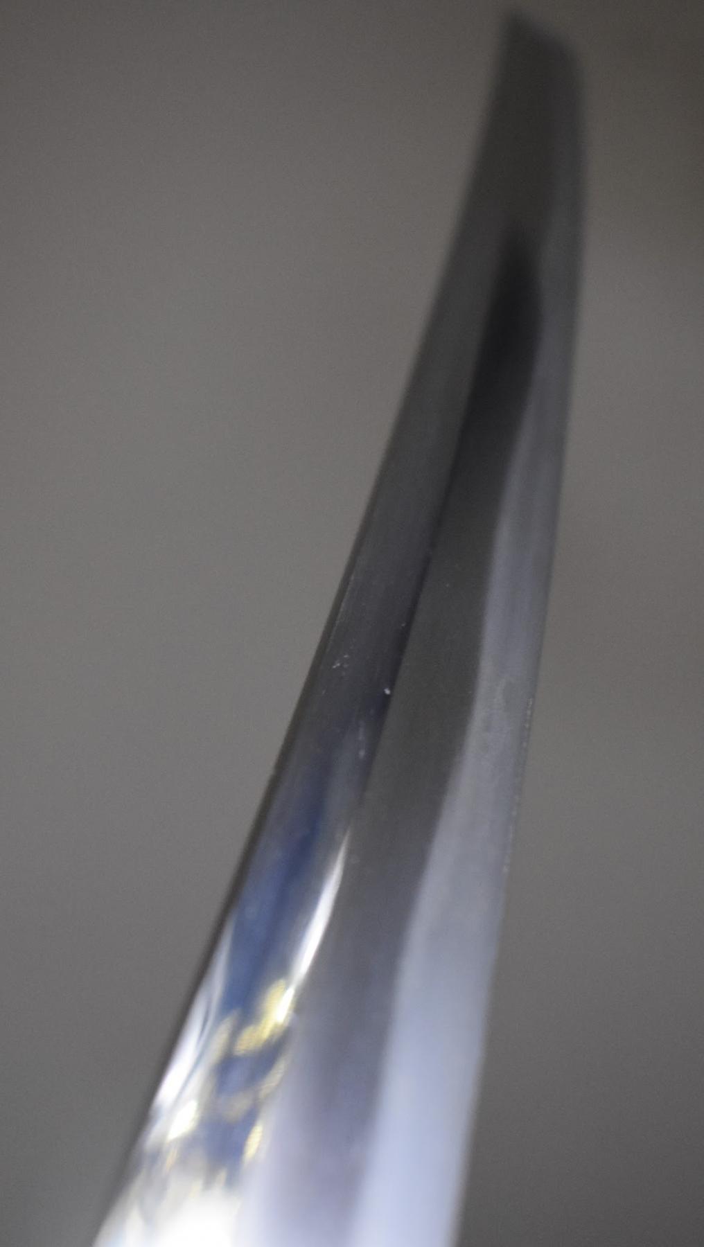

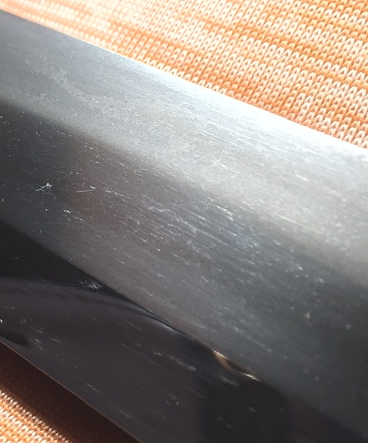

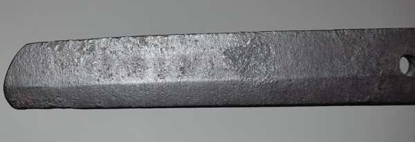

AntiquarianCat Posted February 29, 2020 Report Posted February 29, 2020 Hello everyone, I came into possession of this blade recently and would greatly appreciate input from more experienced collectors. I’m not sure how feasible it is to do so, but if the sword could be identified to a general time period and region/style of make that would be ideal. I’m already aware of the bad quality ato-bori and the ware cracks and suspect this is why it was cheap. To my inexperienced eyes, the hamachi seems worn, and the nagkago has heavy patina, which makes me think that it’s fairly old and been polished several times. The Hamon looks like suguha and the Hada seems to have masme and some type of wood (komokume?) characteristics, but as I said I’m inexperienced and could be completely wrong about all of this. Also it might be due to general inexperience but it seems as if the angle and type of incident light affects how prominent the different Hada patterns are. I had read that Yamato style blades were produced in large numbers as arsenal weapons during the sengoku period and most were unsigned. Is it at all possible that I’m looking at one such example? Thank you again for everyone’s help, Quote
AntiquarianCat Posted February 29, 2020 Author Report Posted February 29, 2020 Also if this additional information aids in identification: the blade length is 71.1cm and the curvature is about 1.6cm. Quote

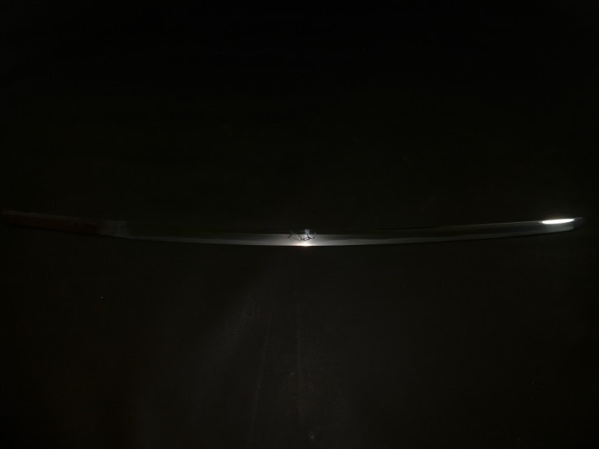

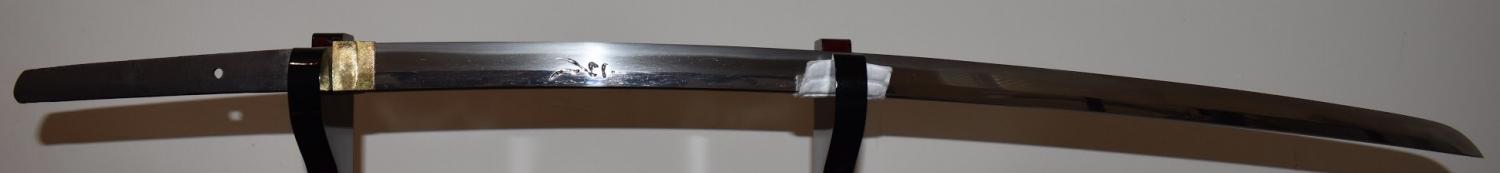

16k Posted February 29, 2020 Report Posted February 29, 2020 Your whole sugata picture is so dark it is hard to see the whole shape but I’d think it is more recent than Muromachi, probably Shinto. Better pictures of the sugata would help as well as measurements. You have a blade with extended chu kissaki, Suguha temper line is konie deki . I think your nakago has Kiri yasurime. Hada seems to be itame in so,e parts but very tight in other parts. Can’t say much more and will leave the real experts give their opinion. EDIT: with the new pics posted while I was replying, let me tell you that this horimono is really ugly, probably Dremelled out. Not trying to be rude. I realize my words were strong but I kinda like the overall blade except this part and wonder if it wasn’t made to hide a defect. RE-EDIT: the size and shallow curvature would seem to accredit a Shinto blade. 1 Quote
AntiquarianCat Posted February 29, 2020 Author Report Posted February 29, 2020 Hello Jean, Unfortunately I’ve only been able to remove the blade from the shirasaya while the weather is extremely moist. The method involving tapping my left hand with the right while holding the bottom of the grip hasn’t worked under drier weather and I’m not confident that I could remove it right now without causing damage to the patina or worse so the only full Suguha photos I have were taken by the vendor. The carving being horrifically bad seems to be a universal consensus. I suppose that’s what made it cheap. And yes I also was wondering if it could have been added to cover some type of a defect or if someone just recklessly did that (there are people who by mistake polish ancient coins, could be something like that I thought). Thanks, Quote

Ken-Hawaii Posted February 29, 2020 Report Posted February 29, 2020 I'd like to be able to confirm that the hada is masame, but I think I'm seeing an overose of uchiko, instead. Yes, Shinto, & that horimono is almost certainly placed so oddly to hide something. 1 Quote

Rivkin Posted March 1, 2020 Report Posted March 1, 2020 Its hard to judge the blade like this one. The hamon style is Yamato, its no earlier than second part of Muromachi, there is masame in shinogi ji. Can be even Bungo. My bet though would be probably someone like nth generation of Owari Seki Kanenobu... Kirill R. 2 Quote

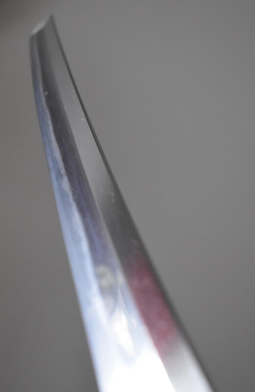

AntiquarianCat Posted June 21, 2020 Author Report Posted June 21, 2020 Hello again, I suppose I’m due for an update: I brought the aforementioned sword to the Atlanta show and showed it to Mr. Benson; he said the sword dated to the Muromachi period, and that it had Bizen characteristics, like the Nagako, also due to damage from the ato-bori and machi okuri it is not cost-effective to polish(not surprised but that means the hada and other traits won’t get any easier to discern). So with all that said I wonder if it isn’t possible (especially for all the people here that are much more knowledgable than me) to make an educated guess at an attribution. If it helps I’ve gotten a bit better at taking photos, and it turns out the hada on the outward-facing side is pretty intact. I’m still new at this compared to everyone else but it kind of looks like a mix of komokume and maybe Itame (definitely a lot of small whorls close together). The inward-facing side which I had been looking at initially is much more scuffed up by uchiko damage and like Ken said, I mistakenly interpreted the scratches as masame; with good incident light what looks like komokume is visible all over the inward-facing side of the sword as well. Shinogi appears to be komokume as well or itame. Nakago appears to be kuri-jiri with kiri yasurime. Also, I guess the Hamon still counts as suguha but I see a slight notate pattern. Also every so often the Hamon will show activities, either what looks like extra lines ( sunagashi?) or these small dimples going towards the cutting edge (is that yo?). Also, the sword seems to have some taper: the Motohaba is about 2.9cm, sakihaba about 1.8cm, definitely more taper than the Shinto katana I have; I assume this is part of what pushed it towards a Muromachi attribution. The curvature also seems to begin fairly late along the blade, especially when compared to the Edo period sword. The late curvature is all the more notable because the Muromachi sword has a shortened blade(machi okuri), I imagine when it was originally made the curvature started even later along the blade length. Again I’m inexperienced but this seems like a tendency towards saki-sori, at least compared to its edo counterpart and I wonder if this also wasn’t part of what helped push the time period attribution towards Muromachi. So far that’s all I can think of. If more photos would help, I’d be happy to take them. I could also upload higher resolution photos in imgur or another file sharing website. Quote
