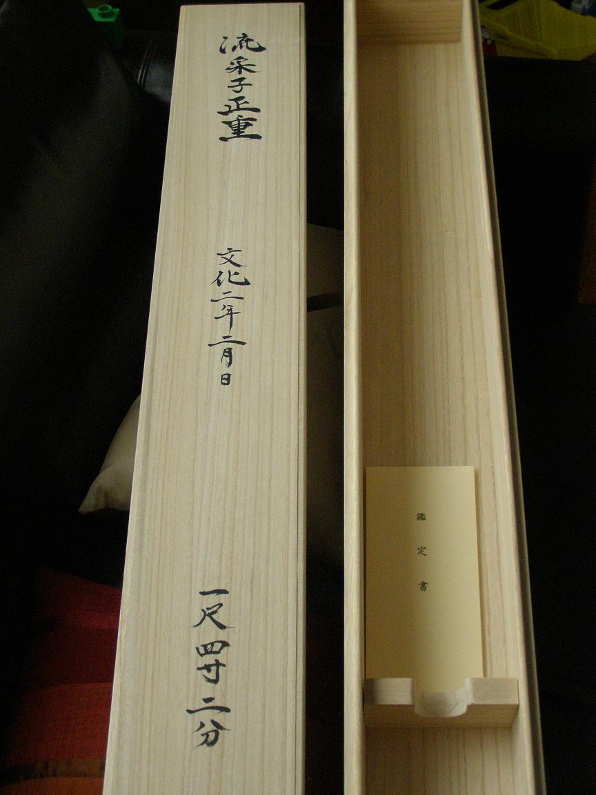

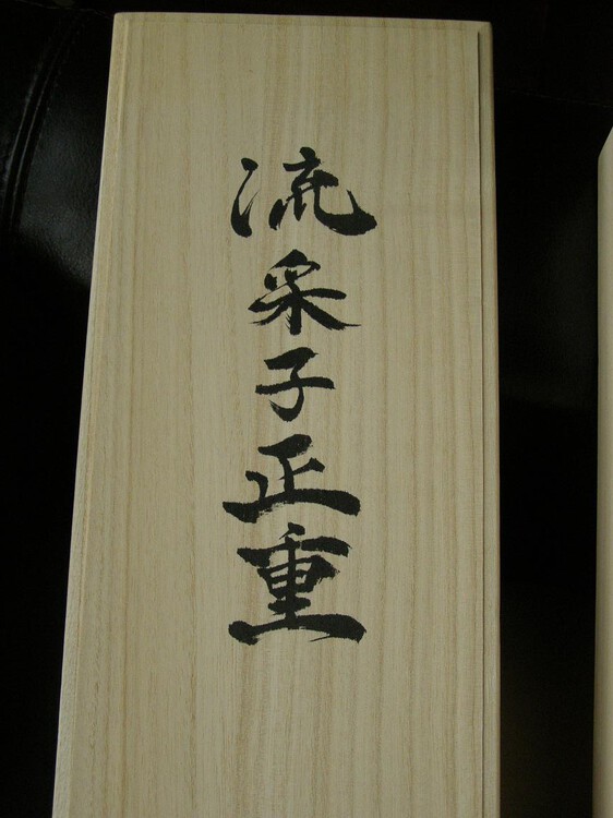

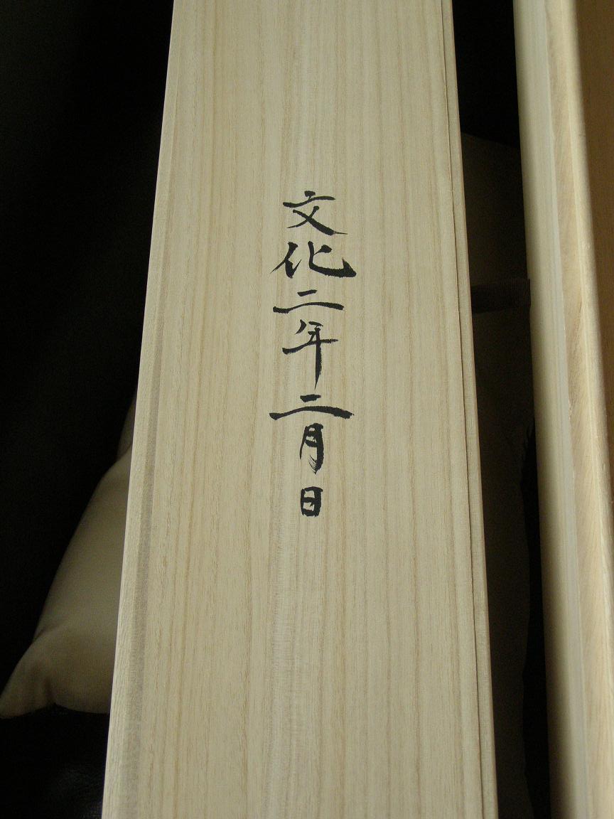

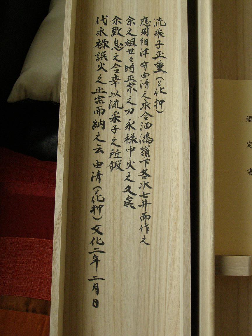

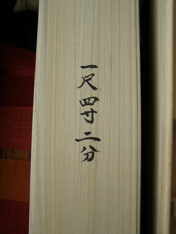

Another option is to purchase a paulownia box and write the sword details on this. Please find attached an example from my collection:
An "inventory Sayagaki" - name of the smith and date (as found on the Nakago), or name and period (if Mumei and papered) as well as the length - doesn't neccessarily increase the value, but also doesn't decrease it. I've seen quite a few (most recently a contemporary one on a Tokujû Kanemitsu), and basically it's the earliest form of Sayagaki. Adding comments, and signing it, is better left to the experts, and there are only a few I can think of: Kunzan (Dr. Homma), Kanzan (Dr. Satô), Yoshikawa Kentarô and Honami Kôson and Nisshû (all deceased), and Tanzan (Tanobe Michihiro) and Honami Kôshû who are presently doing Sayagaki.
As I said before, having a Sayagaki done for easy identification without drawing the sword is not unusual (although the same can be achieved by attaching a label to the Shirasayabukuro, also frequently seen), finding a calligrapher who can do it properly is a different story altogether. If someone claims that he can do it, but doesn't know that regular Sumi should be used, is highly suspicious IMO. I also think that many non-Japanese can't properly judge the quality of a Sayagaki in terms of calligraphy.
The lady who did the Hakogaki for Justin is a rare exception. She also did a Kakejiku for me not too long ago, and everybody who saw it was full of praise - including my wife's aunt who is a Sumi-e teacher. But if someone can't provide credentials - or if you're not able to judge the quality of the calligraphy by yourself - less is more, i.e. no Sayagaki is better than a potentially crappy one that most definately will decrease the value.
