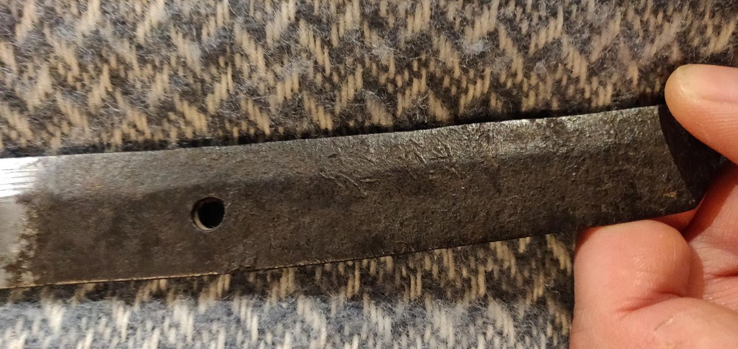

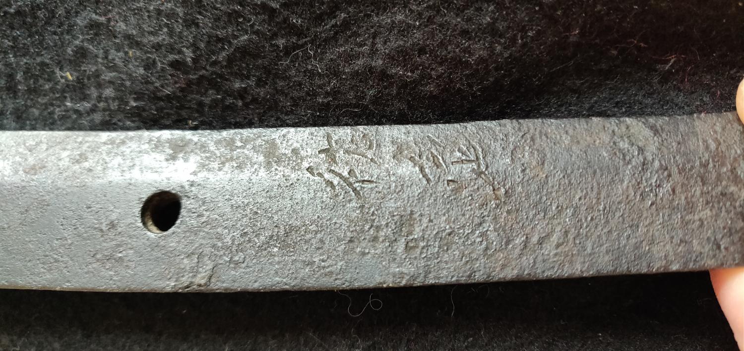

BjornLundin Posted February 24, 2020 Report Posted February 24, 2020 Hi, I was posting on the nihonto section of a katana that I have. http://www.militaria.co.za/nmb/topic/31280-sukesada-katana-hamon-question/?do=findComment&comment=320435 I was refered here for assistans for translation of tang and sayagaki. I was told that it was made by sukesada. Thank you for help! -Bjorn Quote
SteveM Posted February 25, 2020 Report Posted February 25, 2020 在銘祐定 時代天文之頃 Zaimei: Sukesada Jidai: c. Tenbu 長サ弐尺壱寸五分有之 Nagasa: 2 shaku 1 sun 5 bun 淑晃 Yoshiaki ? (multiple readings possible) 3 Quote

SteveM Posted February 25, 2020 Report Posted February 25, 2020 The paper says 刀 祐定 天正 備前 「備前長船祐定」古くは明徳頃から昭和名で続き 共に栄える。備前を代表する刀匠。 本作小板目によく鍛えた地鉄に乱刃を上手に焼いて いる。生茎二字銘の一振。 The salient bits are "Katana Sukesada Tenshō (era)" and "Jitetsu is well-forged into ko-itame, and skillfully rendered in midare-ba style hamon. Original (ubu) nakago with two-letter name. " Note the discrepancy between the paper, which says Tenshō-era (mid-1400s) and the sayagaki which says Tenbun-era (mid-1500s). I agree with the other thread that says the last polish has obscured the hamon. Obscured, but hopefully not destroyed. You would want an educated opinion to verify the sword before deciding to throw a couple of thousand Euros into a full polish and new shirasaya. I don't know if we can trust either the paper or the sayagaki. There are a lot of Sukesada smiths. 3 Quote
BjornLundin Posted February 25, 2020 Author Report Posted February 25, 2020 Great thank you , from the seller he stated that it was the 3rd Sukesada (Toshiro Yokoyama) Tensho (1573-1592) that made the blade. So that is a third date. I want to thank everyone from both threads, I will enquire a polisher for advice of what can be done. I hate to leave something in a non to optimal state, that would really itch my skin everytime I will look at it. Dont know when I can afford it but let see. I guess this is what happens when you jump in the river and then have to learn to swim to get out of it. Hopefully enjoyable. If there is a nihonto study group in scandinavia, please let me know. 2 Quote
Bugyotsuji Posted February 25, 2020 Report Posted February 25, 2020 Steve, Tensho is around 1575, which might well fit, but as you say, some strange discrepancy. 1 Quote
SteveM Posted February 25, 2020 Report Posted February 25, 2020 Oops, my mistake. Yes Tenshō (天正 1573-1592) and Tenbun/Tenmon 天文 (1532-1555) are the two dates mentioned. Sorry about that. Quote
