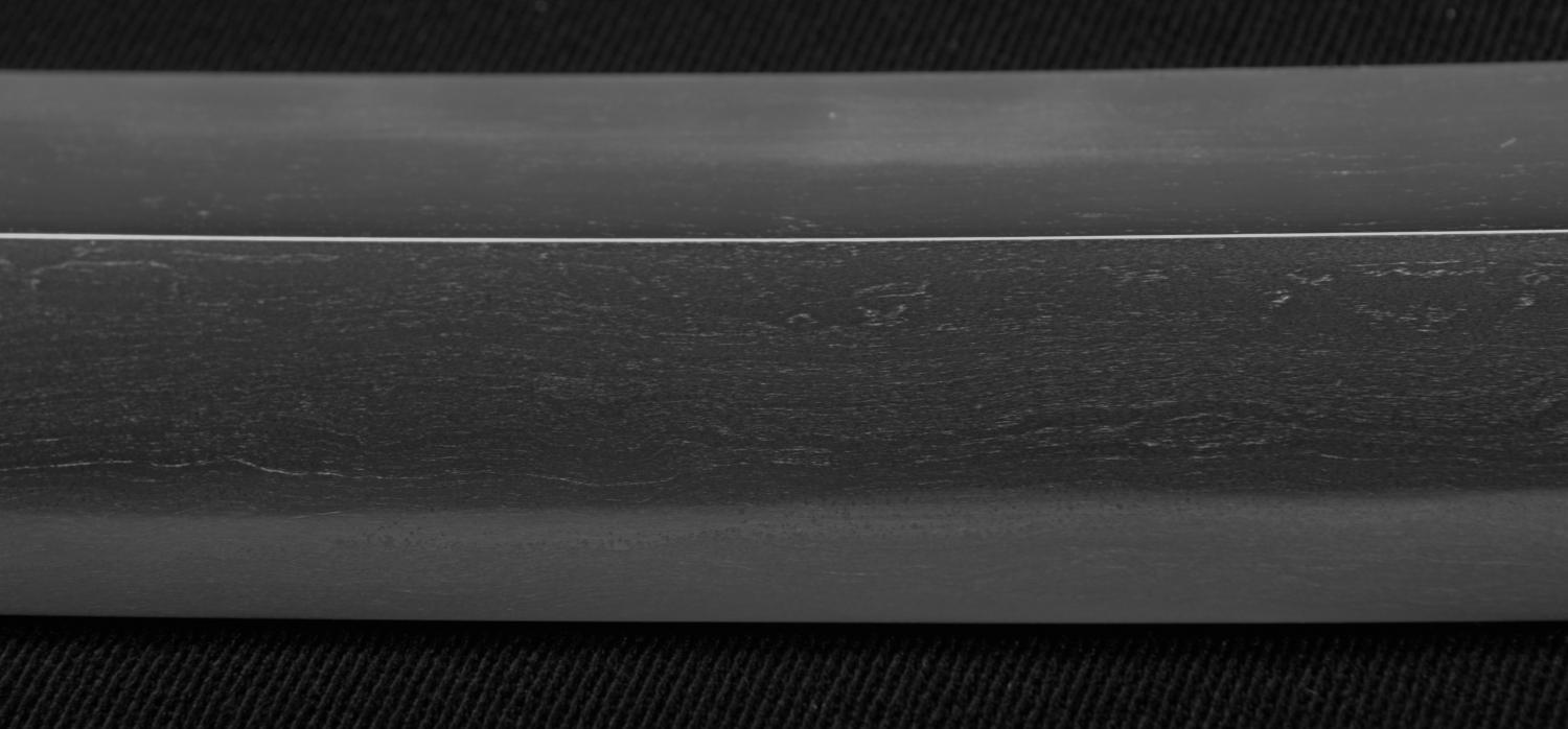

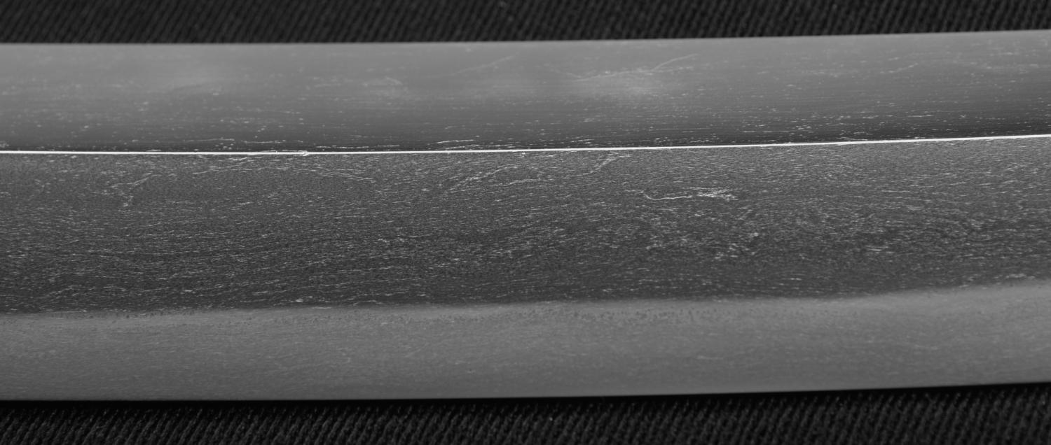

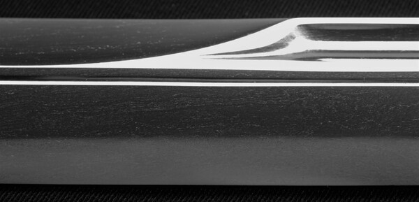

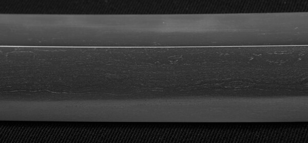

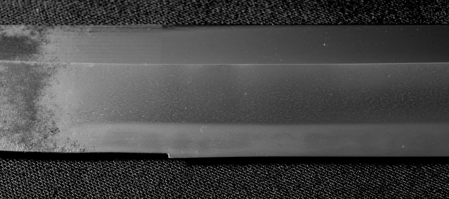

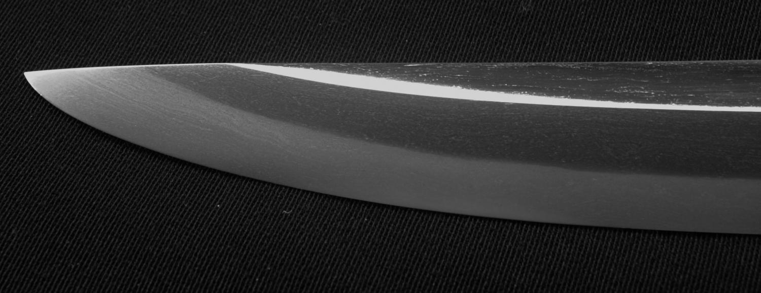

paulb Posted February 19, 2020 Report Posted February 19, 2020 In my bad weather quest to try and improve my photography. Attached are some images of a naginata Naoshi attributed to the Shikkake school of the ealry Nambokucho. It recieved Juyo papers in the mid 1980s.I wrote about it in more detail in an article entitled "Study of a Juyo blade" some 13 years ago and this article appears in the article section here and on the Token of GB website. It is interesting when photographing it this time round I have seen so much more detail than I did a decade ago. I guess a combination of improved understanding and experience and better photography. (getting there but still working to improve it!) 16 Quote
lonely panet Posted February 19, 2020 Report Posted February 19, 2020 I like this a lot, post more pics 1 Quote
lonely panet Posted February 19, 2020 Report Posted February 19, 2020 The soft Evan masame hada mixed with the muneyuki is really enjoyable. BUT the over all sugata really seals the deal. wonderful, but i can only imagine how good it looks in hand. Is the boshi hakikake?? Thanks for sharing Quote
Rivkin Posted February 19, 2020 Report Posted February 19, 2020 Hm, looks Hosho to me. Kirill R. Quote
Ken-Hawaii Posted February 19, 2020 Report Posted February 19, 2020 An ideal blade to study & photograph. Quote
paulb Posted February 19, 2020 Author Report Posted February 19, 2020 I think there is too much itame and mokume in it to attribute it to Hosho. The boshi is hakikake. Two things I picked up when reading about Shikkake in the past: 1. Although seen to varying degrees in most Yamato schools the tendancy for the hada to become masame as it enters the hamon is regarded as a kantei point for Shikkake. 2. To paraphrase a quotation from Tanobe Sensei "When we see a naginata that has obvious Yamato characteristics from the early Nambokucho we tend to attribute it to Shikkake" I am guessing Shikkake for some reason made more naginata and were typically Yamato in style not taking on too many other influences as seen in other Yamato groups of the period. 1 Quote

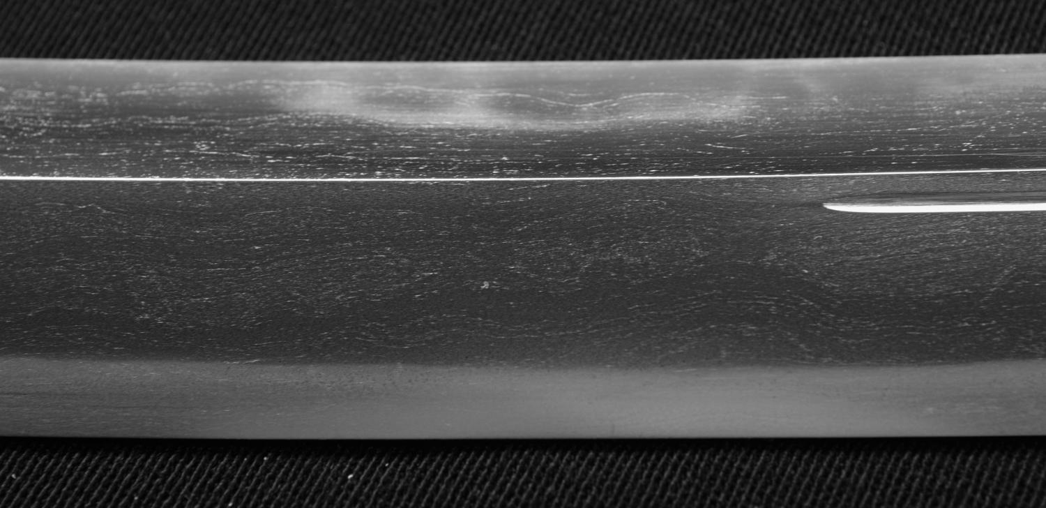

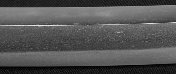

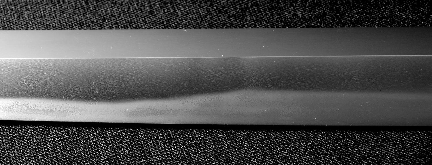

paulb Posted February 22, 2020 Author Report Posted February 22, 2020 Coming back to the orginal theme and I am conscious that I don't want to bore people, but I have been playng with another blade to see if I can get more detail in the hamon and reduce glare from the shinogi-ji. I am becomng a contortionist trying to adjust angles of blade, camera and lights. Going to give it a rest now as I feel I am runing around in ever decreasing circles. But if nothing else I hope it might encourage others to have a go. If a technically challenged impatient idot like me can make progress think what you can do!! 3 Quote
