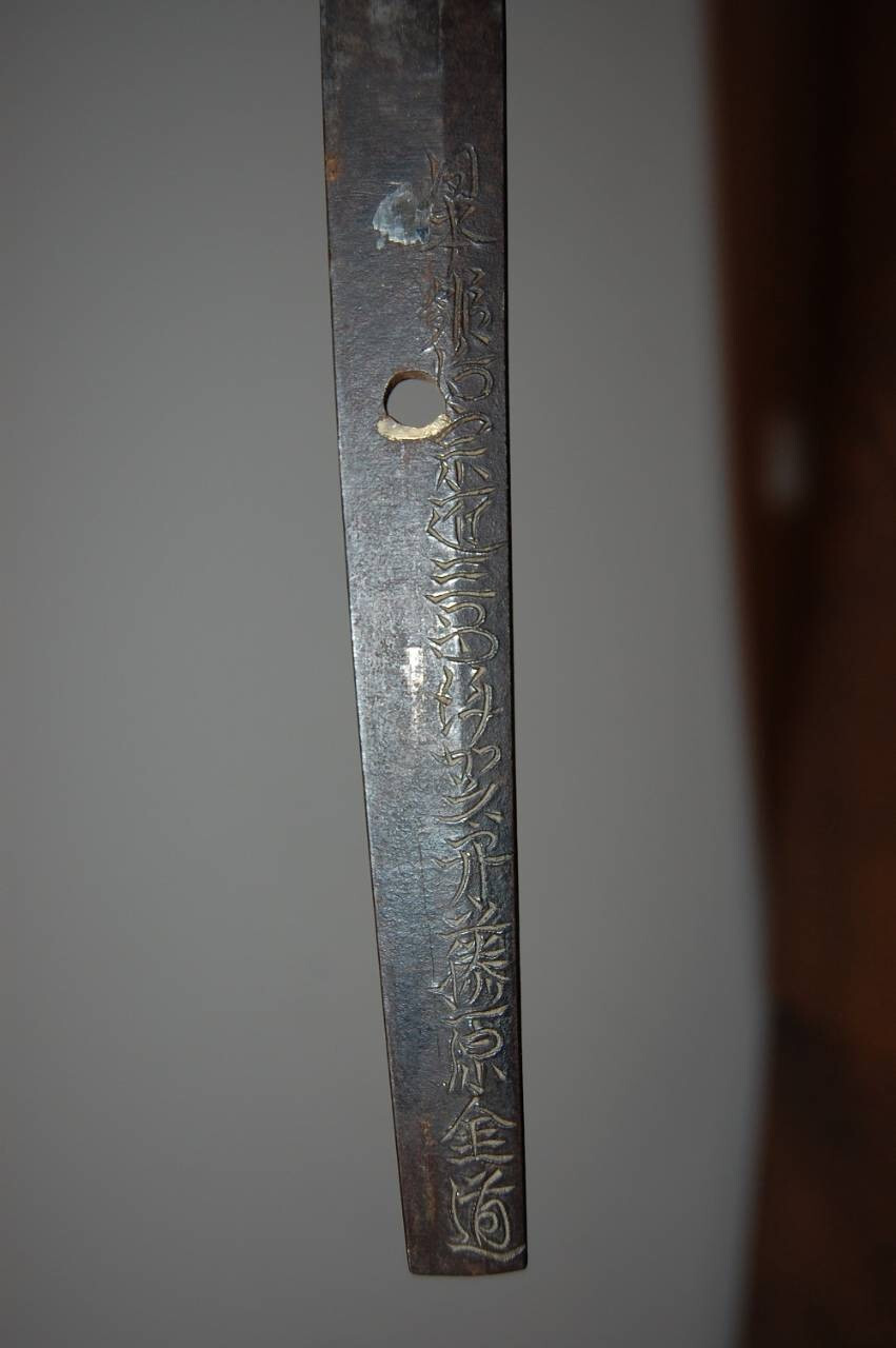

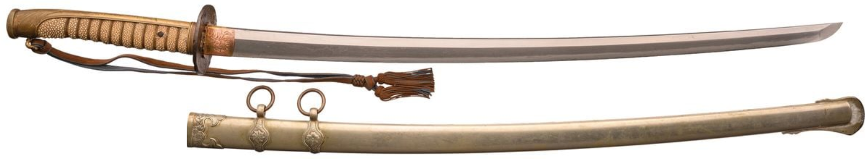

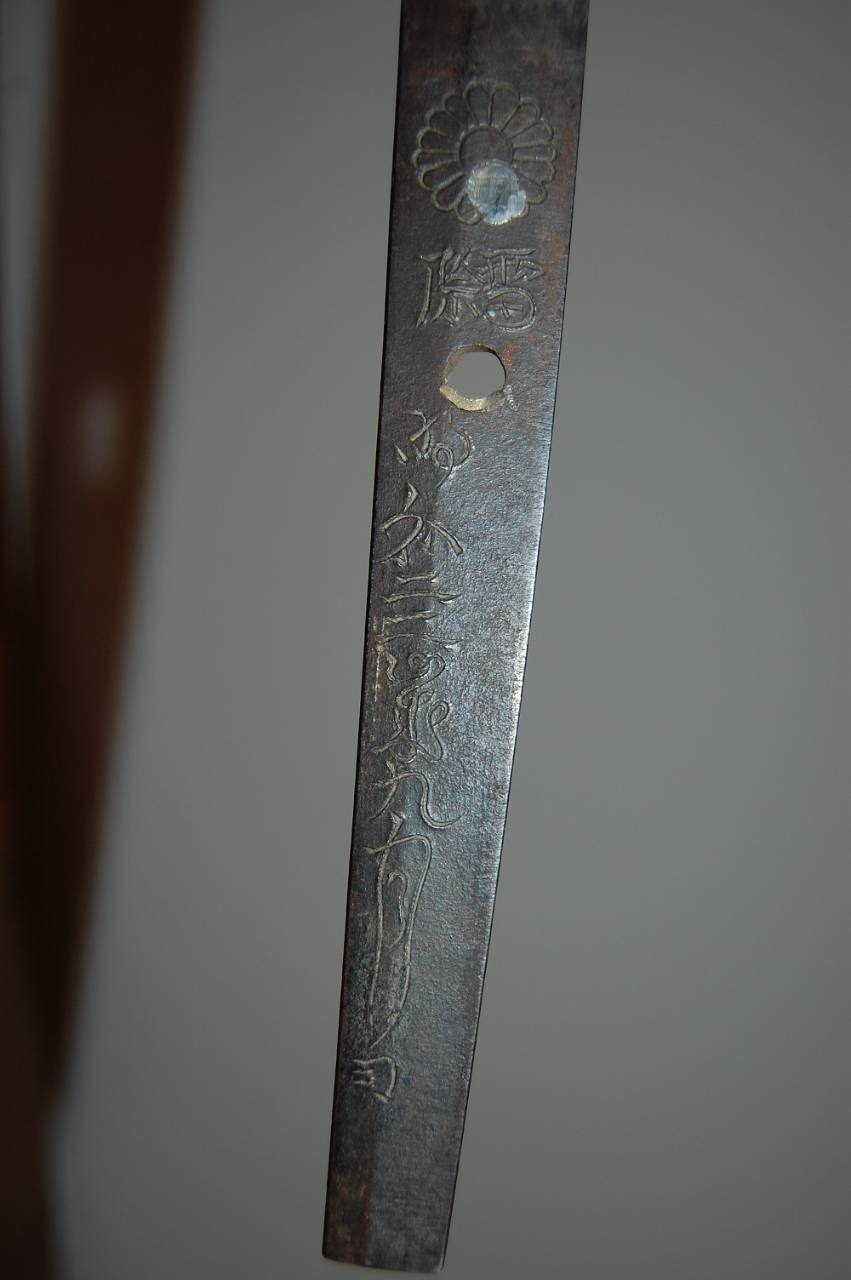

I have a chance to purchase a nice kyu, but want a little more info before I pull the trigger. Seller thinks it is a Murata but the nakago is not signed. There is one small stamp that I am not familiar with. in addition, I have not seen a Murata with 2 thin bohi.
I have requested better pics of the blade itself, but I can't tell if it is an etched hamon. In one of the pics, there appears to be a nioi-guchi bordering the hamon. as always, thank you to everyone who responds!

1 hour ago, Bruce Pennington said:
@Kiipu @BANGBANGSAN - anybody got a meaning of that stamp?
I am clueless on that one. This is shaping-up to be a somewhat rare beast. Seller messaged me that he got it from the Plimpton collection.

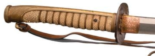

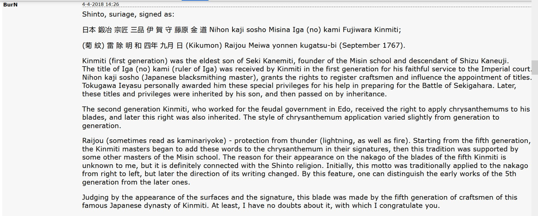

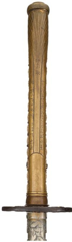

Had to add this one, owned by a Russian collector - Waids - at this Guns.ru thread.  Field grade kyu with a 1767 Kinmichi blade, chrysanthemum.
I realize this is an older post, but fwiw, that was another sword of mine and those are my photos. No cause for concern, glad the forum can reference them, though I should probably start adding a watermark. But the point I want to add is that I have historical photos of swords I have handled (e.g. > 100 Type 95's). If someone needs a reference check for a specific type, or is collecting data, always happy to see if I have something to contribute.

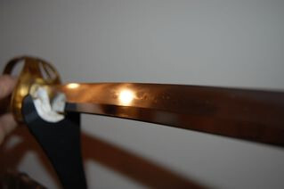

My newest addition, thanks to a trade with @Stegel who snagged this amazing piece from the Lloyds auction recently.  It's from the Barnes collection, and featured in Fuller's book, pages 124-125.  Dawson states that there was a tremendous amount of variants produced between 1873 and 1883.
Army styled kyugunto, but with Navy anchor on the backstrap and drag.  I'm puzzled by the Army company grade tassel.  It's wrapped tightly, and wear indicates it has been there for a long time.
IMG_4238.thumb.jpg.237c7b0170f88bad762e147c157971cc.jpgIMG_4237.thumb.jpg.881961f1ae2d78f03c2ec34d4d44c038.jpgIMG_4220.thumb.jpg.f5f70e7462aeaa140640bb89f854c945.jpg
IMG_4221.thumb.jpg.c3cfb57dfee7dffc2e2176d1fbb74860.jpgIMG_4217.thumb.jpg.5f1892a8c8c42e56035e969cf2a2e43c.jpg
The leather is form fitted too tightly to get it off in order to see the rest of the anchor on the drag.
Mumei, maybe zoheito? @BANGBANGSAN @Kiipu?

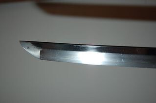

Always wanted a Navy Kyu and finally found a nice one. Even has the tassel!
NTHK papers say the blade was made in the Eisho era about 1504-1521.  attributing it to the Uda Kunimune.
Nagasa = 25 1/2". (64.7cm)
Blade thickness at habaki is 3/16" (6.77mm)
Width at habaki 1" (2.54cm)
Width at Yokote is 9/16" (14.2mm)
Sori is 3/4" (19mm)
