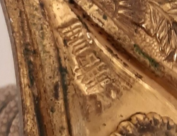

Not familiar with "shi-shi".  What is that?  Also have you had the kanji translated on the guard?

as you can tell i could not get a good clear pic of the Kanji which is presumably the manufacturer of the sword guard  !  maybe someone will recognize it on here .
I've posted it on the Translation Help forum.  Maybe someone can give us an idea.

also i see there is in the translation section,  An excellent reply  about the Japanese   company and the company history  that made these parade sabers.
Yes, after looking at some posts in the translation section they said the stamp on the hand guard is that of KK Suya Shōten  株式會社・壽屋商店 .
Some also lined this article: https://www.warrelics.eu/forum/Japanese-militaria/he-untold-story-suya-shoten-711132/
I skimmed the article but it appears this manufacturer designed many of the uniforms and sword for the Japanese military in the late 1800s. Then in the 1910s and 1920s began exporting to neighboring Asian countries. I believe this sword is one of his exports to China during that time.
