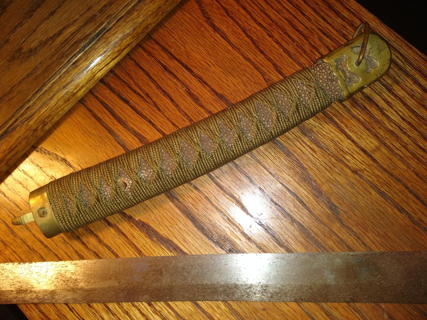

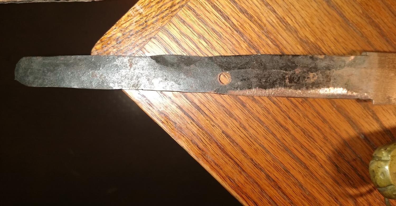

MacTheWhopper Posted February 13, 2020 Report Posted February 13, 2020 Hello everyone. I wanted to show some pictures of a rough shape crude and what I believe to be a later war gunto. I'd like to see what the board thinks about. I have dawson's book but the late war guntos seem to all have the wooden handles. The blade looks to be very crudely made. What do you guys think about it and are swords like these referenced in dawson's book and i just didn't see it? Any information is always appreciated. Quote

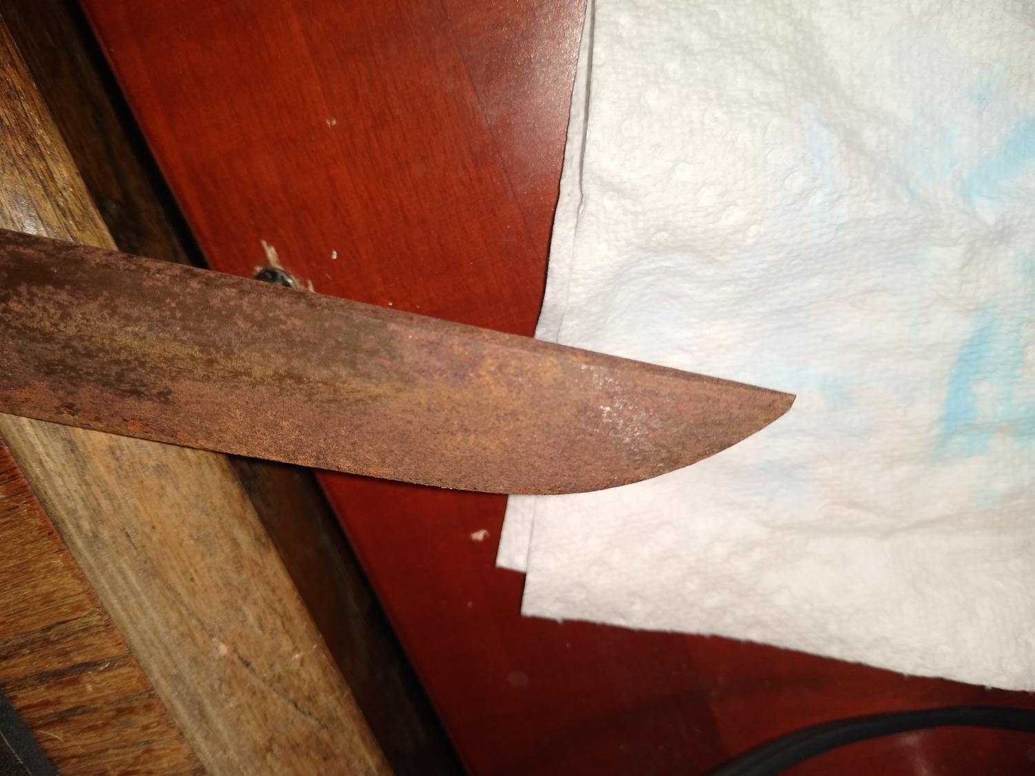

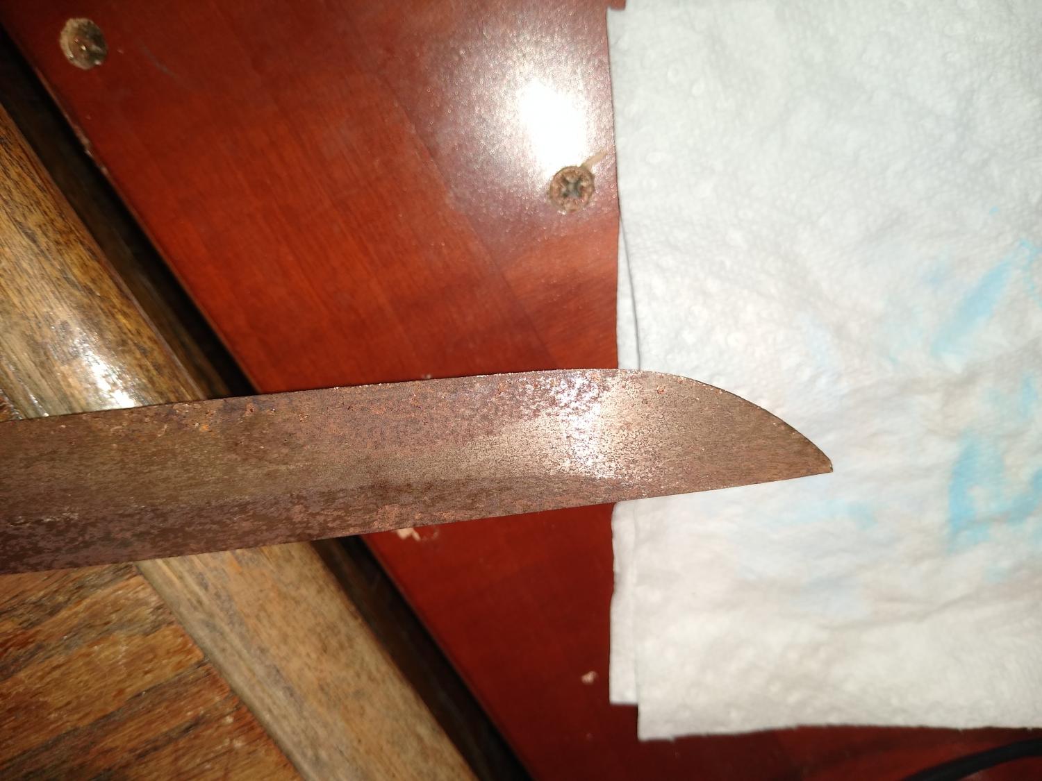

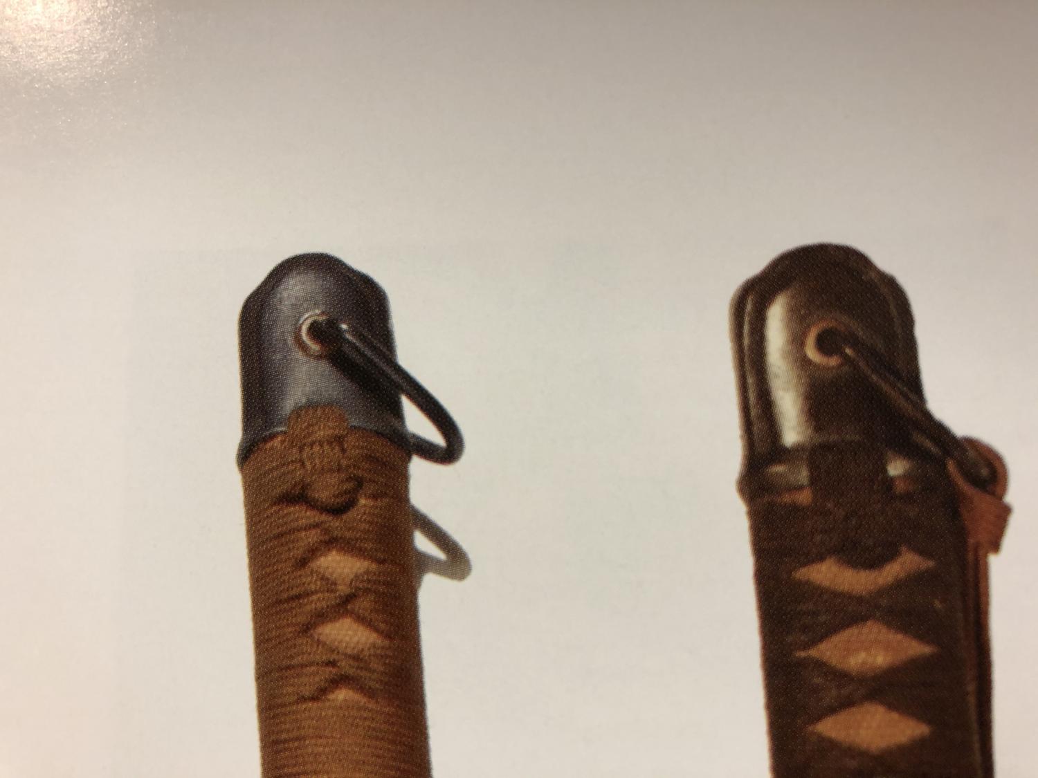

Bruce Pennington Posted February 13, 2020 Report Posted February 13, 2020 Kenny, My tendency with these, and we've seen a few lately, same style, is to lean toward - Chinese fake. I've never seen a "late war" officer or NCO gunto as crudely make as these. Can you post a clear picture of the blade tip? The only legit late-war 98's I've seen come with the style I'm posting a pic of. I could be wrong. 1 Quote

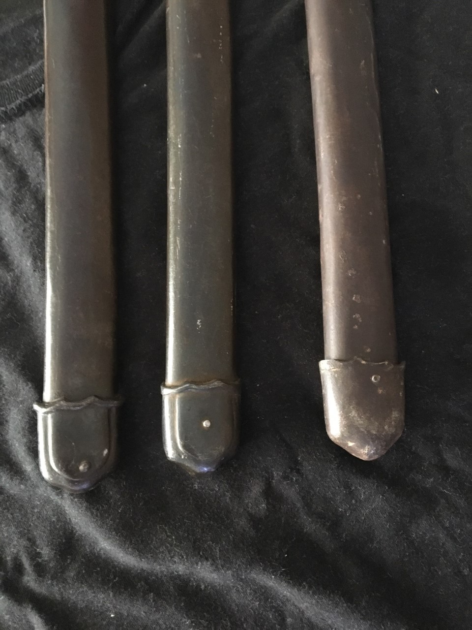

IJASWORDS Posted February 13, 2020 Report Posted February 13, 2020 Sorry to say not a late war Japanese sword. A few late war examples attached. Even late war last ditch swords have some style.. 2 Quote
MacTheWhopper Posted February 13, 2020 Author Report Posted February 13, 2020 I was a little worried that it might be a fake due to it being so crudely made. If fake though, I am covered but definitely want to take better precautions on swords. Quote
Bruce Pennington Posted February 13, 2020 Report Posted February 13, 2020 Well they got the blade tip down pretty close! Usually they get the tip wrong. I don’t see anything else, though that looks Japanese. Quote
16k Posted February 13, 2020 Report Posted February 13, 2020 Could also be something with age, made to look Japanese, on one of the many islands. Not Japanese though. They even got the ito wrapping wrong. 1 Quote

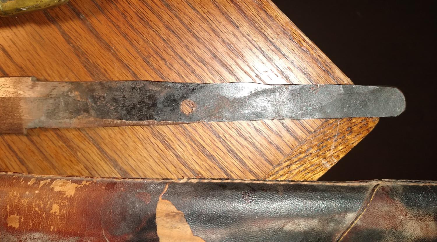

Dave R Posted February 13, 2020 Report Posted February 13, 2020 The single biggest give-away of a Chinese fake is the tang, and sadly this has all the usual give-aways of the type. 2 Quote
PNSSHOGUN Posted February 13, 2020 Report Posted February 13, 2020 At best it's an Island sword. Quote

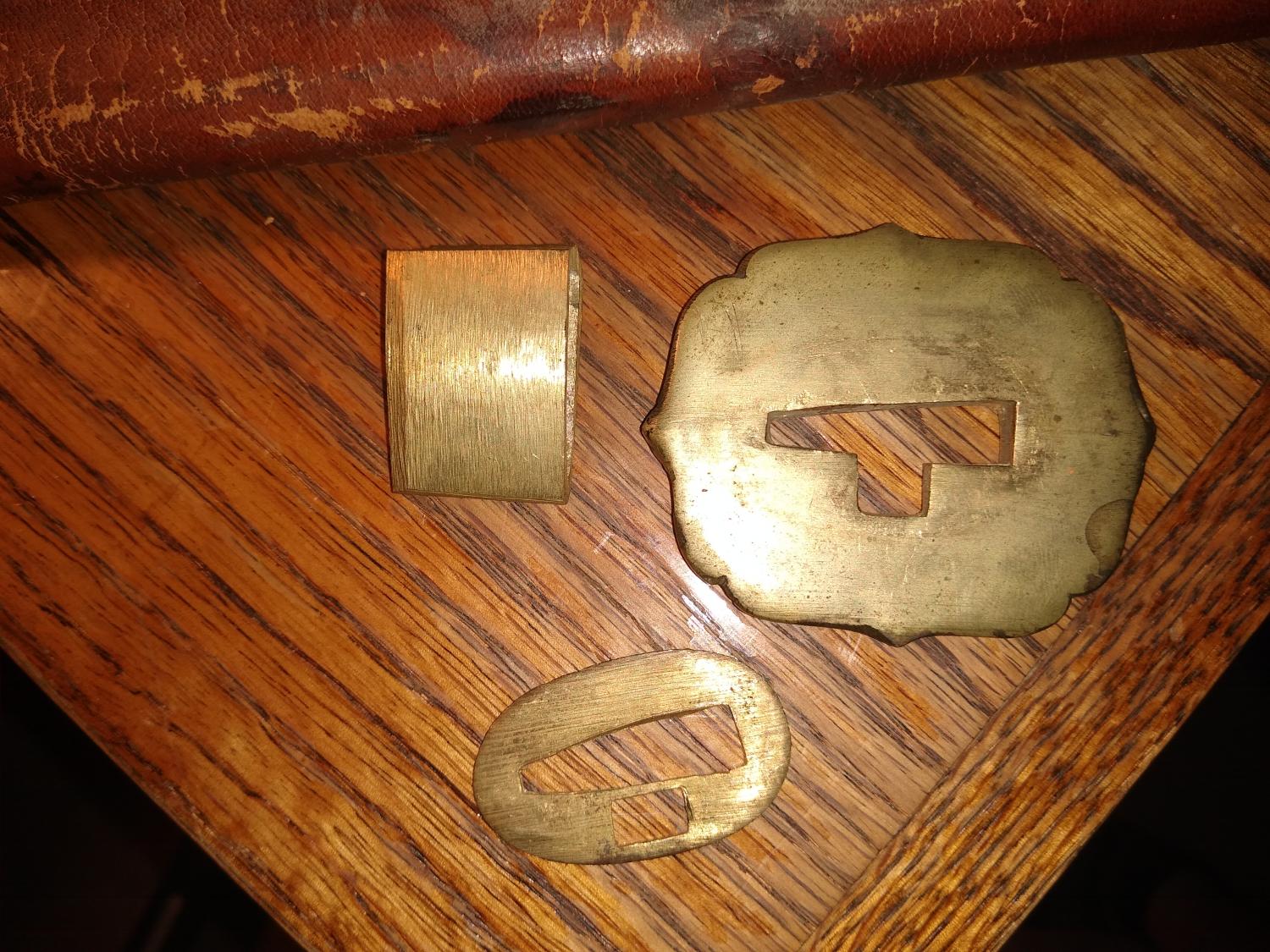

paul griff Posted February 13, 2020 Report Posted February 13, 2020 Hello, Not a total loss..Looks like island made for souvenir hungry troops at the end of the war....The Ito has been added recently but the rest of the bits seem to have some age to them...If you look at the metal fittings they all have the look and patina of “island brass”,same looks old as does the leather and finally the blade is terrible but shaped correctly ie kissaki ( tip of blade )..... Regards, Paul.. 2 Quote
lonely panet Posted February 13, 2020 Report Posted February 13, 2020 Not a island sword, just a poorly aged chinese/indo fake. The island sword myth is missunderstood by many, when really it was more accurately skilled service man making fakes to sell to GIs for profit. I had a family friend how was a black Smith, served on kokoda and the bull track. Who did just this. 1 Quote
Dave R Posted February 13, 2020 Report Posted February 13, 2020 By every definition "Island Swords" are not Nihonto. They are WW2 militaria at best, and you should not expect an informed discussion of such here, which is fair enough.... There are other sword collectors sites. The best of them are swords made for serving IJA officers needing a sword, but no longer on the supply line, and having them locally made by skilled but non Japanese smiths. The other legitimate contenders are those made for subject and collaborator troops and officers, also by local skilled smiths. And then there are the souvenirs, made by CB's or other allied support units,(or local bazaar traders) to be sold to follow up and other non front line troops who wanted a sure-nuff samury sword to take home. Below this in the pecking order are post war fakes.... still being made and sold to the unwary. Opinions are divided as to whether these categories are collectable, or worth discussing, but for better or worse this site is fairly unanimous that they are not! 3 Quote

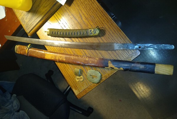

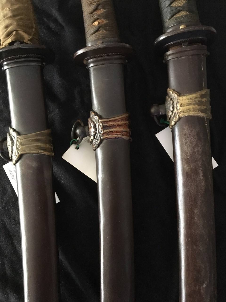

David W Wakeham Posted January 3 Report Posted January 3 HI All i was given this sword to me its a crude local made for the occupying troops to take home as a souvenir. or a late was NCOs has anybody any views. David Quote
George KN Posted January 3 Report Posted January 3 Hi David, I'm no expert, but those fittings do look like post-war souvenir to me. However, I can't completely write off the blade itself. It's always hard to tell from pictures alone, but I can see what look like ware (https://www.Japanese...rdindex.com/kizu.htm) in the steel: This is odd for a reproduction/souvenir/fake (or at least something I haven't seen before), and in places it even looks like there *could* be a hamon: However, the shinogi (non sharpened back bit of the blade) feels a bit thin for its size, and I also can't see a yokote (dividing line for the tip of the blade), which doesn't bode well though. Being able to see the nakago/tang would be a real help here if possible. Also, welcome to the forum! Quote
Polaria Posted January 4 Report Posted January 4 My notes: Koshirae doesn't look right at all, even for late war production. Tsuba is decorated, but the decorations are wrong in style and subject. Saya fittings do not look right at all. The wood hilt has wrong cross hatching. I cannot say about the blade and there are better experts for that here, but nothing in the koshirae looks genuine. Quote
Bruce Pennington Posted January 4 Report Posted January 4 It strikes me as an effort by collaboration sword makers to make an NCO sword. Collaborators had NCO ranks, too. It's just something we've never seen discussed. Nor do we know enough about, nor have enough wartime photos of, to base real decisions on. We all know what the nakago will likely look like, but you ought to pop the tsuka off on the chance there is a Java mei. If so, it locks it in. Without it, we are back to speculation. Quote
David W Wakeham Posted January 4 Report Posted January 4 Thank you for your help George Mikko and Bruce. The tsuka is held on by two brass menuki I will have to drill out. I am a bit reluctant to do. I also have not seen any photos of this type of sword. Like Bruce put it a local made collaborators or for Korean guards Quote
Bruce Pennington Posted January 4 Report Posted January 4 On 1/4/2025 at 6:49 PM, David W Wakeham said: I will have to drill out. Expand Ok, then not necessary. Only do it if it's something you want to pursue. Quote
